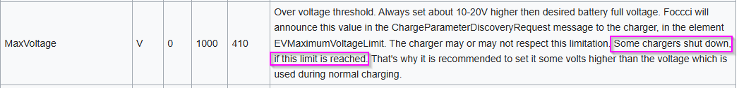

The parameter EVMaximumVoltageLimit is explained here: https://openinverter.org/wiki/Foccci#Parameters
But before changing this parameter, could you please test whether with the latest fix now Foccci tells correctly what went wrong? The software is available here: https://github.com/uhi22/ccs32clara/act ... 0247825798

Thank you for investigation! Zombie adds 10 volts over Voltspnt and I did not think that, so it got over the set maximum. Just thinking this request over maximum voltage problem, are there any cases where it would be needed to send higher request, because Clara could just limit request voltage to maximum voltage?
Upgraded to latest git version and did few charger tests, battery was quite full. 0608-kempower-neste.txt should still be maximum 330v and set point 333v, but not 100% sure anymore after long day. It gives "[19380] Charger reported EVSE_Malfunction. A reason could be hitting the EVSEMaximumVoltageLimit.". EVSE is 400/800v so should not hit the limit.

My first thought was: No, we do not add additional plausibilization into Clara, because this makes trouble shooting more complicated and just is a workaround to live with wrong parametrization.
But yes, let's make the life a bit easier. I now added a limitation of the voltage request, which is one volt lower than the parametrized MaxVoltage. Why one volt? Choosing zero tolerance would immediate trip the overvoltage detector. Choosing too much would irritate the people. So the 1V is a (ugly) compromize. It leads also to a warning in the log, so the user is aware of the wrong parametrization.
Basically if Zombie decides for a certain voltage, I would assume that this is based on the BMS or whatever, and is BELOW the overvoltage threshold. So the clean way would be, to parametrize Zombie (or BMS or whatever) to a highest normal operation voltage, which is requested to Clara, and in Clara set the overvoltage threshold 5V above the highest normal voltage.

In the 0608-kempower-abc-350v log we see:
- EVMaximumVoltageLimit is now parametrized to 350V, as expected.
- PreCharging to 306V works. Is this a plausible voltage for 79% SOC?
- charging loop runs, with EVTargetCurrent=44A and EVTargetVoltage=336V.
- after ~6 loops, the charger seems to try to deliver power, and the EVSEPresentVoltage jumps from 306V to 324V. With zero current, and EVSEStatusCode saying EVSE_Malfunction.
This looks like the charger does not see the battery, because jumping by 20V should for sure lead to a significant current. Maybe the charger has an issue with its output contactors, or the car with the CCS contactors. I guess you have not connected a voltage measuring board at the CCS inlet, this would help to see whether the inlet voltage also rises or stays at 306V, so we would know whether to search inside the charger or inside the car.
Or: The real battery was at 324V, and the precharge target was wrong. So the charger precharged to 306V, then the contactors closed and the voltage jumped, driven by the battery, to 324V, so the charger saw an unexpected jump and ran into error.

[19650] Charger reported EVSE_Malfunction. A reason could be hitting the EVMaximumVoltageLimit or EVSEMaximumVoltageLimit.

This mystery is now solved also. Wallbox plug temperature sensor must haev failed about the same time as I moved to Foccci, I didn't notice Wallbox red LED flashing once in about 3 seconds, now replaced sensor with a resistor and EVSE is working fine.evMacGyver wrote: ↑Tue Jul 30, 2024 5:58 pm My home EVSE is Tesla Wallbox gen 2. Does anyone know is there something tricky with these, does it try to communicate using 5% CP?
There is also Legacy mode for communication which is more for type 2, tried both modes with success and kept Standard or whatever mode it was earlier.
