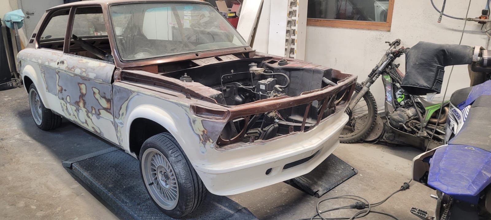

- Take the car to painter to install 2002 Turbo fender flares.
Originally I was thinking of not having those turbo fender flares, but as front wheel well is so shallow, wheel would hit the fender lip with these rims or the car would have to sit very high - which just looks bad. Rims would have to be 6" with 175mm ET30 tire to go inside the wheel well. Those kind of 4x100 rims are very hard/impossible to find with nice styling. So need to do the turbo-mod.

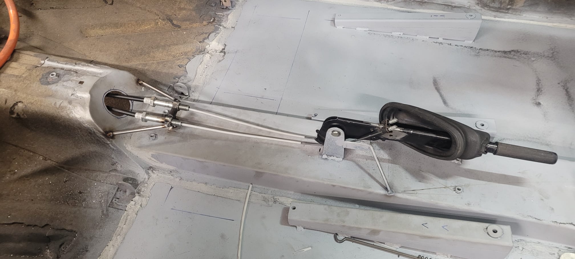

Original plan to have Golf GTI seats did not happen, as seller couldn't find the seats. So plan B, BMW 2-series (G42) alcantara sport seats. This simple seat replacement accumulated way bigger project, as original seats sit high on top of transmission tunnel but new seats need to go to bottom. So first the tunnel was cut a bit, then bit more.. until we realized that they don't sit straight in front of steering wheel.. So need to cut more.. and eventually, whole floor was completely removed and made a new one to make the seats align and sit low enough properly :)
Rear drums also gave a headache, as they we party stuck and adjustment screw was so round and stuck that it was not revivable. New turbo drum brakes from Walloth & Nesch was around 1000 euros.. So started looking for alternatives. 2002 forums blog post suggested using VW Golf MK1 front rotors, MKIV calipers, Golf carrier and custom brackets. So went with that.
As floor was removed and rear brakes upgraded, some new handbrake wiring was required.
As car sit lower, rear camber was way off. So new plates were done to allow camber and toe adjustment.
Next up is revamping the rear shocks, plan is to replace separate coil and damper with coilovers.

Update from the paintshop. Turbo flares and front lip installed. Prepping for the paint.
