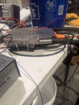

OK! So I reinstated the royhen99 code with some modifications and hooked everything up to water, 320V and 12V and ground. I had the controller run through all IDs on the lin.order command and used ID 39 for the lin.response, since this is the only ID that does not return -1. Power set for 1000, Temp set for 100 and UDC in was around 320V.
The Serial Monitor began working FINALLY and the readings looked like this.
I am working to correct the information being spit out from Serial Monitor. I changed up the code to print out each of the numbered data lines [1]-[8] and this is the printout:
I am curious why the final data byte 8 goes back and forth between 0 and 1. The wiki page lists the 8 bytes out. I wonder if the 0,1 back and forth is trying to turn the heater on, but it is not appearing in the correct location.
For some reason, the formula in the STM32 version used to decode the data is not giving me accurate info:
Interesting to me that the data readouts by each number are different that the printout of the linRXdata repones of:

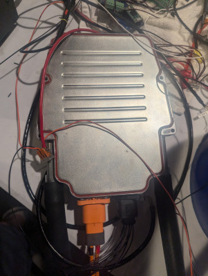

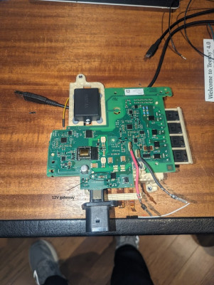

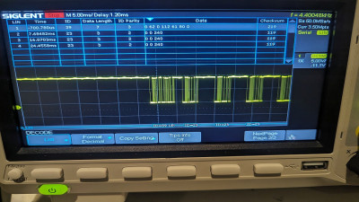

I HAVE HOT WATER!!!!!!
So I went to bed last night thinking about what I was missing and woke up with the thought that there might be info hidden in DATA[0] since DATA[1] was used to calculate temp and I recall Johan mentioning that the on status would be in byte 0, so I modified the code to print out DATA[0] through DATA [8] using lin.response ID 39 and running through all of the lin.order IDs.
I ran this code:
with this response:
DATA[0] showed 0s until ID 35 and it jumped to 128 at that point. Therefore, I assumed ID34 was causing the change in DATA[0].
I then modified the lin.order command to ID34 with the lin.response on ID39 and water started to heat.
Here is the code I was running:
Serial Plotter:
Not sure why the 128 in the first bit drops to 32 at some point, but it did not affect the heating as far as I could tell. You can see that the final bit seems to increase over time and I am pretty sure is the temperature. I pasted examples along the way of the number increasing. With an offset of 40, I assume the temps are between 80 and 110 C. I will need to work on the formulas for the output on serial plotter, but I assume those are just for my knowledge and do not affect the heating of the water.
This was only on the VOLVO HVH50 heater out of a CX90, so I will need to sniff the other heaters for their lin.response ID and then lin.order ID, but now I have the blueprints and steps to do it.
THANK YOU THANK YOU THANK YOU ROYHEN99! I would not have been able to do this without your help. You created the initial coding and talked me though the issues I was having and taught me about hoe to code on my own! Thank you Johan for forging the path on the STM32 version to allow us to have the blueprints we needed. The guys at the Teensy forum were invaluable with the lin2x fix, the linbus.cpp fix, the sketches to sniff out a response ID and just teaching me enough that I could experiment on my own to get to this place.
I will update the wiki page with the info for this VOLVO heater. I have two other heaters (from Chrysler Pacificas I believe) and will try to sniff them out as well and will update the wiki page if I figure them out.

Re: Webasto HVH50
I am going to open this thing up and trace out the circuit.
As I understand it, all that is happening is there is an IGBT on one side of each PTC element that acts like a switch, connecting it to one side of the HV.
The other side is always connected to the opposite polarity of the HV.
As PTC elements are self regulating, there is no temperature control, it just turns on more elements for more heat.
It may be simple to control the IGBTs with a +12VDC on/off and bypass all the software control, I certainly do not need it.
Webasto actually makes a version that is controlled with +12VDC directly, but good luck finding one to purchase!
- Posts: 80
- Joined: Sun Oct 30, 2022 2:21 am
- Has thanked: 4 times
- Been thanked: 9 times
Re: Webasto HVH50
Just so you know, I did this as well a while back. Here is a photo of the board. I purchased an extra heater at a good price that was sold without warranty it was functioning. I opened in up and started checking for continuity and I was able to identify some of the pathways, such as the HVIL loop and the 12V line pathway to a dead end after the resistor at a small black chip (circled below), which might be the gateway that opens when the proper LIN command is received. I assume this could be bypassed, but I abandoned this in favor of learning how to program the LIN with a sealed unit. I also discovered that there is a GND wire in the 8 wire setup (#8) that I started using with the board outside of the metal case, just to make sure the board was getting a good GND signal. I actually got some sparks with the 12v only attached when the multimeter prong touched across a couple of lines accidentally. I agree that there should be a way to bypass the lockout of 12V on and off that is closed in programming.
Re: Webasto HVH50
Thanks for showing that, it looks plenty complicated!
If only they would sell the 12VDC controlled model, or if there were information on what application it was used in...
With the help you have provided I will pursue getting the local college's programming school to take it on as a project.

Hello everyone. I have finally SOLVED the HV heater issue and can set out a path for anyone still trying to incorporate an HV coolant heater into their EV build.
After not having much luck with the various HV50 or HV70 heaters from various companies like Volvo and Chrysler, I looked into other options and found this company and their HV Heater.
https://www.auto-parkingheater.com/elec ... -cars.html Ask for Luda.
The form factor for this HV Heater is almost identical to the Webasto HV50/70, probably a little smaller actually. The cost, including international FedEx shipping to my home in the USA was under $350.00 AND it came with all of the mating connectors, already wired up. The LV connector is identical to the Webasto LV connector. The HV connector is similar to the Webasto one, but has a slightly different key at the top. Also, it is brand new and not harvested from a junked EV.
Best part about this is that it came with the manual and all of the LIN commands and IDs and baud rate and the proper LDF (Lin Description File) and tech support to get things working. I was able to salvage the code we started on this post and completed with the help of folks on the teensy forum site. I ran the final code tonight and it was heating the water on my test bench to 80C.
Here is the code for anyone that wants to go this route [UPDATED ON 8-19-24]:
The code will printout the following info in the serial monitor (below are pulled from the serial monitor at different points in time):
