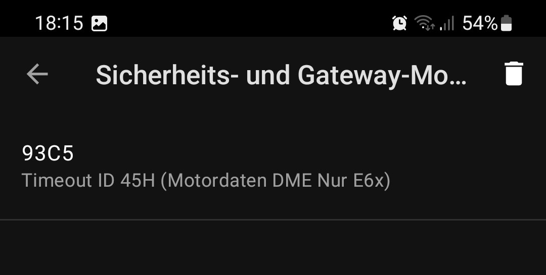

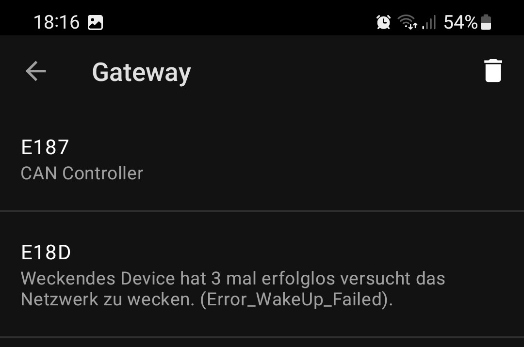

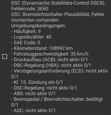

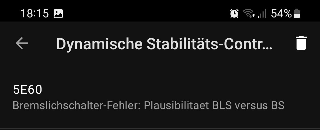

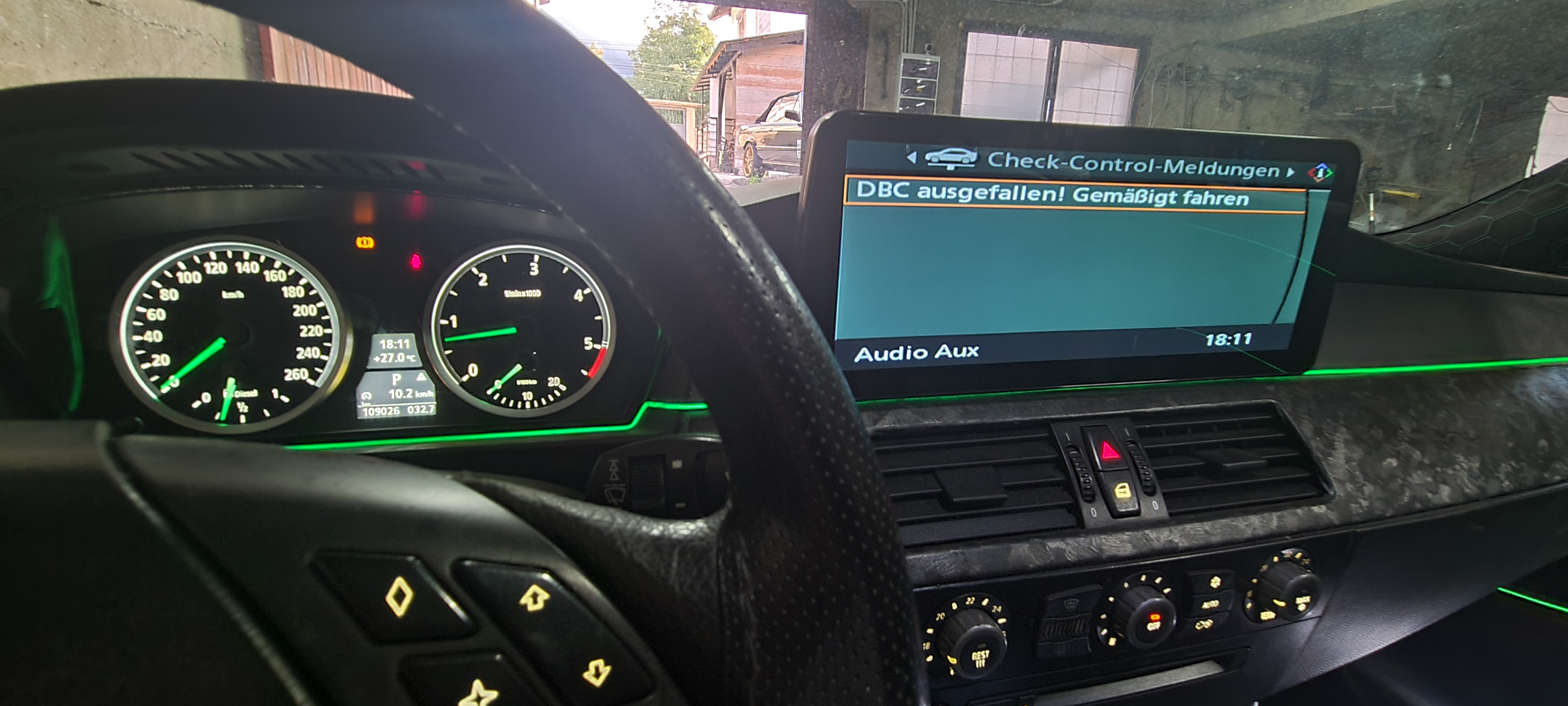

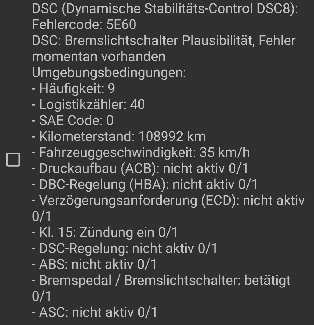

After I drive about 30kmh and hit the brakes, these error messages appear
Posts: 2418
Location: Bristol
Has thanked: 209 times
Been thanked: 576 times
Re: Zombieverter, E65 vs E60
Okay, so a few things possible and wierd others do not see these:
1. E18D possibly not waking up quick enough to send CAN, will review your log again to check where we wake. Hard to compare to your before engine removal, as you have no logs.
2.93C5 No idea if this means messages missing, can have a look online to see if there is more. Message ID 0x45 will look at this
3.5E60 You have brakes wired into zombie? As the Zombie mimic the DME reading the brakes and putting this onto CAN as the DME

Post by medo »
No, I haven't connected the brake pedal signal to the zombie converter. Shouldn't it transmit it to the zombie converter via the vehicle's CAN?
Maybe I should also make a log while driving
Posts: 2418
Location: Bristol
medo wrote: Wed Aug 21, 2024 6:03 pm No, I haven't connected the brake pedal signal to the zombie converter. Shouldn't it transmit it to the zombie converter via the vehicle's CAN?
No the brake is needed into the Zombie it does not take it from CAN. The DME in the BMW also reads the brake sensor and transmits it.
Driving log is good too.

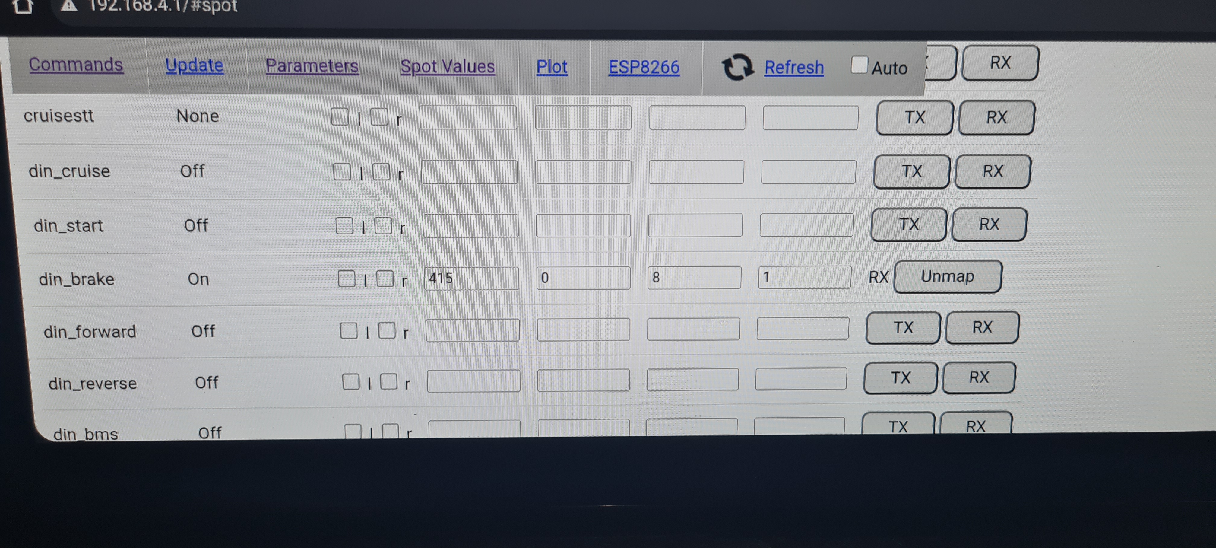

medo
Posts: 168
Joined: Thu Dec 07, 2023 9:32 pm
Location: Kosova
Has thanked: 18 times
Post by medo »

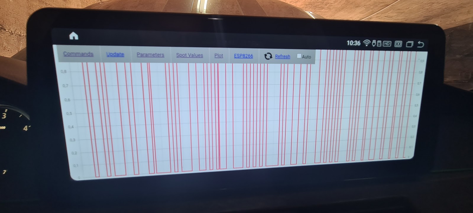

when I hold the brake, the signal in the zombie jumps back and forth, since we have the brake signal twice per CAN, it would be cool if you could use that and not lay more cables
Posts: 2418
Location: Bristol
medo wrote: Fri Aug 23, 2024 1:42 pm when I hold the brake, the signal in the zombie jumps back and forth, since we have the brake signal twice per CAN, it would be cool if you could use that and not lay more cables20240823_140740.jpg
Why do you have it twice per CAN? You do not you mapped it once. I will have a look in the code to review what is going on, it might always just be looking at the digital input.

There will not be a CAN resolution I am not modifying the brake signal coding. Possibly CANIO might still be working in Zombie https://openinverter.org/wiki/CAN_commu ... deprecated
You need to map this in stead of DIN_Brake
medo
Posts: 168
Location: Kosova
Post by medo »
Unfortunately I don't quite understand.
is that right??
can rx canio 415 2 6 1 on VCU
can tx canio 415 2 6 1 on Inverter
Posts: 2418
Location: Bristol
medo wrote: Fri Aug 23, 2024 6:34 pm Unfortunately I don't quite understand.
is that right??
I do not know if canio can be sent, you might need to send the brake signal on the right bit to match the CANio
medo
Posts: 168
Location: Kosova
Post by medo »
That worked, no more errors
