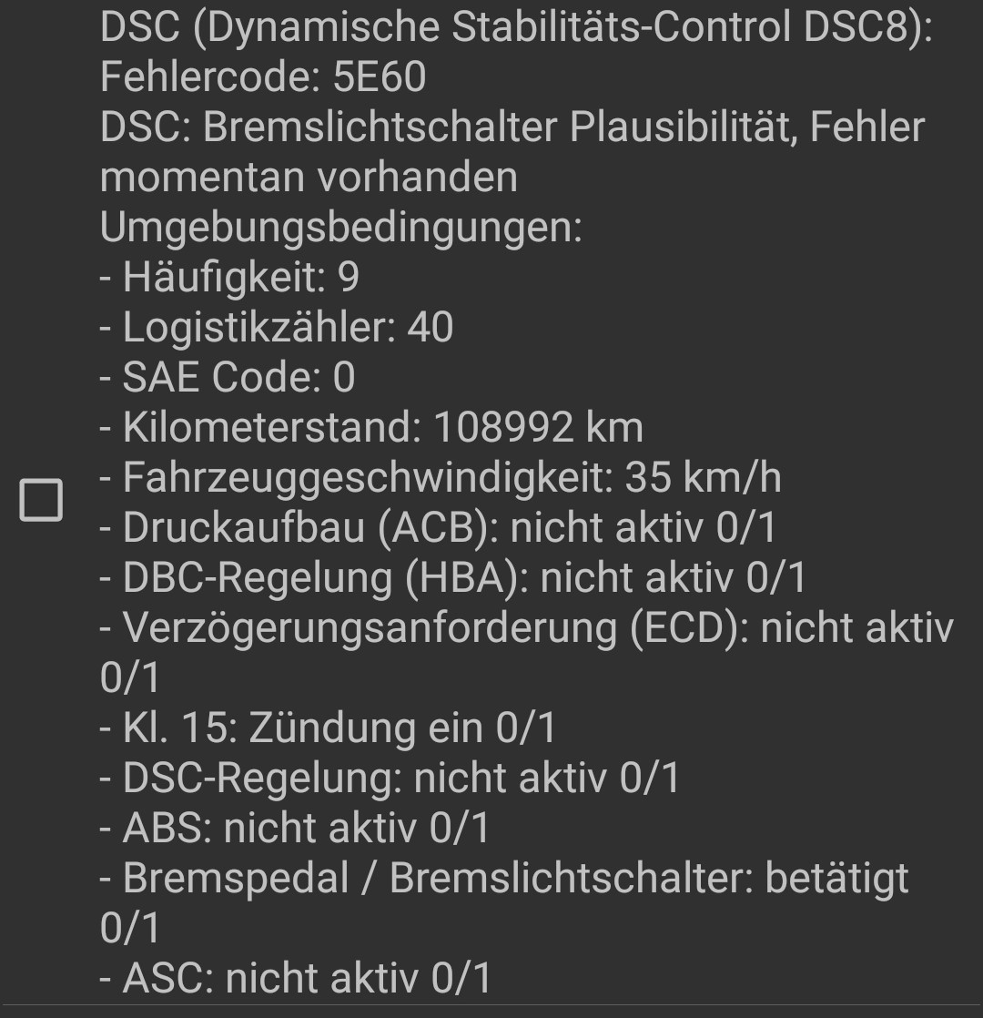

After I drive about 30kmh and hit the brakes, these error messages appear
Posts: 2962
Has thanked: 328 times
Been thanked: 847 times
Re: Zombieverter, E65 vs E60
Okay, so a few things possible and wierd others do not see these:
1. E18D possibly not waking up quick enough to send CAN, will review your log again to check where we wake. Hard to compare to your before engine removal, as you have no logs.
2.93C5 No idea if this means messages missing, can have a look online to see if there is more. Message ID 0x45 will look at this
3.5E60 You have brakes wired into zombie? As the Zombie mimic the DME reading the brakes and putting this onto CAN as the DME

No, I haven't connected the brake pedal signal to the zombie converter. Shouldn't it transmit it to the zombie converter via the vehicle's CAN?

No the brake is needed into the Zombie it does not take it from CAN. The DME in the BMW also reads the brake sensor and transmits it.

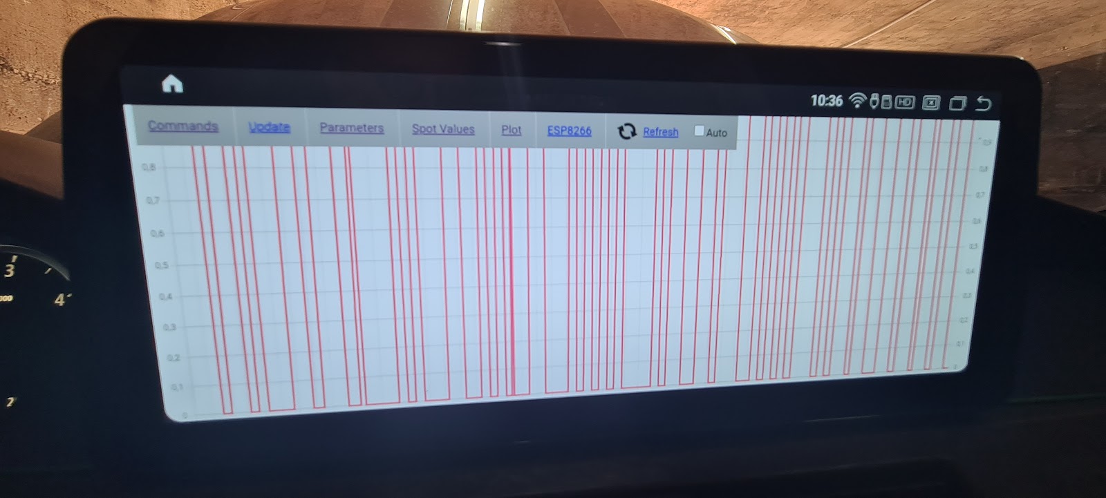

A graph showing it going high please. To ensure it reaches the Zombie.
Can simulate this on the bench to see if this works.
medo
Posts: 207
Joined: Thu Dec 07, 2023 9:32 pm
Location: Kosova
Has thanked: 21 times
Post by medo »
when I hold the brake, the signal in the zombie jumps back and forth, since we have the brake signal twice per CAN, it would be cool if you could use that and not lay more cables
Posts: 2962
medo wrote: Fri Aug 23, 2024 1:42 pm when I hold the brake, the signal in the zombie jumps back and forth, since we have the brake signal twice per CAN, it would be cool if you could use that and not lay more cables20240823_140740.jpg
Why do you have it twice per CAN? You do not you mapped it once. I will have a look in the code to review what is going on, it might always just be looking at the digital input.
