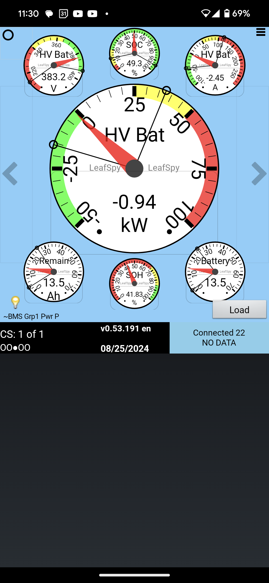

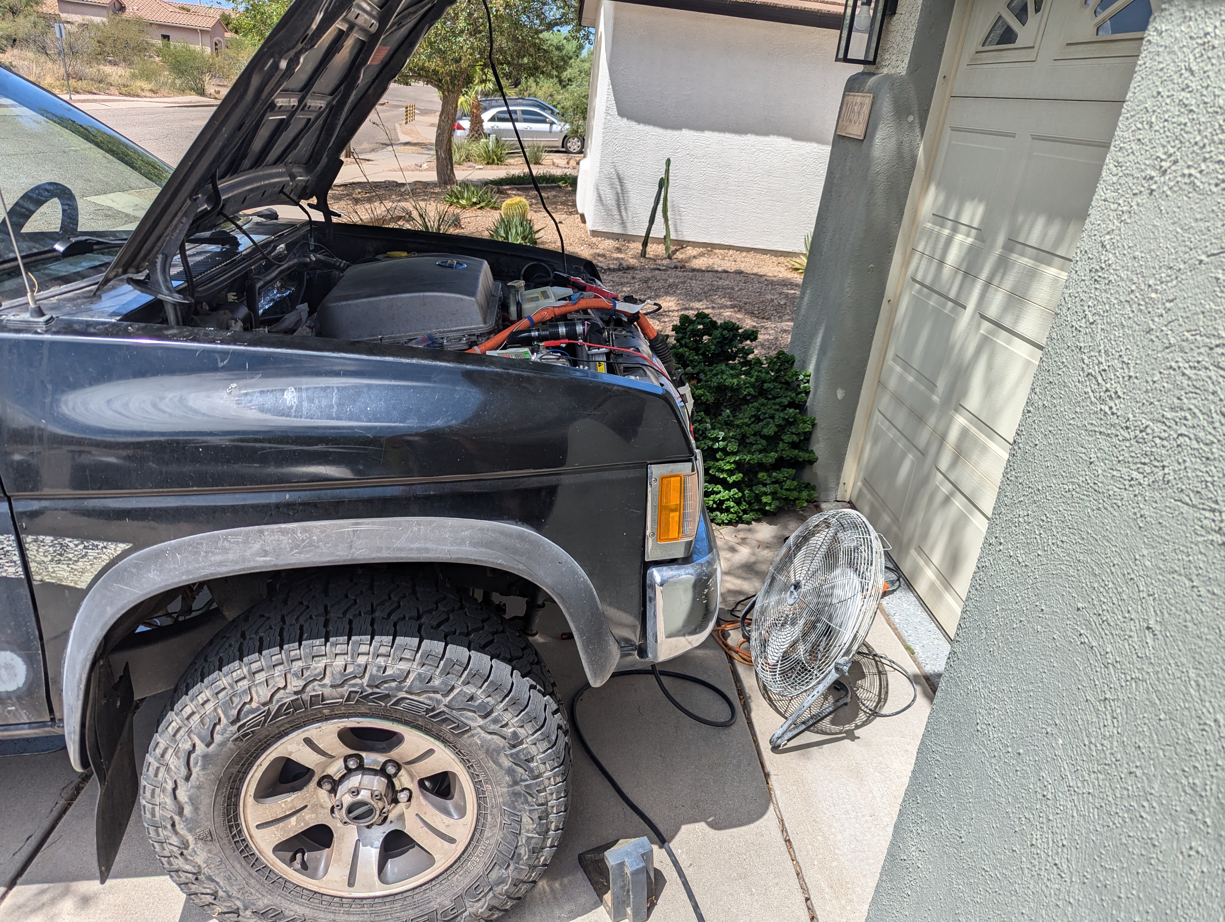

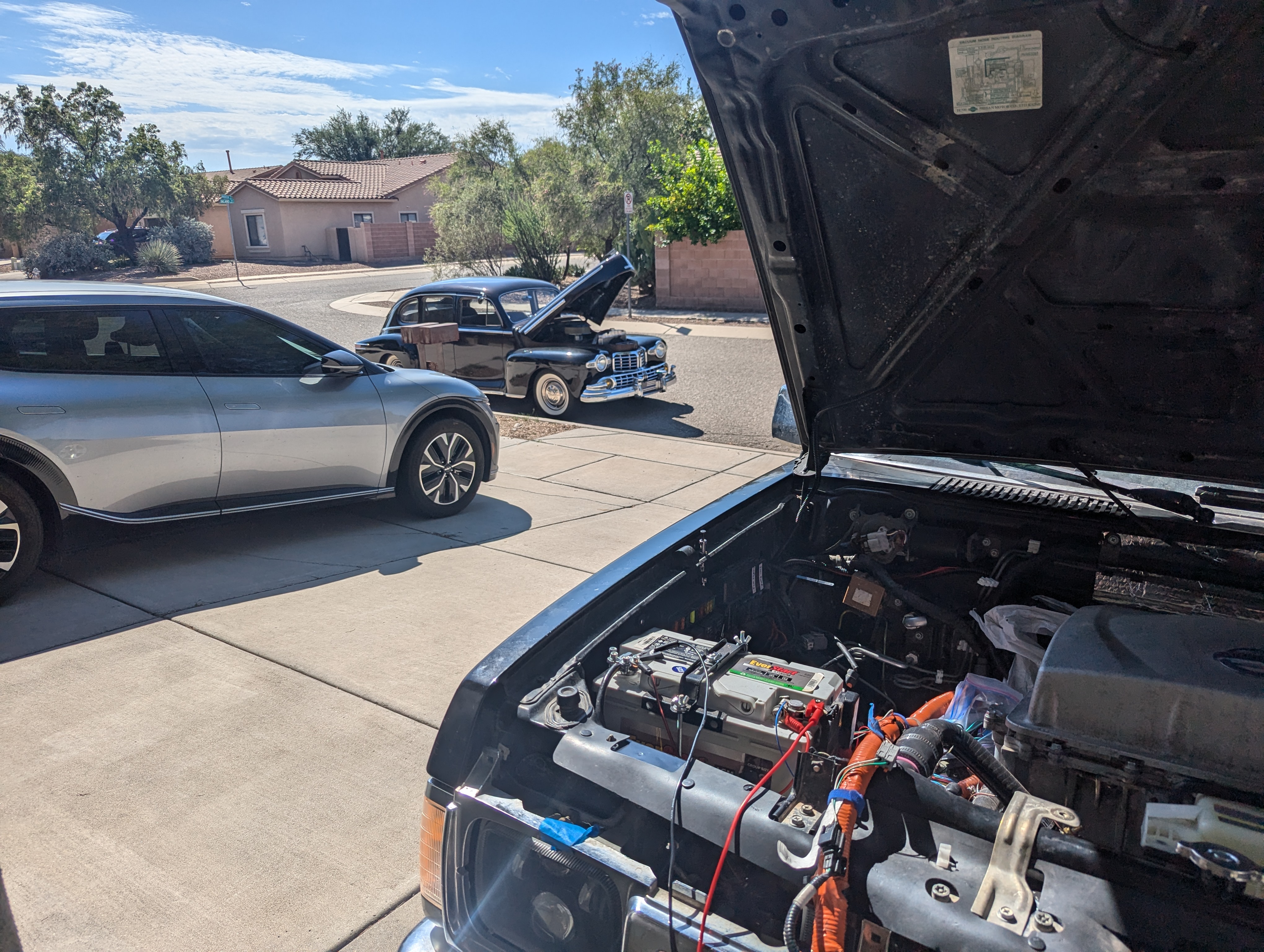

I finally got the Nissan to charge with the Leaf PDM with the help of J0hannes. He kindly provided me with his fork of the ZOmbieverter code for testing. I took the Nissan for a 5 mile trip to the gas station for snacks, and the only issue I noticed is a drive shaft vibration.
The speedo works!!! I added first 5 EV miles to the odometer.
Before I loomed the wires in the cabin
After looming most of the wires
It's taking a charge!!!
Charging. I don't have the fan installed yet, so I'm being cautious.

- I was able to drive my truck to my new house with a charging patch from J0hannes. Thanks!
- Zombieverter 2.20A firmware fixed initiate AC charging with the LEAF PDM
- After getting the charging started I'm unable to leave charging mode without a hard reboot of the zombieverter
- I've smoothed out the motor oscillation with parameters
- I've purchased CATL style modules to build a 52.8kWh battery pack
I have been able to successfully charge the battery. Now I can't seem to get the zombieverter out of charging mode without a hard reset. Unplugging the charging cable doesn't leave charging mode, turning the ignition off and on in any sequence didn't seem to do the trick either. What conditions is the VCU looking for to go back into run or off mode?
