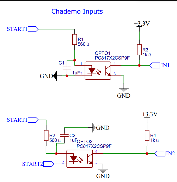

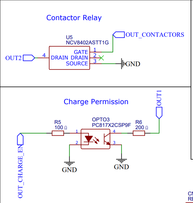

Re: ESP32 Based Chademo
Hi can you tell me what kind I/Os you use?
IN1 and IN2 are pullup inputs? In DUE version i use IN1 with signal LOW (GND) and 12V pullup with NPN transistor releasing pin to pullup.
IN2 signal directly with 12V signal and then interim NPN transistor would pull the pin down.
How are the OUT1 and OUT2 used? As open collector directly or should i use additional relay?
TNX
If only the circuits were opensourced. Oh wait they are on the first post.
https://github.com/jamiejones85/ESP32-Chademo
https://github.com/jamiejones85/ESP32-C ... hademo.pdf

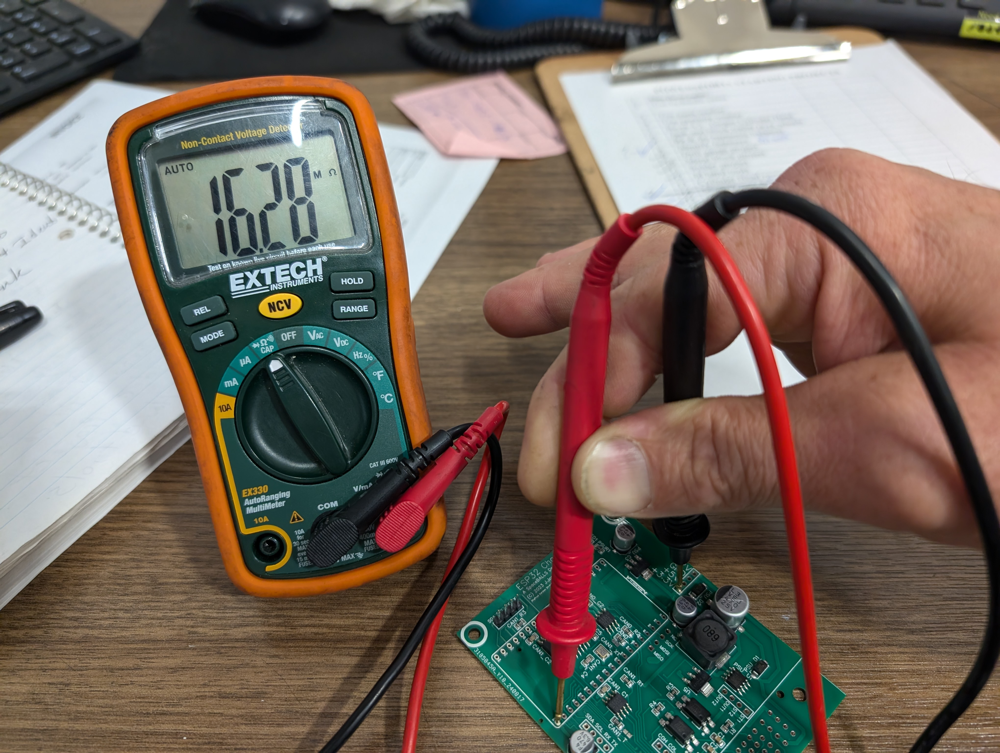

Hmm So I got most of the things to work on this. But the first problem I run into is my ESP 32 is too narrow. by about 4-5mm Anyone else run into this problem?
Edit. Now that I have the boards. I was able to see the older ESP32 uses a wider footprint. But you also need to make sure the pinout matches.
Yes you definitely need to check if the pinout is ok.Arlin wrote: ↑Fri Aug 30, 2024 12:08 am Hmm So I got most of the things to work on this. But the first problem I run into is my ESP 32 is too narrow. by about 4-5mm Anyone else run into this problem?
My design uses wider footprint and when i mount newer USB C equipped boards i need to bend both female headers inwards.

How is the ESP supposed to get power from the shield?
I see the pin for 5v is not connected and the 3.3 from the ESP to the 3.3v supply has 2k resistance
It powers up with a good USB cable to the ESP but even with my 100w wall plug for fast charging my phone the 5v on the ESP is only at 4.4v...

When you give the board the 12V supply the ESP32 gets 3.3v from the AMS1117
Thank you. So I run a jumper from the 3.3v regulator to the 3.3v pin on the ESP and it still didn't work.
I then tested a new unused board from the GitHub files and it doesn't have continuity from the 3.3v regulator to the pin on the ESP32.
