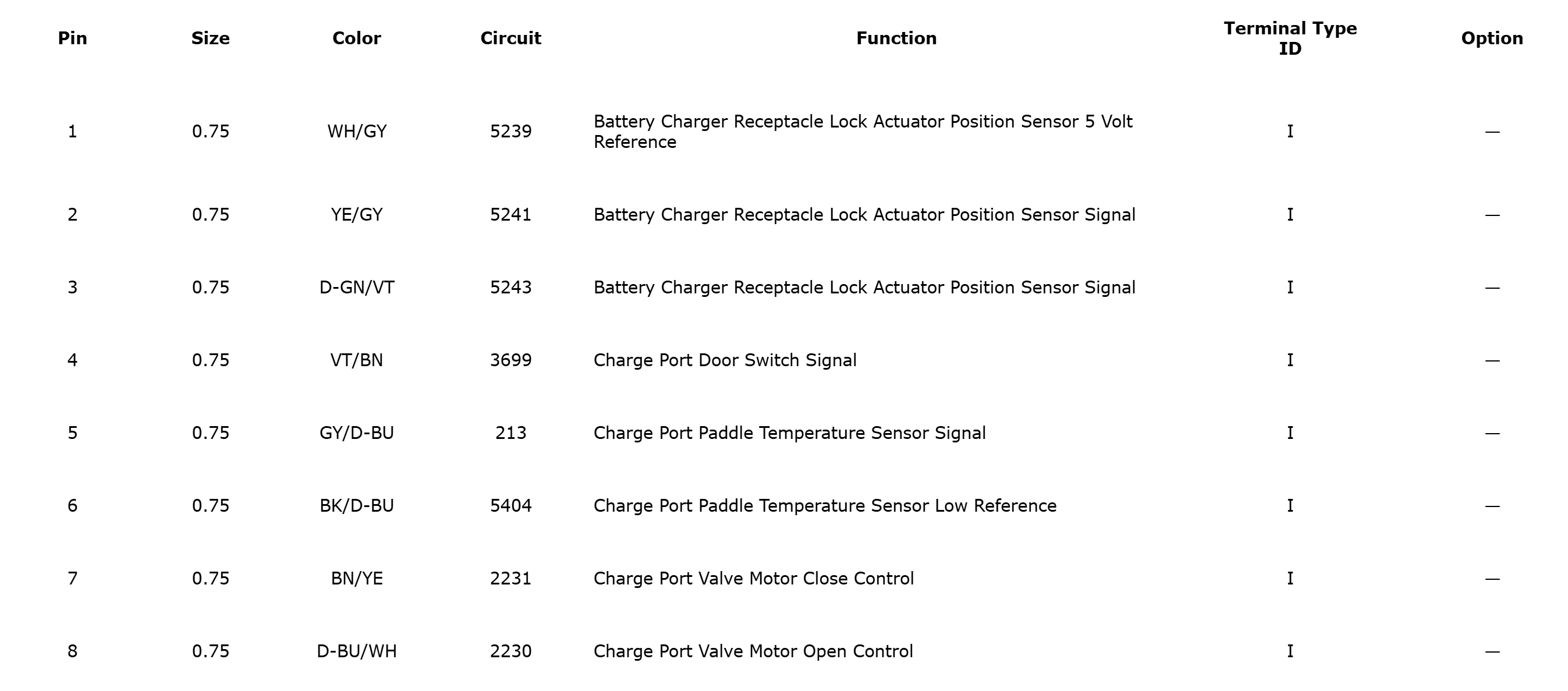

Ok, I think I posted this before but now don't see it, so I'll try again. I need some help with a wiring question.
I'm wiring up my FOCCCI board to my charge port (Chevy Bolt) and have a few questions regarding matching the Chevy pin descriptions to the FOCCCI descriptions.
Here is the pinout of the port: There are pins labeled "motor open control" and "motor closed control". Which should go to LOCK_MOT1 and which to LOCK_MOT2 ?
Will FOCCCI be ok with only a single temp sensor? And I presume the "Low reference" should go to ground, does that sound right?
The position sensor has a 5V reference. I presume I could use the FOCCCI 5V supply, since I'm getting voltage over CAN. Is that correct?
The port seems to have two position sensor wires. I'm thinking I just wire up one to FOCCCI?

Pick one and if it works the wrong way swap them.P.S.Mangelsdorf wrote: ↑Wed Sep 11, 2024 11:47 am There are pins labeled "motor open control" and "motor closed control". Which should go to LOCK_MOT1 and which to LOCK_MOT2
P.S.Mangelsdorf wrote: ↑Wed Sep 11, 2024 11:47 am The position sensor has a 5V reference. I presume I could use the FOCCCI 5V supply, since I'm getting voltage over CAN. Is that correct?
?!? The position sensor for foccci is pull to ground. wiki states this. So your lock position feedback must be resistive based.P.S.Mangelsdorf wrote: ↑Wed Sep 11, 2024 11:47 am The port seems to have two position sensor wires. I'm thinking I just wire up one to FOCCCI?
You know what sort of temp sensor is in the port? is it a PT1000?P.S.Mangelsdorf wrote: ↑Wed Sep 11, 2024 11:47 am Will FOCCCI be ok with only a single temp sensor? And I presume the "Low reference" should go to ground, does that sound right?

To avoid increasing time pressure before the race, you can omit the temp sensors, lock motor and lock feedback completely. Foccci will be happy. If you have more time, you can find out the characteristic of the temp sensor, and the polarity of the lock motor. Lowest prio is the lock feedback, because timebased actuation should be fine.

Thank you! Great to know, I was stressed about needing to tune this stuff and knowing it will work without is a relief. Obviously, I want it all working but knowing if something isn't it's not a dealbreaker is huge.uhi22 wrote: ↑Wed Sep 11, 2024 12:13 pm To avoid increasing time pressure before the race, you can omit the temp sensors, lock motor and lock feedback completely. Foccci will be happy. If you have more time, you can find out the characteristic of the temp sensor, and the polarity of the lock motor. Lowest prio is the lock feedback, because timebased actuation should be fine.
Ok cool. I also just saw the option in settings to do the swap there.
Missed that in the wiki. I'll play around with what I have. If the latch sensor is similar to the port door, it's an open circuit in one position and provides a resistance in the other, so I may just be able to give "5V reference" ground, and then the latch would pull to ground. Will experiment if I have a chance, but from uhi's post, I may just run w/o it for now.
I do not know; I went with this port as it has the AC connector I need that is unobtainium otherwise.

If the port has DCFC it will have dedicated PT1000sor something for a thermistor per pin. Do you have a part number or some pictures?P.S.Mangelsdorf wrote: ↑Wed Sep 11, 2024 2:56 pm I do not know; I went with this port as it has the AC connector I need that is unobtainium otherwise.
I would always use a lock, never want it being pulled out under power by some unaware bystander or yourself when your tired.

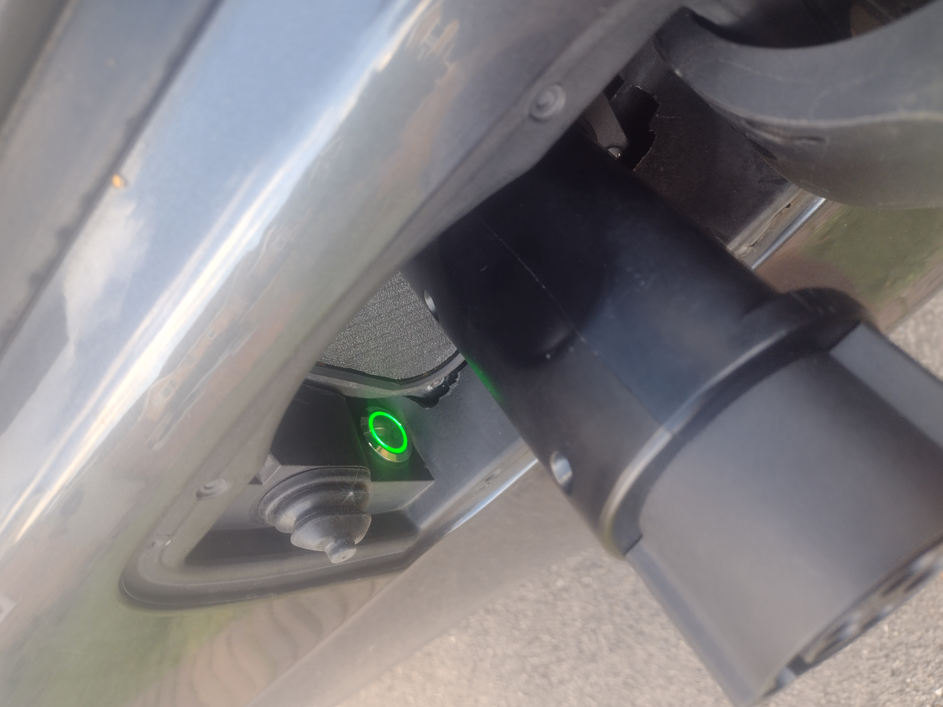

It is running on my E91, it's working great for AC charging. Not got to DC yet, not wired up yet.
The zombie auto config worked a treat too.
Unlock inhibit when the car is locked is great for when I'm charging in public.
Not too keen on the rapid flashing green to mean charging, maybe a bit slower would give less 'error vibes'

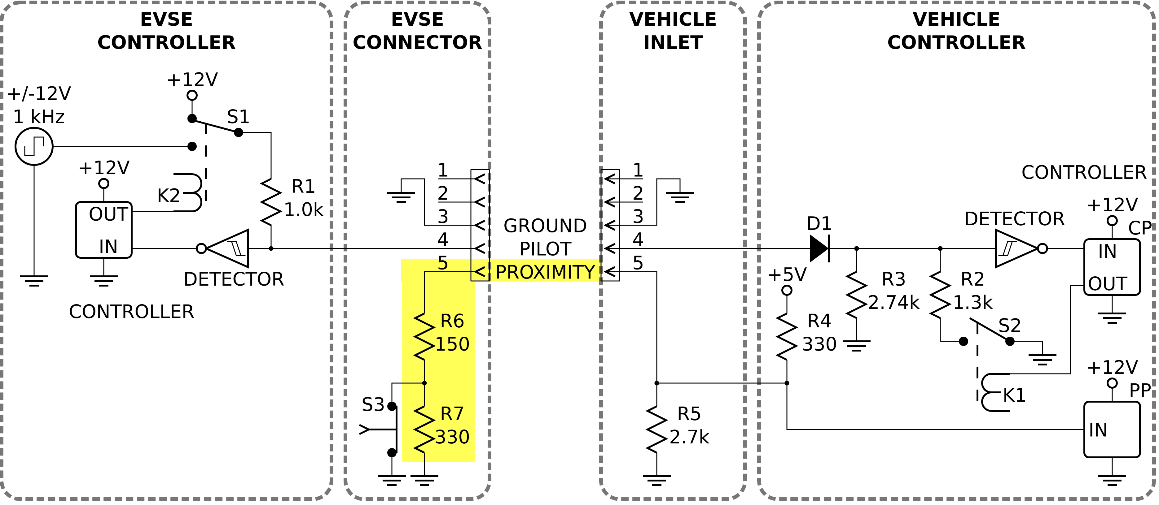

I don't know how to put this to not sound quite wild, but... I'm pretty sure the Kempower charger I mostly test my car at doesn't connect PP, either at all or at least not during the actual charging session.
Due to this, the current PlugPresent value is useless as it stays at 0.
I just tested with a resistor connected between PP and PE that my foccci is reading the value. Well, it's reading the 150 ohm resistor as something around 500 ohms (ResistanceProxPilot), but that's fine enough for me.
The problem is, at the charger, while charging, PlugPresent stays at 0 and that's because ResistanceProxPilot is 10k which is the highest it will go.
Soo... I would prefer not to dvelve any deeper into this and propose setting the PlugPresent value also, using an || (OR) conditional, based on opmode or LockState or something like that which actually will surely stay active when the communication link is up. I did not record the beginning of the charging session so I don't know how exactly it begins and whether PP is ever activated by the charger.
I did some grepping on previous logs, and I can see that foccci is in opmode=CurrentDemand at lots of times when ResistanceProxPilot=10k. When grepping for which checkpoint has been active during ResistanceProxPilot=10k, I get this, which also indicates charging has happened during those times at multiple occasions:
I can see similar things in the Omega's logs (these are from the Previa). However, the Omega still is much more work-in-progress so I haven't been worrying about it there.

From my understanding the PP resistor of 1k5 shall be in the plug, without the possibility to deactivate this. It would be quite dangerous if the plug is in but the vehicle does not see it. Could you check at the plug with a multimeter? I've never seen other values than 1k5 on public chargers.
We need to find out and fix, that you get 500 ohms when you connect 150 ohms. Maybe the same issue causes the 1k5 to be interpreted as >5k. (The 5k I defined as threshold for the PlugPresent detection.)

I hate to keep dragging this image up from the J1772 Wikipedia article, but . . . 480 ohms seems correct for the iteration they supplied.uhi22 wrote: ↑Wed Oct 02, 2024 7:20 pm From my understanding the PP resistor of 1k5 shall be in the plug, without the possibility to deactivate this. It would be quite dangerous if the plug is in but the vehicle does not see it. Could you check at the plug with a multimeter? I've never seen other values than 1k5 on public chargers.
Perhaps this is another regional difference? If so, I'd love someone with a cite-able reference to update that Wiki article.
- uhi22
- Posts: 1117
- Has thanked: 206 times
- Been thanked: 617 times
Re: QCA7000 Foccci+Clara User thread
This is the type1 (US) version with the button. Celeron is Europe, type2, 1k5, no button.
Edit: The differences between CCS types 1 and 2 are shown in the diagrams in the LIM Wiki https://openinverter.org/wiki/BMW_I3_Fa ... ng_circuit
