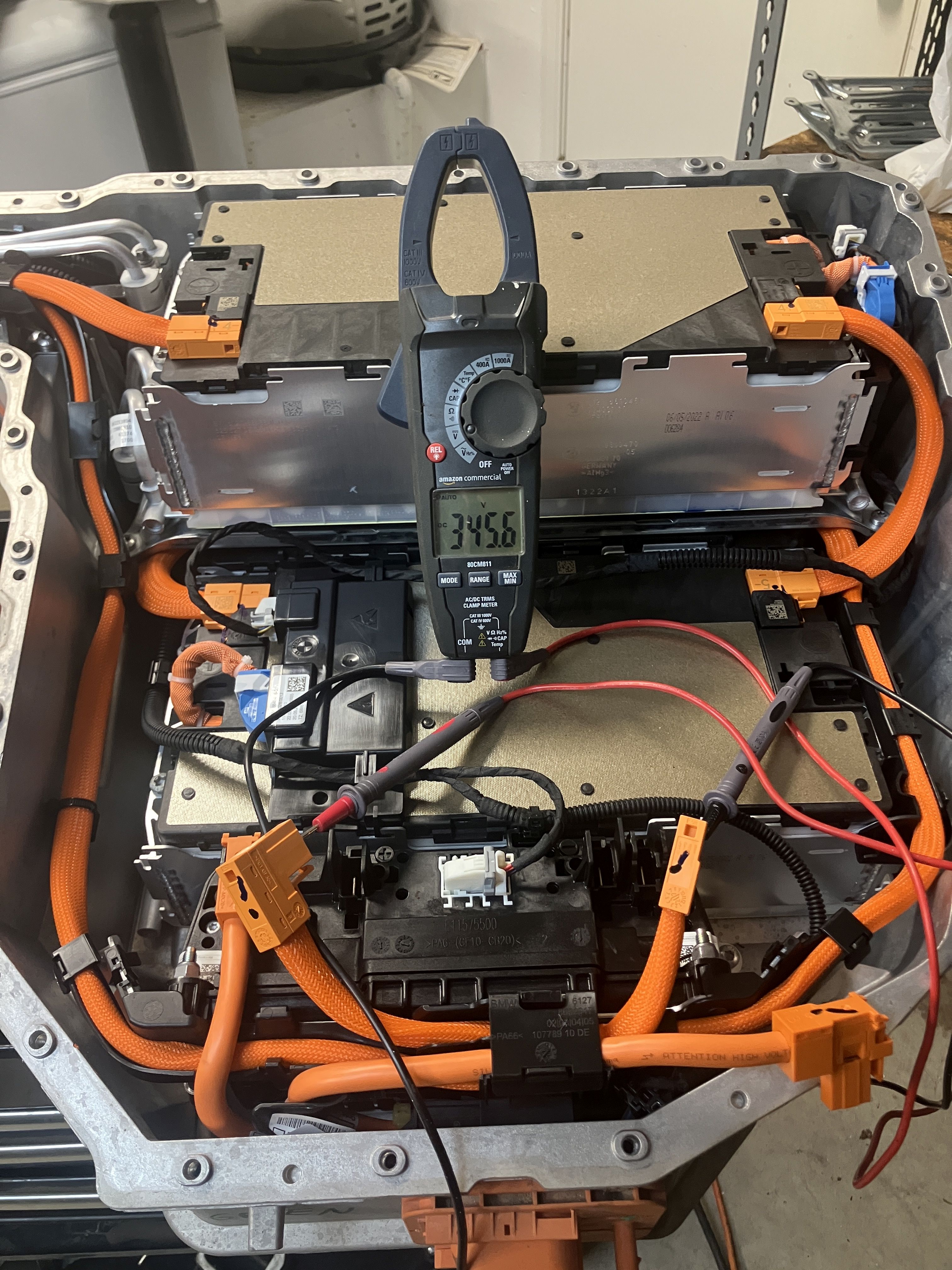

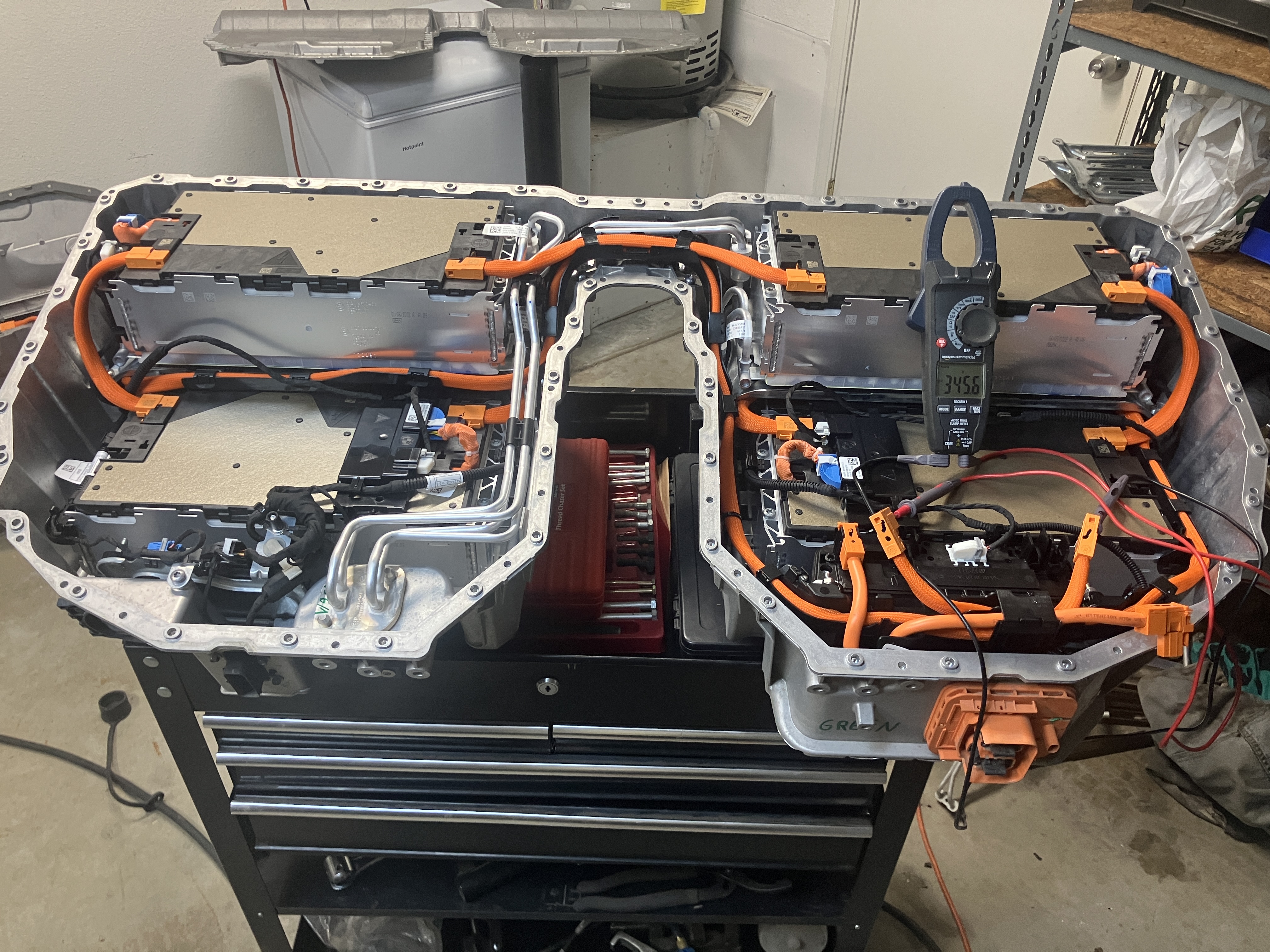

BMW 530e 12 kWh Battery Pack Voltage Reading
Gregski
Posts: 2685
Has thanked: 493 times
Been thanked: 909 times
Post by Gregski »

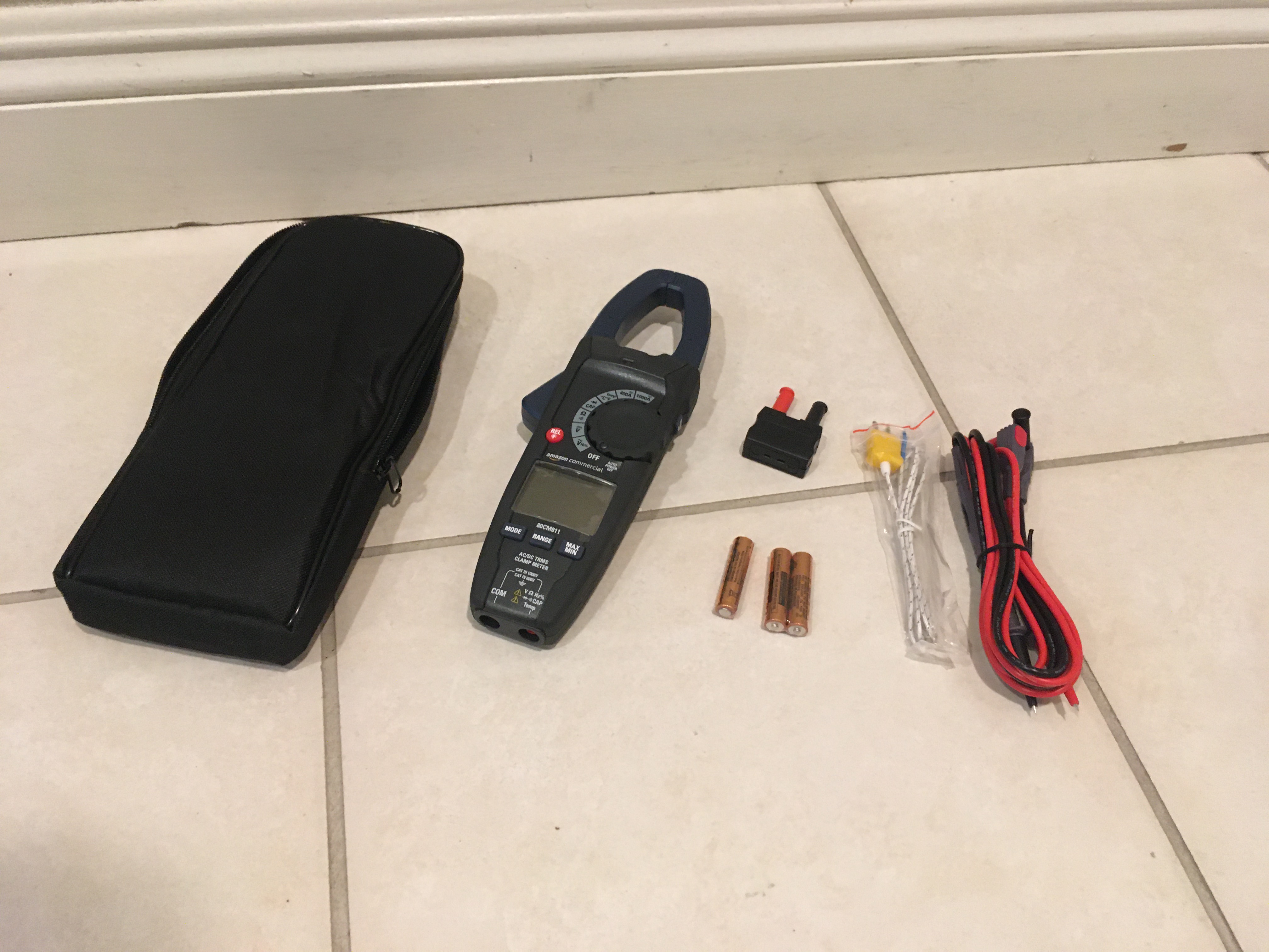

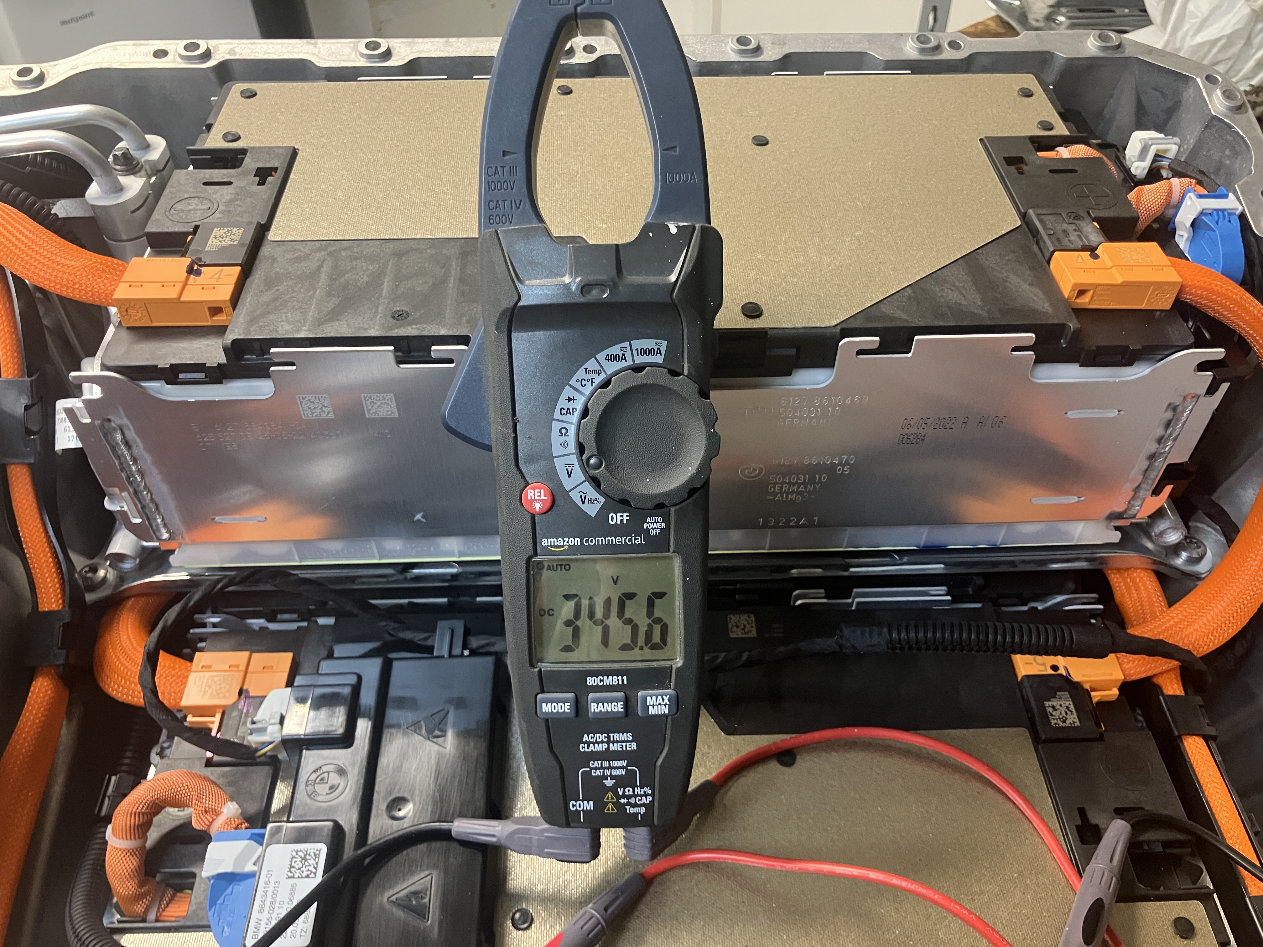

Literally Nobody: So what's that Clamp Meter you're using?
Me: well it's like a Fluke Meter for a third of the price, ie $68 bucks when I got it in 2021
Zieg
Posts: 339
Has thanked: 142 times
Been thanked: 138 times
Post by Zieg »
I... Was actually wondering that while watching the video, haha. How does it do with dc currents over a few dozen amps?

Post by Gregski »
Zieg wrote: Sun Sep 22, 2024 12:36 pm I... Was actually wondering that while watching the video, haha. How does it do with dc currents over a few dozen amps?
not sure how I would measure that as I would have to mount it under the hood of the car between the safety box and the inverter and go for a spin, no? so far I just used it to confirm things like is the Chevy Volt onboard charger charging as well as the Mitsubishi Outlander onboard charger charging, but that was 15 amps or less
same goes for this Tesla Model S second gen battery charger gitty up (though it looks like it's doing a whole lotta good on the table over there, ha ha)

Post by Gregski »
alright guys I took the lid off of the second pack aka the Mean Green pack and took a voltage reading of that one: 345.6 volts
so it appears they are within one volt of each other, so word on the street is we're lookin' pretty good and should be able to connect them positive lead to positive lead and negative lead to negative lead and let them balance each other out using gravity and prayer

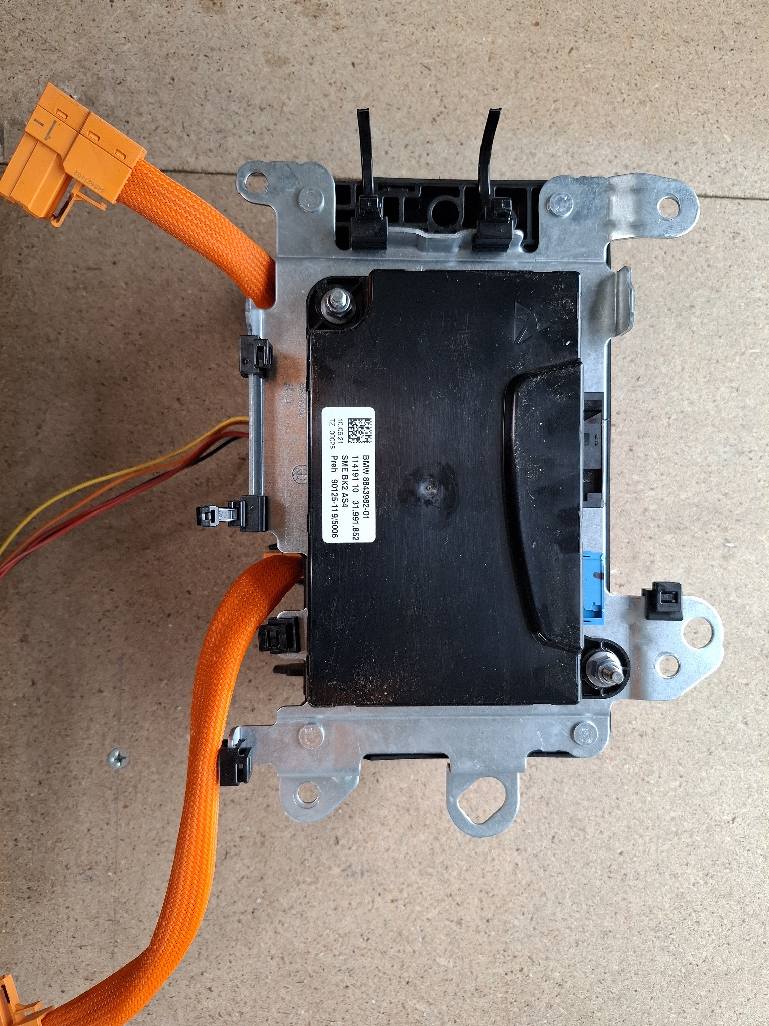

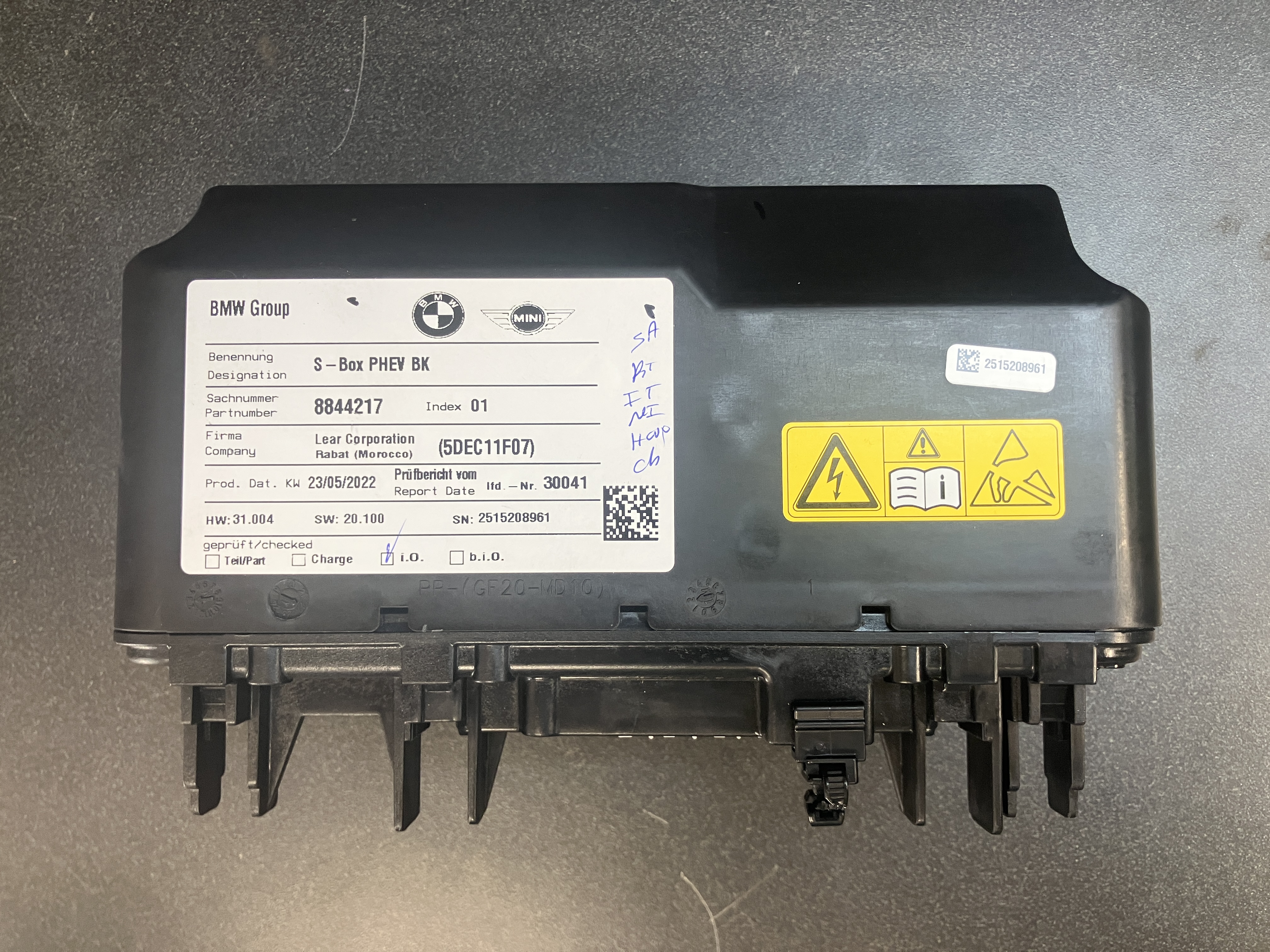

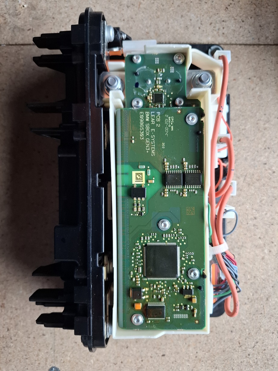

well, I decided to yank the Safety Box first to satisfy my component curiosity
BMW 530e SP41 Safety Box Teardown
Gregski
Posts: 2685
Post by Gregski »

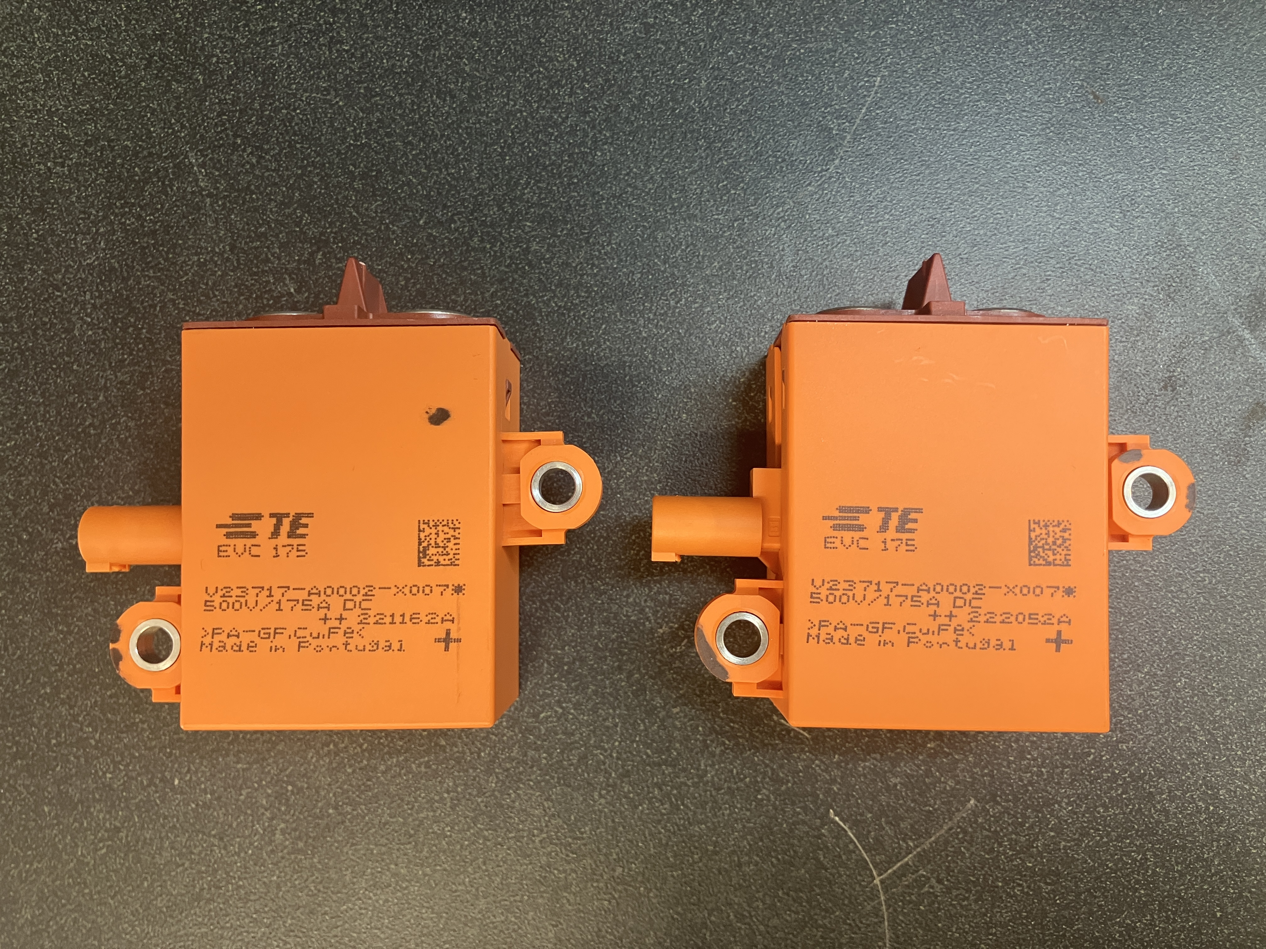

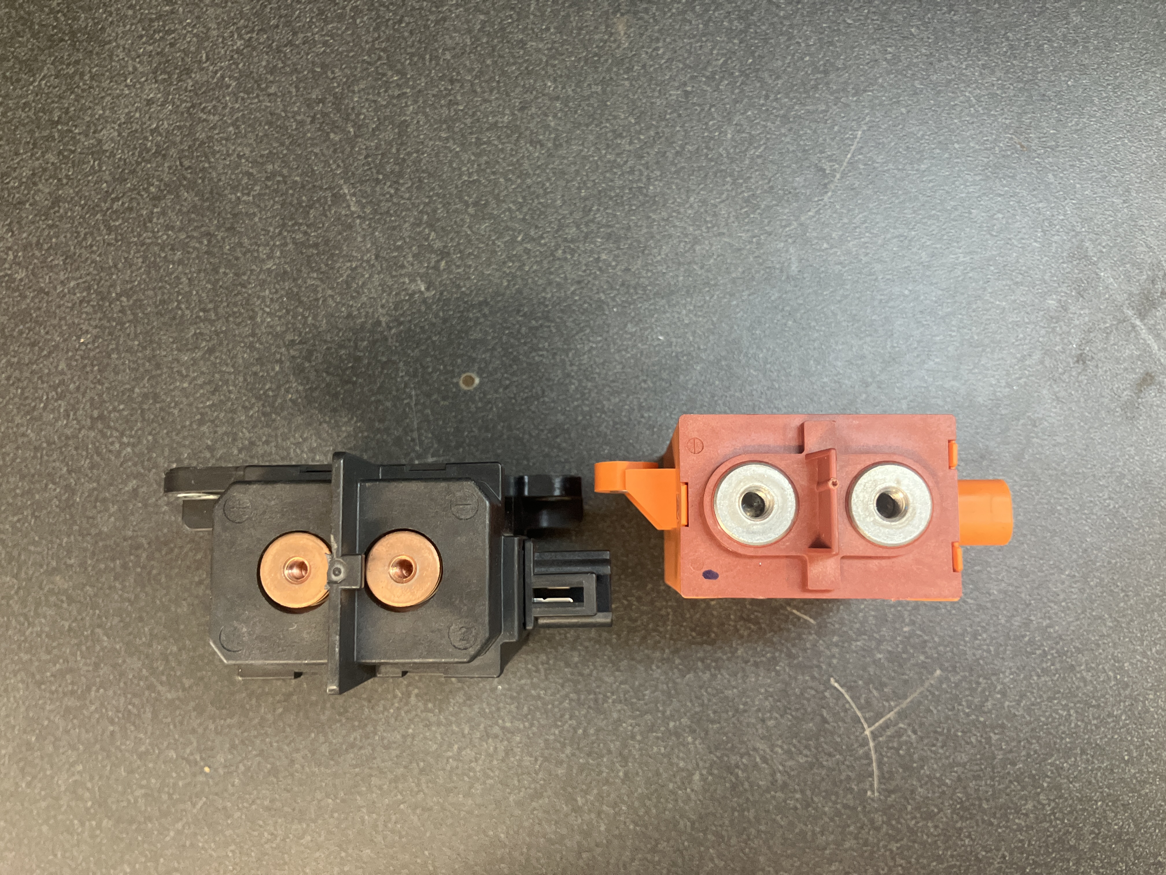

so let's meet the components
orange you glad I extracted these?

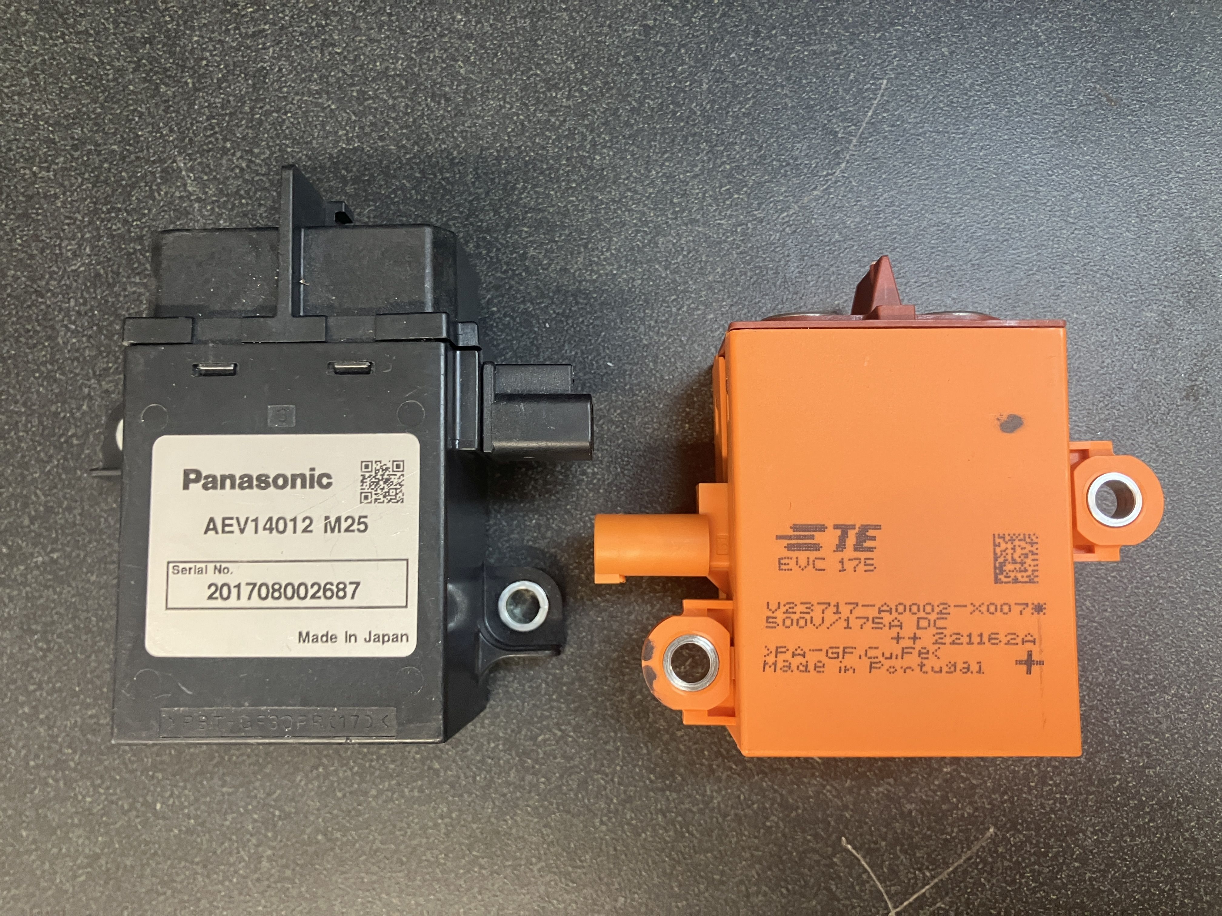

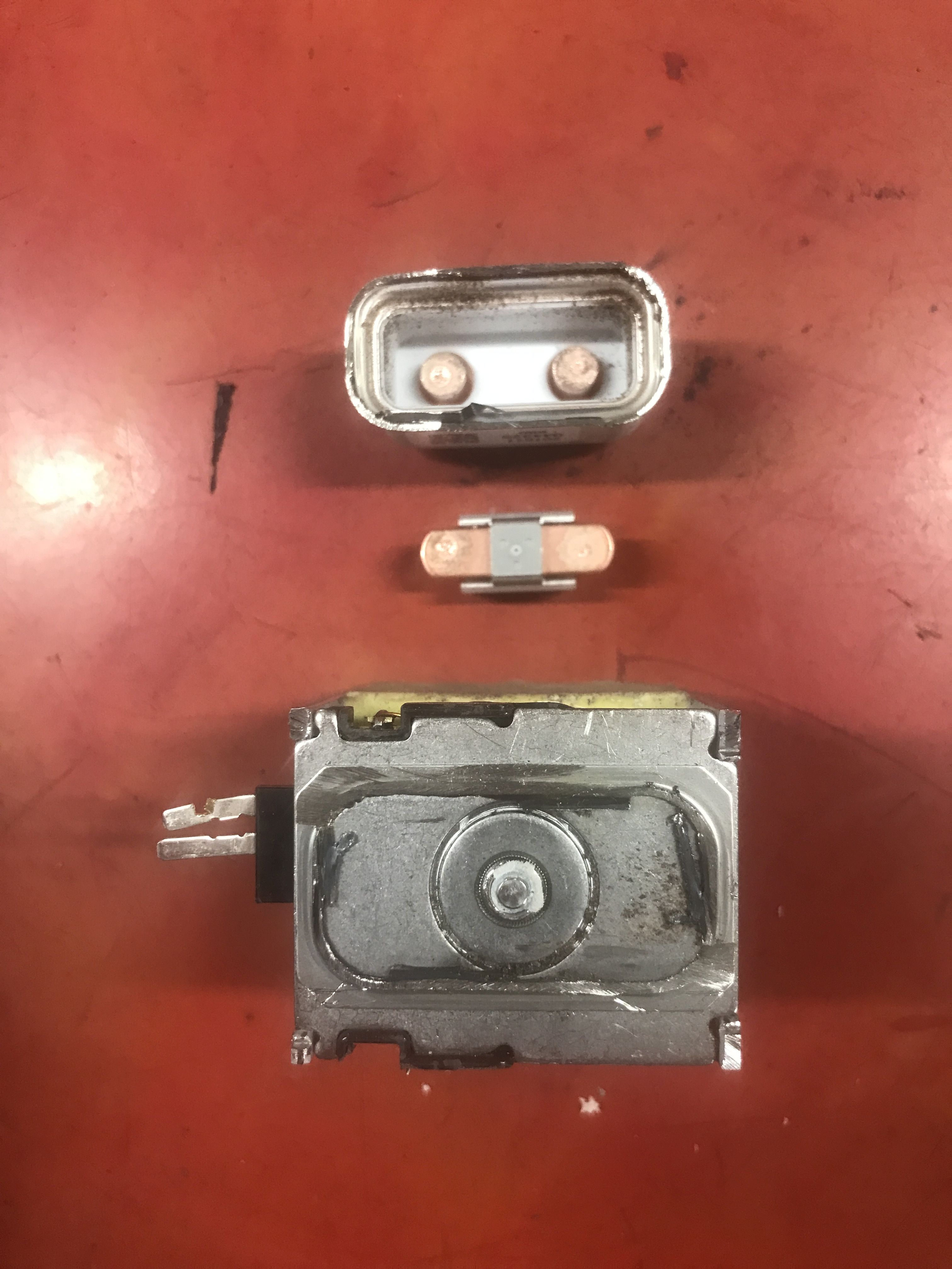

somebody explain to me how can these contactors be rated for 175 amps and the fuse in that pack is rated at 350 amps, and I know our friend Artur can pull well above 250 amps out of these packs
V23717-A0002-X007
500 Volts 174 Amps DC
Made in Portugal
ENG_DS_V23717-X0000-A001_A.pdf
(1.13 MiB) Downloaded 446 times
Gregski
Posts: 2685
Post by Gregski »

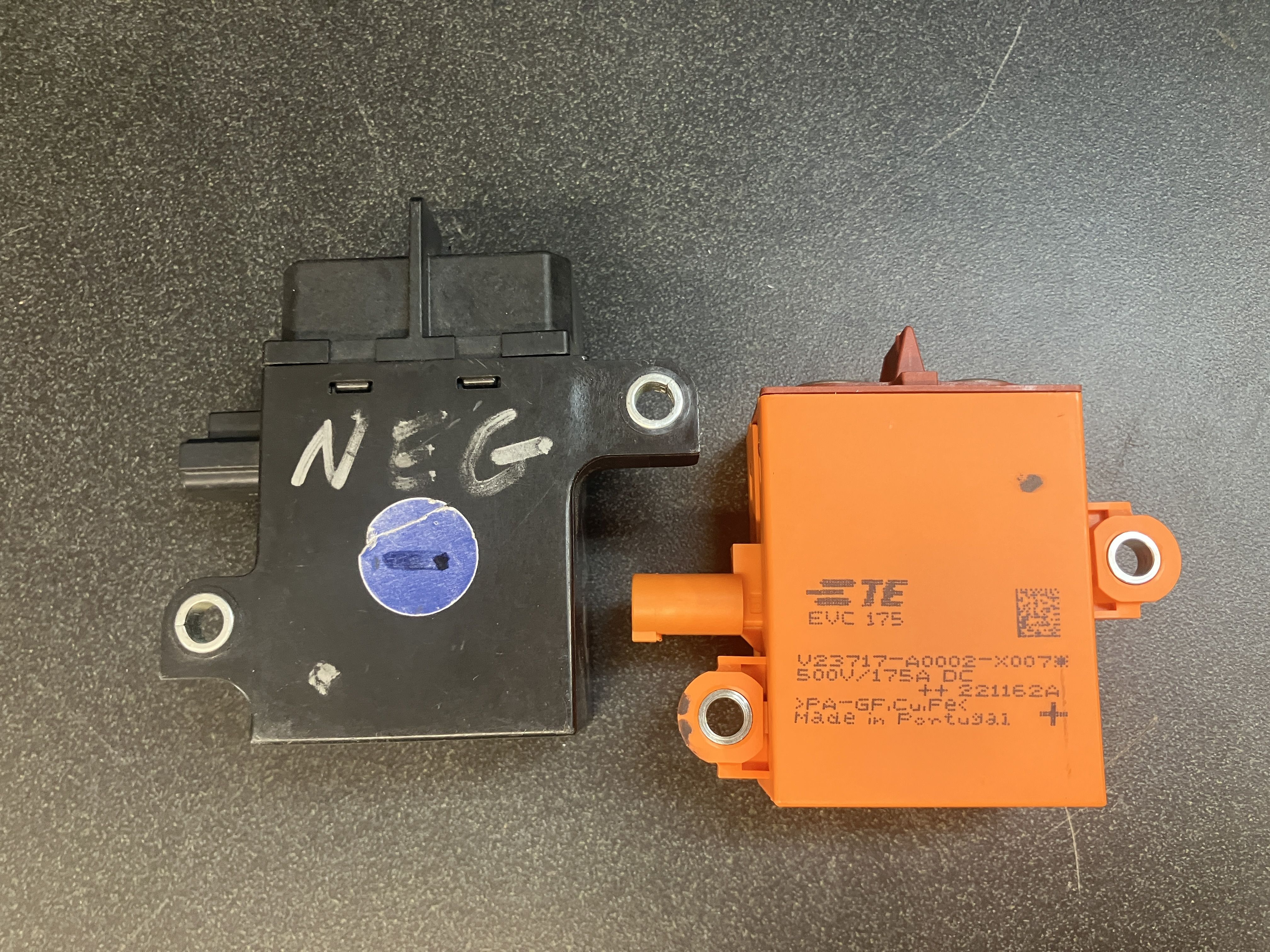

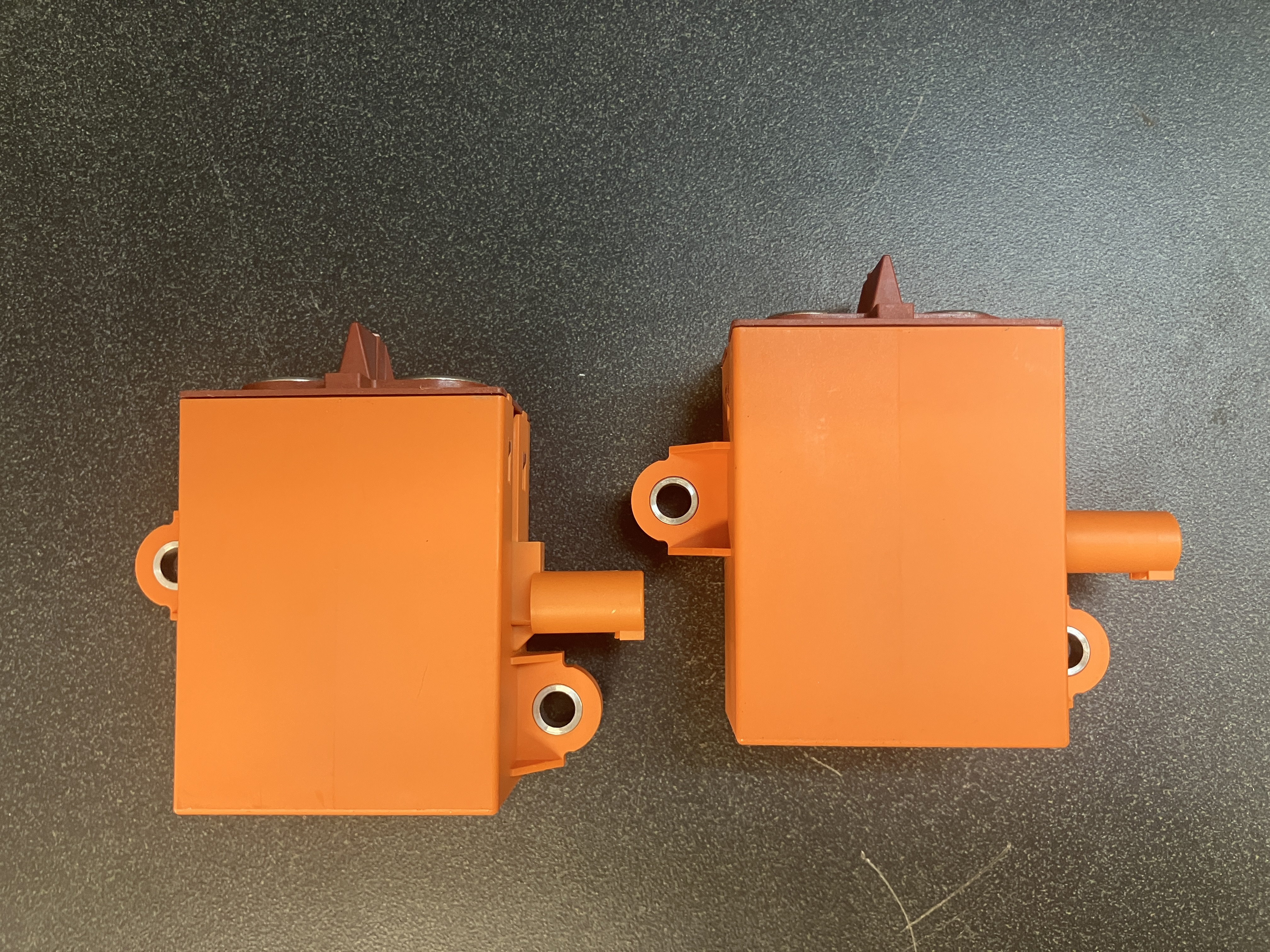

mandatory stare and compare of the old SP06 and the new SP41 contactors
so here is a side by side look at the markings aka labels
note these were not labeled on the same side, so here they are properly positioned side by side they way they would be mounted in the sBox aka belly up
and here are their back sides, (I hope this makes sense)

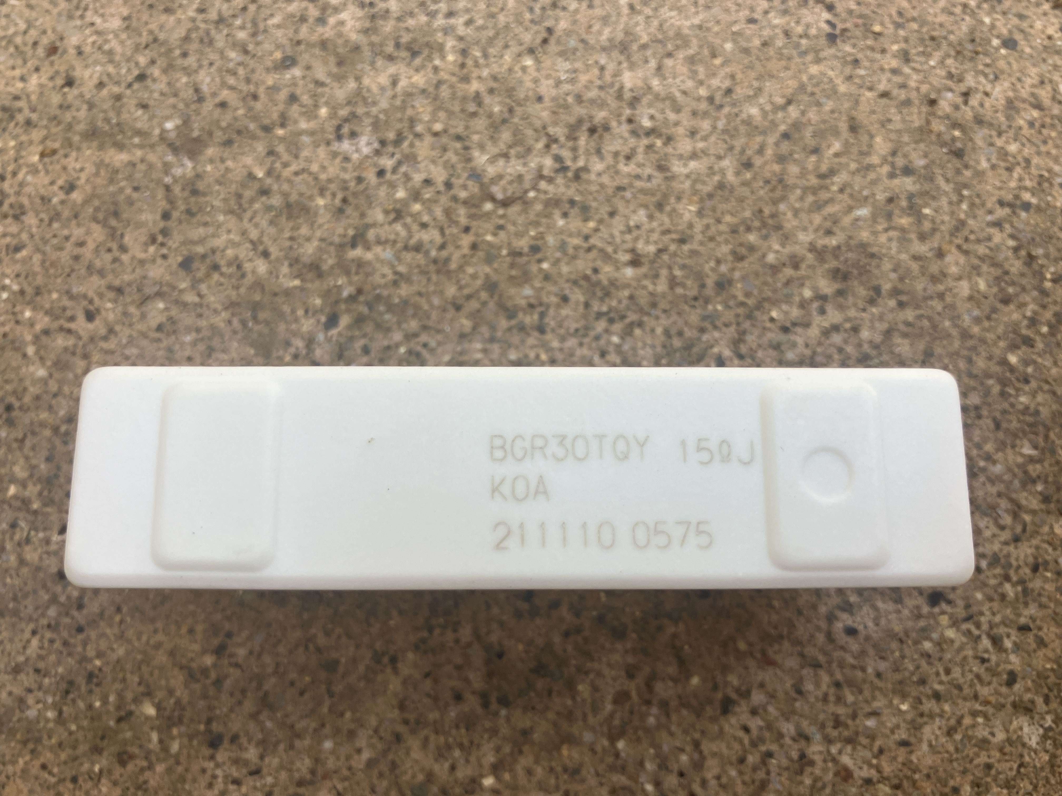

and here is the 30 watt 15 ohm resistor
BGR30TQY 15ΩJ
K0A
211110 0575
Posts: 2293
Location: Bristol
Has thanked: 199 times
Been thanked: 524 times
Gregski wrote: Wed Sep 25, 2024 4:46 pm somebody explain to me how can these contactors be rated for 175 amps and the fuse in that pack is rated at 350 amps, and I know our friend Artur can pull well above 250 amps out of these packs
So the fuse is 350A, no idea why seems excessive to me also given the cables under the car are not beefy.
The contactors are rated for 175A continuous, I would be careful pulling alot more for minutes at a time. The older Panasonic contactors love to weld stuck.
I do not know is anyone has ran a GS450h or Tesla drive unit with the stock Gen 2 Sbox and had any contactor issues. I would take care to monitor them.
Gregski
Posts: 2685
Post by Gregski »
tom91 wrote: Wed Sep 25, 2024 6:31 pm So the fuse is 350A, no idea why seems excessive to me also given the cables under the car are not beefy.
FACTS !!!

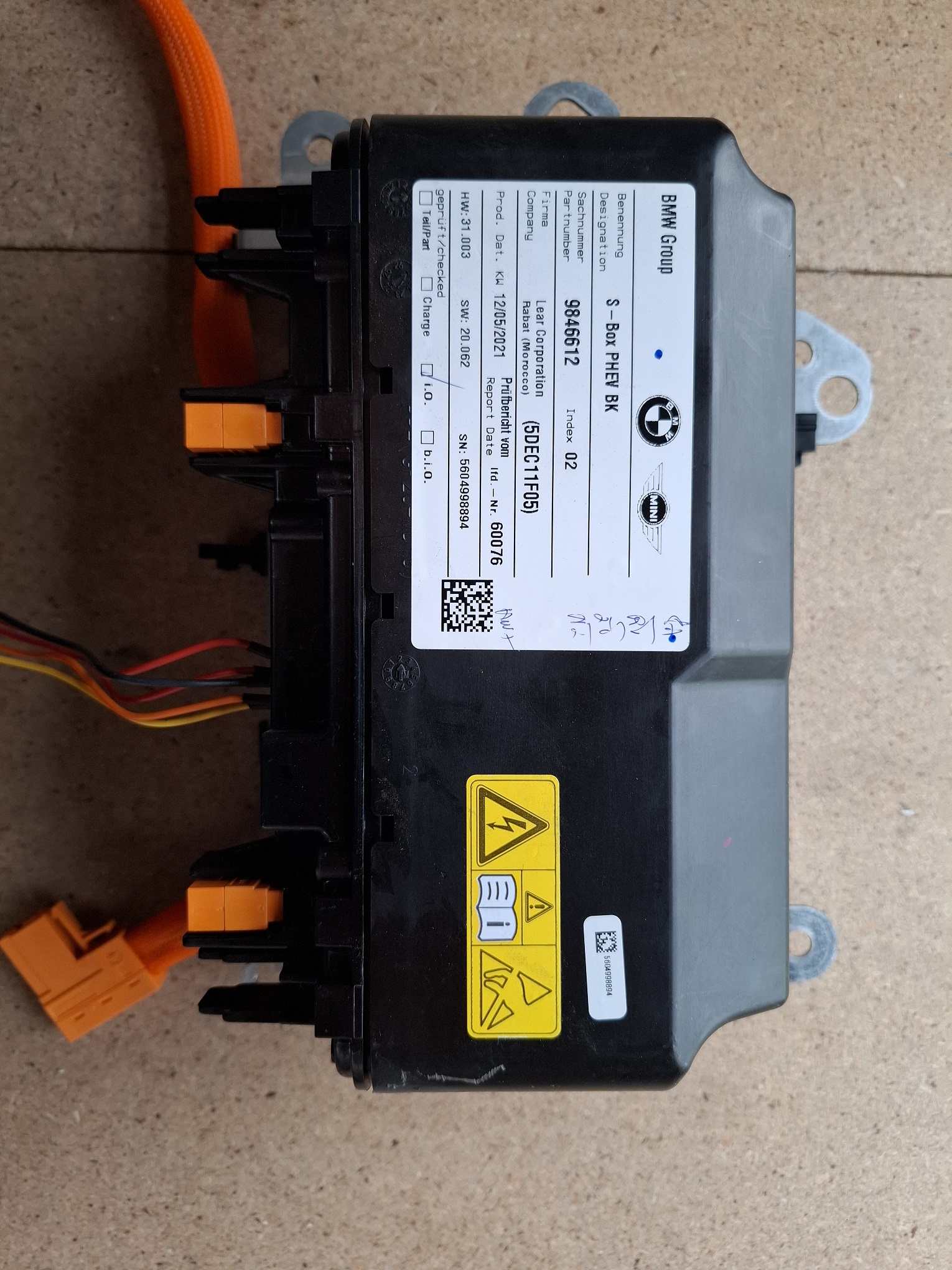

BMW X5 SP44 24kWh Safety Box
For comparison, the SP44 (24kWh, 12 modules, 8S2P) S-box components vs the SP41 above, same component specs:
Gregski
Posts: 2685
Post by Gregski »
nkiernan wrote: Fri Sep 27, 2024 6:28 pm BMW X5 SP44 24kWh Safety Box
thanks dude, finally got a chance to Googletize this beast and though I would share, it's a 2024 model year, so it may take a few rainy days for the soccer moms to get into some fender benders before we see these hit the wrecking yards
