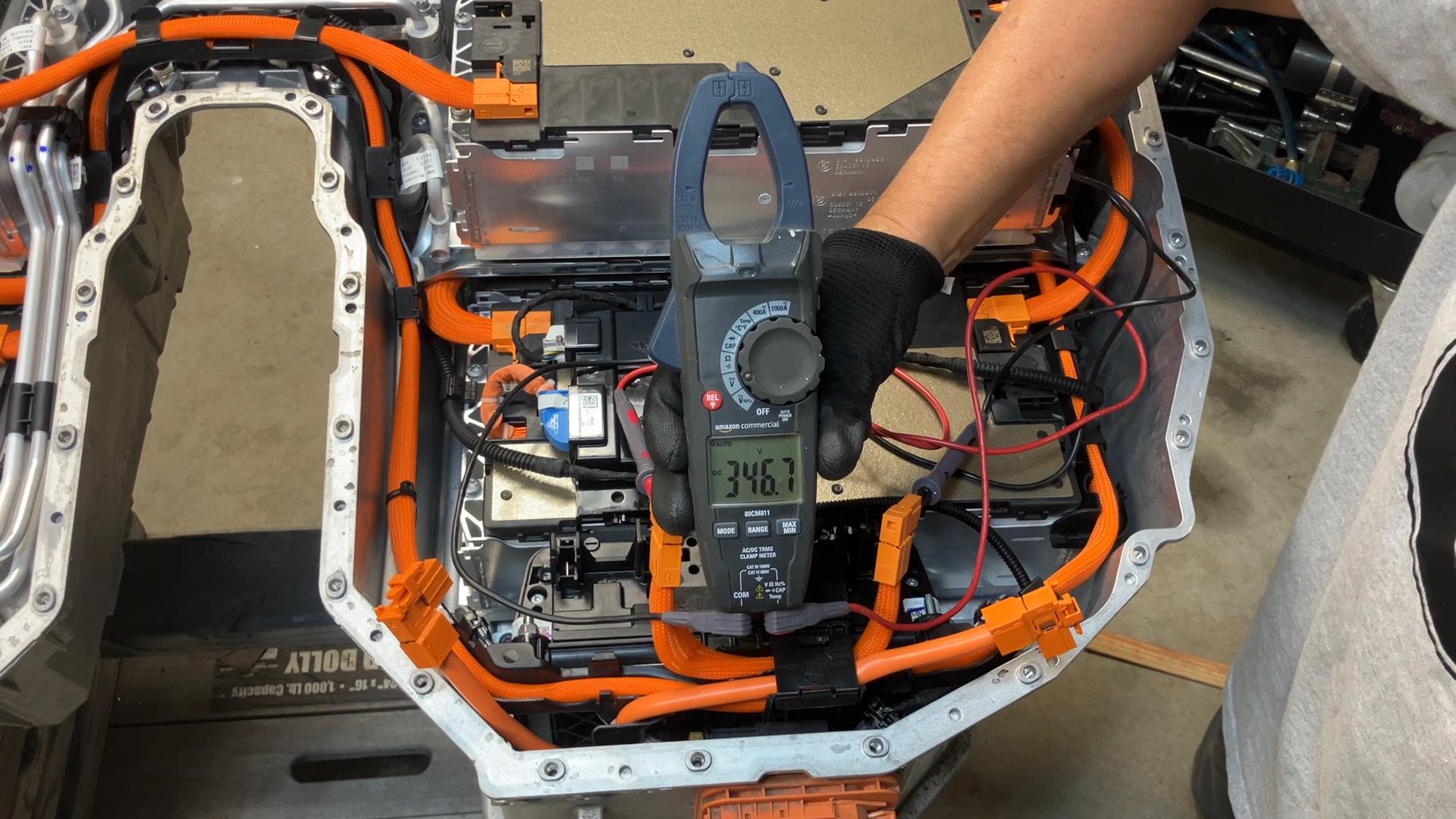

BMW 530e 12 kWh Battery Pack Voltage Reading
Gregski
Posts: 2743
Has thanked: 500 times
Been thanked: 951 times
Post by Gregski »
Literally Nobody: So what's that Clamp Meter you're using?
Me: well it's like a Fluke Meter for a third of the price, ie $68 bucks when I got it in 2021

alright guys I took the lid off of the second pack aka the Mean Green pack and took a voltage reading of that one: 345.6 volts
so it appears they are within one volt of each other, so word on the street is we're lookin' pretty good and should be able to connect them positive lead to positive lead and negative lead to negative lead and let them balance each other out using gravity and prayer

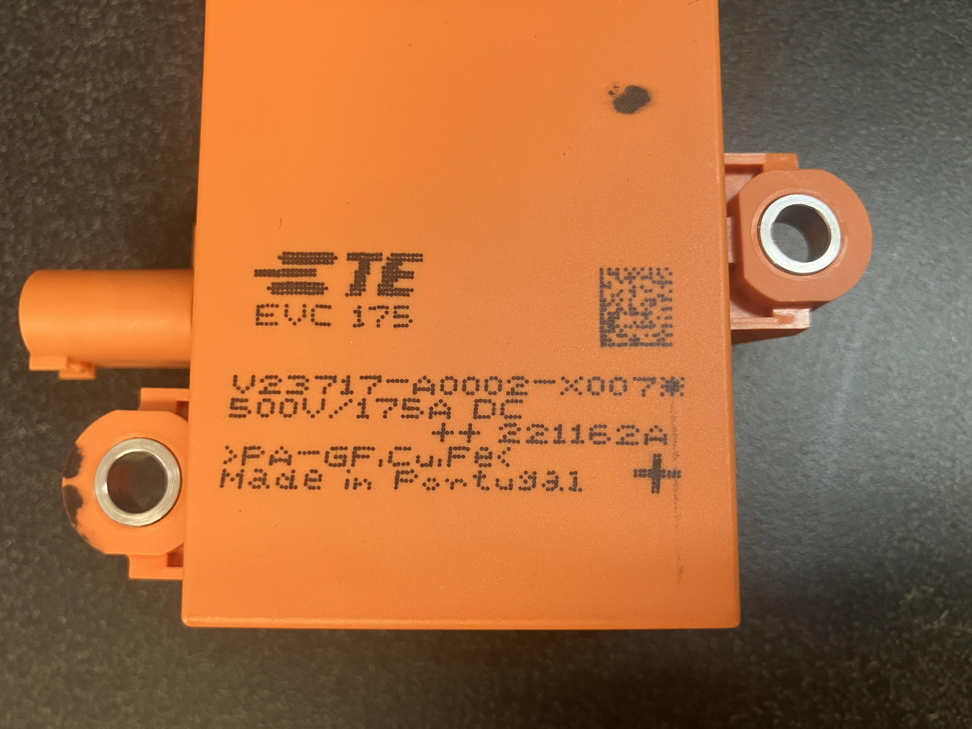

so let's meet the components
orange you glad I extracted these?
somebody explain to me how can these contactors be rated for 175 amps and the fuse in that pack is rated at 350 amps, and I know our friend Artur can pull well above 250 amps out of these packs
V23717-A0002-X007
500 Volts 174 Amps DC
Made in Portugal
ENG_DS_V23717-X0000-A001_A.pdf
(1.13 MiB) Downloaded 593 times

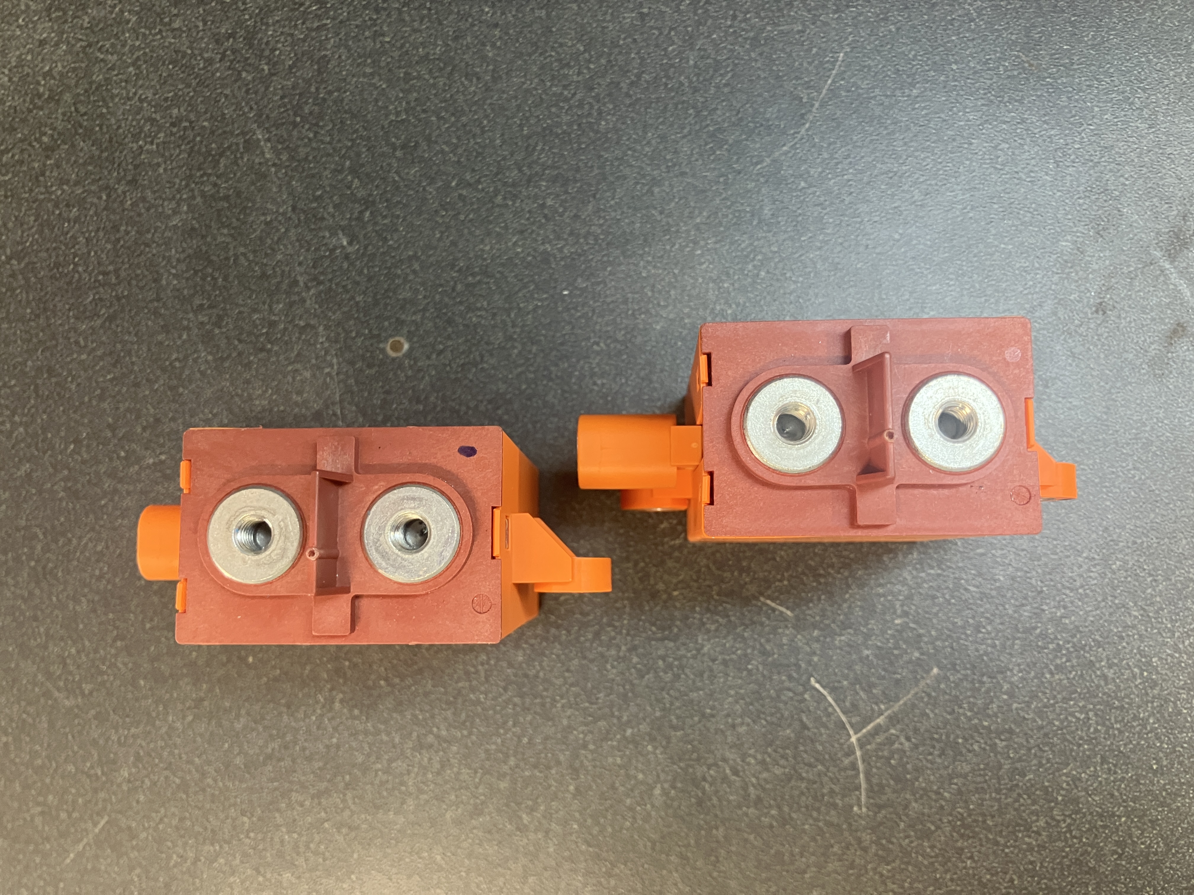

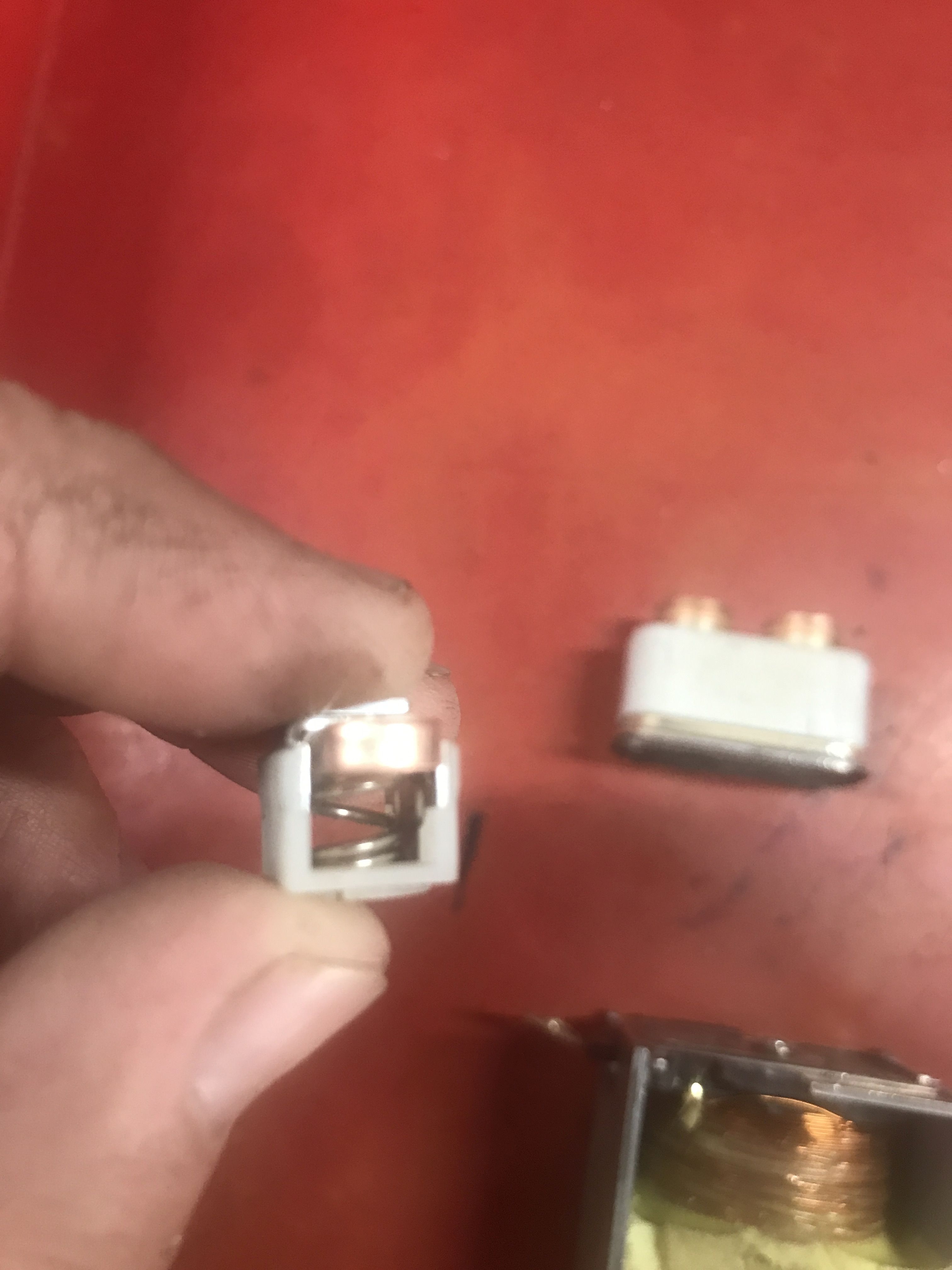

mandatory stare and compare of the old SP06 and the new SP41 contactors
so here is a side by side look at the markings aka labels
note these were not labeled on the same side, so here they are properly positioned side by side they way they would be mounted in the sBox aka belly up
and here are their back sides, (I hope this makes sense)

Posts: 2428
Location: Bristol
Has thanked: 210 times
Been thanked: 588 times
Gregski wrote: Wed Sep 25, 2024 4:46 pm somebody explain to me how can these contactors be rated for 175 amps and the fuse in that pack is rated at 350 amps, and I know our friend Artur can pull well above 250 amps out of these packs
So the fuse is 350A, no idea why seems excessive to me also given the cables under the car are not beefy.
The contactors are rated for 175A continuous, I would be careful pulling alot more for minutes at a time. The older Panasonic contactors love to weld stuck.
I do not know is anyone has ran a GS450h or Tesla drive unit with the stock Gen 2 Sbox and had any contactor issues. I would take care to monitor them.

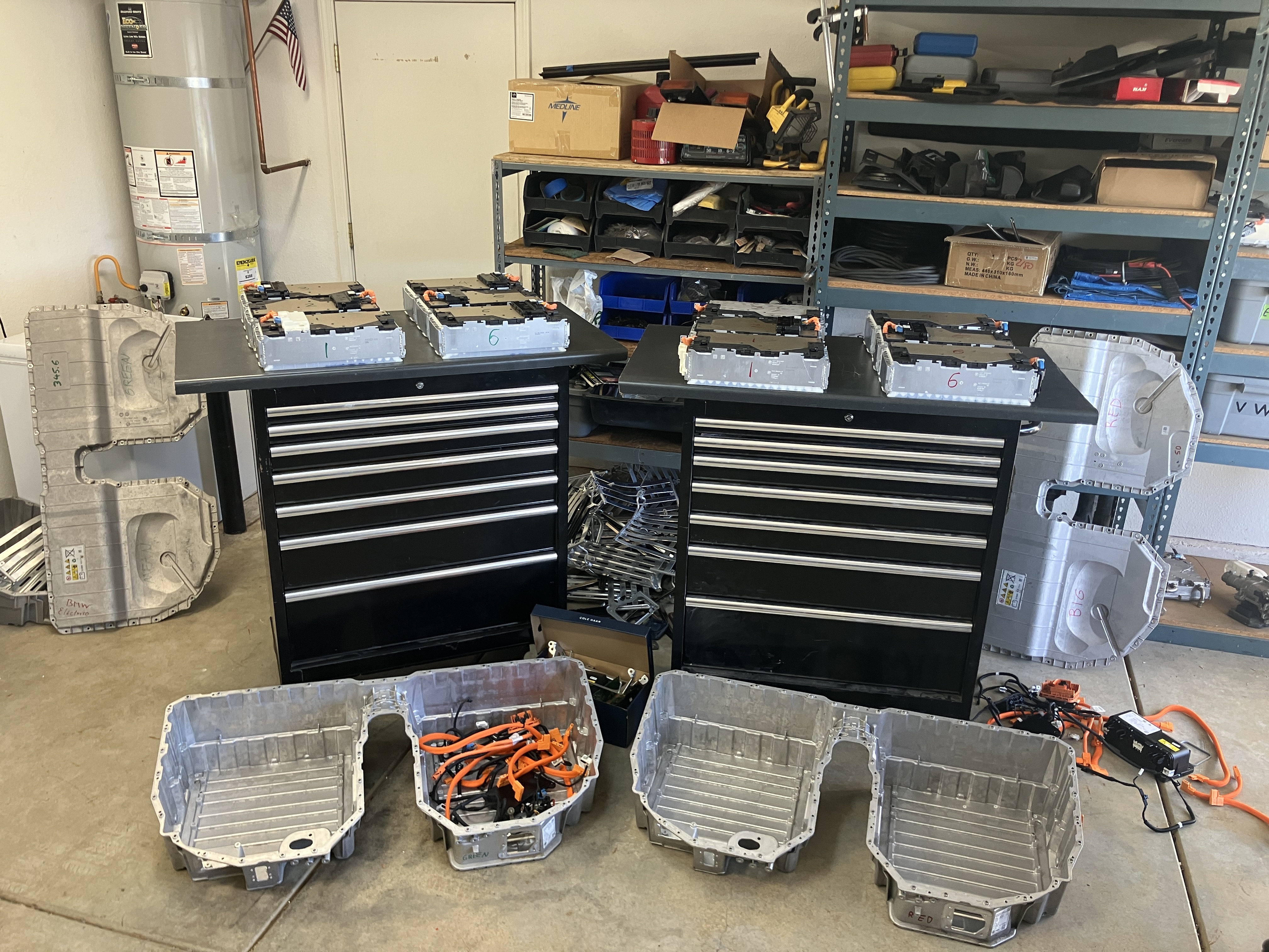

Post by Gregski »
progress is slow, yet deliberate
we managed to get both BMW 530e SP41 12kWh battery packs stripped down (aka the newer generation)
these two will replace the single BMW 530e SP06 9kWh battery pack that is in there now (aka the older generation)
