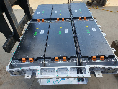

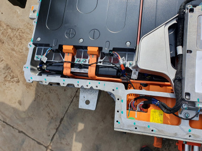

I'm sharing information about the MG5 LR battery I used in energy storage projects.
The 61kWh battery has a 96S1P configuration and uses giant 174Ah NMC cells from CATL.
The cells are arranged into six modules with two 8S groups.

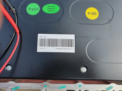

Marking on the battery module:

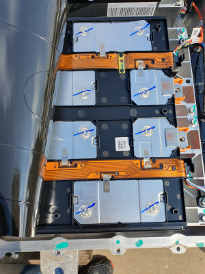

Arrangement on the cell's group:
Each block has a BMS module:

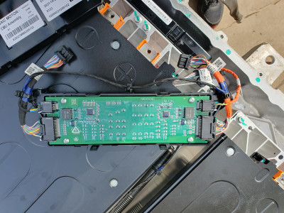

Inside BMS module:
The BMS has two sections for monitoring each 8S cell. It's based on ADBMS6815, a new-generation BMS chip from ADI. It can monitor up to 12S cells.
Unfortunately, it is under NDA, and the full datasheet isn't available to the public. I think this chip is the successor to the popular LTC6811.

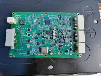

A picture of the primary BMS:
It uses LTC6820 for ISO-SPI communication with slave BMSs.
I was able to reuse the slave BMS modules; more on that in the following posts.

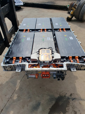

And finally, here is a picture of the battery without electronics and cables:

I have used the slave BMS modules and can help in this direction. But this will require some programming.
The ADBMS6815 is under NDA, which complicates the situation. Unfortunately, I cannot share the full datasheet.
My approach was to start with the code for LTC6811 and modify the code to work with ADBMS6815:
https://github.com/analogdevicesinc/Lin ... es/LTC6811
I'm using custom hardware based on STM32G491 MCU.
Also, I've searched the Github and found this:
https://github.com/526766987/Battery_Ma ... tem_36cell
It's based on STM32F407 + ADBMS6815 - I didn't test this, but it looks like a good starting point.
So, what hardware platform are you planning to use? You will need a LTC6820 for iso-spi communication.

We have gone a completely different route.
The battery hasn't been opened, we have got it to start up on the bench by playing various CAN logs to it. We just need to keep distilling down now until we can write a basic sketch for an ESP32 or maybe add it to the Battery Emulator Project.
We have got a V2L charger from an MG5 so the ultimate plan now is an off grid setup using the charger as an inverter.
