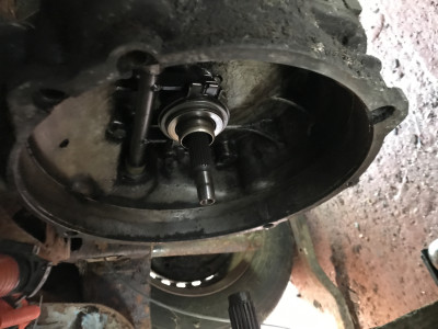

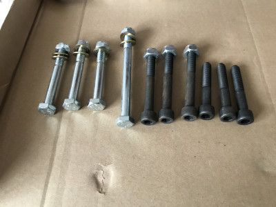

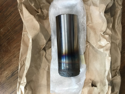

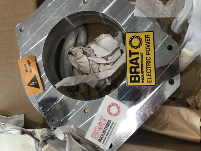

So it’s been a long frustrating summer of no action. Mainly because I watched the courier tracking of my adaptors and couplers coming over from Canada, landing in Coventry… before UK customs decided to post it back to sender… aargh.
Then had to wait for it to get re delivered, which it finally did a couple days ago.
What can I say, sh!t happens I guess.
Then main thing is the stuff looks good quality. I asked Brat to also weld my clutch centre to his standard issue Leaf coupler to make the finished item as I had no luck with local metal workshops in my area.
So I’ve started sizing things up, which I’ll add in separate posts…

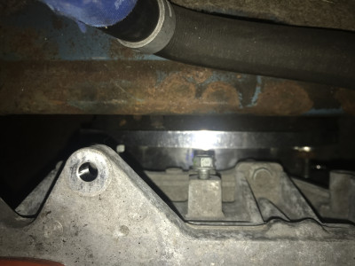

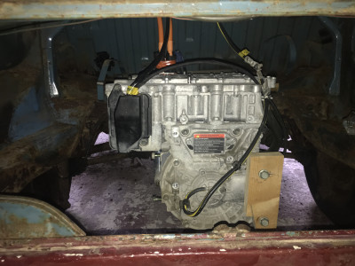

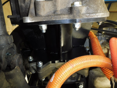

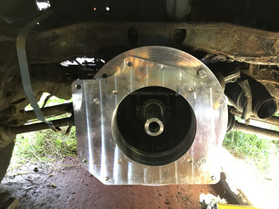

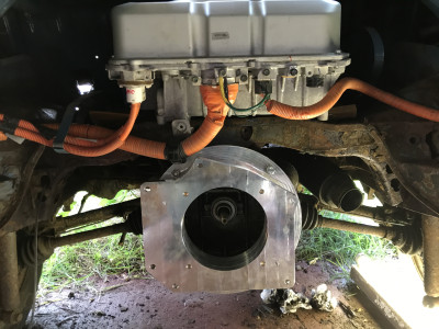

Trying it on for size…
I knew things would be tight in the engine bay. There’s actually plenty of space, just not necessarily in all the right places…
The only way to know what options I had was to try it for real and I held off getting stuck into it until my motor adaptor plates arrived this week.
Step 1, (just loosely in place, not fitted yet) adaptor plate and coupler (Brat Industries)
Note, the VW transmission shaft will still need to be shortened approx 10mm. I’ll measure exactly what works when I cut it.
Next, and this was always the bit I was unsure would work, is to place the Leaf PDM (top third of the motor stack) onto the shelf left after removal of the petrol tank. It fits in there, and note this is rotated 90deg from its original placement on the motor.
But would this still allow enough space for the motor and inverter to slide up close enough to the vw transmission?
The answer to this is no!
Hard to tell from the photos, but the motor needs to move forward approx 100mm to mate to the transmission, and the PDM prevents that.
Not a disaster as I half expected that to be the answer. But I need to decide on the path to take…
1 - place to the left of the motor. Problem 1 - no room, but there would be if the spare wheel arch above was removed. But even if that happened, there are no existing bolt holes in that space that I could use to mount it to.
2 - raise the parcel shelf above the engine bay by about 100mm. That would allow the PDM to return to its natural home at the top of the motor stack. Benefit - less HV wiring that I need to route between PDM and inverter. Problem - adding more weight to the rear. Problem 2 - it means the rock and roll bed would not be flush with the parcel shelf which means I need to consider the height of the seat and reduced head height.
2b - if I’m even considering raising the parcel shelf, perhaps I can go back to the original plan / hope that it could fit in the fuel tank shelf. Benefit - less weight on the motor. Benefit 2 - that shelf has bolt holes and more of the weight is placed over the axle.
3 - perhaps move the vertical (slightly angled) engine compartment section that is in front of the PDM forward a bit might work. For some reason this bother me more than raising the parcel shelf up. But it avoids the complication of the raised parcel shelf, and retains the other benefits of placing in the fuel tank shelf. But am I breaking the EV conversion rules of no cutting?
Other considerations that need to go in the mix include the water cooling pump and pipes.
What will I actually do? Ignore it for a while. When faced with sub optimal paths I like to leave it to my subconscious to chew on it for a while.
So next step will be to put the PDM in the passenger space with the original Leaf battery pack, just as a test, with the motor mounted to the transmission to see what other problems occur.
If anyone reading in UK, familiar with the no cutting rules has an opinion on option 3 (or 2), I’d be happy to hear it.

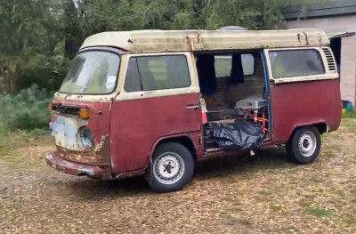

Option 4 has occurred to me. The disaster bus that I’m playing with had a 1600cc engine like the majority of them had. My final bus I intend to electrify is an 1800cc. These later T2s with the type4 1800 - 2000cc engines have a very useful hatch in the roof of the engine bay. Quite large. Will it be in exactly the right place above the motor to allow the extra headroom for the PDM? Hard to guesstimate it without trying for real given all the awkward shapes involved. But it’s possible.
Also, I seem to remember that Mr Flying Tools created his own lid to his PDM for his VW Golf conversion which saved a bit of space aswell, so that’s worthy of more investigation aswell.
BTW - the apparent engine hatch in my photos is a hacked out hole I made myself. It’s not the same shape or size as the main 1800 bus.
- Posts: 2962
- Has thanked: 330 times
- Been thanked: 847 times
Re: [WIP] Leaf to VW Type 2 Campervan
No cutting welding or drilling of the monocoque/chassis of the vehicle. This is literally what it says. Best bit it gets to be interpreted by the DVLA/inspector however they want.ianlighting wrote: ↑Sat Oct 19, 2024 10:41 am Thanks, although I know that much! I’m going to get hold of the regs to understand the detail of what it says.
Have you thought about ditching the pdm and using a more compact dc-dc and charger, or does the resolve controller limit you to the pdm? Zombieverter?

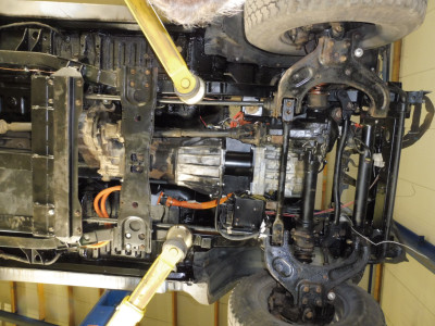

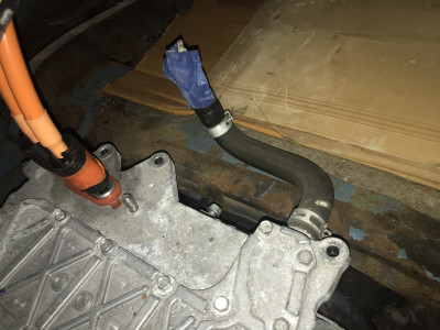

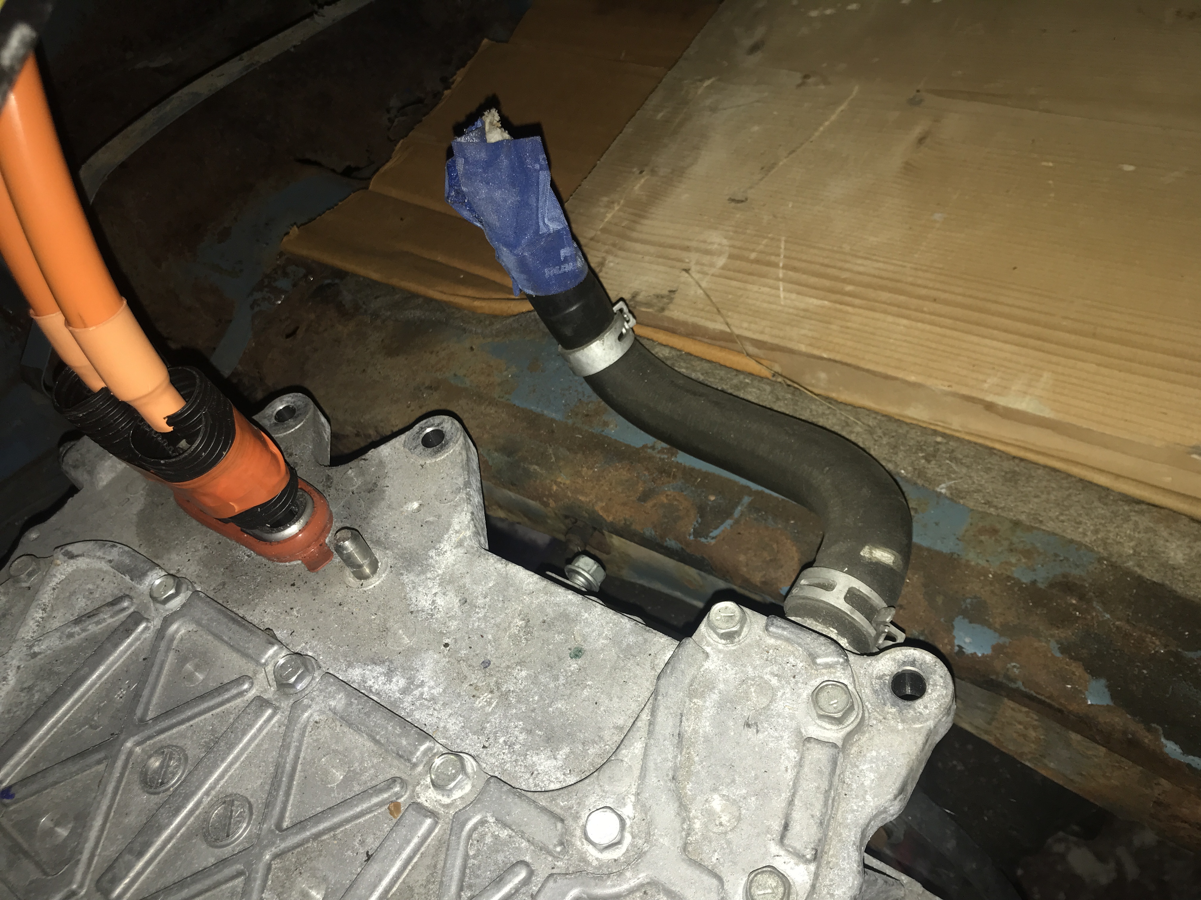

Yep! That all works then!
It goes forward. It goes backwards. It even wheel spins in 3rd gear which is an unusual experience in a T2
This is a complete lash up as you can tell from the photos. It’ll never be road legal, but it proves to me what I need to do next on the main bus.
As you can see from the side photo, the PDM is just sat in the passenger section cos is doesn’t fit in the engine bay.

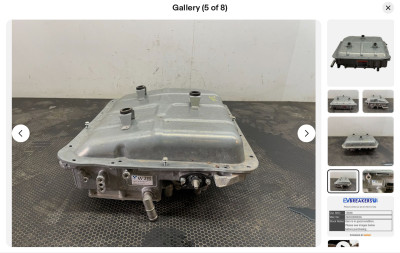

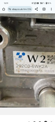

In my attempt to find a solution to my space problem I came across some unusual (to me at least) Leaf PDMs on eBay from EV Breakers . I’m used to the original shape with the silvery domed lid. Then I’ve seen the square black lid version, but what is this one….? Can someone with some knowledge confirm this is from a Leaf? Even better would be some height dimensions! It seems to have all the connections you’d expect to see.
EBay link
https://www.ebay.co.uk/itm/256610955705 ... 0e1ce0966d
EBay link
Toyota!!!ianlighting wrote: ↑Fri Oct 25, 2024 1:36 pm Can someone with some knowledge confirm this is from a Leaf? Even better would be some height dimensions! It seems to have all the connections you’d expect to see.
EBay link
evil neodymium
Yeah I know! It’s a bit weird. But it’s a similar shape to the Leaf PDM I’m familiar with, and the connections seem to be in the right place. Hunting that part code just brings me back to the eBay shop.
This other item from the same people has some much better close ups.
https://www.ebay.co.uk/itm/256602969791 ... R-yhnb_YZA

Yee haw! It drives! Possible to post or send me a closer up photo of the engine bay?ianlighting wrote: ↑Fri Oct 25, 2024 1:36 pm Yep! That all works then!
Yup it’s the latest leaf pdm. But can control of it is not confirmedianlighting wrote: ↑Fri Oct 25, 2024 1:36 pm Can someone with some knowledge confirm this is from a Leaf? Even better would be some height dimensions! It seems to have all the connections you’d expect to see.
- ianlighting
- Posts: 275
- Location: Uk
- Has thanked: 258 times
- Been thanked: 189 times
Yeah, no problem Angus.
Hmmm, well this could be interesting and possibly dig me out of my self imposed hole. All depends on the height. I’ll have to ask Isak what he thinks.
- ianlighting
- Posts: 275
- Location: Uk
Engine bay close ups, as request by Mr Brat Industries, purveyor of the world’s finest adaptor plates and transmission couplers.
Yes, that is a bracket made out of wood. What’s the problem?
It’s just a little extra bracing. The rear ‘moustache bar’ (rear engine mount) is designed to take a heavier weight from the petrol engine, and as I’m only doing 15 mph max in my driveway, it’s fine.
Looking down. Top of the photo was plan A - to put the PDM in that ex-petrol tank space. Didn’t work.
Side shot of Brat’s finest
BTW - saving the Brat supplied nylon nuts for motor mounting for the final bus. These nuts are just for the temporary disaster-bus testing.

Why not move the motor more back, away from the gearbox? It looks like there is enough room.
- ianlighting
- Posts: 275
- Location: Uk
It would probably need a 150mm tunnel to make sufficient space for the PDM, plus the coupler then would need replacing with a new one about 200mm long to bridge the gap. That’s a lot of potential for wobble.PaulHeystee wrote: ↑Sat Oct 26, 2024 9:22 am Why not move the motor more back, away from the gearbox? It looks like there is enough room.
What I like about the current fit with the Brat adaptors is they are a very nice tight fit.
But I’m open to all ideas.
- PaulHeystee
- Posts: 141
- Joined: Mon Apr 12, 2021 10:26 am
- Location: Nederland
- Has thanked: 3 times
- Been thanked: 35 times
On the Daihatsu Rocky I made a longer tunnel just to keep the motor and PDM clear of the firewall. This worked fine.
I welded on the center of the clutch plate to a tube which had the input shaft of the Leaf gearbox welded onto it.
As there is little to no vibration the shaft simply stayed in place without wobbling of vibrating.
However, I guess BratIndustries could make a longer shaft, on request. Otherwise I know someone who might also be able to make it for you.
For the extension you could simply add more alu plates, sandwiched onto each other.
