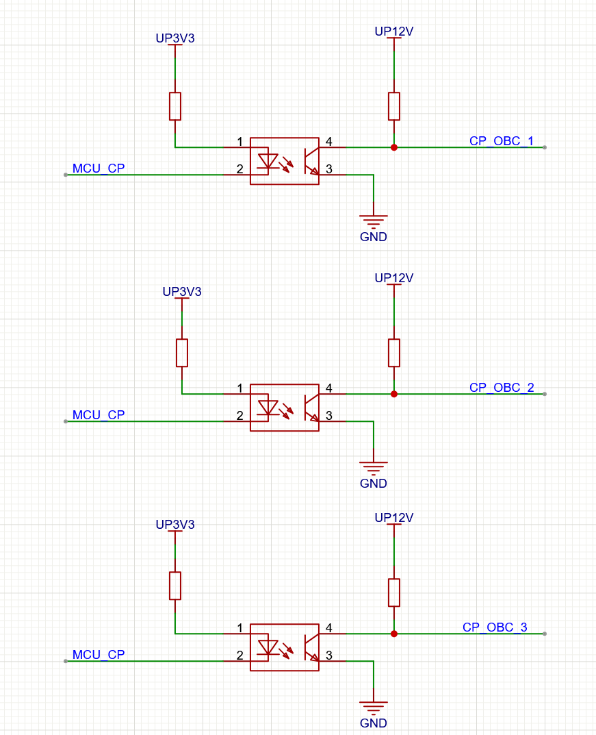

Here I want to start discussion on how to integrate Foccci with existing OBCs.
What we already have:
  • Foccci evaluates CP dutycycle and scales it to a current limit which can be put on the CAN bus
  • Foccci evaluates PP resistance, also scales it to a current limit
  • Foccci can receive an OBC state resulting in connector locking (TBD) and state C switching
So for OBCs that do not evaluate CP and/or PP themselves we already have a working mechanism.
For those that do need an undistorted CP or even PP we have the following options:
  1. Do not connect PP to Foccci. It isn't really needed, provided the OBC pulls it up in the correct way
  2. Use a change-over relay e.g. controlled by the VCU to connect CP and/or PP to the OBC and disconnect it from Foccci. The VCU can determine e.g. from CP duty cycle that we want to AC charge
  3. Re-create the CP signal and spoof the PP resistor to the OBC. This would need an additional output of Foccci and Foccci can only create the positive swing. Seems ok for most chargers
  4. Re-create CP with one of the contactor outputs. The contactors can then not be controlled individually but we also don't need an extra pin and it works with existing hardware (at least 4.5 and newer)
  5. Spoof PP and CP with some simple circuit (NE555?) and control the charger like one that doesn't read CP and PP
  6. connect CP to both. Remove the 2k7 state-B resistor from Foccci, because the 2k7 is present in the OBC

Is it possible to setup an output from foccci to "mirror" the CP input signal to be used to route to OBC?
Since the connectors are already full, I'm thinging if it's possible to use one of the testpoints for this (and patch in cable)?
And with this I think it should be possible to also limit the current and stop AC charging from Foccci by manipulating the CP signal to the OBC.
What do you think?

Yes, we could try this route. Some questions are to be clarified. How to generate a stable 12V as PWM supply? Is also -12V necessary (officially yes, but some OBCs may work also with 0V/12V PWM)? Is also measurenent of the PWM voltage necessary (I think yes, we want to know whether the OBC is in state B or C)? Is the STM able to provide the 1kHz PWM in the needed resolution? And is it also necessary to control the PP?

If you re-read the thread is a possible solution already presented? What is it you want to achieve?
Maybe for your application it's sufficient to remove the state-B resistor from Foccci, provided it is present in your OBC.
Re-creating the signal requires quite some additional hardware as uhi stated.
Simply putting a copy of CP on a test point at 3.3V level wouldn't be hard. Then some external circuit could modify it to +-12V and we don't "pollute" the Foccci design.
I think with CP forwarded to the OBC Foccci can stay passive and leave current control to someone else, i.e. I don't think it's necessary to read anything back from CP.

It seems to me a 0/12V CP PWM mirror from foccci at one of the contactor outputs would satisfy a lot of the people who aren't using Zombieverter or some other VCU with CP PWM output capability.
  • The contactor outputs are already proven to be capable of PWM so that's not an issue (the frequency just needs some managing in software, maybe disable PWM on the contactor output when CP PWM mirroring is in use on the other output)
  • It seems like most OBCs are happy without the negative portion of the CP PWM, so that's not an issue
  • No extra leads through the enclosure are needed
  • No PCB changes are needed, purely a software solution
  • When in need of more contactor drive current than one output can handle, one can add an external relay or utilize an auxiliary contact on one of the contactors to control the other. Yes, it's a downside, but it's perfectly manageable

You mean Foccci produces a 0/12V PWM with a contactor half bridge, and the 1k serial resistor is outside in the cable harness? Could work, if the OBC does not care too much about the voltage. Because the "12V" will be something between 12 and 15V most likely. Any volunteer to give a try?

What I have done in the past, 1K pull up to 12V then pwm it with a nfet. The Outlander charger finds this fine.
Jamie is running a PWM out from zombie into an outlander charger, which is a gate driver.

I have checked the pin options of the STM32. On larger variants TIM8 is connected to an appropriate pin but I think our MCU doesn't have TIM8.
There is only TIM3 then and that runs at 17.6 kHz. So specially for replicating PWM we'd have to run it at 1 kHz making the contactors noisy, if Foccci economizing is being used.
uhi22 wrote: Wed Jun 26, 2024 1:05 pm - (f.) connect CP to both. Remove the 2k7 state-B resistor from Foccci, because the 2k7 is present in the OBC
If I were to use my CCS inlet for AC charging I'd probably roll with that.

My first idea was to use the FOCCCI as the primary charge controller for DC and also let it handle AC charging by manipulating the CP signal to OBC.
I also had an idea to connect upto 3 OBC in parallel.
So my idea was to get a signal from the FOCCCI which replicates the CP but can be modified and decrease the power allowed.
I thought of a simple PCB with optocouplers like this:
But maybe this is just to complicate things.
I just liked the idea of keeping the EVSE CP signal routing clean by just routing it to one unit (FOCCCI).
And from your last post with timers it sounds as if this is not possible (in a simple way at least).
Perhaps just best to control OBC with CAN commands (if I like to limit output) and route the CP via switch/mux to the different boards/units.
