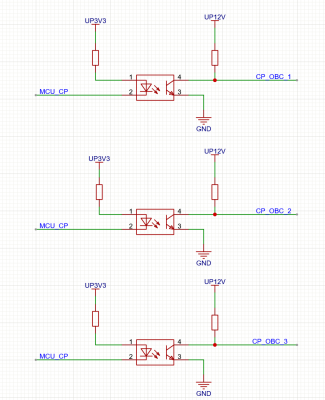

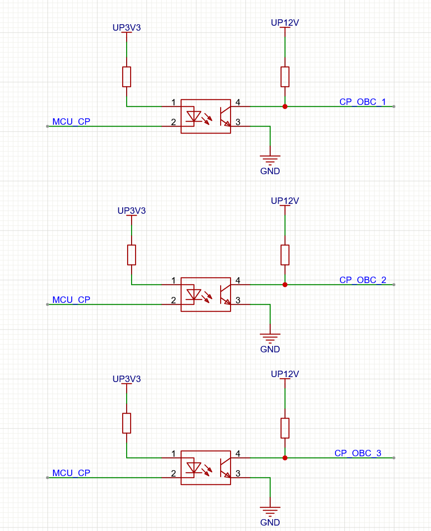

Is it possible to setup an output from foccci to "mirror" the CP input signal to be used to route to OBC?
Since the connectors are already full, I'm thinging if it's possible to use one of the testpoints for this (and patch in cable)?
And with this I think it should be possible to also limit the current and stop AC charging from Foccci by manipulating the CP signal to the OBC.
What do you think?

Yes, we could try this route. Some questions are to be clarified. How to generate a stable 12V as PWM supply? Is also -12V necessary (officially yes, but some OBCs may work also with 0V/12V PWM)? Is also measurenent of the PWM voltage necessary (I think yes, we want to know whether the OBC is in state B or C)? Is the STM able to provide the 1kHz PWM in the needed resolution? And is it also necessary to control the PP?

Simply putting a copy of CP on a test point at 3.3V level wouldn't be hard. Then some external circuit could modify it to +-12V and we don't "pollute" the Foccci design.
I think with CP forwarded to the OBC Foccci can stay passive and leave current control to someone else, i.e. I don't think it's necessary to read anything back from CP.

It seems to me a 0/12V CP PWM mirror from foccci at one of the contactor outputs would satisfy a lot of the people who aren't using Zombieverter or some other VCU with CP PWM output capability.
  • The contactor outputs are already proven to be capable of PWM so that's not an issue (the frequency just needs some managing in software, maybe disable PWM on the contactor output when CP PWM mirroring is in use on the other output)
  • It seems like most OBCs are happy without the negative portion of the CP PWM, so that's not an issue
  • No extra leads through the enclosure are needed
  • No PCB changes are needed, purely a software solution
  • When in need of more contactor drive current than one output can handle, one can add an external relay or utilize an auxiliary contact on one of the contactors to control the other. Yes, it's a downside, but it's perfectly manageable

You mean Foccci produces a 0/12V PWM with a contactor half bridge, and the 1k serial resistor is outside in the cable harness? Could work, if the OBC does not care too much about the voltage. Because the "12V" will be something between 12 and 15V most likely. Any volunteer to give a try?

What I have done in the past, 1K pull up to 12V then pwm it with a nfet. The Outlander charger finds this fine.
Jamie is running a PWM out from zombie into an outlander charger, which is a gate driver.

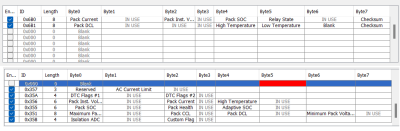

Right, but there's still a line on the diagram that goes to an input labelled 'plugin' which is separate from the cp/pp input pins. Unsure why it doesn't just signal that via CAN too, maybe it's for waking it up or something?
And the switch will be right by the charge port and then run either to to the foccci or the bms.
After re-reading the bms manual, maybe I don't need the switch? When I first read this I thought it was talking about the actual fast charging side of things, not passing info through for onboard charging.
Although ZEVCCS does not perform onboard charging, it manages the charge plug, and a
special interface is used between the ZEVCCS system and the MCU so the MCU can be notified
of charge plug presence and its ampacity. Charge plug presence, normally provided by the
Proximity input, is instead provided by a new input called plugin. Charge plug ampacity,
normally provided by the pilot signal, is determined by the ZEVCCs system, and communicated
to the MCU by a CAN message.

Zieg wrote: Thu Oct 24, 2024 11:30 pm After re-reading the bms manual, maybe I don't need the switch? When I first read this I thought it was talking about the actual fast charging side of things, not passing info through for onboard charging.
https://shop.fellten.com/shop/ccst2fck- ... -kit-13491 have a read of their user guide.
Luckily I worked on this system myself back in the day.
You are using this BMS right: https://www.thunderstruck-ev.com/mcu.html
The MCU also supports onboard charging using the Zero EV CCS; this case is handled
separately: see ZEV CCS Charging, below.
The MCU monitors for charge plug insertion to begin a charge, and once charging has started,
the MCU controls the chargers, typically by using CAN messages.
To find the CAN format just download the orion2 software and rip it from there.

My first idea was to use the FOCCCI as the primary charge controller for DC and also let it handle AC charging by manipulating the CP signal to OBC.
I also had an idea to connect upto 3 OBC in parallel.
So my idea was to get a signal from the FOCCCI which replicates the CP but can be modified and decrease the power allowed.
I thought of a simple PCB with optocouplers like this:
But maybe this is just to complicate things.
I just liked the idea of keeping the EVSE CP signal routing clean by just routing it to one unit (FOCCCI).
And from your last post with timers it sounds as if this is not possible (in a simple way at least).
Perhaps just best to control OBC with CAN commands (if I like to limit output) and route the CP via switch/mux to the different boards/units.
