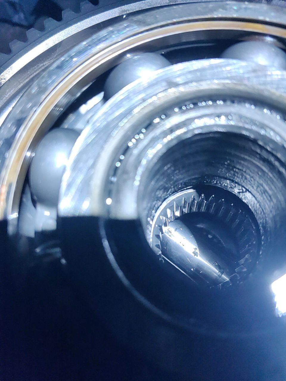

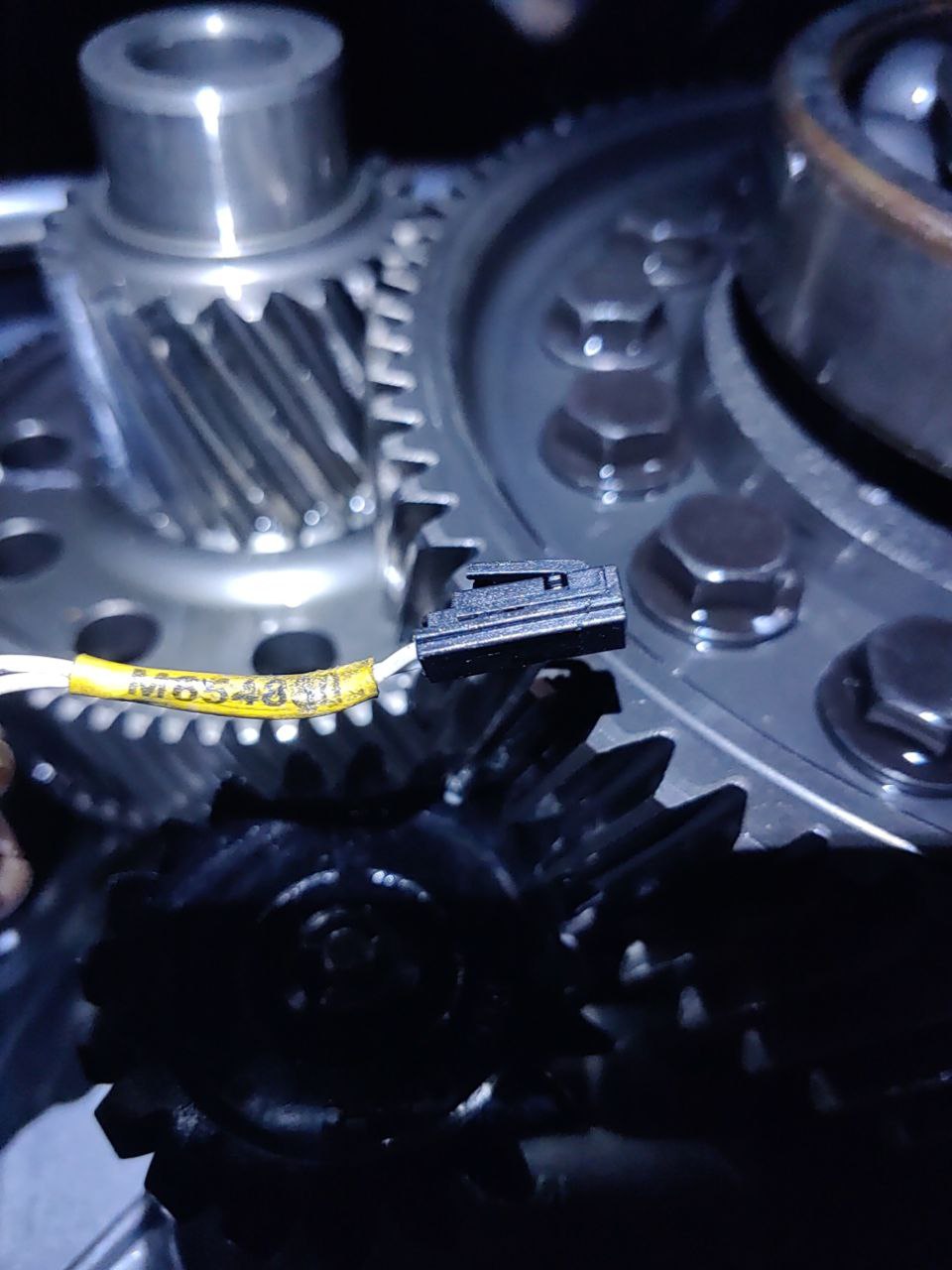

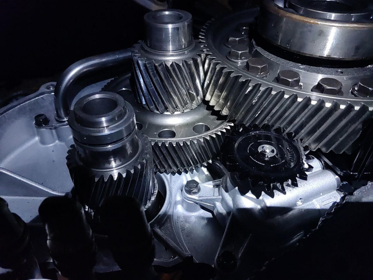

I have more information and the same time I do not have much.

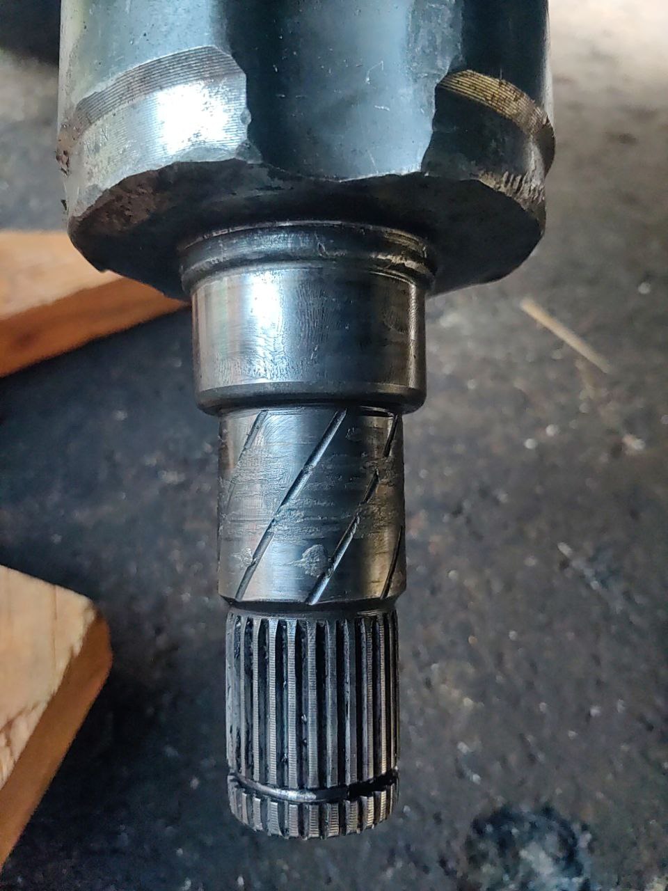

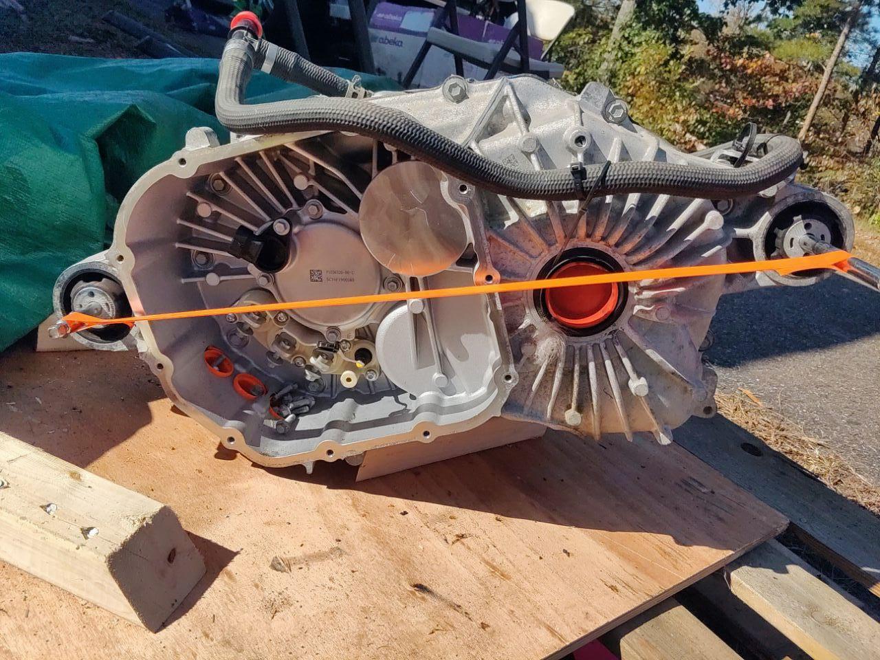

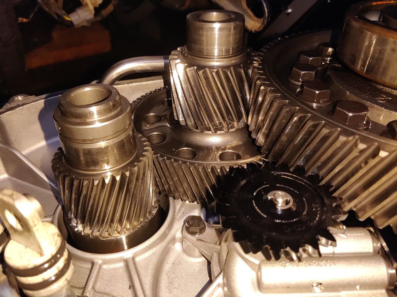

The Tesla end of the CV axle were stuck in the motor. Normally you just have to pry them out and they come out of the motor. it took me 7 hour to get them out and I had to use a hammer intensively on them.
I think that when the motor get's stuck in some way I cannot explain , the wheels keep turning and something has to give.
I can spin the motor with my drill and see no issue. Unless there is something electrical that freezes the motor while accelerating I cannot see how the CV axles would get stuck.
I guess I need to order new Tesla ends for the CV axles and try the new motor.
I wish I did not have to work with CV axles since it is so painful to get the motor in and out.

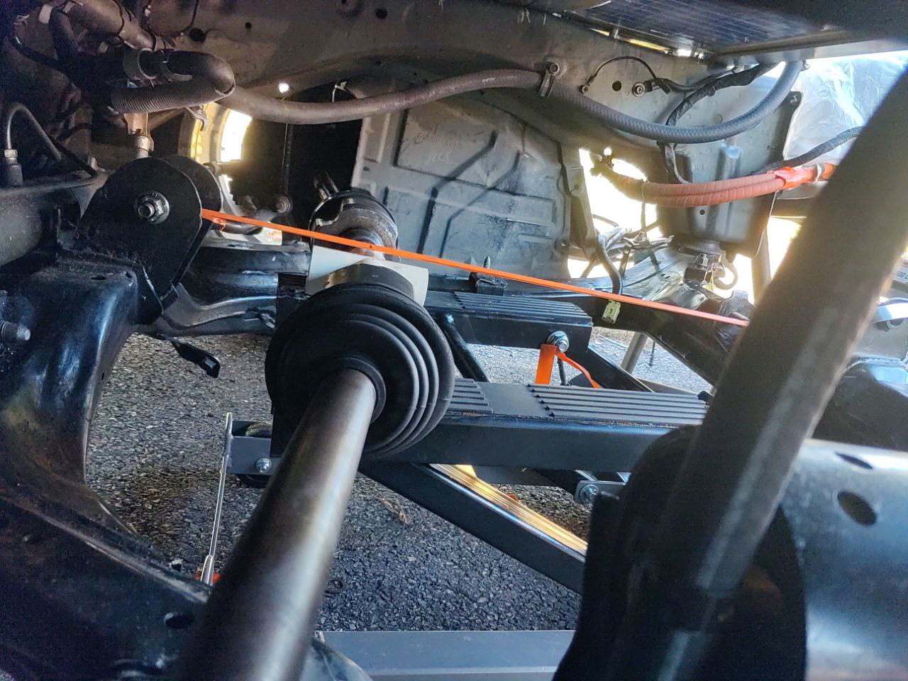

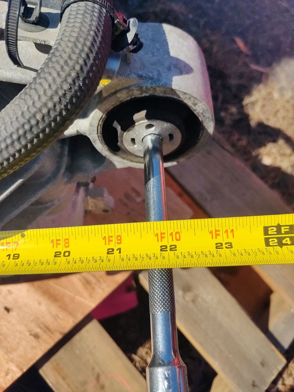

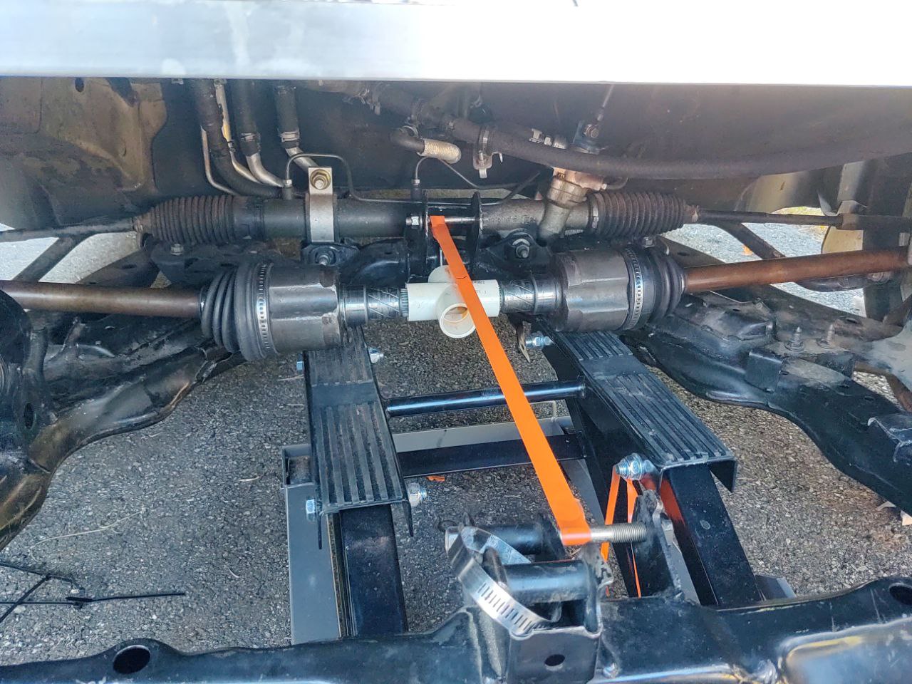

With some work and little bit more welding I could move the supports towards the back to straighten the shafts a little bit, but even as is, at least for me does not look a very big angle.
Also for anybody interested I measured the distance between the center of the front and back support. almost 22in.
Been thanked: 1914 times
Are the drive shafts the correct length, i.e. enough travel when the springs are compressed? Still wondering why they got stuck.

After few more measurements I think that the CV axles are a bit too long. I also decided to move the motor forward about 2 inches and shorten the CV axles.

I finished the car and is moving forward and reverse. It is dark and I will have to test it tomorrow in daylight on the road to be sure that everything is right. if all good I will make a quick video and then order the BMS from Johu.
CV axles are now straight. I had to move the motor 2 inch UP and 2 inch backwards, so I had to modify all 3 mounts.

Proton wrote: Tue Oct 29, 2024 5:09 pm That is nice but they were really stuck. I got them out before with no issues.
The CV axles are held in place with a little ring/clip (it seems to be missing in your pictures above, but you can see the grove in the shaft. BTW... did the clip come out or is it still inside the differential?).
If this ring is a little too big or bent a bit out of shape, you'll have the kind of trouble you experienced because the clip sits flush in the grove on top but sticks out too far on the bottom.
The best method apparently is to try to get the clip in a favorable position by constantly rotating the axle and pushing it back it, pulling it back out etc. This way, you try to get the clip centered in the grove and it should be easier to pull the axle out.
Violence and the shown tools are not necessarily the right answer, because if that ring becomes really bent, you'll have a hell of a time getting the axle out. The shaft itself and the bearings are hardened, so something will certainly break with too much violence.
I don't want to sound like a know-it-all, I just wanted to explain why it was easy the one time and very hard this time. :)

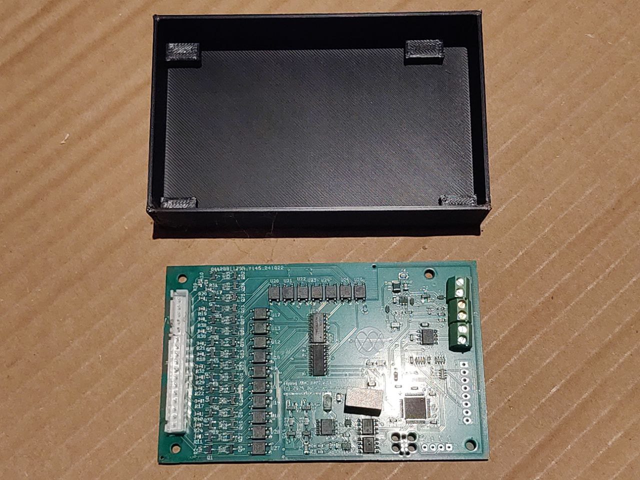

My son made me this box so if anyone needs the BMS case I attached the STL file.
I will ask him to do a cover when he has some time.
Screw holes need to be drilled, or just screw into plastic standoff.
OpenInverterBMS.stl
(4.57 KiB) Downloaded 93 times

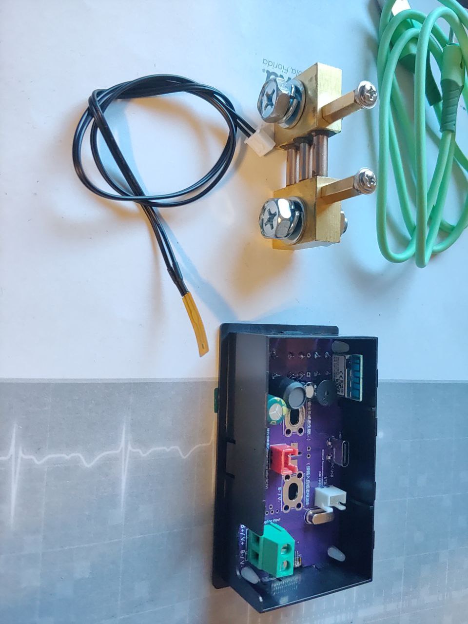

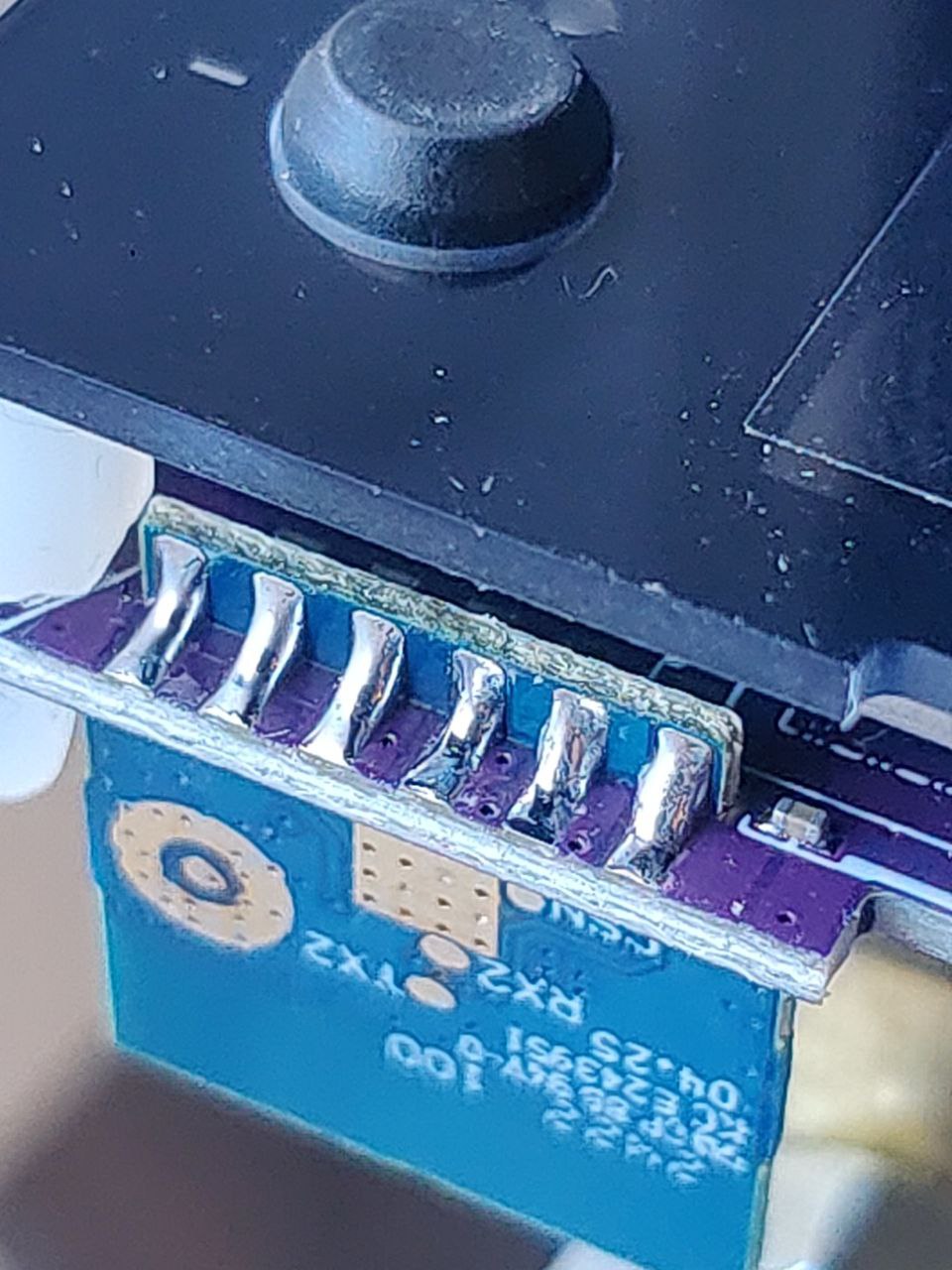

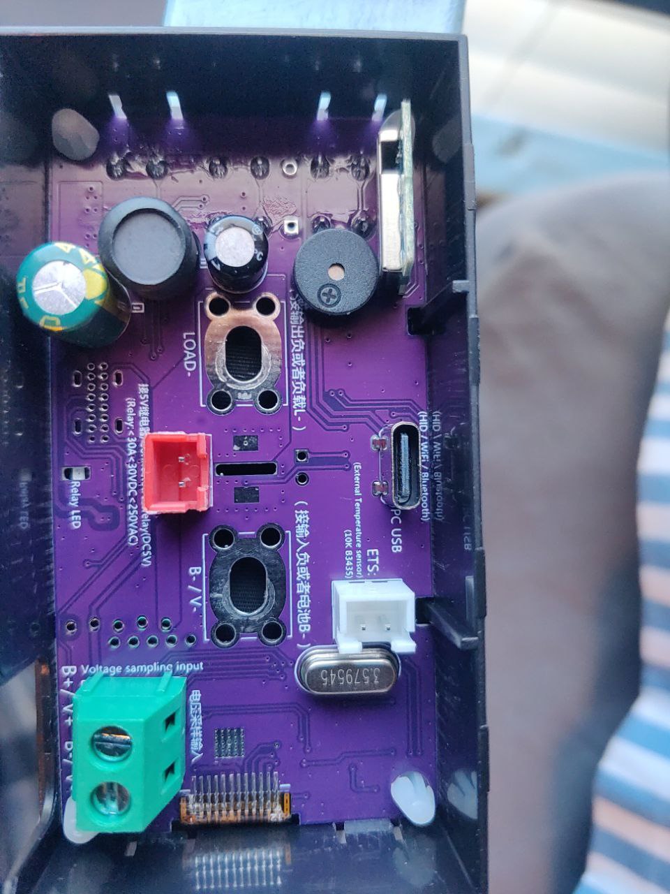

i am still looking for a wired battery monitoring solution.
For those of you that need a cheap battery monitor, do not mind some wireless radiation and leaving a trail everywhere you go, i found a cheap one on aliexpress:
https://www.aliexpress.us/item/32568069 ... pt=glo2usa
For me I am trying to modify it so i do not have to use the Wifi.
I am going to desolder the Wifi module and I already removed the shunt.
I will add the shunt close to the battery and run some wires to the monitor inside. Will see if adding some long wires from the shunt inside the cabin keeps the device accurate.
if the measurements are not accurate I will use it for a battery bank, and look for a different wired solution.

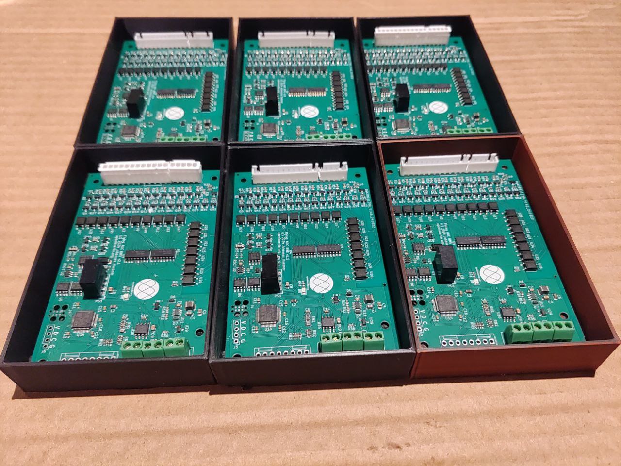

I finally have the BMS working.
The latest Openinverter BMS version 2.3 looks good and had no issues and I also updated the boards connected to the batteries
