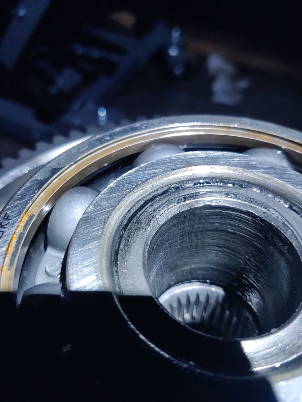

I have more information and the same time I do not have much.
The Tesla end of the CV axle were stuck in the motor. Normally you just have to pry them out and they come out of the motor. it took me 7 hour to get them out and I had to use a hammer intensively on them.
I think that when the motor get's stuck in some way I cannot explain , the wheels keep turning and something has to give.
I can spin the motor with my drill and see no issue. Unless there is something electrical that freezes the motor while accelerating I cannot see how the CV axles would get stuck.
I guess I need to order new Tesla ends for the CV axles and try the new motor.
I wish I did not have to work with CV axles since it is so painful to get the motor in and out.

Proton wrote: Tue Oct 29, 2024 12:12 am The Tesla end of the CV axle were stuck in the motor. Normally you just have to pry them out and they come out of the motor. it took me 7 hour to get them out and I had to use a hammer intensively on them.

That is nice but they were really stuck. I got them out before with no issues.

Proton wrote: Tue Oct 29, 2024 5:09 pm That is nice but they were really stuck. I got them out before with no issues.
The CV axles are held in place with a little ring/clip (it seems to be missing in your pictures above, but you can see the grove in the shaft. BTW... did the clip come out or is it still inside the differential?).
If this ring is a little too big or bent a bit out of shape, you'll have the kind of trouble you experienced because the clip sits flush in the grove on top but sticks out too far on the bottom.
The best method apparently is to try to get the clip in a favorable position by constantly rotating the axle and pushing it back it, pulling it back out etc. This way, you try to get the clip centered in the grove and it should be easier to pull the axle out.
Violence and the shown tools are not necessarily the right answer, because if that ring becomes really bent, you'll have a hell of a time getting the axle out. The shaft itself and the bearings are hardened, so something will certainly break with too much violence.
I don't want to sound like a know-it-all, I just wanted to explain why it was easy the one time and very hard this time. :)

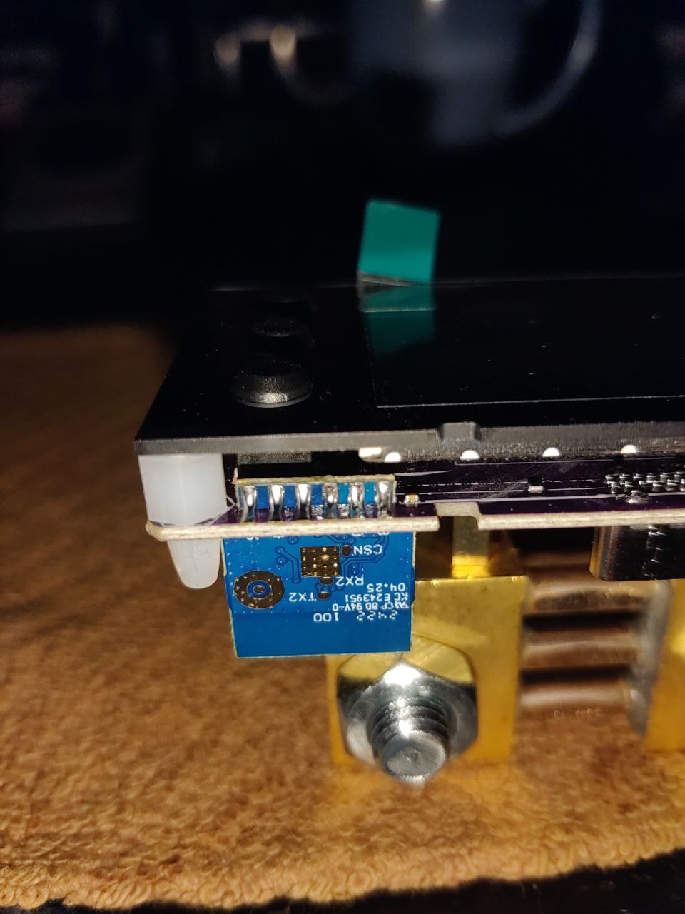

i am still looking for a wired battery monitoring solution.
For those of you that need a cheap battery monitor, do not mind some wireless radiation and leaving a trail everywhere you go, i found a cheap one on aliexpress:
https://www.aliexpress.us/item/32568069 ... pt=glo2usa
For me I am trying to modify it so i do not have to use the Wifi.
I am going to desolder the Wifi module and I already removed the shunt.
I will add the shunt close to the battery and run some wires to the monitor inside. Will see if adding some long wires from the shunt inside the cabin keeps the device accurate.
if the measurements are not accurate I will use it for a battery bank, and look for a different wired solution.
