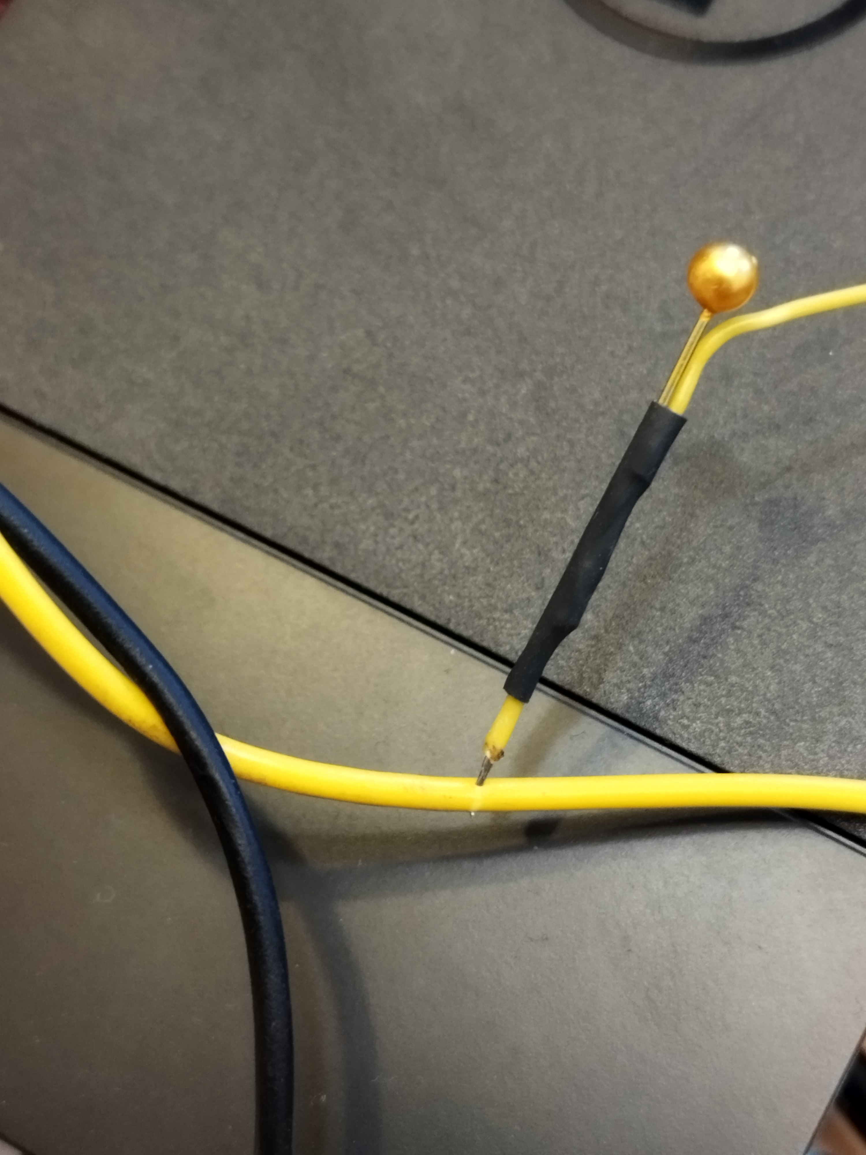

Over the next few months, I'll like have the opportunity/reason to take CAN logs on a few stock OEM EVs. When I've needed to log in my conversion, I've added a place in the harness to tap the CAN bus, but in these circumstances, I won't have the ability to modify the stock wiring.
What are some good options/approaches to CAN logging with minimal disruption to the harness? Is there a good way to do it that will not damage anything?

Apparently there are inductive methods but never tried it. If you have enough time you can find the connector with the CAN wiring (VW orange) and see if you find both sides of it for sale. Then make a tap cable

johu wrote: Tue Oct 29, 2024 8:18 pm find the connector with the wiring and see if you find both sides of it for sale. Then make a tap cable
I was thinking about trying this. I know some of the busses are only ever in big connectors though, so not sure how much work it'll be.
I was also thinking about trying to use a needle into each wire of the bus, but not sure if that was crazy.
Been thanked: 1918 times
Re: Tapping an OEM CAN Bus
CAN busses are surprisingly picky when tapped that way as in you could disturb the bus. But then you can just remove it.
Perhaps penetrating the back of the connector hits more metal? Works well with unsealed ones at least

johu wrote: Tue Oct 29, 2024 8:25 pm Perhaps penetrating the back of the connector hits more metal? Works well with unsealed ones at least
Good point. What have you used to do that? Any specific pin or just a strip of metal?
Re: Tapping an OEM CAN Bus  [SOLVED]
Resistor leads :)

I used scope needle probes from the back of Nissan chademo CAN connector to scoop up telegrams. And it worked well.

I have a couple of Crocodile clips. Tried to get it working, but interference with the bus is all I get.
Parallel scope is by far the least intrusive, just need the right setup. I have a spare Crocodile clip. PM if you're interested....just need to pay postage 😉. Maybe you can find a solution 🤞

pin from the sewing box, they are not very sharp originally, I sharpened them.

uhi22 wrote: Wed Oct 30, 2024 7:18 am pin from the sewing box, they are not very sharp originally, I sharpened them.
I've got a few that are quite sharp and should do the trick

RetroZero wrote: Wed Oct 30, 2024 6:06 am I have a couple of Crocodile clips.
I've use those on my conversion, but had to strip insulation off the wire to get contact.

P.S.Mangelsdorf wrote: Wed Oct 30, 2024 12:12 pm I've use those on my conversion, but had to strip insulation off the wire to get contact.
No need to strip wires.

RetroZero wrote: Wed Oct 30, 2024 8:49 pm No need to strip wires.
Never got these working reliably for me
