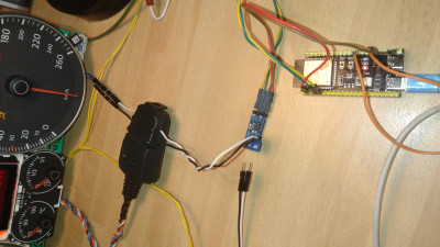

Re: Tapping an OEM CAN Bus
I used scope needle probes from the back of Nissan chademo CAN connector to scoop up telegrams. And it worked well.

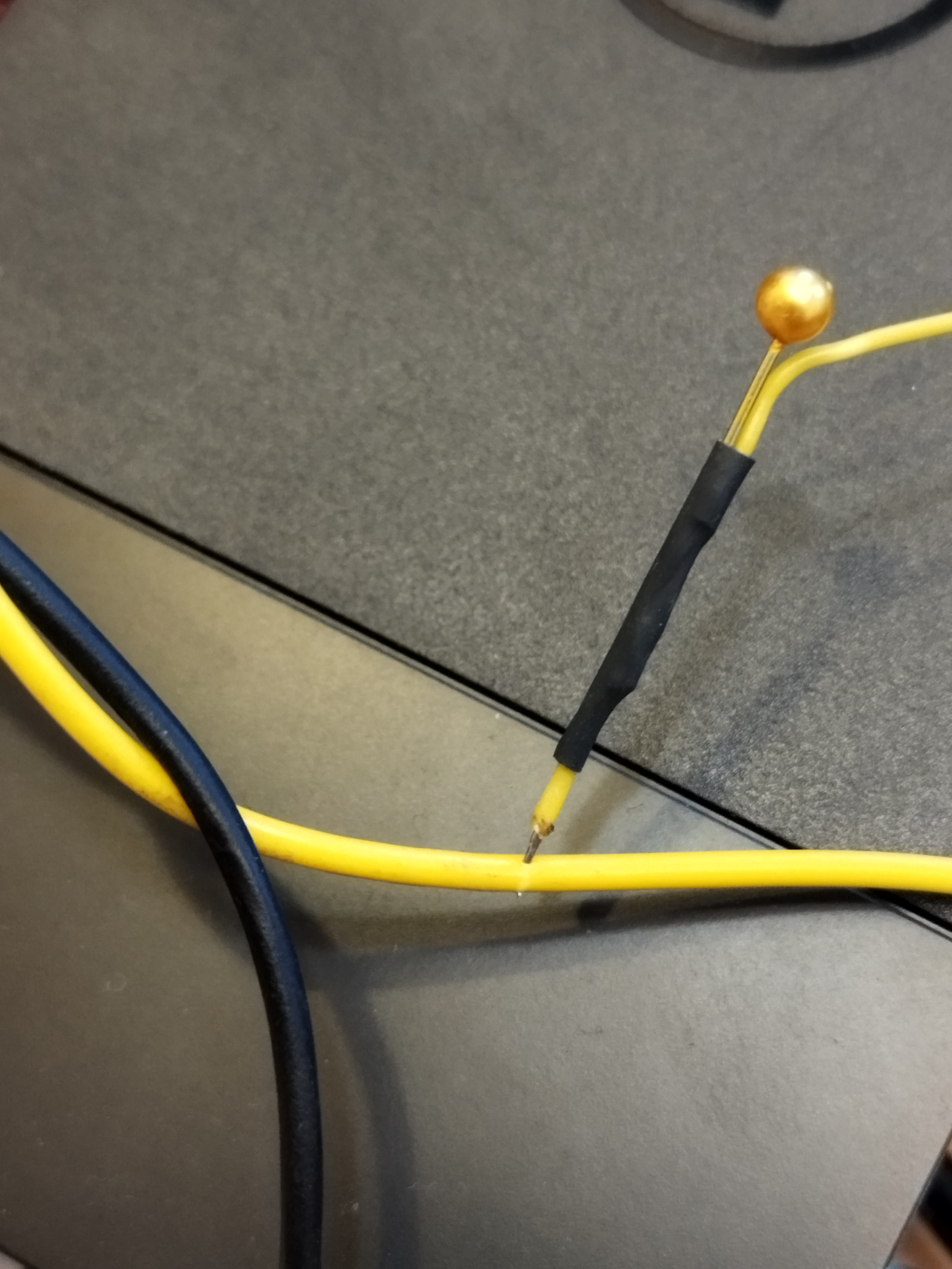

I've use those on my conversion, but had to strip insulation off the wire to get contact.
- Posts: 885
- Location: France
- Has thanked: 557 times
- Been thanked: 53 times
No need to strip wires.P.S.Mangelsdorf wrote: ↑Wed Oct 30, 2024 12:12 pm I've use those on my conversion, but had to strip insulation off the wire to get contact.
