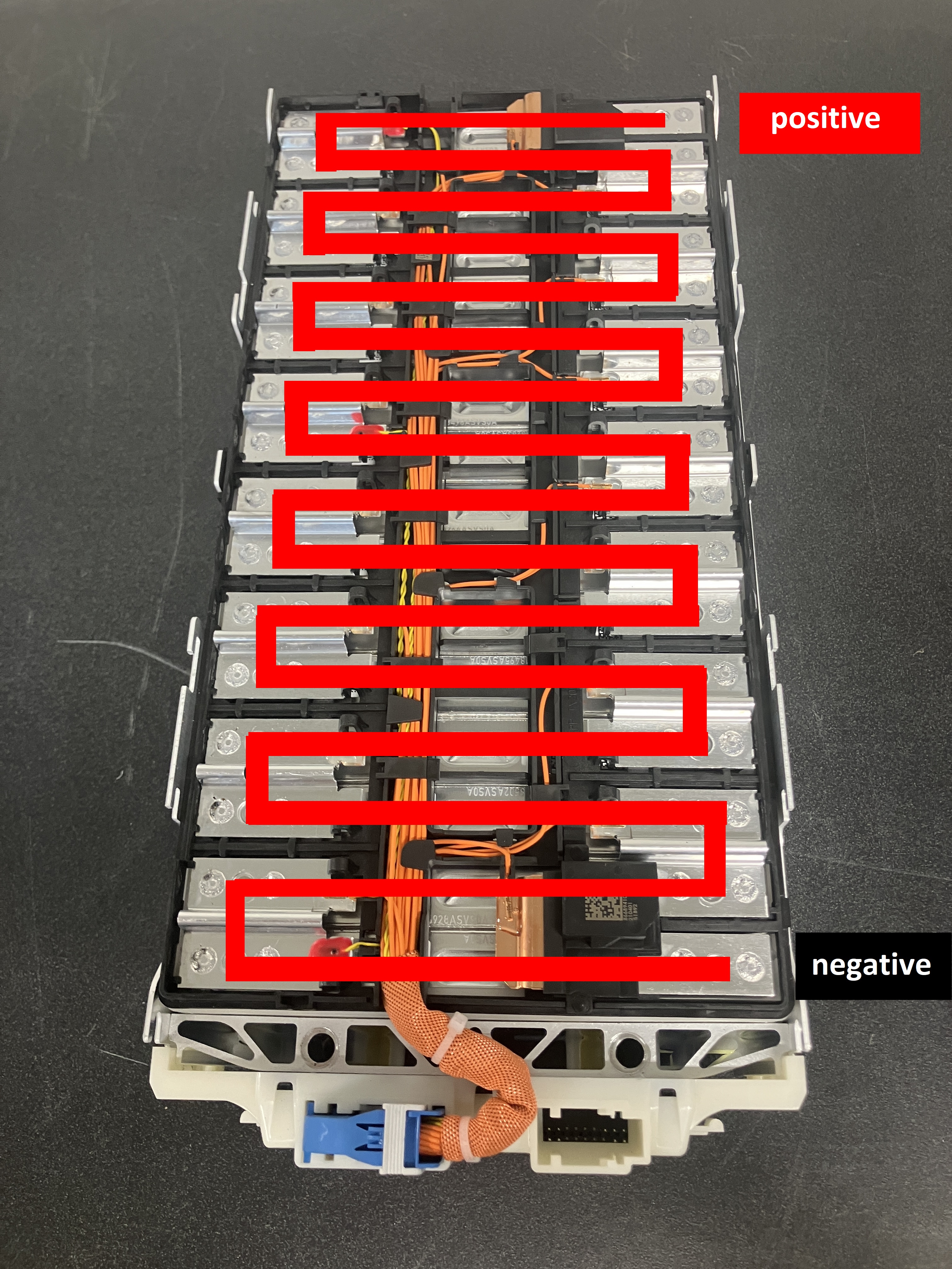

alright time to tell you what you already know, both the older SP06 and the newer SP41 modules are made up of 16 cells, in alternating formation, think of them like domino pieces of 1 and 0 laid down on their sides
type of stuff, this is obviously done for spaceabilty and practicality and storegability otherwise the modules would be an inch thich and a mile long since joining cells in series means linking or connecting them plus to minus, plus to minus, plus to minus, plus to... well you get the idea (by the way solar panels do the same sh!et) this adds up the voltage so 4 volts plus 4 volts plus 4 volts, etc...

sorry it took me so long, I am trying to get back on track in this game called life, ha ha
this is the new SP41 module with the BMS slave module attached weighing in at 28.2 freedom pounds, the truck will be equipped with a dozen of these beauties
the module is approximately 7 inches wide
the length is a bit tricky so hear me out, with the slave BMS module it appears to be 15 1/2 inches long
height looks like 4 1/4 inches

something to look out for or account for are these pesky plastic feets that stick out about 1/8th of an inch on each side, now you can grind these flat, I did that on my first pack cause I did not account for them space wise, so I avoided a close call there
Thank you! Wow, that is pretty good. Guess it works out to 14.1 lb/kwh including BMS.. I like it!

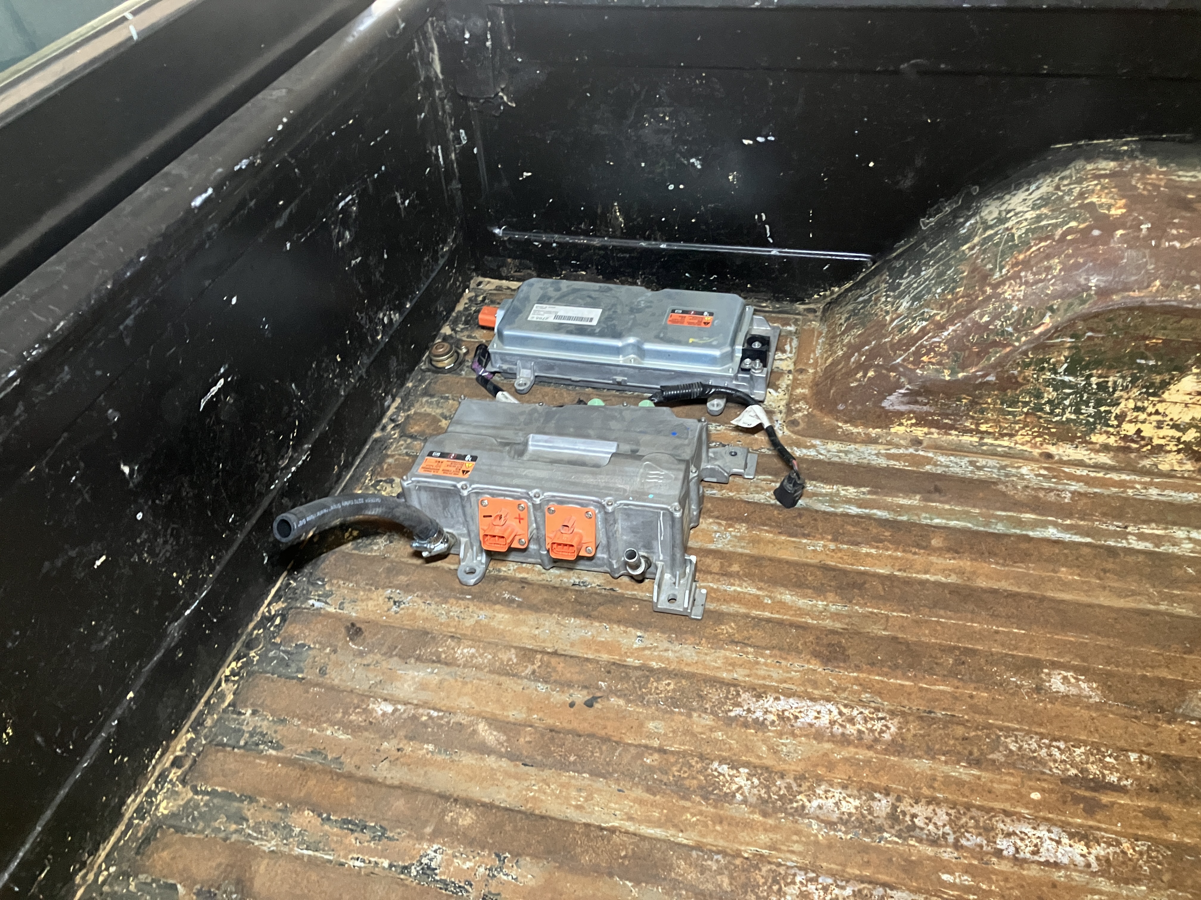

we now join Phase 2 of the truck project already in progress...
Our mission should we choose to accept it, is two fold:
below I already removed the first gen Chevy Volt charger and DC-DC converter
nice thing about owning a truck is that it comes with it's own workbench/storage space
- Replace the 9 kWh battery pack with two 12 kWh battery packs
- Enable MG1 by locking out the input shaft
