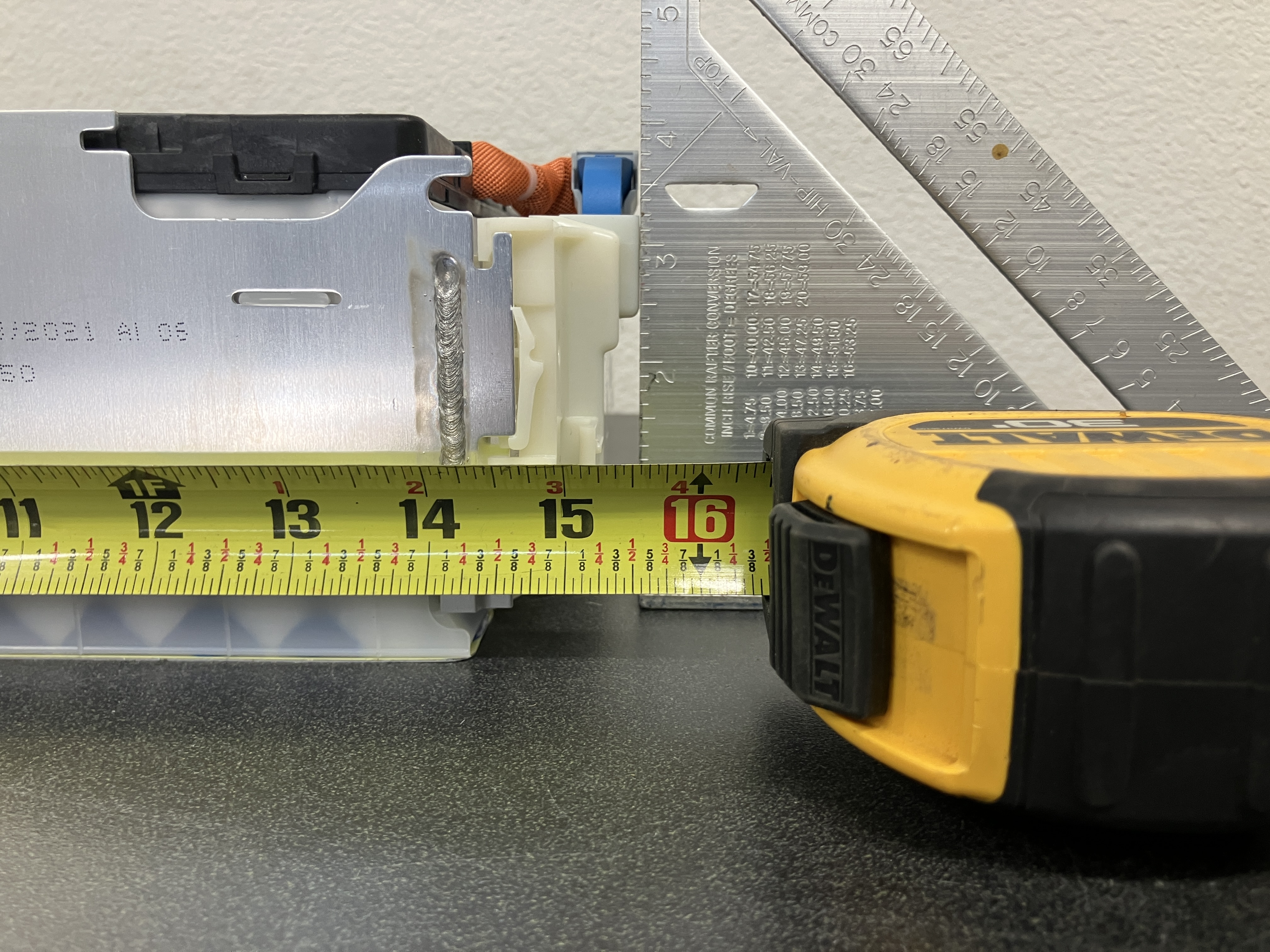

this is the new SP41 module with the BMS slave module attached weighing in at 28.2 freedom pounds, the truck will be equipped with a dozen of these beauties
the module is approximately 7 inches wide
the length is a bit tricky so hear me out, with the slave BMS module it appears to be 15 1/2 inches long
height looks like 4 1/4 inches

something to look out for or account for are these pesky plastic feets that stick out about 1/8th of an inch on each side, now you can grind these flat, I did that on my first pack cause I did not account for them space wise, so I avoided a close call there

Thank you! Wow, that is pretty good. Guess it works out to 14.1 lb/kwh including BMS.. I like it!

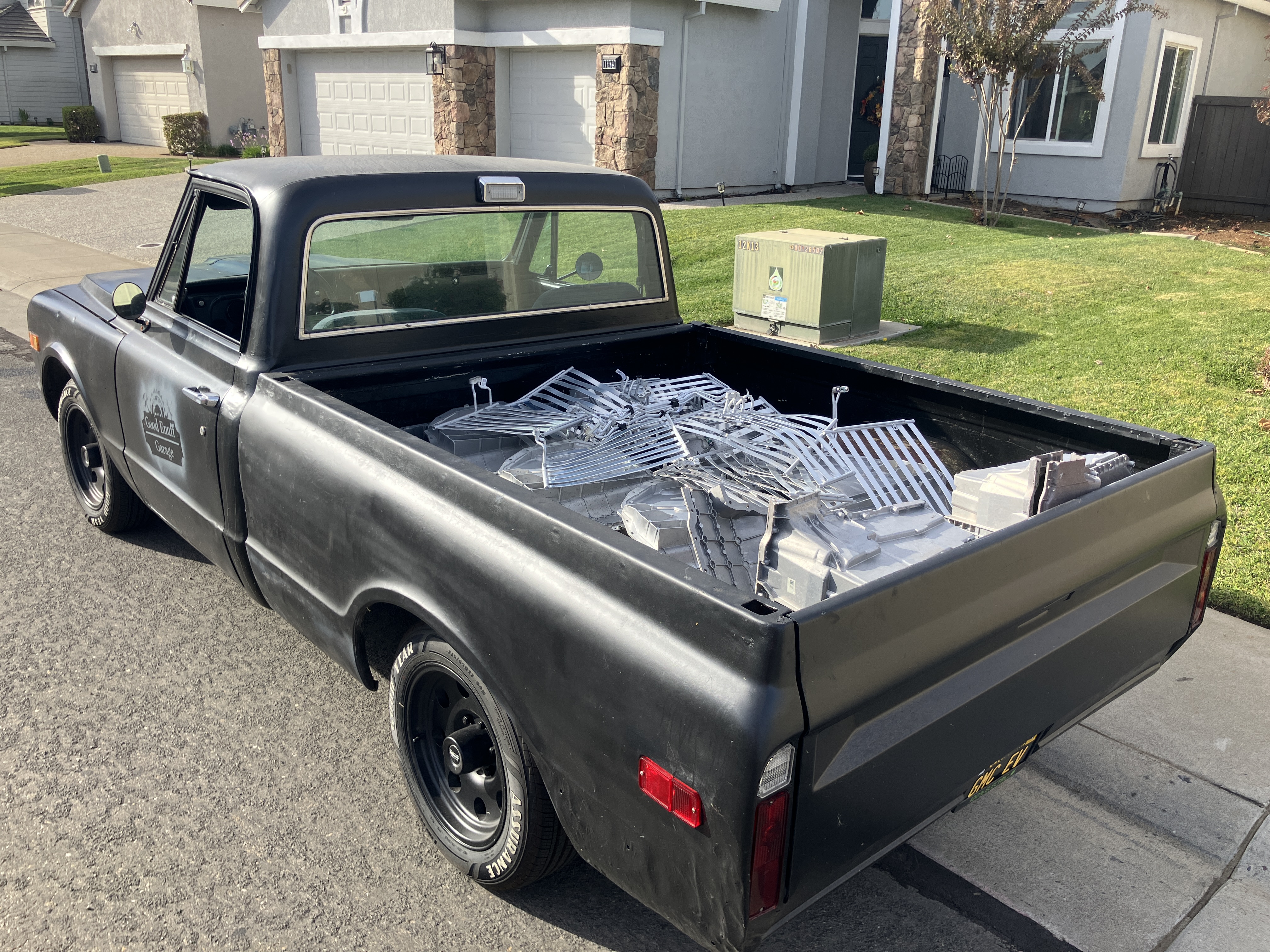

So you need an EV truck to dump the EV scrap caused by all yer EV meddling!
Proper. :lol:

just hammin' it up on my way to the metal recycler with a big smile on my face cause the truck is running great, and check out these street names

Hmmm.... and I got in the Sh*t for going off topic in a build thread 🙄 I wanted to buy the cooling tray parts of the scrap you were going to transport to the scrap yard, you would have made better than $100 and still had the aluminium cases to sell .... To bad, I'll keep my eye out over ere in Aust or anyone doing a similar thing ......

Uppertown wrote: Mon Nov 11, 2024 1:40 pm Hi Greg,
Would you have any dimensions for the cell hold down bolt holes?
Cheers
center of bolt hole to center width wise is 87 mm
center of bolt hole to center length wise is 14 1/8 inches (sorry I did not have a metric measuring tape that long)
the holes appear to be 8 mm in diameter, but the bolts are only 5 mm

T1Terry wrote: Tue Nov 12, 2024 7:03 am Hmmm.... and I got in the Sh*t for going off topic in a build thread 🙄 I wanted to buy the cooling tray parts of the scrap you were going to transport to the scrap yard, you would have made better than $100 and still had the aluminium cases to sell .... To bad, I'll keep my eye out over ere in Aust or anyone doing a similar thing ......
I got my complete Lexus 450h home yesterday, so I'll start my project thread soon, thank you for all the time you spent filming your build, it gave me a lot of encouragement .... and a warning about staying on the right side of the household co inhabitant ;) All the insurance money is in her account, no replacement house for me ;)
T1 Terry
sorry mate I had someone ask for those parts from my first pack years ago and the cost to ship them at that time to Canada if I recall correctly made it cost prohibitive, the aluminum heat sinks are sort of useless without their supporting heavy ass steel plates that they sit atop of
