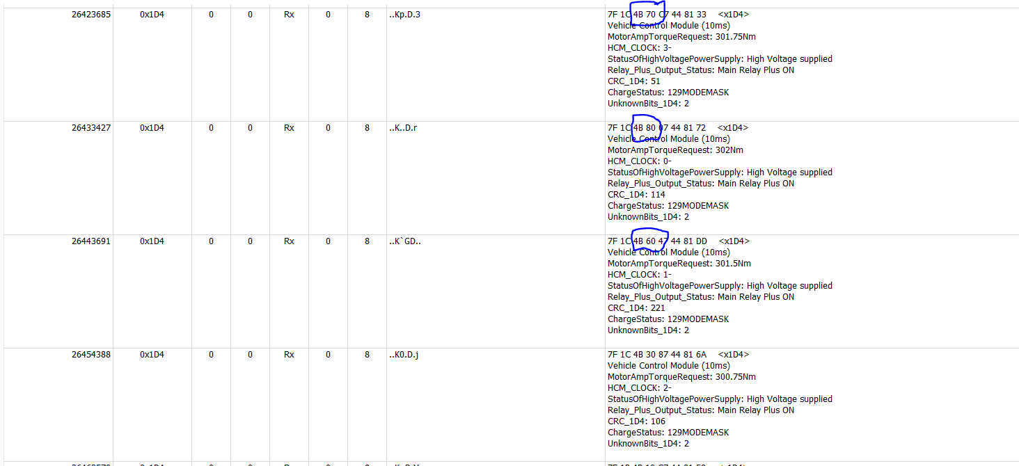

Here is a a log from a 62kwh car
The way the torque gets requested is a bit strange.
So it scales from 0-100 as torque percentage then multiplies by 2047. Given the motor torque is scaled at 0.25 bit/Nm and its a 12bit value.
This would mean 2047*0.25 = 511.75Nm which sounds like quite alot.

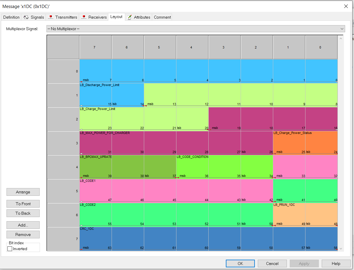

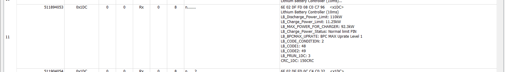

Re: Zombieverter Nissan Leaf 160kW
"cryptic" because its just copy paste from a log.
Here is the format of the values.
So you the 10bit discharge limit is: 0x1B8 440d. The scaling is 0.25kW per bit, luckily its hex and if you shift it back 2 positions you are dividing by 4.
The discharge limits thus is 0x6E which is 110d kW
So what value do we want to try, lets say 150kW 0x69. Then shift this left 2 you get 0x258 or 600d.
bytes[0]=0x6E;
bytes[1]=0x0A;
Becomes
bytes[0]=0x96;
bytes[1]=0x0A;
ted.walsh

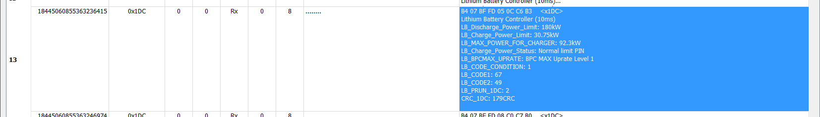

Code wise, yes. I made sure 0x1dc[0]=A0 as that appears to be the documented max for my twinned BMW hybrid packs - the numbers do show that side of things are functioning as expected.
I didnt mess with anything to do with the throttle following your sage mentoring and a good session with ChatGPT getting Ai to explain bit shifting and other C related insights. Its a very patient teacher.
Thermal wise I do understand that the 'fault' isn't to do with the code per se its more my understanding of the decode on the log notwithstanding I made a couple of hardware modifications before getting the log that may be skewing the view somewhat.
No doubt I am taking things beyond their design concept in a way that is difficult to achieve in a road car. Im sure nobody drives their Leaf round at 95mph for very long.
I havn't tried soft pedalling for a few mins with the logger on yet but may be able to do so over the weekend as well be able to test again. I have my suspicions on this but more testing is required.

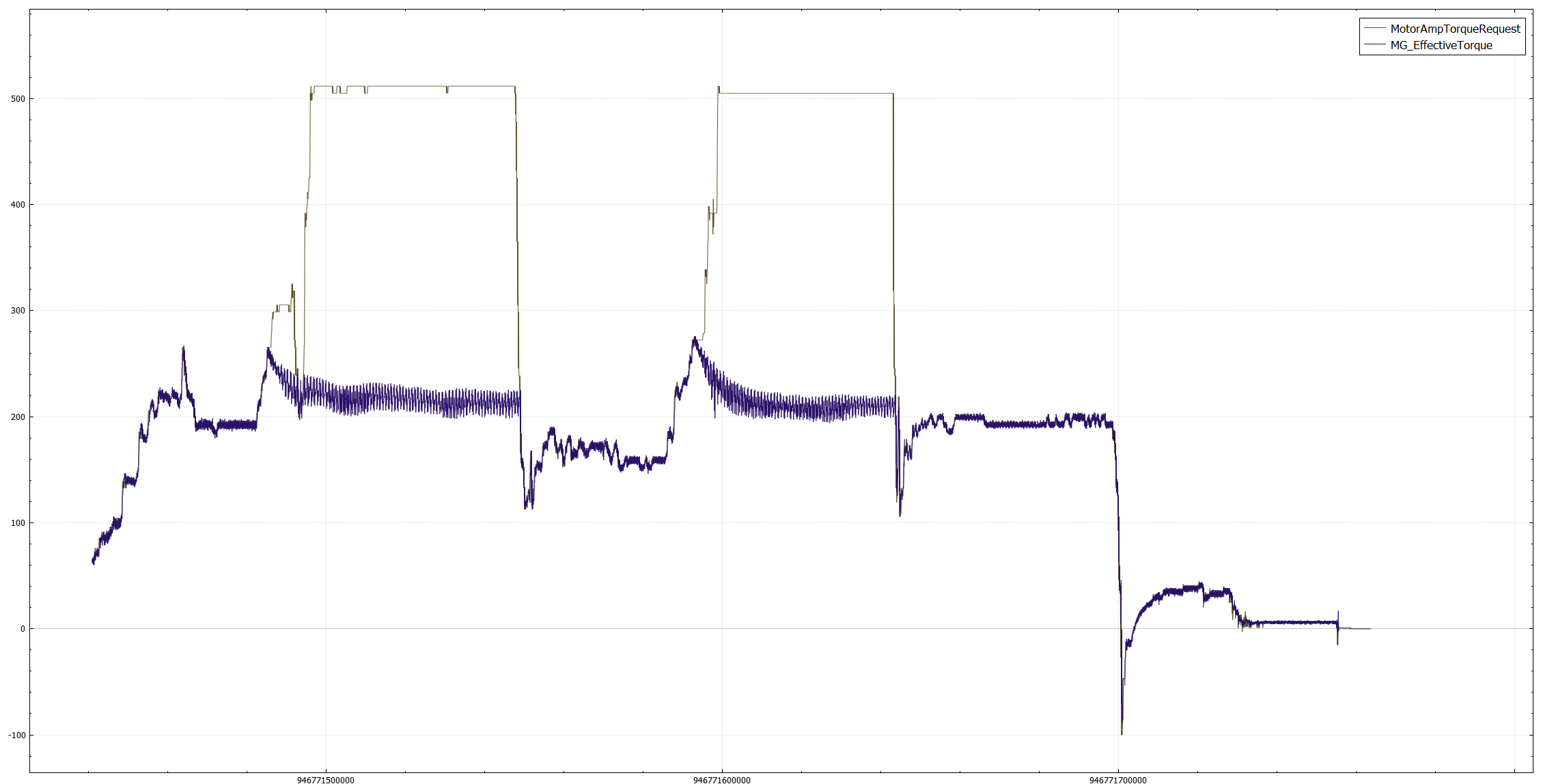

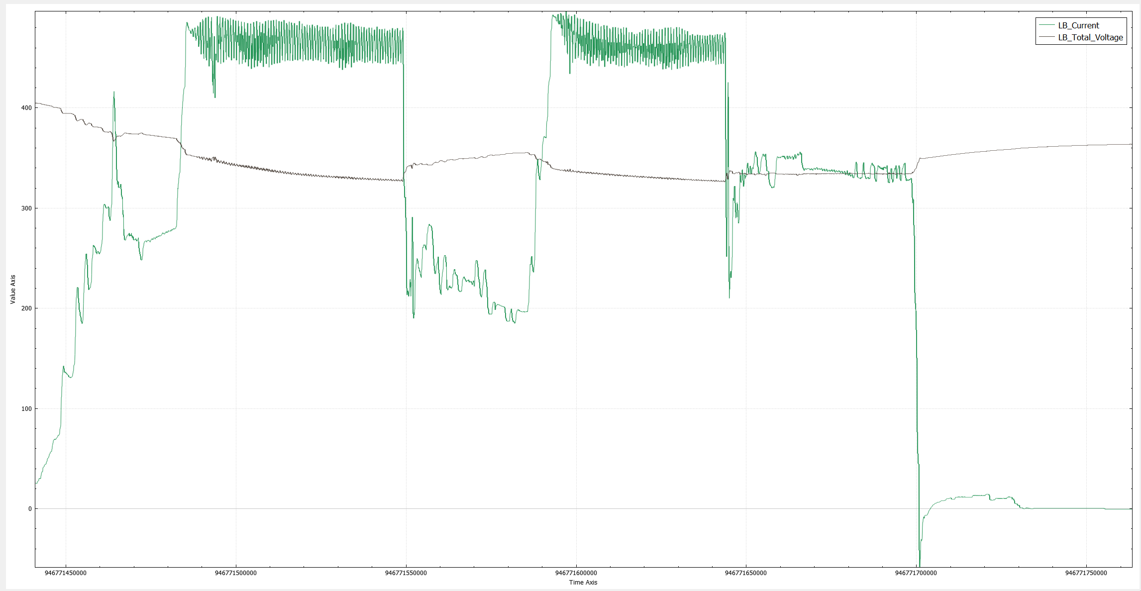

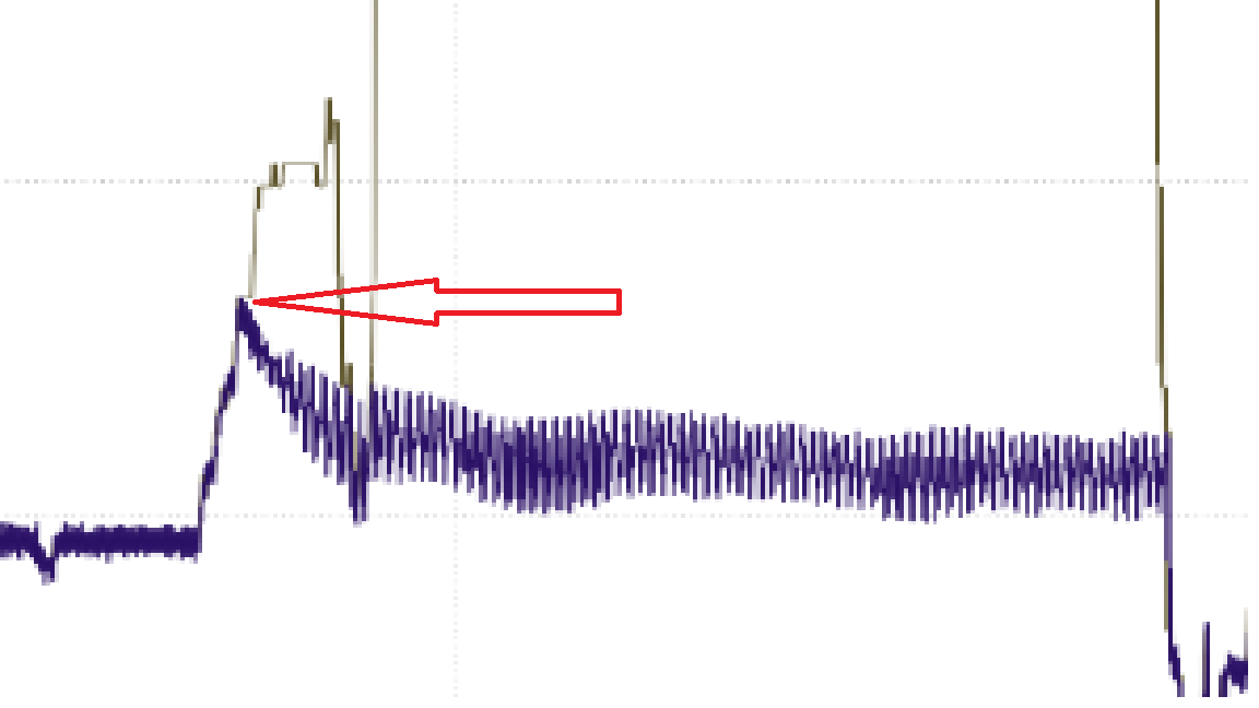

Reveiwing the CAN log with a Leaf ZE1 dbc.
You can see we request more torque yet the inverter refuses to give it to us.
The battery info reported during the run.
As you can see we are just maxing out the inverter. The average power of the two flat bits are 150-160kw give or take
One option to try, increase the power limit in message 0x1DC slightly if you are confident nothing in the battery setup gets hot.
It is possible the inverter will draw more, or it will also have its own internal limit.
@tom91 thats great, thanks for the feedback - after looking at it Im interested as to what is actually going on here....
The actual and requested follow very nicely until about 260NM when there is a big departure. Is this because we run over the set KW limit or because the requested value at that point departs from an MAX_NM setting? either way Im assuming the resultant 'fuzzing' is some internal management algorithm trying to keep things on the straight and narrow.
as a question for all then, would it be best to keep the requested torque value underneath the 260NM 'limit' in code and get a smoother delivery or increase the KW value to try and raise the point at which the fuzzing comes in?
