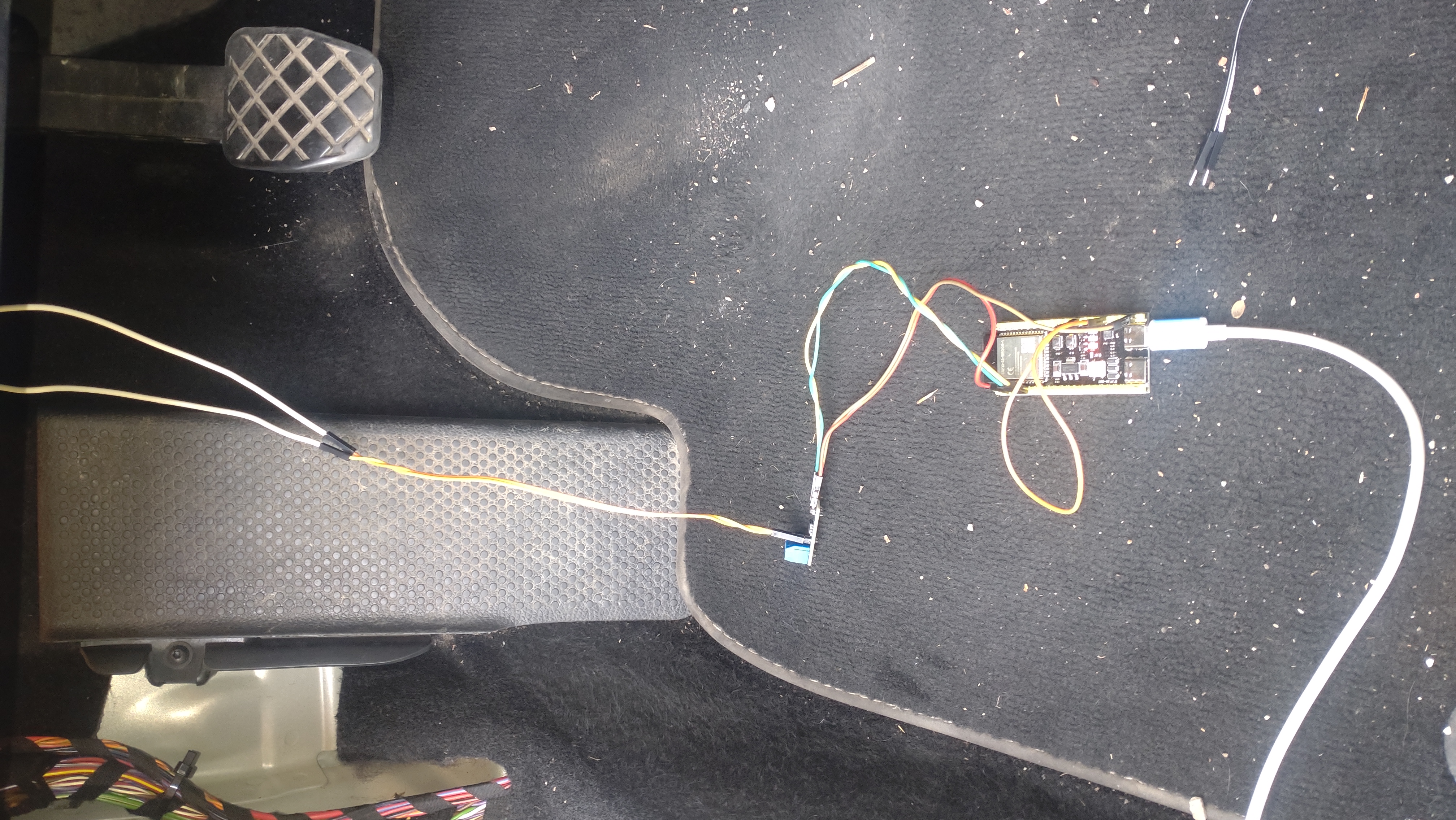

Really dissapointed with my setup (and lack of fundamental knowledge) . I 'gave up' on trying to setup a second board, as I can't even get the original wifican scketch to upload without error messages. Numerous Arduino uninstallations etc etc. The CanCrocodile will have to wait.
Now, things seem to have gotten worse. The original ESP32/Wifican setup runs great with direct connection CanH and CanL sniffing an instrument cluster on my desk. Even can make the Rev counter move to various positions.
To feel like I am 'moving forward', I decided to connect it to my Golf 6 Comfort Can Bus. Guess what, no data is being captured. I tried connecting after the Diag socket (the front door junction and the Body Control Unit) - nothing. Swapped CanH and CanL around, even the RX and TX.
I tried various speeds - nothing.
Is it possible that I need to remove/shunt the SN65HVD230 onboard 120 Ohm resitor?
In the meantime, the VW charger and Charger flap sit waiting gathering dust.

There are multiple CAN busses in this car. You write "after the diag socket", this sounds like the diag CAN, and this is silent if you did not connect a diagnostic tester to the OBD socket. The komfort CAN you find eg in the front doors.

It's the comfort can in the front door. I also tried at the body controle unit (comfort).

Some ideas:
1. check whether you found a CAN bus. While disconnected the battery, use an ohm-meter to check the resistance between CANH and CANL. Should be around 60ohms, because the CAN is nominally terminated with 120ohms at each end. May be ok to see something between 120ohms and 50ohms.
2. using a two-channel-oscilloscope, check the CANH and CANL while the car is turned on. You should see both lines on the same level (around 2 to 3V) very often ("recessive state"), and should see the CANH going at least 1V up and in parallel going CANL 1V down ("dominant state"). The width of the pulses should be multiples of 2µs in case of the usual 500kBaud.
3. check the CANRX of the transceiver. Using a two-channel-oscilloscope, one channel on CANL, one channel on CANRX. The CANRX should show the same signal as CANL, but with higher amplitude (0V dominant, 3.3 or 5V recessive).
4. check whether the CAN controller sends an ACK bit: Using two-channel-oscilloscope, one channel on CANRX, one channel on CANTX. Most of the time the CANTX should be at high level (3.3 or 5V). At the end of a message on CANRX, the CANTX should have a single low-pulse (2µs in case of 500kBaud). This is the ACK bit. If this is visible, the CAN controller is correctly configured with the correct baud rate.
