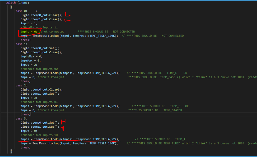

Temp Calibration/Mapping issue when using Tesla SDU
I am getting very odd temp readings, and have been tracing the source code for reading the multiplex vs the hardware layout on the actual board (SDUv4).
There seems to be some strangeness in the mapping at least in 4.76 against the SDUv4 board... Am I interpreting this wrong? If even the logic is inverted, things don't seem to line up....
Logic Table for 74HCT4052 multiplex on SDUv4
And here is the source with **** comments (I'm assuming .Set is a pulldown and .Clear is a float high)
Re: Temp Calibration/Mapping issue when using Tesla hardware...
I think this mapping is actually correct for the LDU. The issue is the mux inputs are different for the SDU in both pinout and sensor type, but I can't see a hardware switch in code for running on the small drive unit...

Just to update if anyone is interested. I found that S1/BMS_IN is not switching. You would expect to see it cycle logic states as the stm polls the multiplex. S0/ERR_OUT IS toggling. This means I guess some of the analog value is being read from an inactive input.
I flashed a simple test program to output pulses on both S0 and S1 and that works fine, so it's not the hardware...
Wondering as BMS_IN is used as an input on some hardware platforms, whether this is being initialised as an output correctly?
Re: Tesla Small Drive Unit Support Thread
I get the feeling I am going to be talking to myself here, but spent some more time on this tonight.
Compiled a new version of openinverter with the temp values set statically - motor now works normally without any temp derate. I can only assume the SDU sensors are simply not handled differently from the LDU in software and therefore have no chance of being correct. Still a little confused as I can't be the first person to come across this... A forum search didn't turn up much.
I will try and fix the mux select logic issue and then map the correct sensor inputs. Anyone know the best way to contact Johannes to see if we can put in a fix for all?
I'm still new to this, so if I'm barking up the wrong tree here - please let me know!

Sounds like you have uncovered a major bug so first off thanks for sharing. I too doubt you're the first to find this. Most likely discovered and patched but not shared
I'll ping Johannes and we'll get it sorted.

I'm able to get sensible real values at least from TEMP-A & FLUID now by setting fixed low mux states. Next step - figure out why temp1_out.Set() isn't actually sending the pin high.
JCurve isn't quite right for the SDU fluid temp sensor, (reading 20c at actual 11c). Will try and get some measurements to build a curve for it. Unless anyone knows what sensor it's using?

I'm really confused then! I can't believe there are 280 out there and nobody has picked up on tmphs derate, it would be pretty obvious... Perhaps the temp1 switching is a unique issue to my setup and people just didn't notice/care about mis-mapped sensor readings? Or maybe this is only manifested in newer firmware?
Either way, If anyone is able to power up an SDU board and just scope S1/Pin 9 on the temp sensor mux IC that would answer that...

The heatsink temp sensors are the same in both large and small du. Also the mux pattern should he the same at least for the heatsink side of things.
Yes, good point - all 52K type on 0,1,2 - but port 3 grounded out HS side on LDU (2Y3) and both sides on SDU (1Y3/2Y3)
The issue I think on the HS side is S0+S1 both high would pick the 0V state on input 2Y3 & this is polled for in case3. This would read as temp 100+ If I'm reading the sensor curve correctly and therefore the max function would return this as the max hs temp...
I found in the source that .set() is commented to set output High, so perhaps it's not inverted as I thought. Which means that case0 and case3 appear to be swapped, or maybe a mux chip with an inverted input has been used in the past? Fortunately this is all academic as S1 never goes high for me! I'll pull the inverter off the drive tonight and confirm the logic states.
