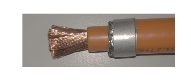

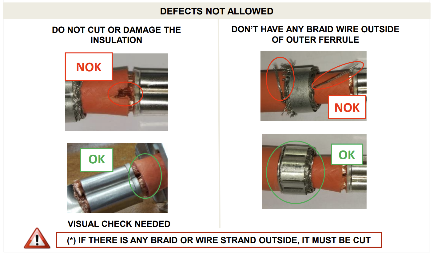

Just to get an idea on how detailed process crimping a shielded HV cable is, you can check this Aptiv RCS800 assembly instriction just as a reference.
This snip is from the document, you need to be also careful that you don't cut the insulation in a wrong place.
Yes it may seem fine, but with HV you can't really go with gut feeling. A slit in insulation means that the angry pixies can get out there and then it's no fun trying to find out where's a problem after a while (because it may not cause an issue right away and the problems can occur intermittent)
Also check that you have enough creepage distance between the shield and the end of the middle insulator. Usually these are specified in such assembly instructions which not all manufacturers have openly available.
Pages 25-33 have good pictures of steps and pics of defects not allowed on page 32 are something that can be used more generally as rules on what's good and whats not.
