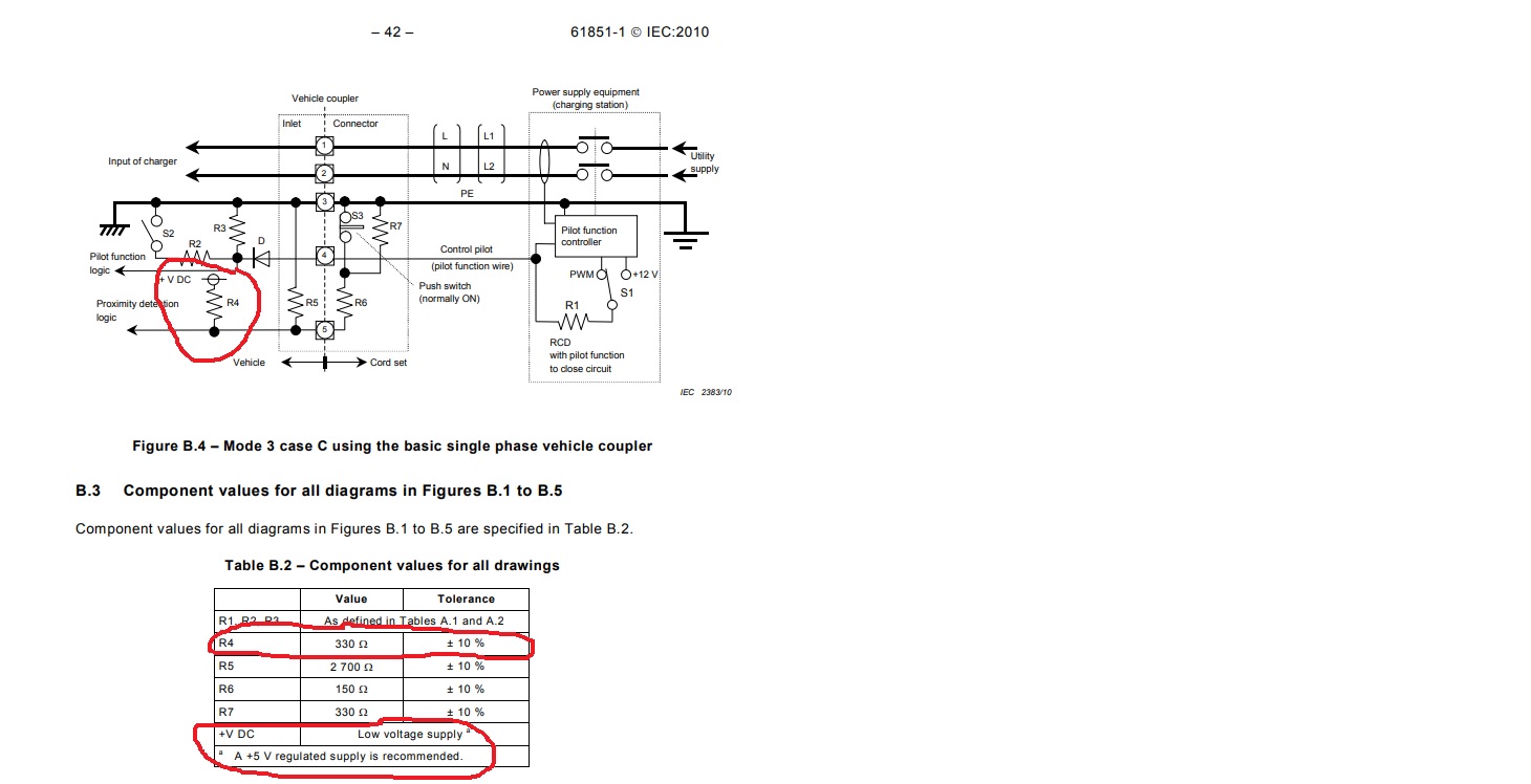

Sorry to go off topic a little but would you be able to guide me to where the 330 Ohm resistor is referenced?uhi22 wrote: ↑Sun Nov 24, 2024 6:10 am This means the car has a 10k pull-up to 5V. The SuC V3 seems to expect something in the range of the official 330 Ohm pull-up.
The first idea would be to add an additional pull-up to a 5V source, to make the SuC happy. But this would most likely irritate the car, it would see a higher voltage and interpret this as "no plug seen". I guess some "resistance-translation" needs to be invented.
I've done a bit of a dive into the standards but could only find an explicit reference to a 330 Ohm resistor in the sections related to CCS1 (from memory, was a couple of months back).

Re: Charging works on CCS2 Tesla V2 but not V3
viewtopic.php?p=66305#p66305
discusses the 330ohms. Not sure whether there is a 100 percent waterproof specification.

re:330 ohm resistor. Here is a screen shot of proximity circuit for CCS1 from IEC 61851-1 2010 standard. The value should be 330 +- 10%. From web address

Would love to see the CCS2 circuit -- that would be a slam-dunk.
We will probably never know what eventually forced them into some action (assuming a solution does arrive or its not just more of there BS) Probably a number of factors. "Ludicrous feed" was hinting there was a class action pending or they just got sick of peddling there BS and ran out of excuses. Maybe hundreds of people with home made adaptors was not a good look for the brand.sstanleyau wrote: ↑Thu Feb 20, 2025 11:46 am Looks like this will become academic -- perhaps it played a part in prompting some belated action:
re: CCS2 circuit
I'm sure it is in the latest standard. Just seems a bit rude to fork out a couple of hundred dollars on the off chance it is explicitly defined.
