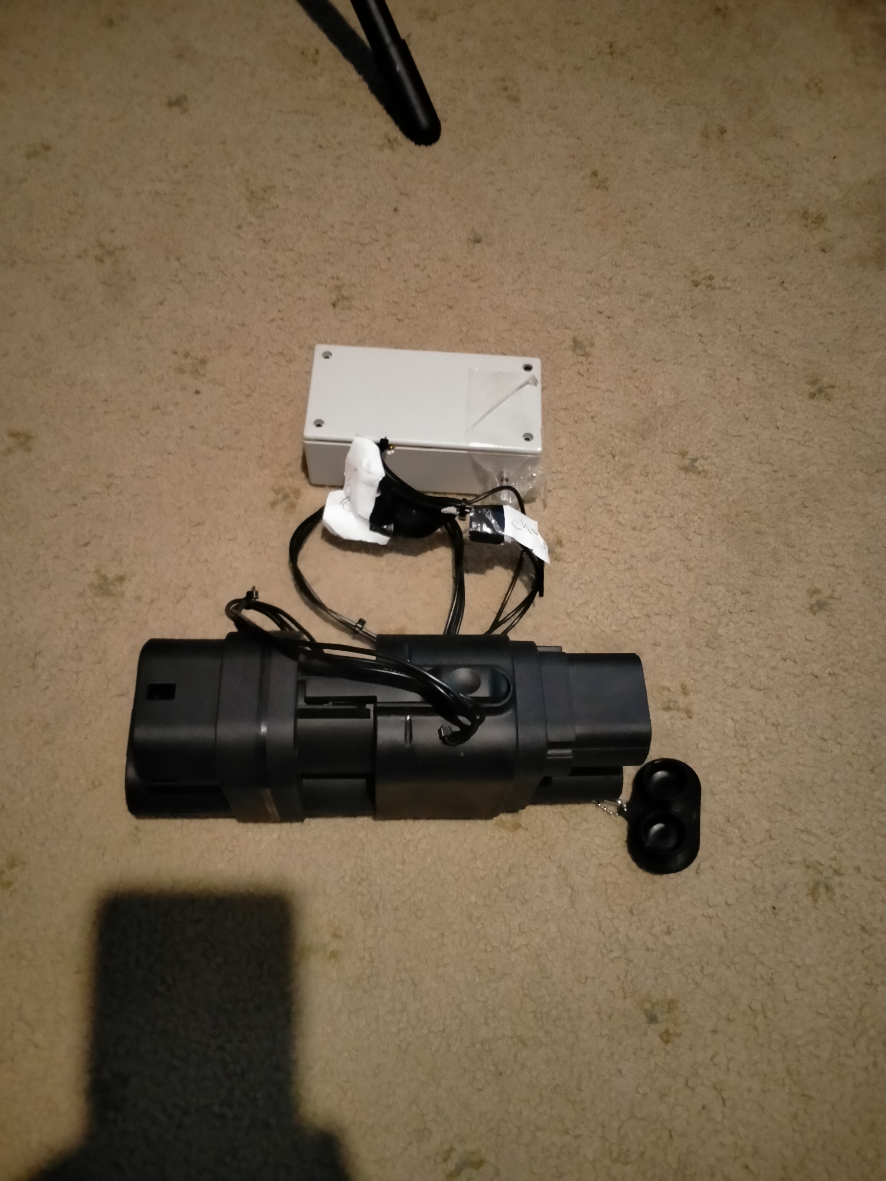

I would just like to confirm that the only issue is that the pull up resistor is incorrect in the Atto3. Thanks Uni22 and Johu, I appreciate the help.
Here is a quick description of my fix. As it is a relatively new car I wanted to avoid messing with the wiring so went with an external adapter. As there are no commercial ccs2-ccs2 adapters (why would there be!) I bought a CCS2->CCS1 adapter as well as a CCS1->CCS2 adapter. Connect the CCS1 ends together Modify the wiring on the PP (proximity pin) at either end. When plugged in the car still sees 0.65V but the Tesla SC sees about ~3.6 I also incorporated a check circuit so that if the PP is lost at the car it also dumps the PP at the charger.

Re: Charging works on CCS2 Tesla V2 but not V3
Give me a couple of days and I will draw something out. However a working circuit is very simple. You need an adapter with CCS2 pinouts at either end. On the car end you simply have a 1500 ohm resistor from the PP to PE pin. So the car thinks a charger is plugged in. At the charger end you could get by with a 9v battery feeding a 5v regulator. From this I have a 330ohm resistor to the PP pin. And then a 4.7k resistor to the PE pin. You probably don't even need the 4.7k resistor. When the charger is plugged in the charger sees about 3.7v which is in the preferred range. All other pins on the adapter go straight through. So nothing really to go wrong.
However being over cautious and home built I check that the car end is about 0.65v and using an Arduino drive a relay so that the charger end drops out if you pull the adapter from the car. Probably not needed as the CP line is broken as well. I am redesigning this to just use a comparator chip and a transistor to drive the relay.
Just used some adapters CCS2-CCS1 and CCS1-CCS2 from ali-express. I think about $180 and $120 AUD. They appear well built. It is surprising there is no play at all when the CCS1 ends are joined together. Make sure they have a thermal cut-out on the cp pin. It is just another cheap electrical component. The adapter didn't even get warm when when running at 89Kw which is well under the 250 Amp rating for both parts. However you will need to pull them both apart to massage the PP line to add in the custom circuit at the charger end.
I reckon you could also use a CCS2-NACS and NACS-CCS2 combination.
A single CCS2-CCS2 adapter would be better, so if anyone knows a Chinese manufacturer who could produce one I'm interested.

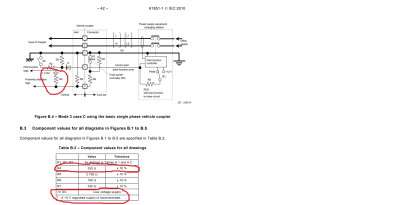

Sorry to go off topic a little but would you be able to guide me to where the 330 Ohm resistor is referenced?uhi22 wrote: ↑Sun Nov 24, 2024 6:10 am This means the car has a 10k pull-up to 5V. The SuC V3 seems to expect something in the range of the official 330 Ohm pull-up.
The first idea would be to add an additional pull-up to a 5V source, to make the SuC happy. But this would most likely irritate the car, it would see a higher voltage and interpret this as "no plug seen". I guess some "resistance-translation" needs to be invented.
I've done a bit of a dive into the standards but could only find an explicit reference to a 330 Ohm resistor in the sections related to CCS1 (from memory, was a couple of months back).
viewtopic.php?p=66305#p66305
discusses the 330ohms. Not sure whether there is a 100 percent waterproof specification.
re:330 ohm resistor. Here is a screen shot of proximity circuit for CCS1 from IEC 61851-1 2010 standard. The value should be 330 +- 10%. From web address
Thank you! I have made the adaptor and it works. I had one problem with the CCS1 to CCS2 part the Pp pin was too short to make contact with the Tesla plug. When I remade the pin 7 mm longer it then worked. I got my adaptors from Aliexpress but it is worth checking the pin lengths.
