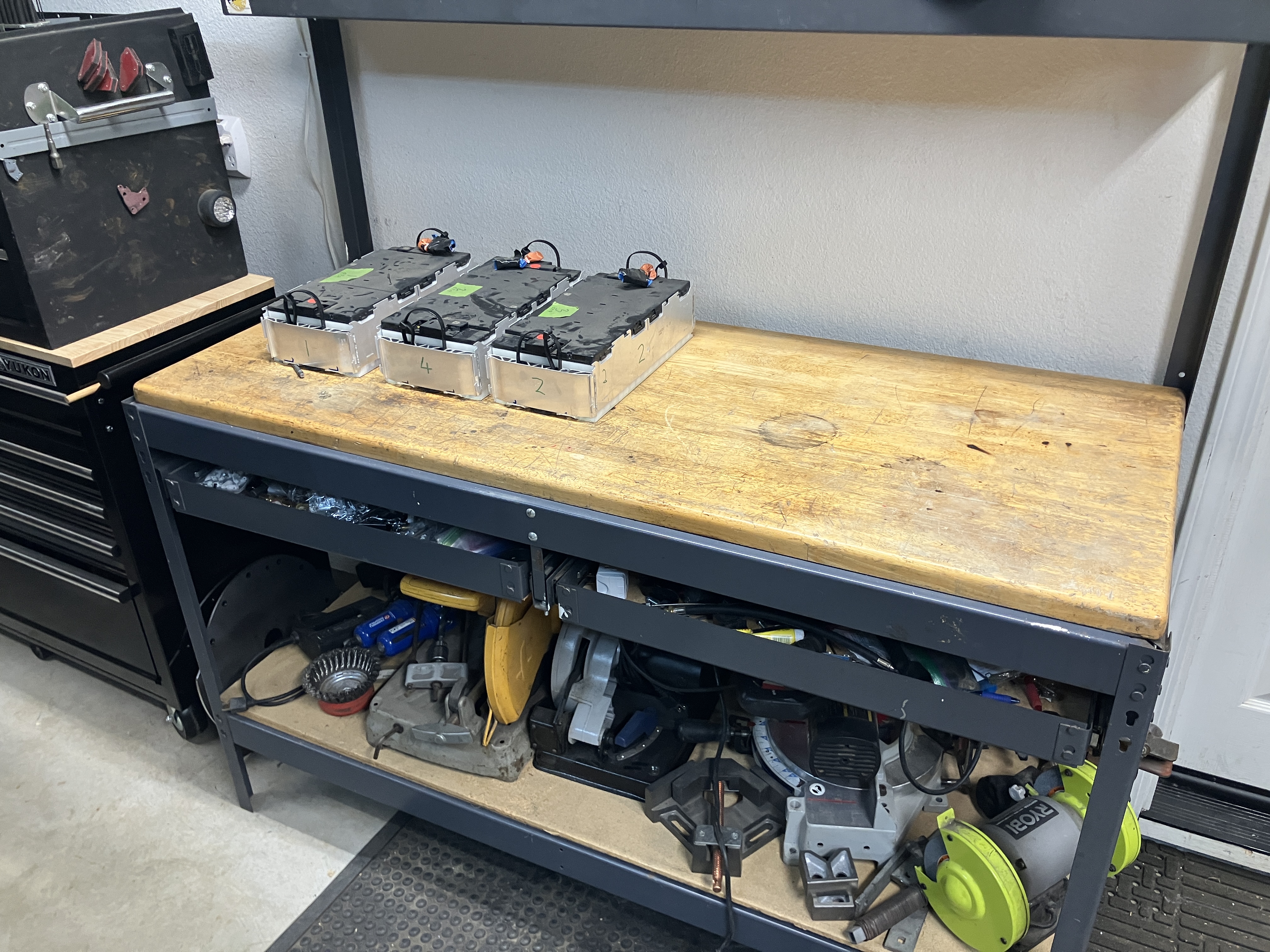

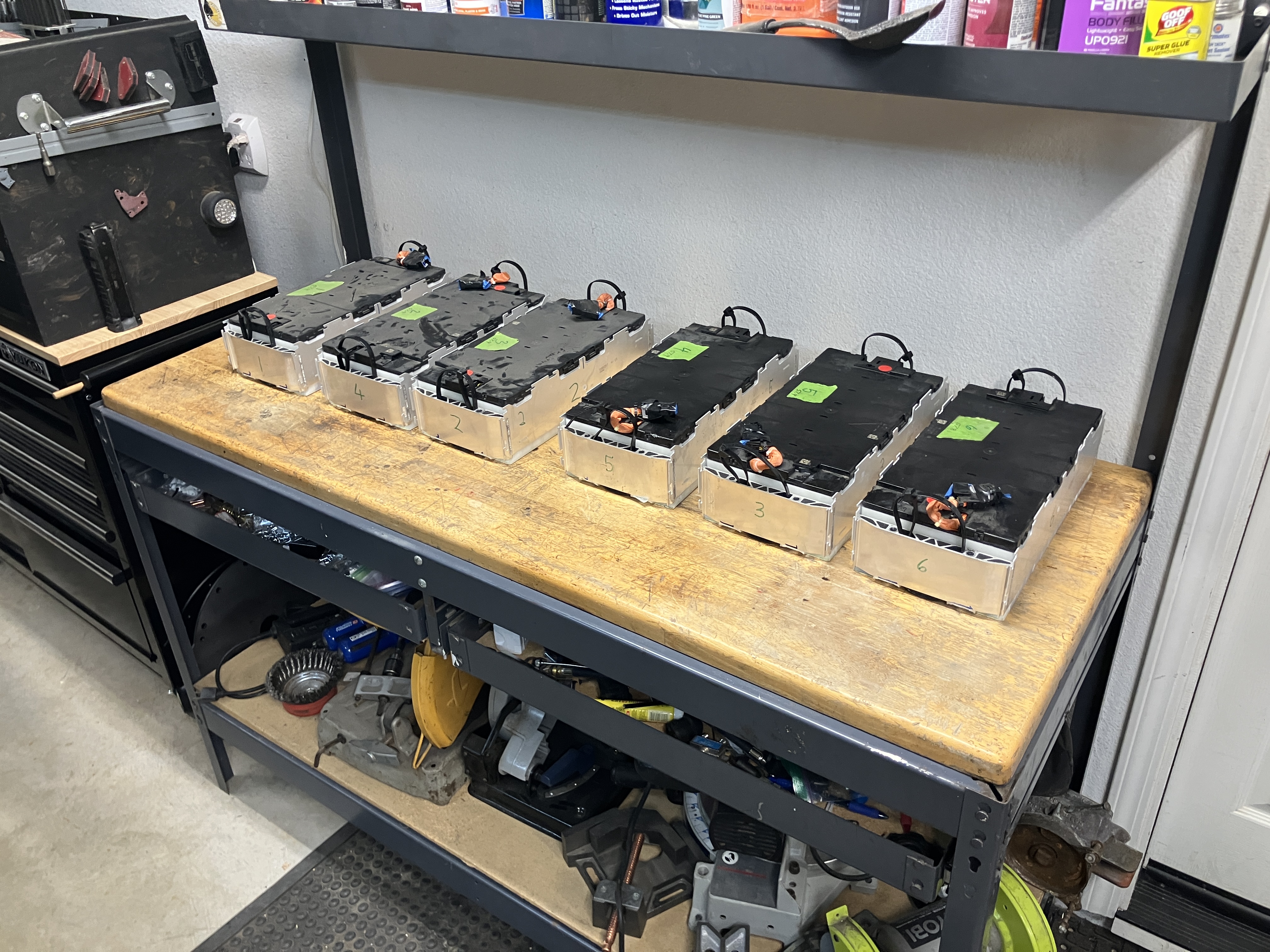

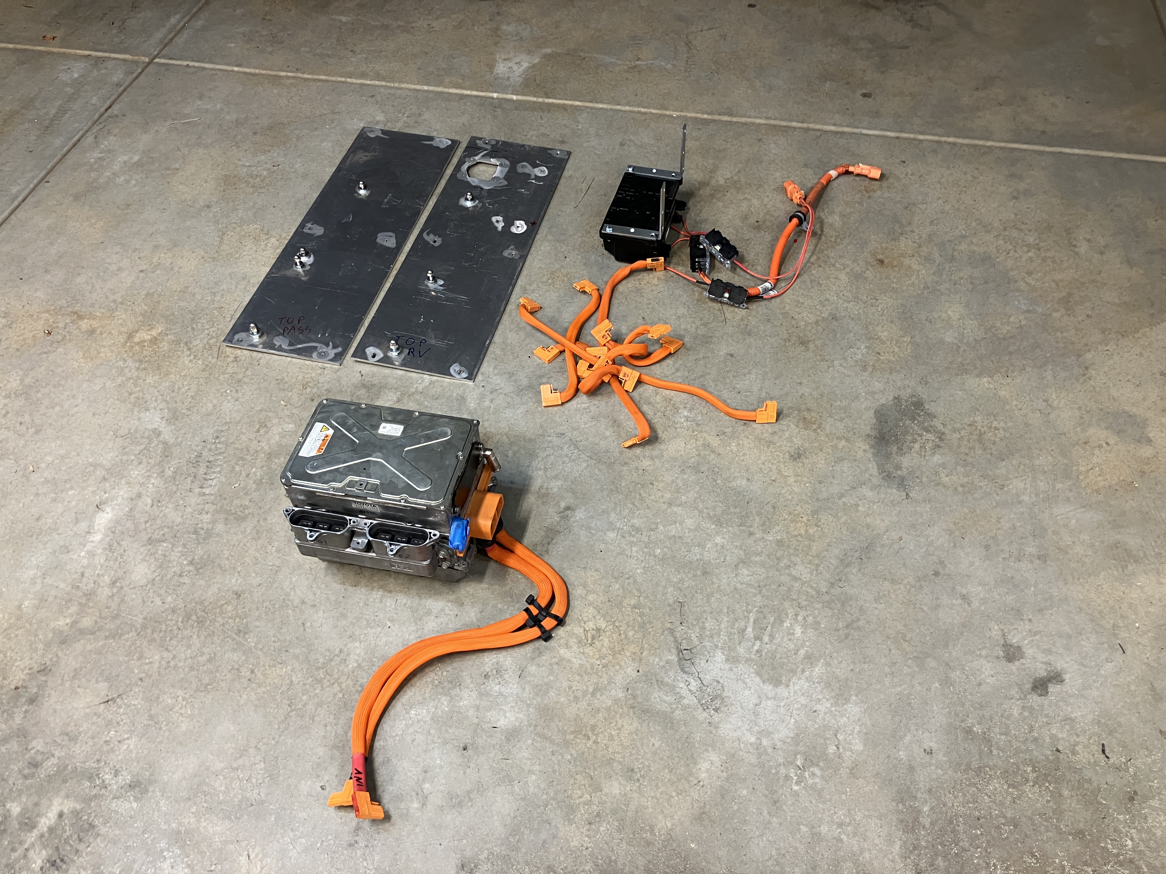

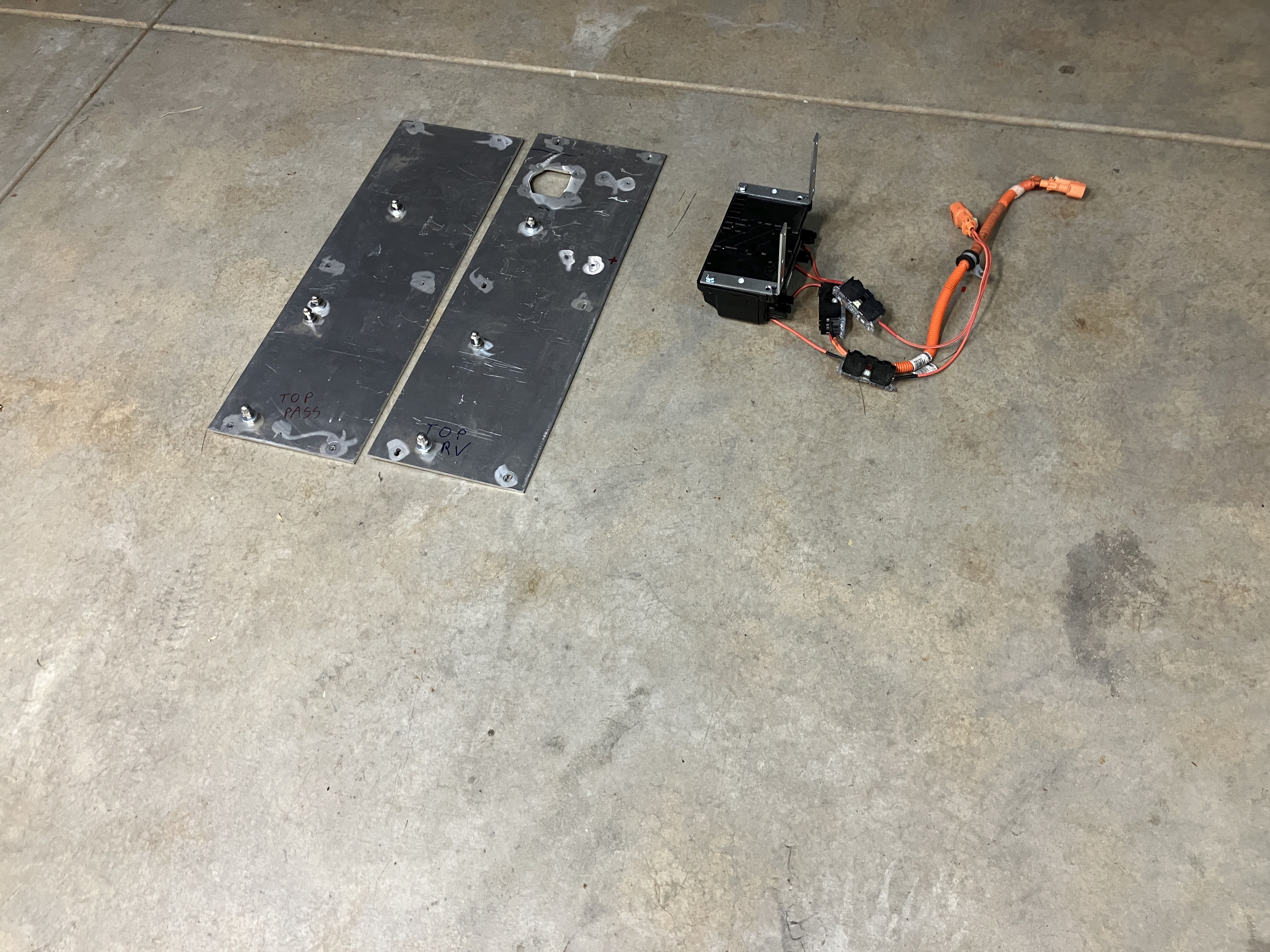

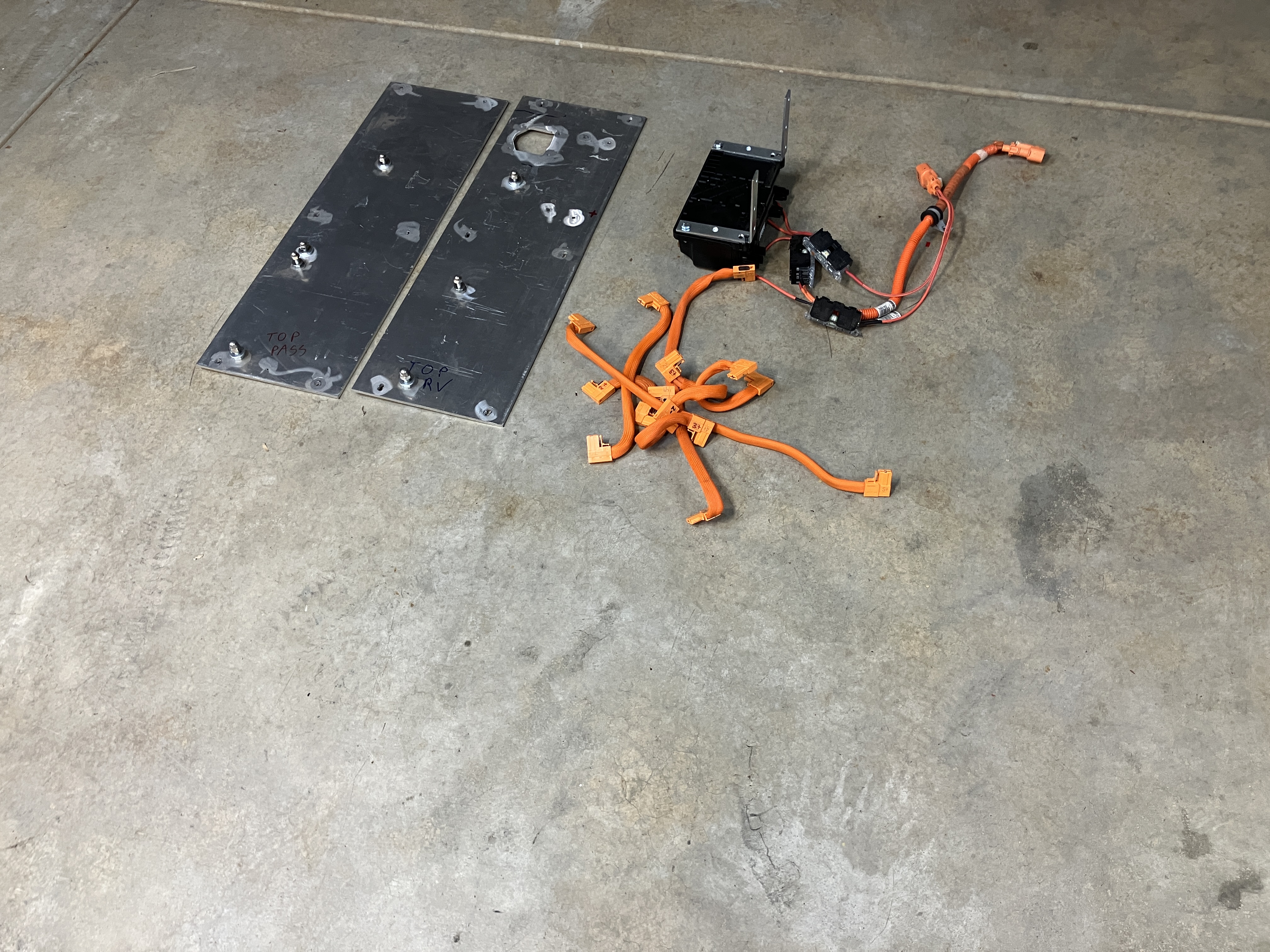

on this episode we finally removetize the old BMW high bred 9 kWh battery pack
... and create a tripping hazard in our threeeee car garage

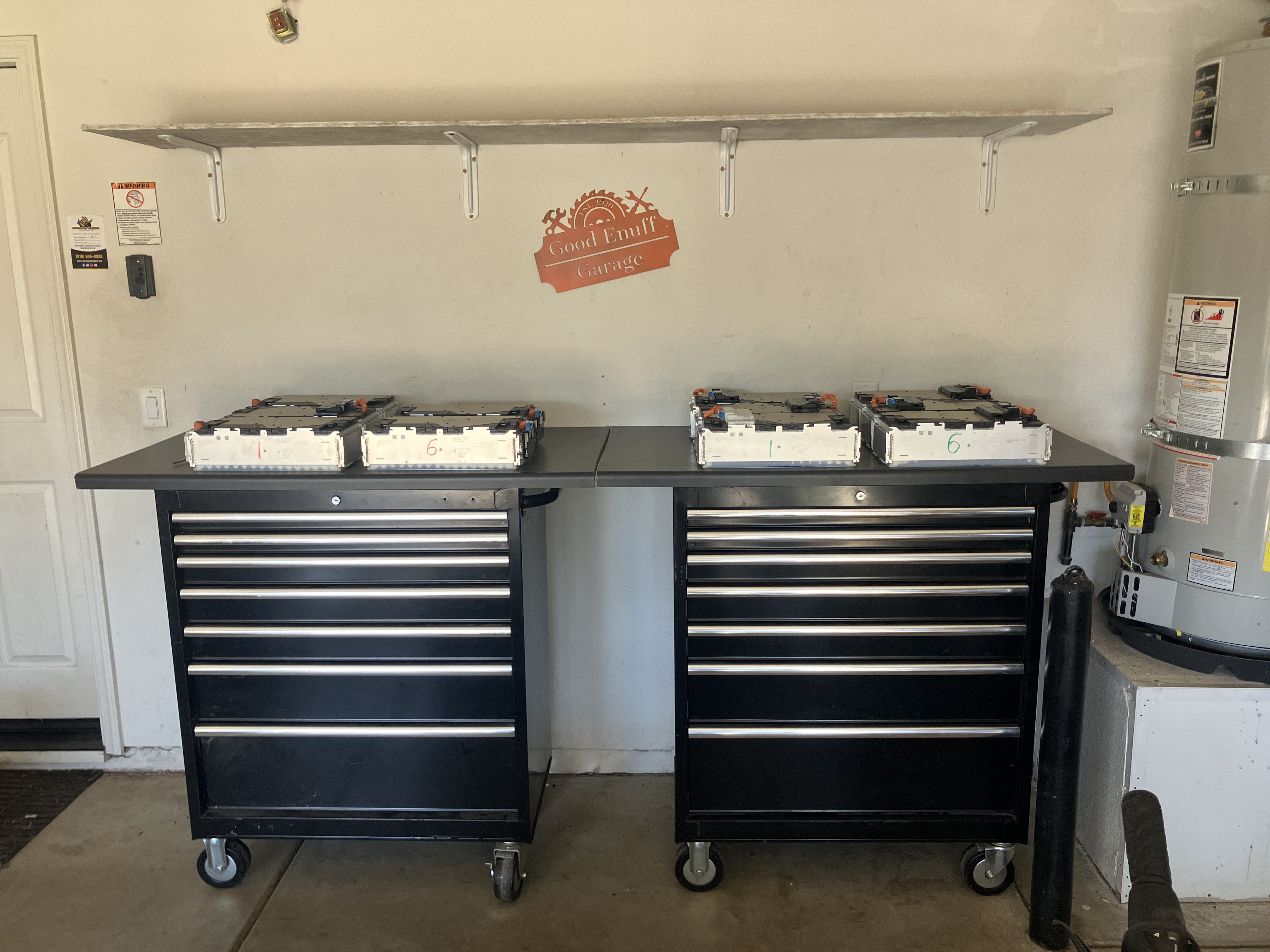

sometimes you have to take the little wins, like hanging up a shelf, am I right fellas ?
"Squint" from Tilt Construction LLC knocked it out in only a couple hours
Alibro
Posts: 1052
Location: Northern Ireland
Has thanked: 416 times
Been thanked: 277 times
Post by Alibro »
Gregski wrote: Wed Nov 27, 2024 10:27 pm sometimes you have to take the little wins, like hanging up a shelf, am I right fellas ?
Just so long as it doesn't fall of the wall first time you set a screwdriver on it. :shock:

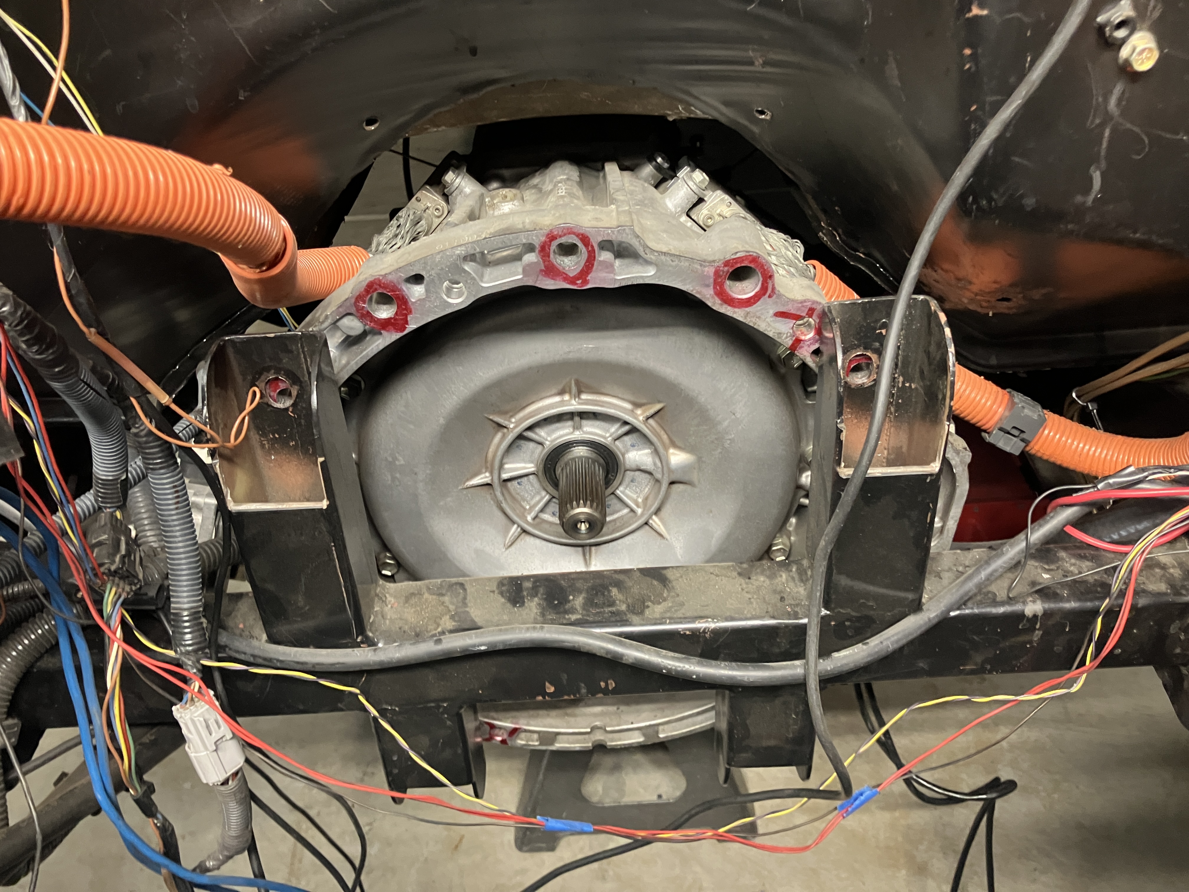

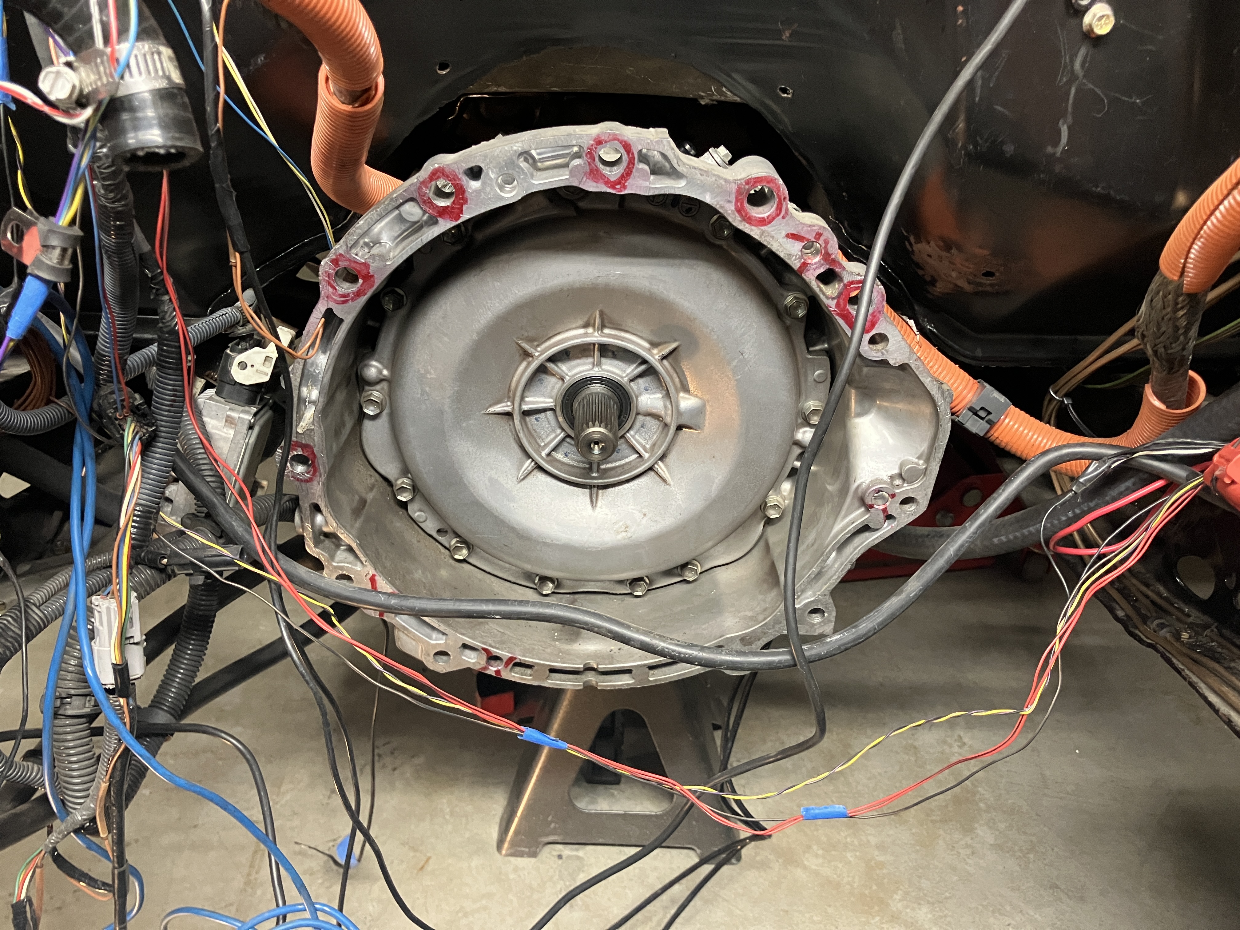

in this video The Greg removes more stuff off of his electrically converted Chevrolet (pronounced: "GMC") pick up truck in order to be able to access the Lexus GS450h transmotor input shaft
well hopefully this is all that had to be removed...

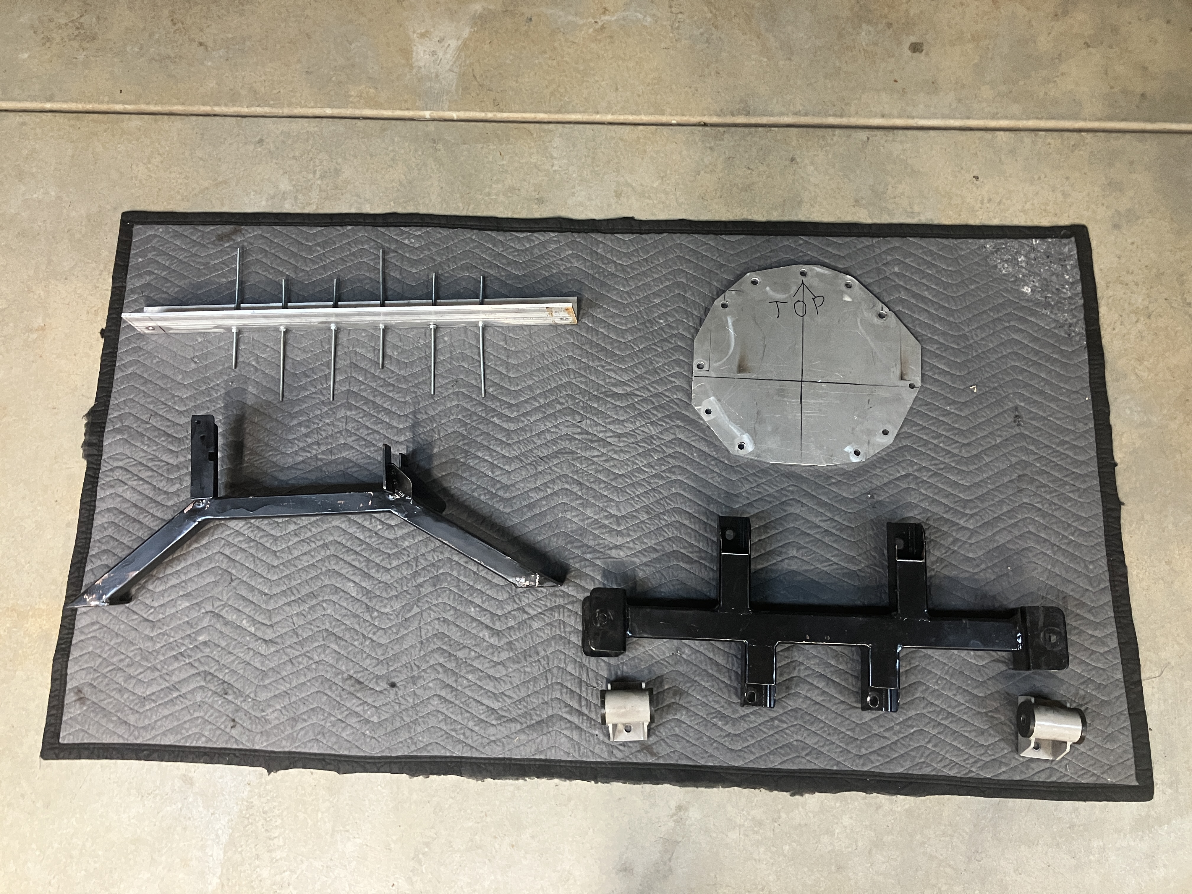

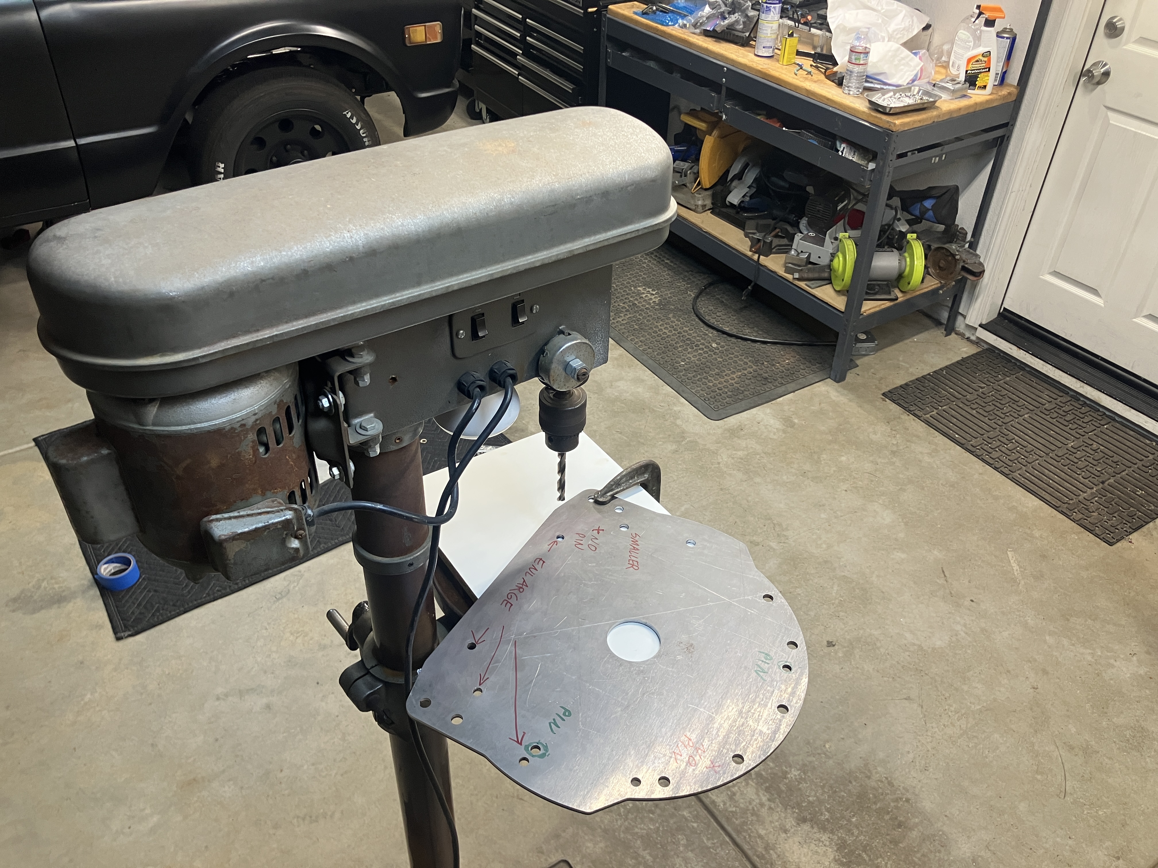

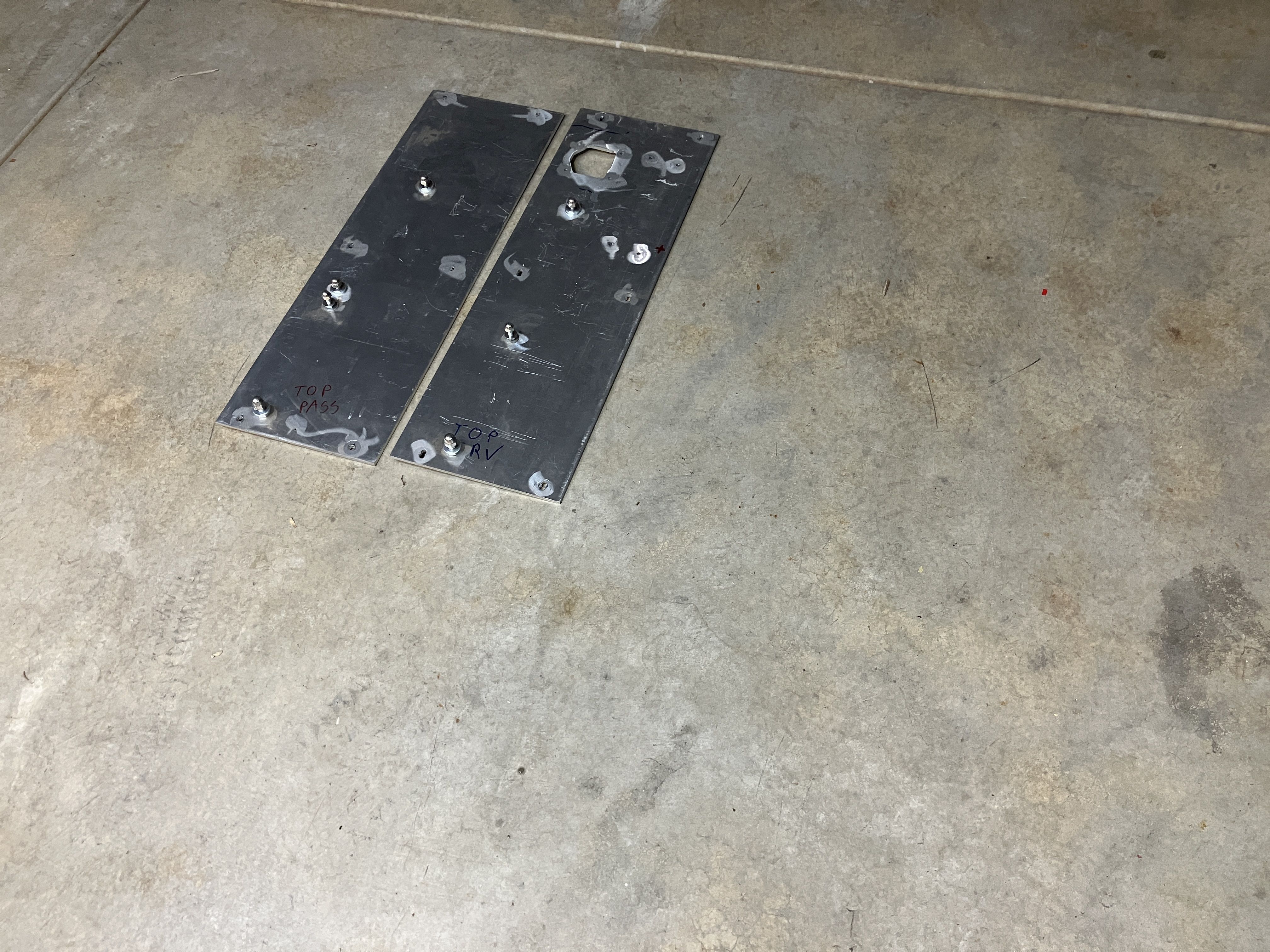

new trans plate time - NTPT
Posts: 1040
Has thanked: 427 times
Been thanked: 267 times
Post by MattsAwesomeStuff »
Picking up the hand crank drill off of the drill press platter got me.
Seeing you trace out a pattern in the middle of the sheet had my hoarder's anxiety blaring a klaxon.
Gregski
Posts: 2873
Has thanked: 530 times
Been thanked: 1189 times
Post by Gregski »
MattsAwesomeStuff wrote: Wed Dec 04, 2024 9:39 pm Picking up the hand crank drill off of the drill press platter got me.
Ha ha, I appreciate that, as I went to 7 different Thrift stores looking for a "vintage" hand drill, only to find out my buddy Pontiac Mike had one but he lived all the way across town, so a joyful cross town trip later during rush hour, that beauty was mine.

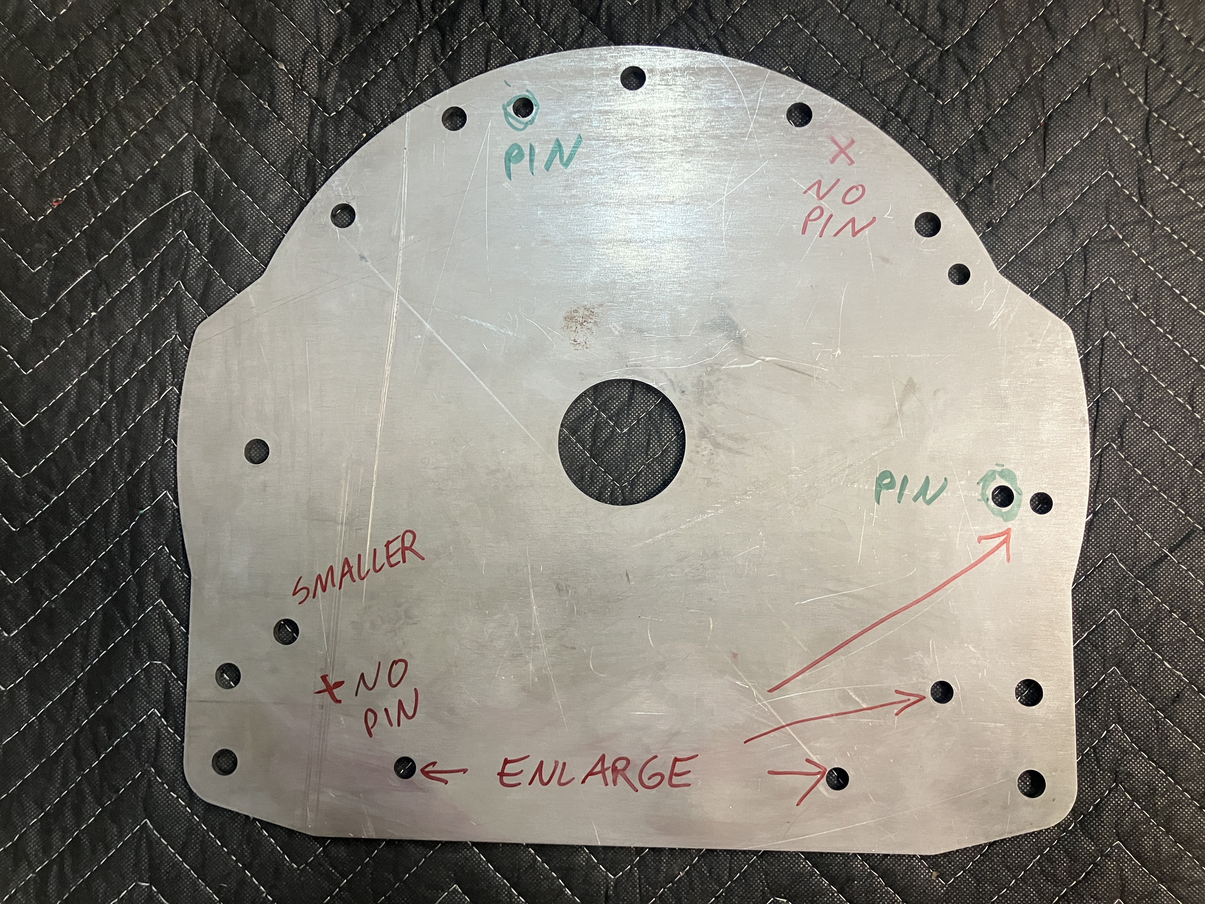

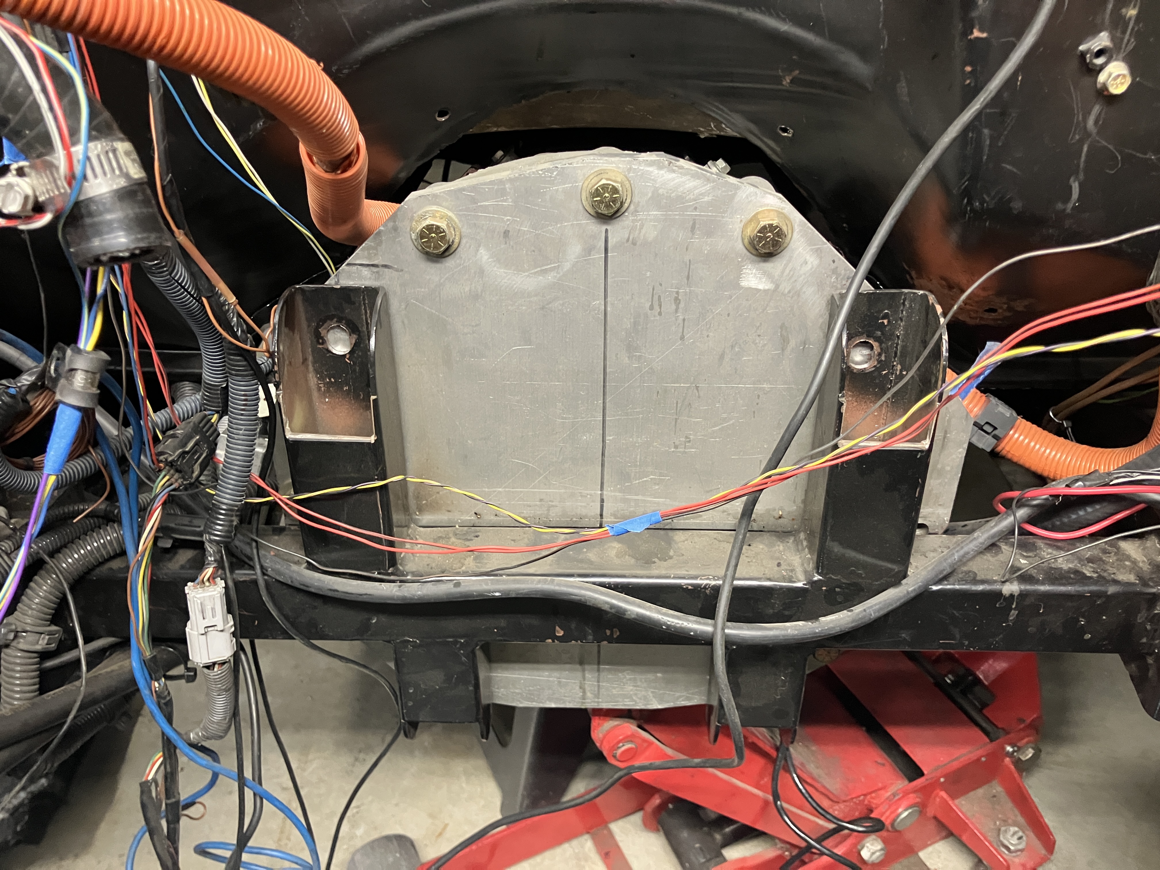

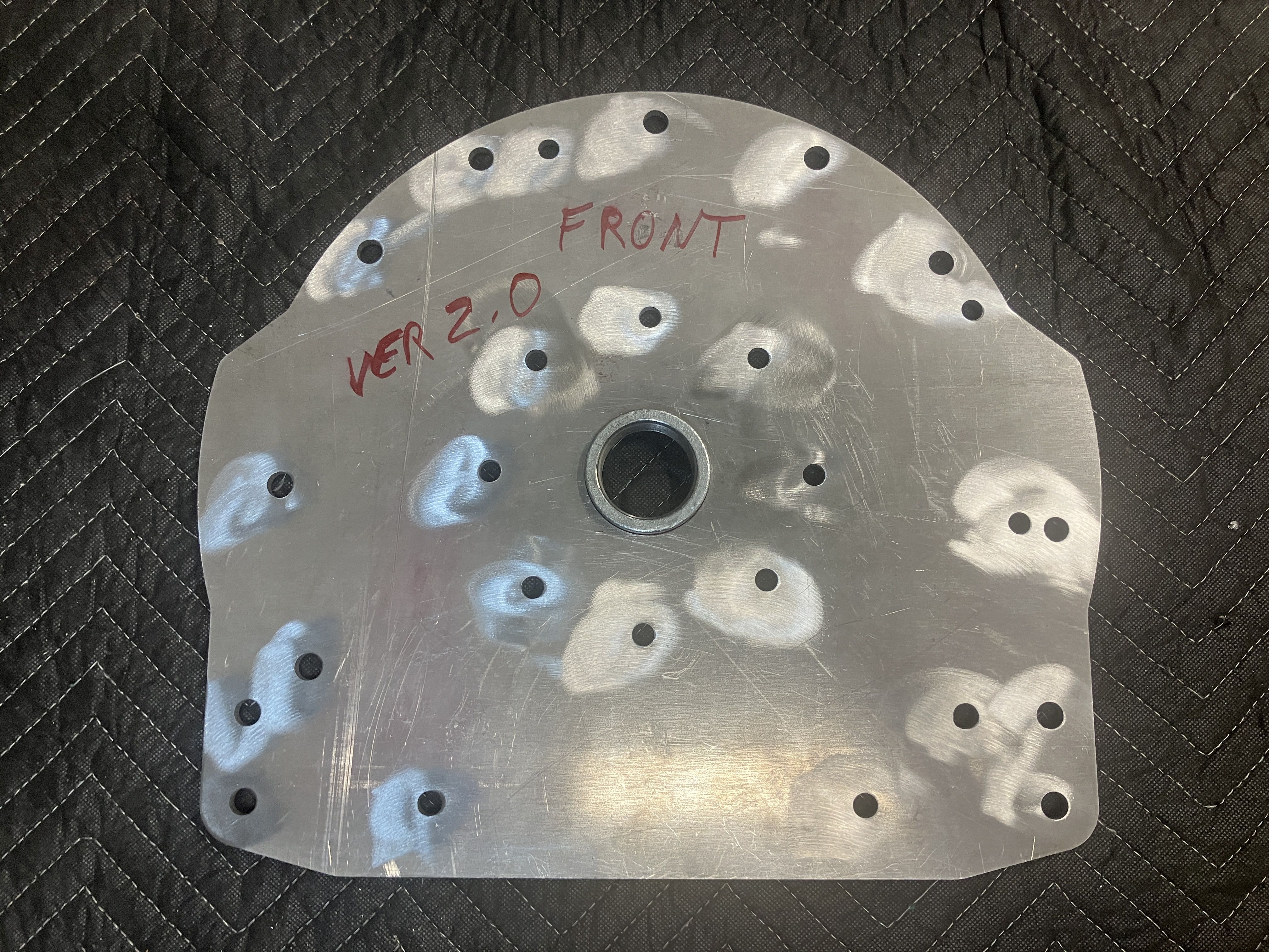

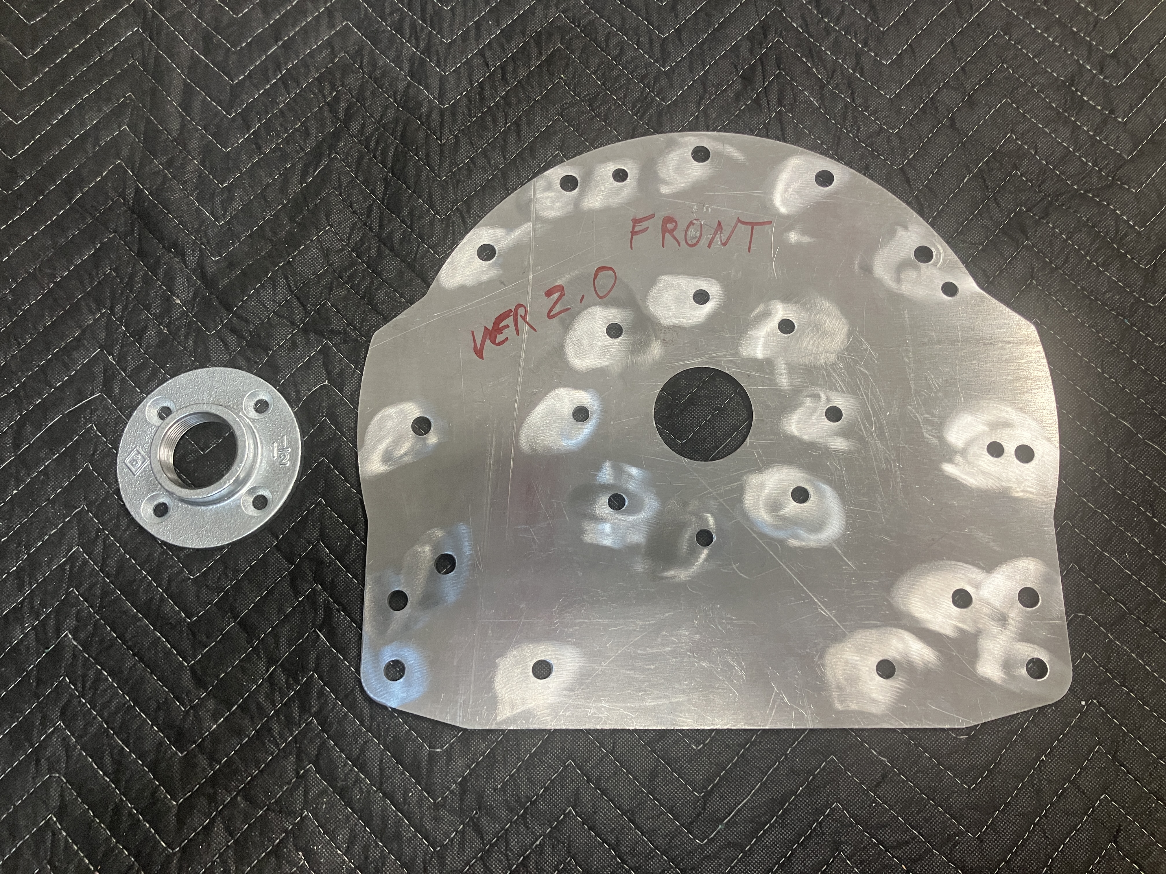

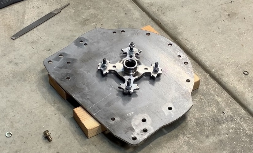

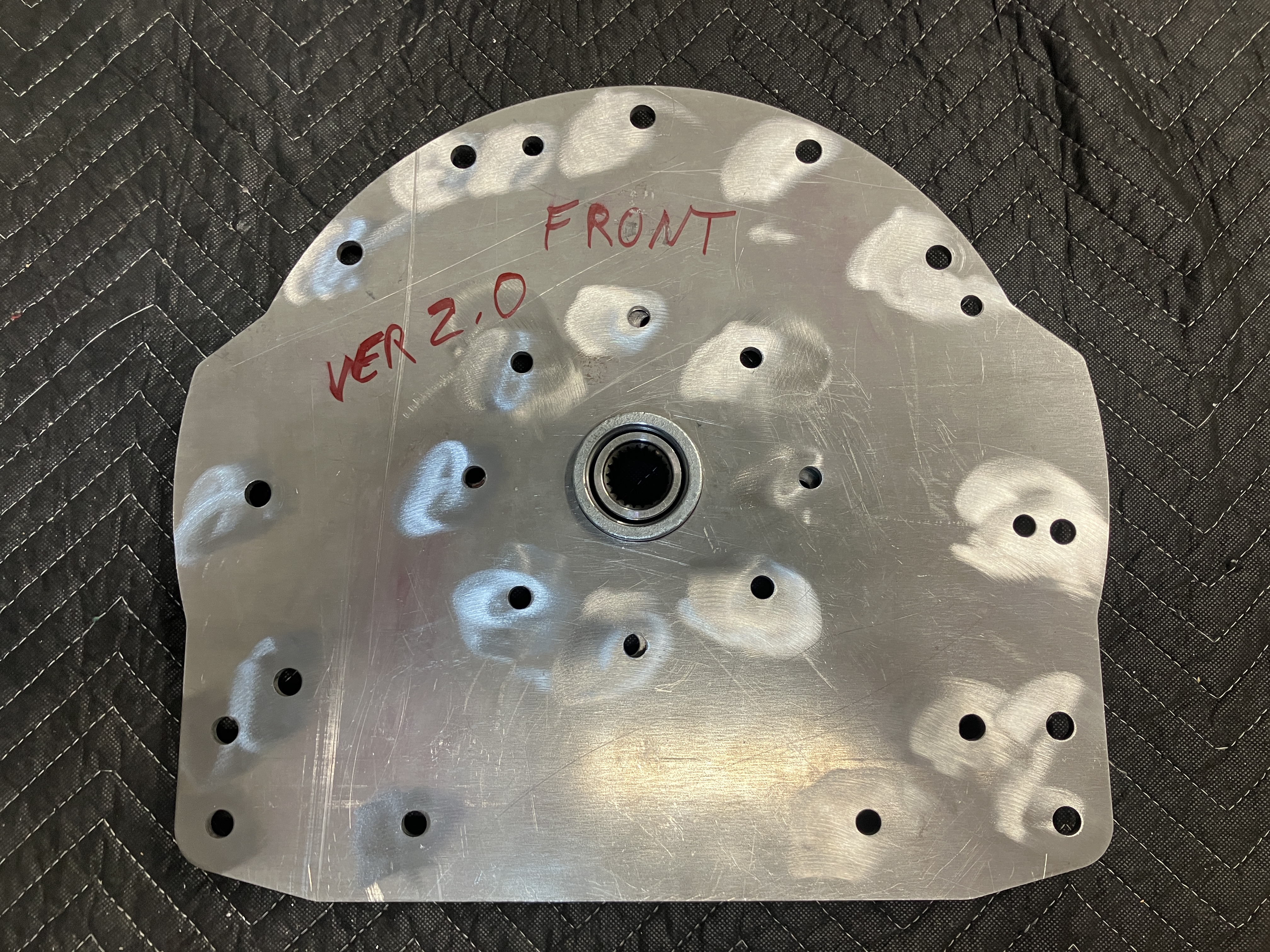

GMC Electric Truck Lexus Transmission Plate Improvements watch me improvetize my crappy aluminum plate using a $300 dollar steel template
please forgive a slight overlap with this other post you may find useful: GS450H Adapter Plate

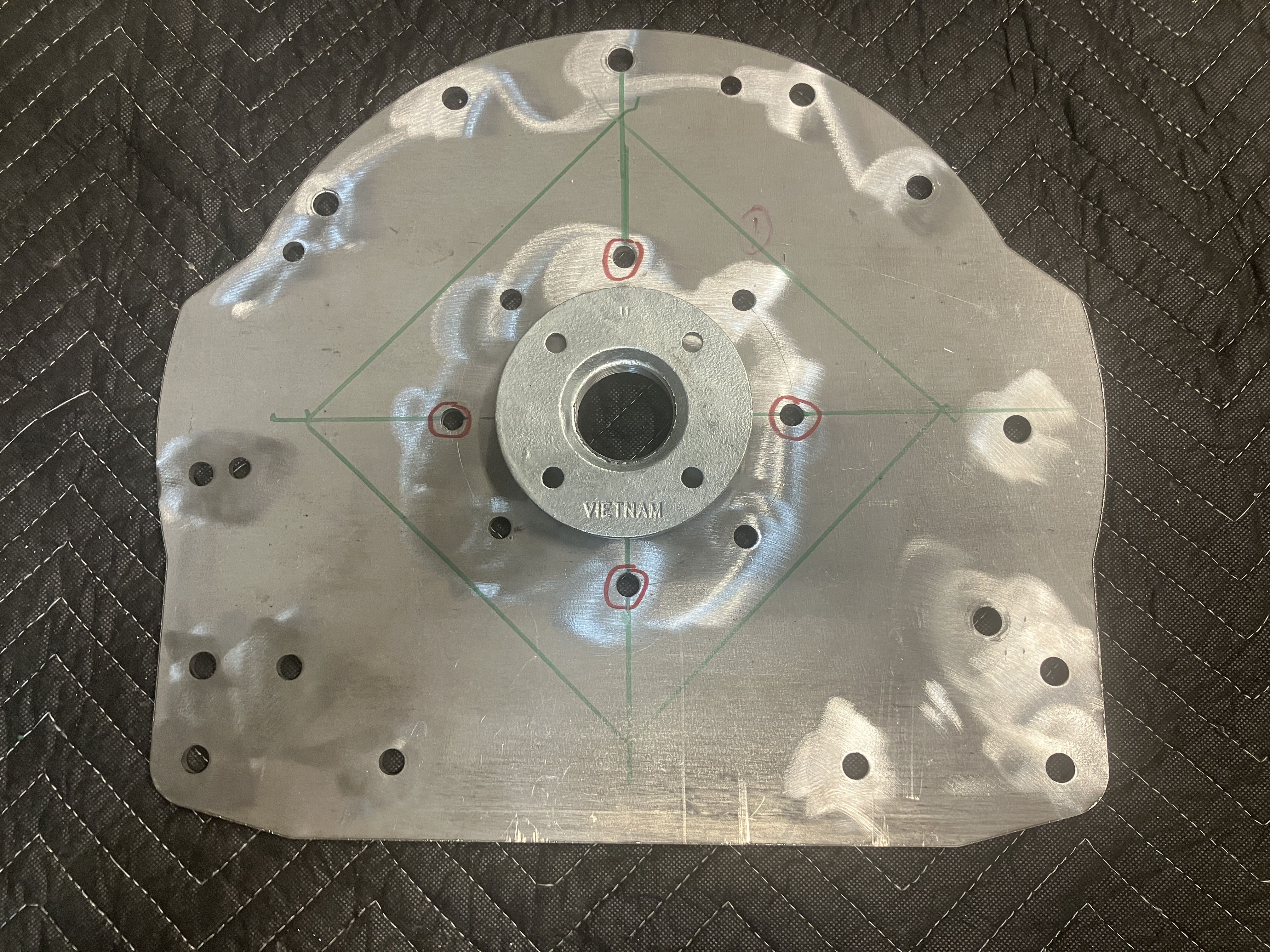

Post by Gregski »

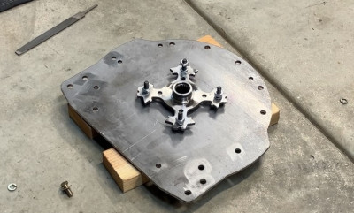

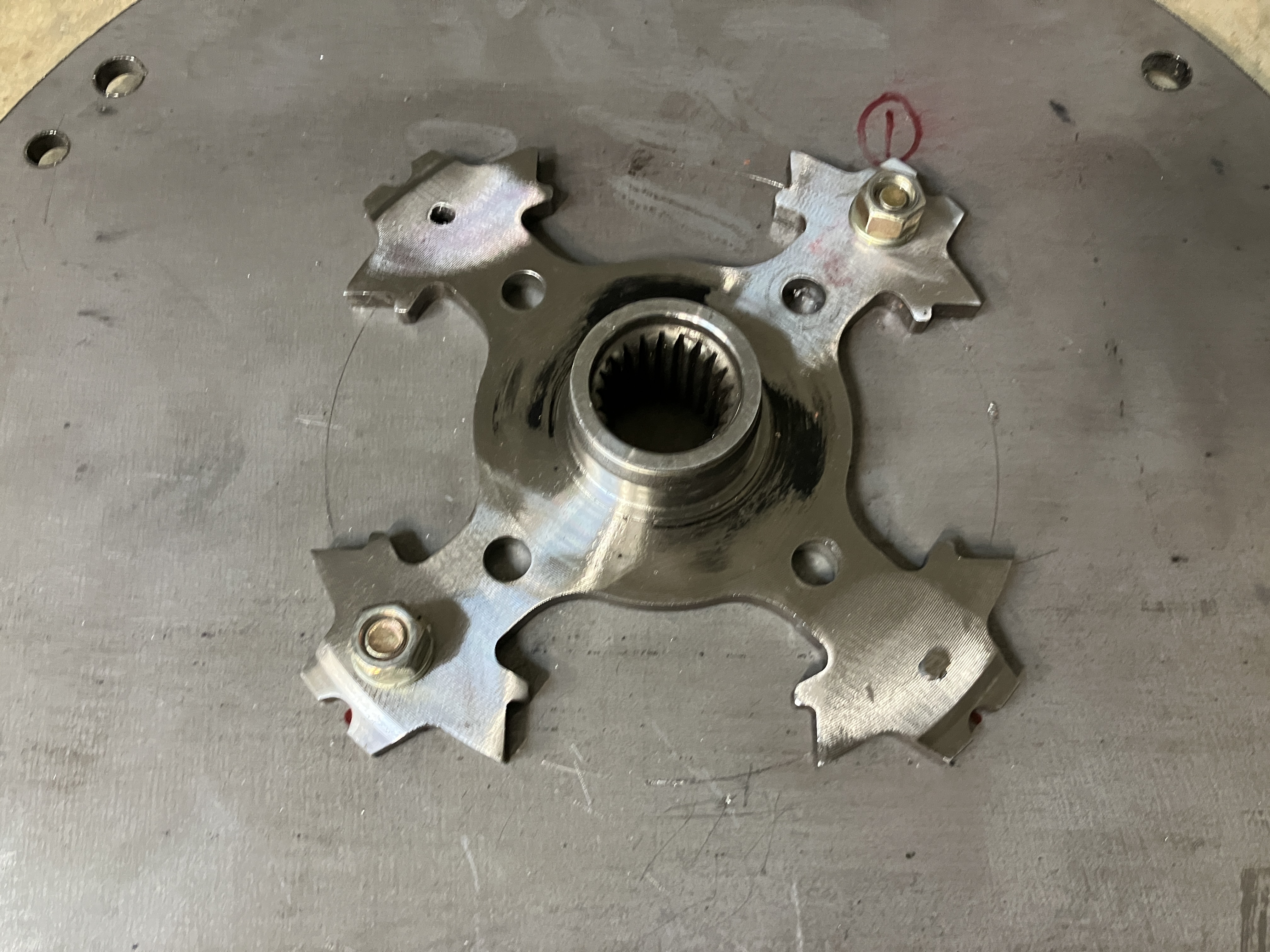

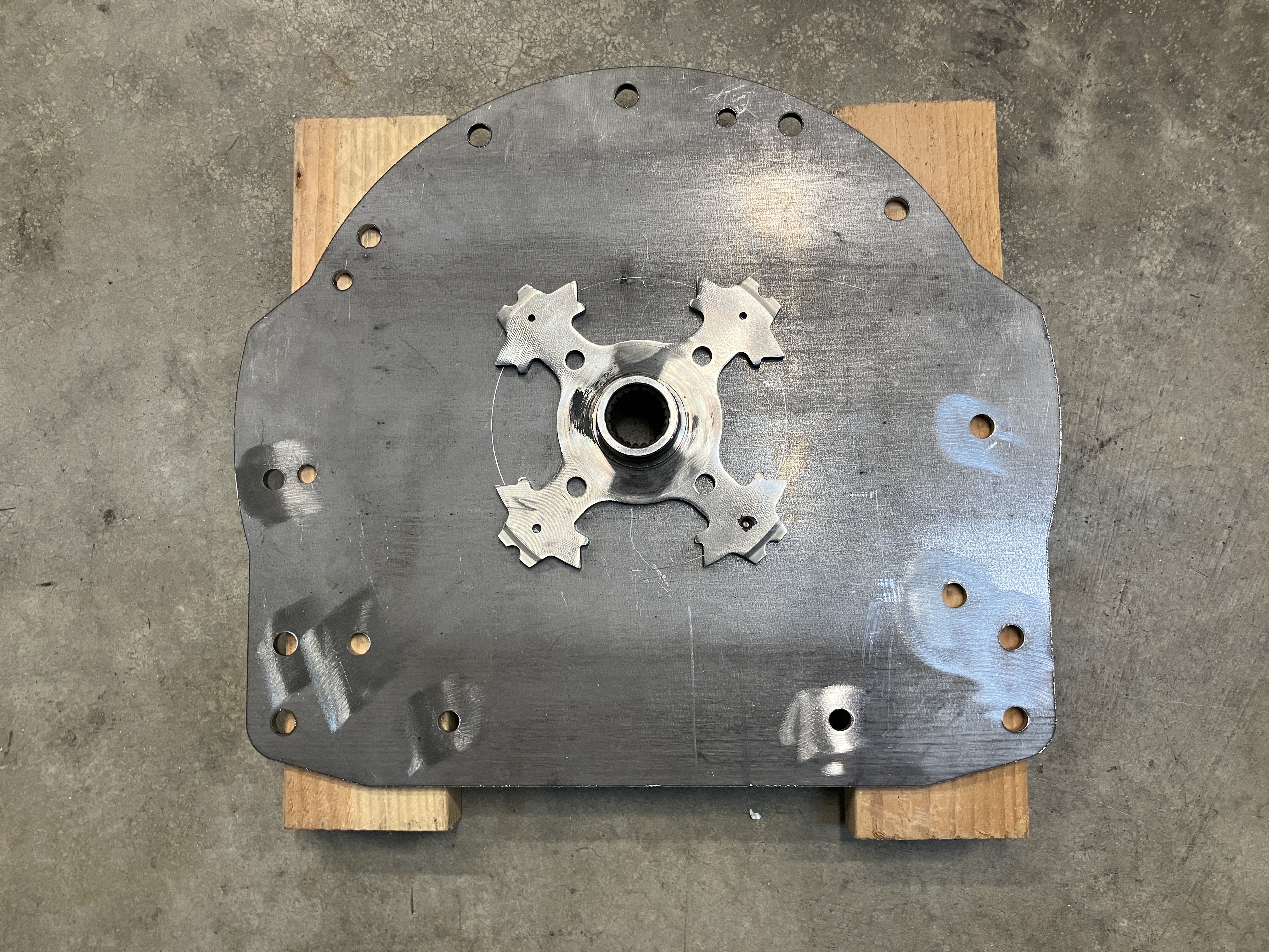

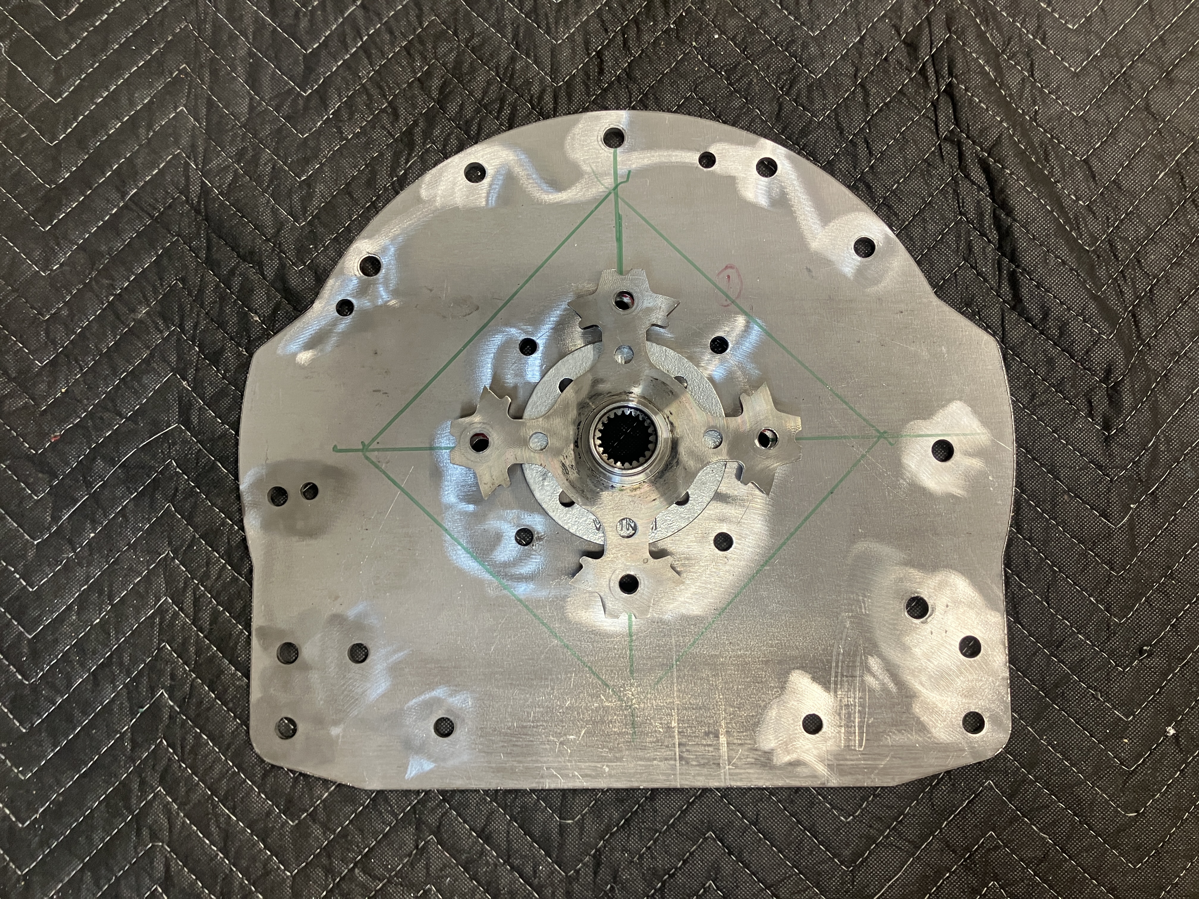

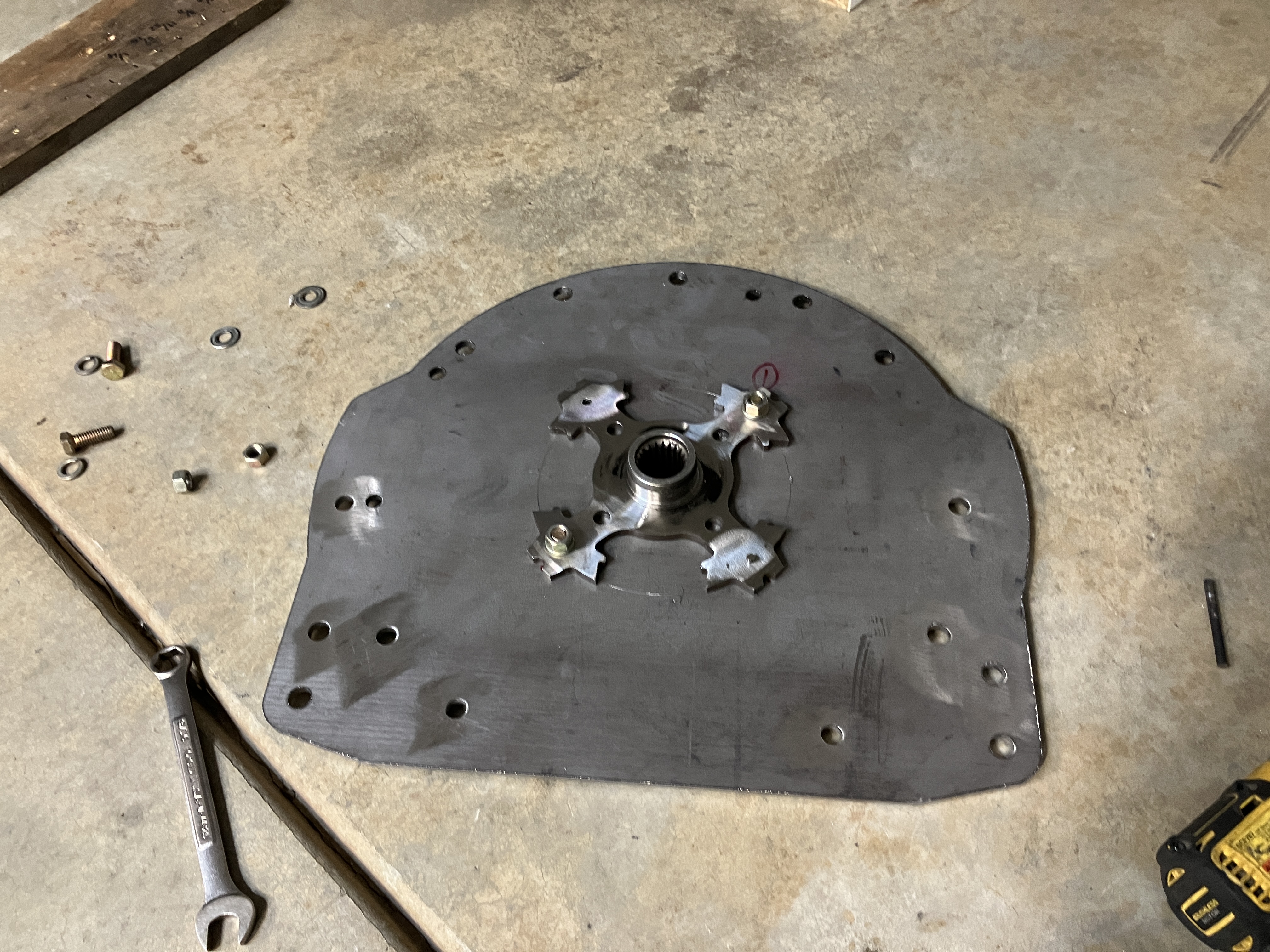

so first attempt at locking out the input shaft was a small failure
below you can see the circumference of the circle I etched
below I raised the Ninja star about 1/2 an inch off the plate to make it sit further inside the bell housing and on the input shaft, this was still just for testing purposes
Alibro
Posts: 1052
Post by Alibro »
Will there be much torque on the plate or is the concern more about stressing the bearings if it's not perfectly aligned?
Gregski
Posts: 2873
Post by Gregski »
Alibro wrote: Sat Dec 21, 2024 10:28 am Will there be much torque on the plate or is the concern more about stressing the bearings if it's not perfectly aligned?
both, equally important I recon

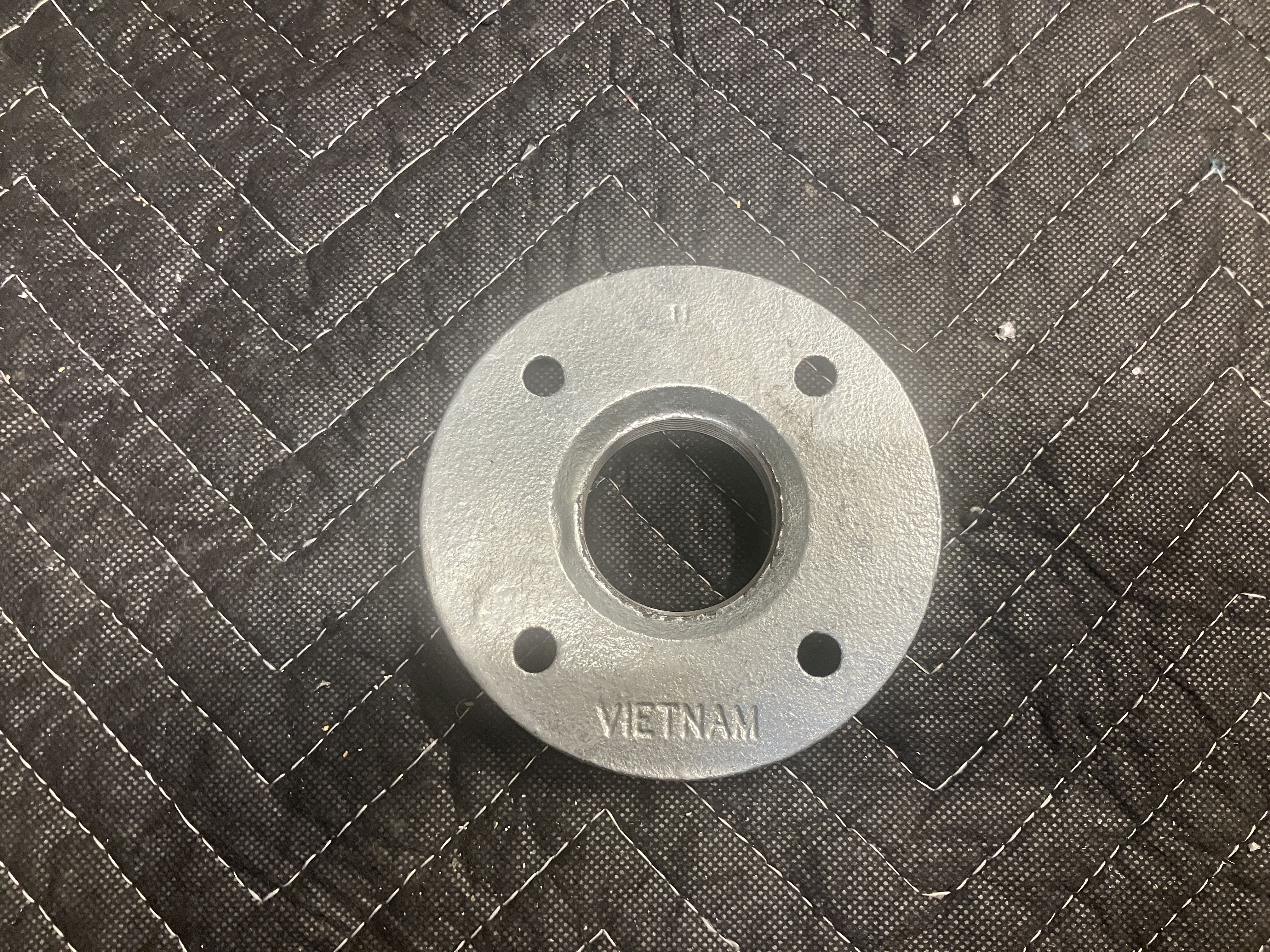

Post by Gregski »

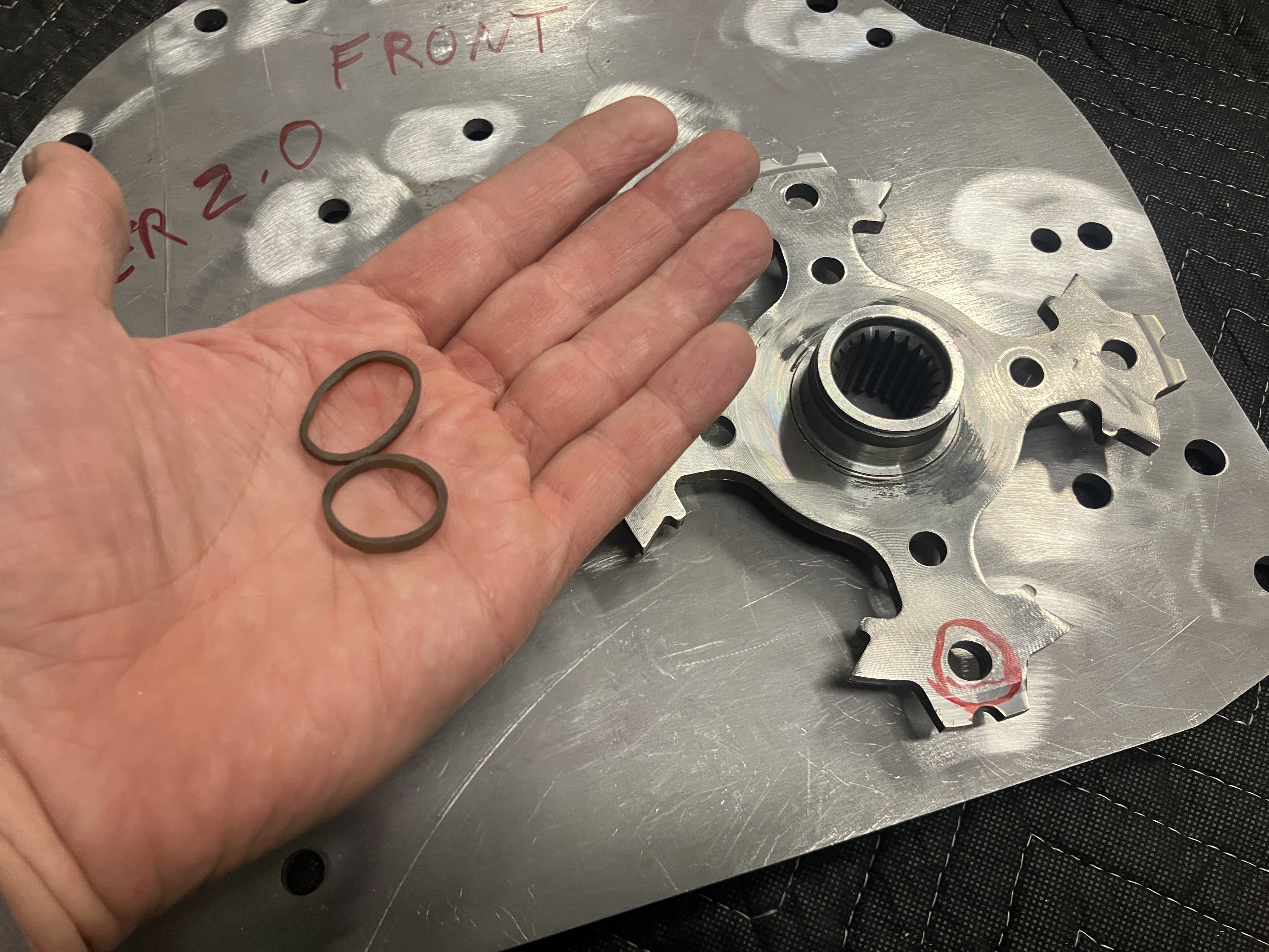

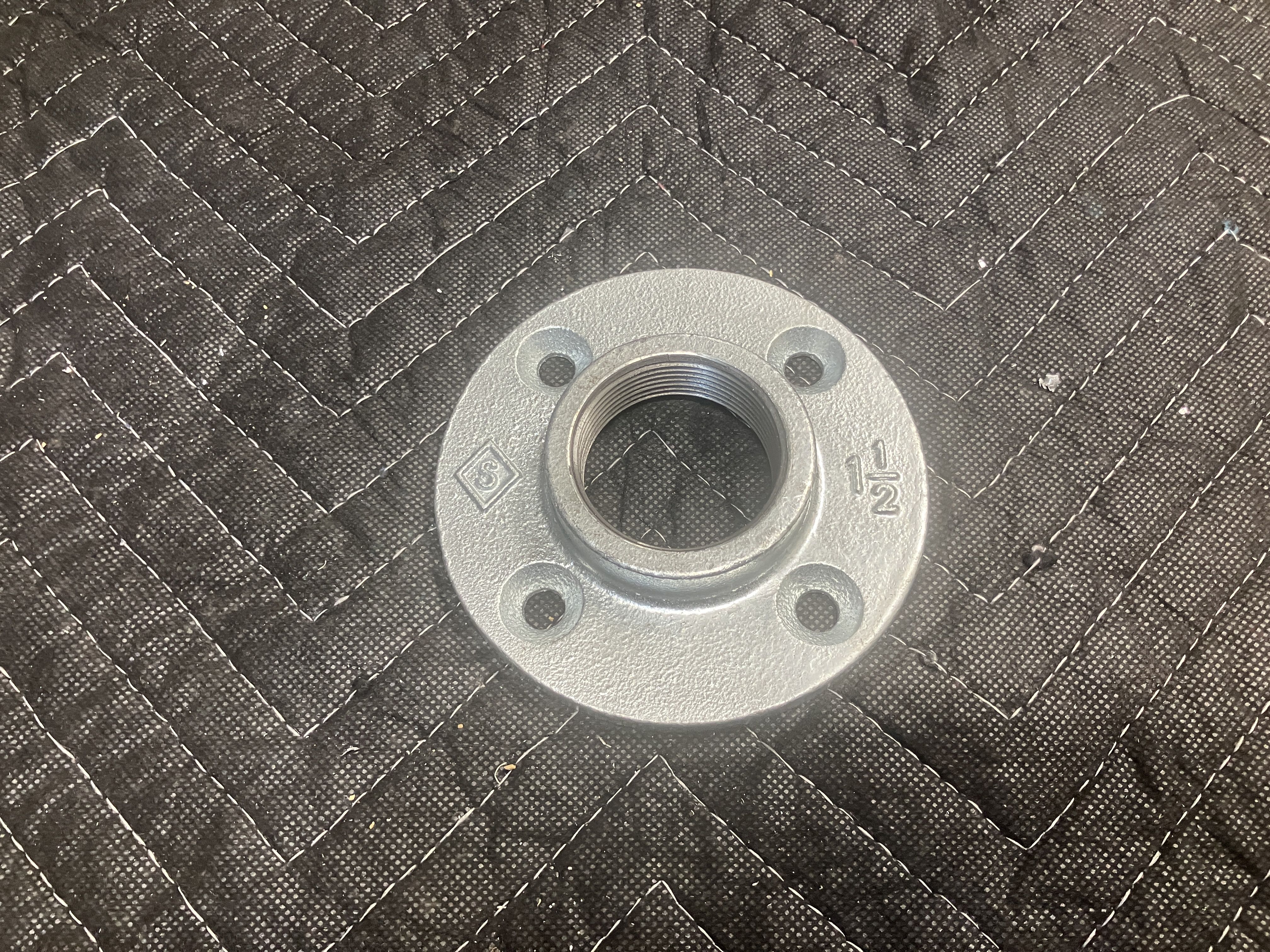

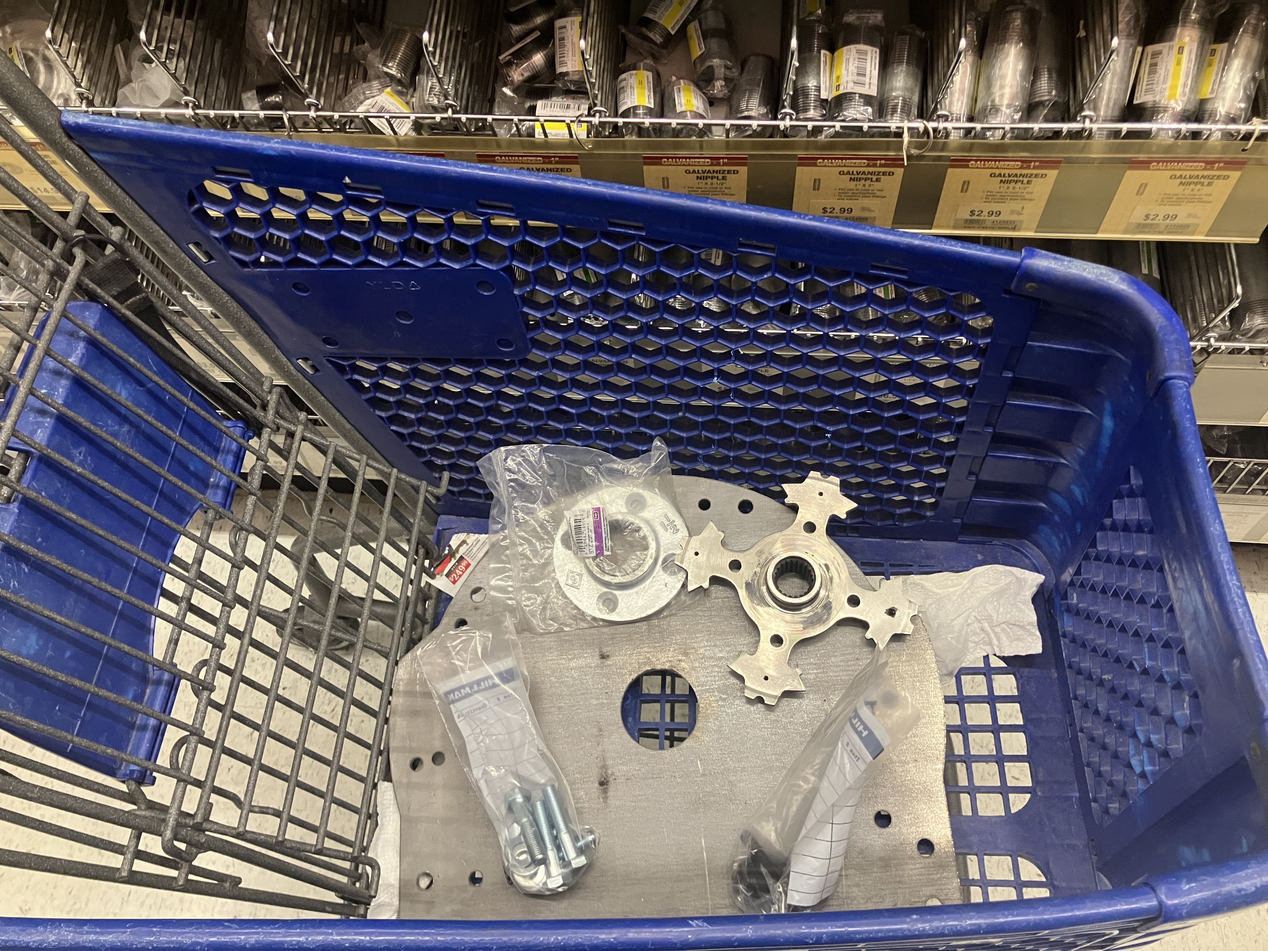

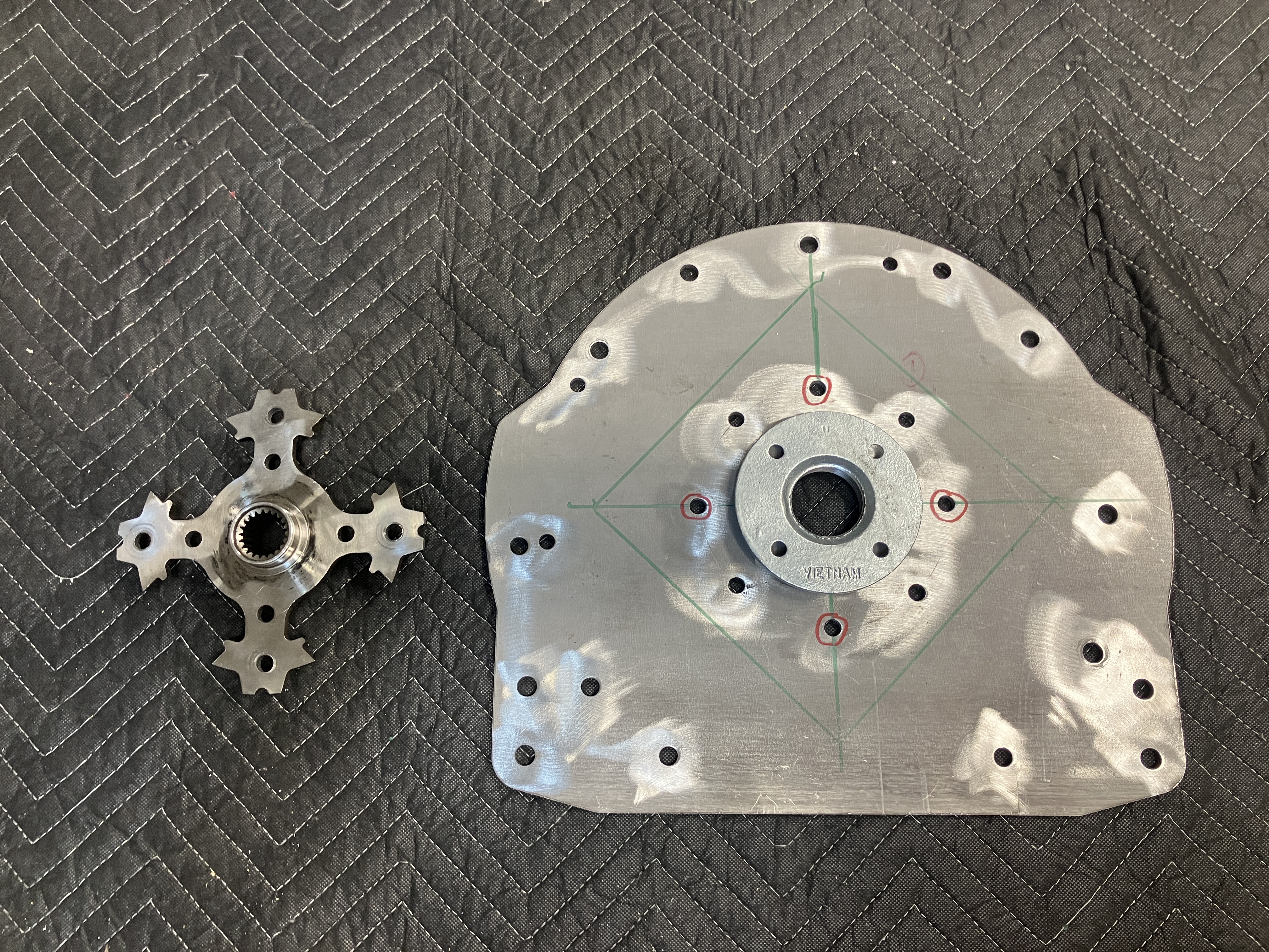

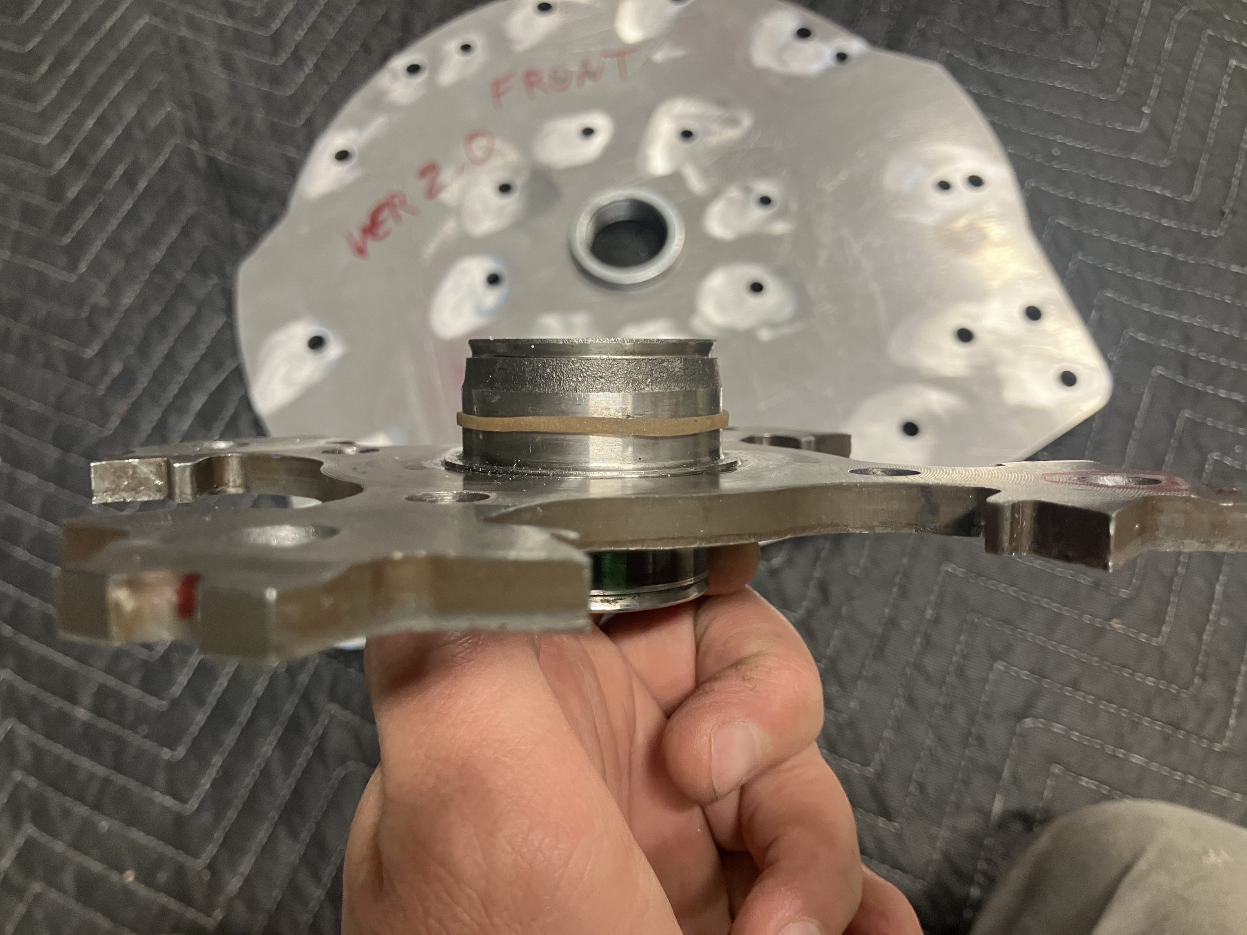

after one too many sleepless nights The Greg made some significant progress on Rev. 2.0 of our input shaft mechanism, using this handy LDR 311 F-112 Galvanized Floor Flange, 1-1/2-Inch, complements of our friends in Vietnam, or as I like to call it the Lexus GS450h transmission plate too big of a hole reducer thingie
here it is as found in our local Ace Hardware store plumbing section
Gregski
Posts: 2873
Post by Gregski »
alright, I aint gonna lie to you, it's not a snug fit... yet ! but we got a solution for that
this gets us in the ballpark but it's not a snug fit, we can do better...
Gregski
Posts: 2873
Post by Gregski »
turns out a simple rubber band set was the secret weapon for perfect alignment
naturally the second one snapped off the shaft into oblivion during the photo shoot, so just picture two of them on here
Posts: 6968
Has thanked: 454 times
Been thanked: 1771 times
as my highly decorated professor once said: every fool can come up with a complicated solution, only true masters find a simple one :)

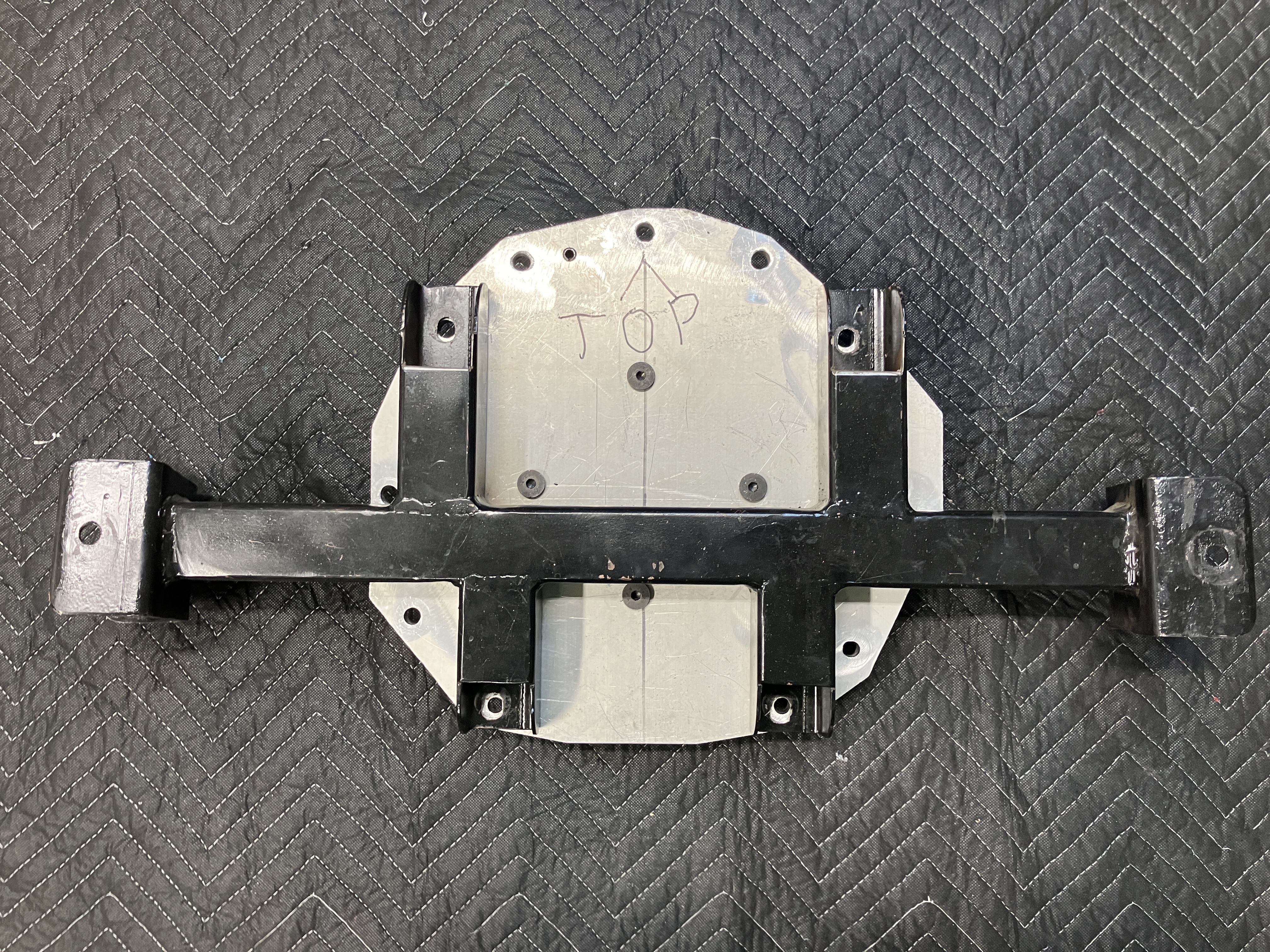

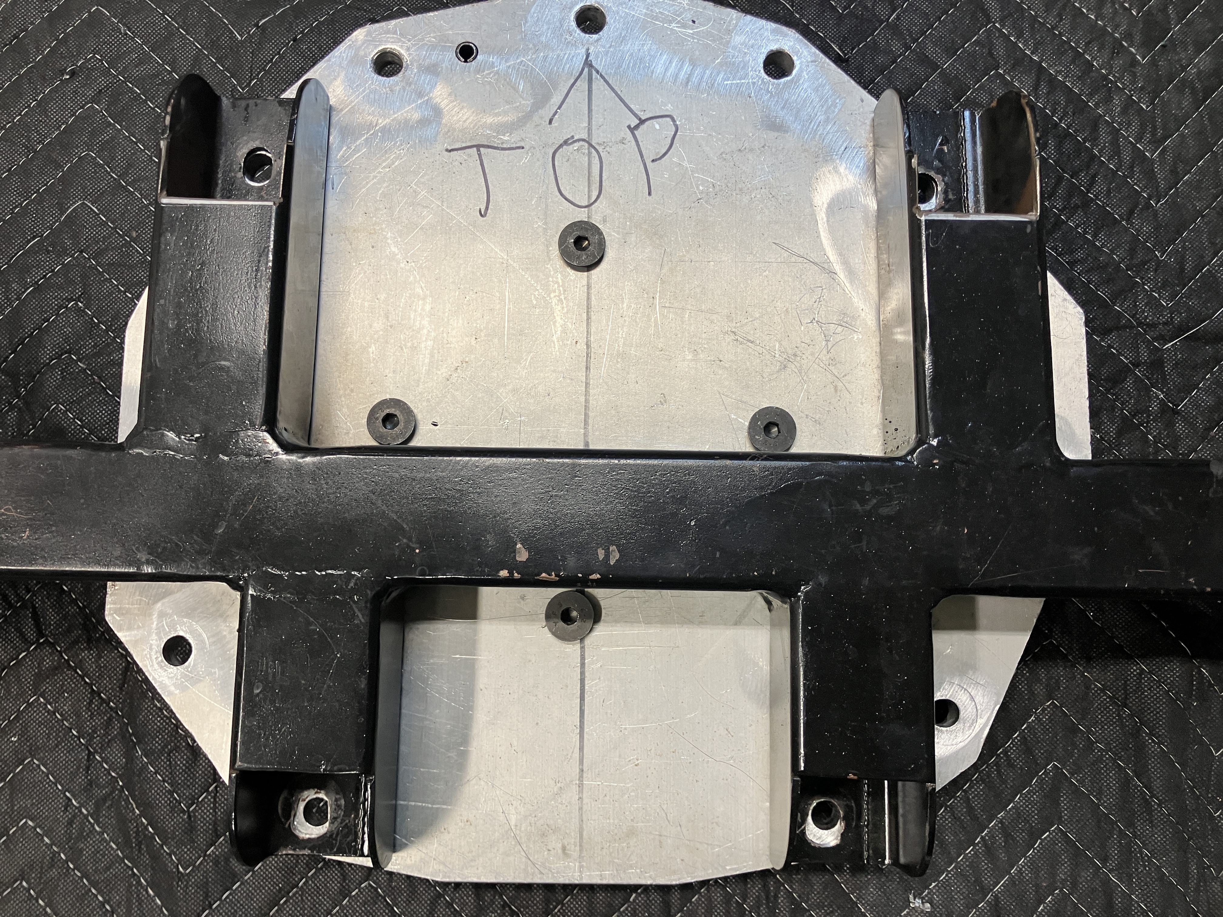

did I mention I was tickled pink when I discovered OUR custom transmission crossmember was going to clear all North, South, East, and West boltuators
jrbe
Posts: 653
Has thanked: 266 times
Been thanked: 186 times
Post by jrbe »
Gregski wrote: Mon Dec 23, 2024 7:21 am turns out a simple rubber band set was the secret weapon for perfect alignment
Thats a first for a rubber band aided fix that i've seen! Nice!
