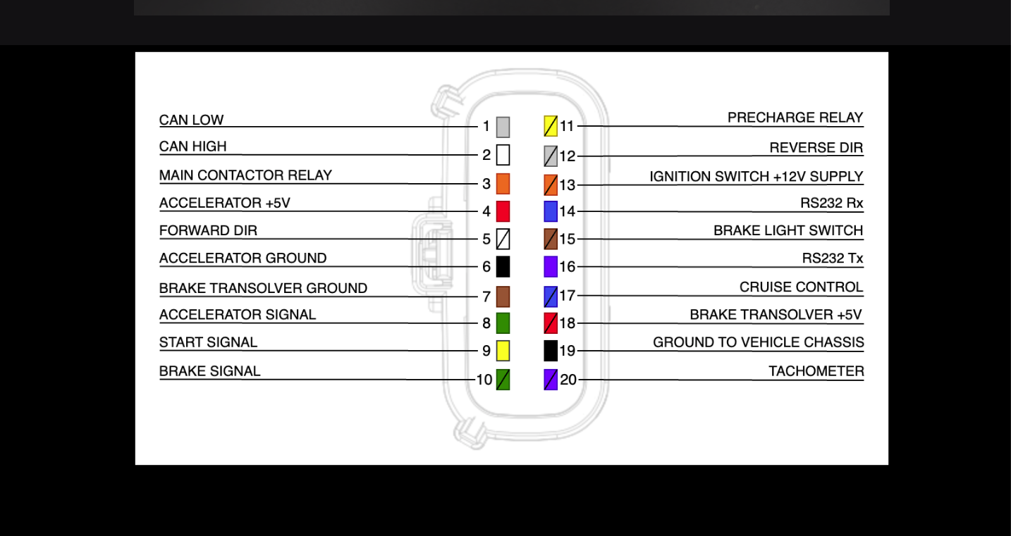

I am working with a Nissan throttle pedal, but am using a Tesla SDU and OI board. Could someone please let me know where to connect the pot 2 wires? I've been going through those videos and It looks like there are connections on the Zombieverter , but II don't have any wires to connect to on my wiring harness for the SDU. Thanks!

Thanks. My pedal has two sensors, a total of 6 wires. Currently I have 3 hooked up and I’m testing in “single regen”. It seems common to hook up all six and use it “dual channel” for redundancy/safety, any ideas where to connect those other 3? I only have a SDU with OI board installed-no zombieverter. Thanks!

The other triplet goes to what is sometimes labelled "brake sensor input"
https://github.com/jsphuebner/Tesla-Fro ... ctions.pdf

Here is a screenshot of my harness. I don't seem to have a pot 2 connection available.

johu wrote: Sun Dec 22, 2024 4:16 pm The other triplet goes to what is sometimes labelled "brake sensor input"
Would that be "Brake Transolver +5v" on mine? Thanks!
Posts: 6746
Has thanked: 380 times
Been thanked: 1570 times
Re: Throttle Pedal Question
yes, pins 10, 18, 19
phillipschip
Posts: 114
Joined: Wed Jun 19, 2024 2:02 am
Has thanked: 4 times
Been thanked: 25 times
Post by phillipschip »
Ok thanks. So I wouldn't use the "brake transolver ground"? Just hook to chassis ground?
Posts: 6746
Oh yeah, brake transolver ground. Missed that
