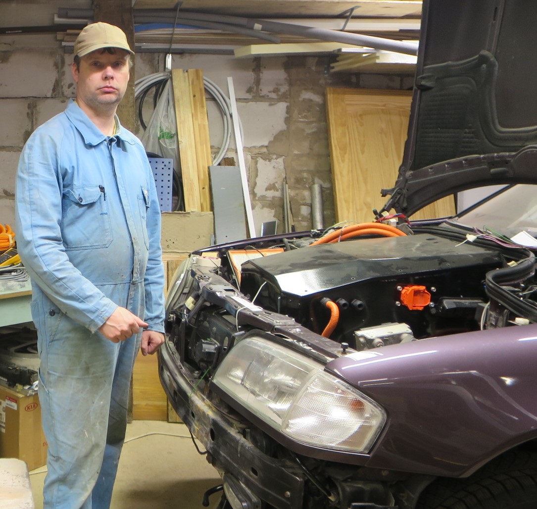

Hello
This is my first car conversion project. I took my old german car wich was already quite rusty and its 1.8 Liter petrol engine was also in a need of a rebuild because of the oil leak and loss of coolant so I asked myself is it worth spending thousands euros and half a year in that engine rebuilt.
Well you see already what I decided, otherwise I wouldn't be writing that story here.
2016 I got from wrecked car auction unrepairable Mitsubishi i-MiEV then it took me a few years to restore the electric system and make it run again. When that was done I decided to install all this mitsubishi electric drive system to the Mercedes. Motor unit was placed to the rear axle where the differential was. Battery is installed in front where the engine use to be. Then it took many years to install all the i-MiEV wiring and control units to the mercedes. Nothing fitted, almost all wiring needed to be lenghtened. I think I chose the right car to convert because in 1996 Mercedes C180 had almost like analog electrical system there's no CAN or even OBD port. Now it has Mitsubishi OBD port. Some Mercedes actuators are driven by hoses :D vacuum system.

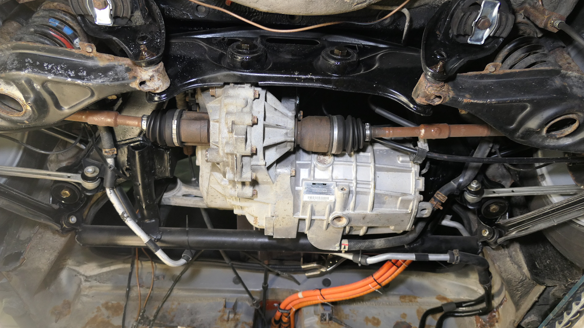

Awesome, do you have some details on the mechanical mounting and driveshaft adaption?
A lot of cars are based on the same or very similar rear subframe & multi-link suspension.

marcexec wrote: Mon Aug 21, 2023 1:33 pm Awesome, do you have some details on the mechanical mounting and driveshaft adaption?
Ofcourse I have some details. I by myself fitted the motor there. At first I tried Nissan Leaf motor but it didn't fit between original mercedes C class rear axle subframe. Halfshafts are just simple cut mercedes shaft in half and from the motor side also and turned a sleeve there and then my students TIG welded them together. I haven't tested them with full load and uphill or with treiler yet but I will someday.

Wow, so you didn't have to modify the spare wheel well at all? I suspect the weight is now similar or even less as you have a relatively small battery and no prop shaft. I would love to see pictures (or is there a write-up somewhere else?) as I have a W201 and am contemplating IS300h vs Outlander RDU with ZombieVerter.
I'm assuming you're using the original VCU, maybe it would accept another 8S module (even different OEM), as the inverter can take it?

Here is a video clip about motor install to rear axle.

I need to figure out some modifications for motor mounting because under the rear seat it's not ok. I have to lower the motor a little bit and remove the original bar with many rubber mounts. Then also I relocate the inverter from luggage compartment to under the seat, where fuel tank used to be. This way I don't have to pass 5 wires thru the car body but the inverter will be under the car outside which is also not good but in the Mitsubishi i-MiEV it worked atleast 12 years and over 100 000km I have seen.
