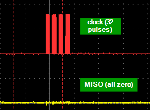

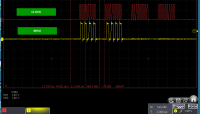

I just measured the MISO line on a Foccci. If the QCA does not see a homeplug coordinator for 30s, it does not send anything back on the MISO anymore, it is going to a kind of sleep mode. This is normal. It wakes as soon as a homeplug coordinator (e.g. an EVSE) is visible.
After a power-on, I see some responses on the MISO:
But also I see a lot of clock packets without a response on the MISO:
So it may be normal that you see not much on the response. You could trigger on the MISO line, this should reveal some data. If not, check the MOSI whether it sends the correct request message.

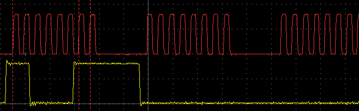

Also make sure that you use the intended clock polarity. Here is an example of the C3 message (binary 11000011, means "read, internal, reg 3 RDBUF_BYTE_AVA"). The data is sampled on rising edge of the clock and prepared on falling edge.
Red is clock, yellow is MOSI.

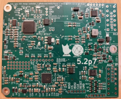

Good news regarding the transformerless Foccci boards: Just populated the QCAs on two of them, and they work like a charm. Even with additional 26dB attenuation of the RF signal, the demo charging with pyPLC as EVSE works perfect.
This means, if you order a Foccci in the shop, you could select now between the transformer variant (V5, V5.1) or the transformerless variant (V5.2p7).

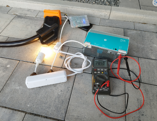

Post by uhi22 »
Good news: The transformerless Foccci works on the Alpitronic charger. Here driving a 230V bulb (just because it's nice) and a 24V/20A power supply (which will be the use case later).
Was running stable until I stopped after 18 minutes.

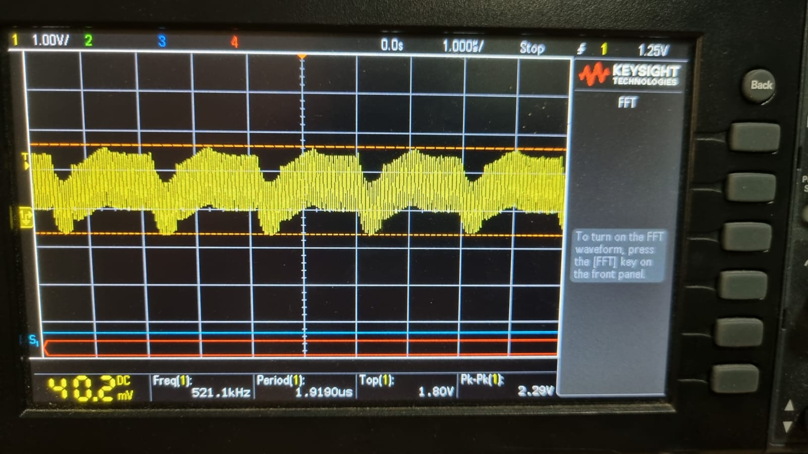

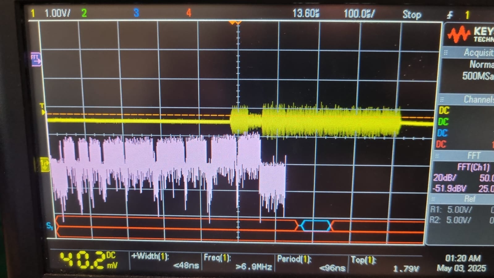

Guys. I'm having trouble getting my QCA7000 board to work, so I'm looking for documents and projects that might give me some clues about what to do. I found a git file with files that might help everybody with the QCA7000 design. Here's the link: https://gitcode.com/open-source-toolkit/3c2616 and the attached file.
My problem is that I can't generate the proper RF signal. The signal intensity is too low and I can barely read it with an oscilloscope. The oscillator is ok, the 1.2 V signal is ok. The board communicates with SPI.
I'm attaching photos of the poorly formed signal and a well-formed signal that I read on a REDBEET board.
Does anyone have any tips on what to try?

Post by uhi22 »
Usually this is the result of soldering issues, like shortcut or open circuirt in the RF path. Some voltages and resistances to be checked are mentioned in the trouble shooting guide https://github.com/uhi22/foccci#no-comm ... r-possible
On some V5 boards we have seen shortcuts under the RF transformer.

Gabriel wrote: Tue May 27, 2025 10:04 pm I have 5 cards and they all behave the same way
This could also point to wrong components, e.g. C10 with 220nF instead of 220pF or something similar. You could compare the signals directly on the TXOUT_P and TXOUT_N, with the signal on the C10 and the signal on the CP line. And if nothing helps, remove the D3, 4, 6, 7, and C10. The TXOUT_N and _P should provide inverted signals with >1V amplitude.
And important pitfall: The QCA will stop sending packets at ~30s from power-on, if it does not see a homeplug coordinator (EVSE). So it may be normal, that you do not see packets.

Thanks, uhi22. I'm using the board with the FLASH memory firmware as EVSE. I checked and the C10 is at an adequate value.
I'm continuing to investigate and do new tests, if I make any progress I'll let everyone know here.

Maybe the flash image contains a configuration with very small transmit power? Would it help that you share the image, so we can give a try with our boards?
Gabriel
Posts: 13
Joined: Tue Nov 21, 2023 12:27 pm
Re: Develop a QCA7000 board?
Post by Gabriel »
I don't think it's related to the flash image. I got the .bin from: viewtopic.php?p=33730#p33730
uhi22

Thanks, I missed this.
Measured the transmit amplitudes using a Foccci 1.0 board, with the aliexpress EVSE_1 and 2, and the Ioniq configuration, which we use on Foccci normally.
The aliexpress configuration has lower transmit power, but still very well visible on oscilloscope.
Summary: each transmit line has 2V (peak-peak, in the preamble) for the Ioniq PEV, and 0.6V for the aliexpress EVSE.
Details here: https://github.com/uhi22/pyPLC/blob/mas ... of-the-qca

Great work! Thanks.
So far no progress. I will compare each part of the circuit and components with the REBBEET module. I am suspicious of the quality of the QCAs purchased from Aliexpress. Has anyone had a similar problem?
