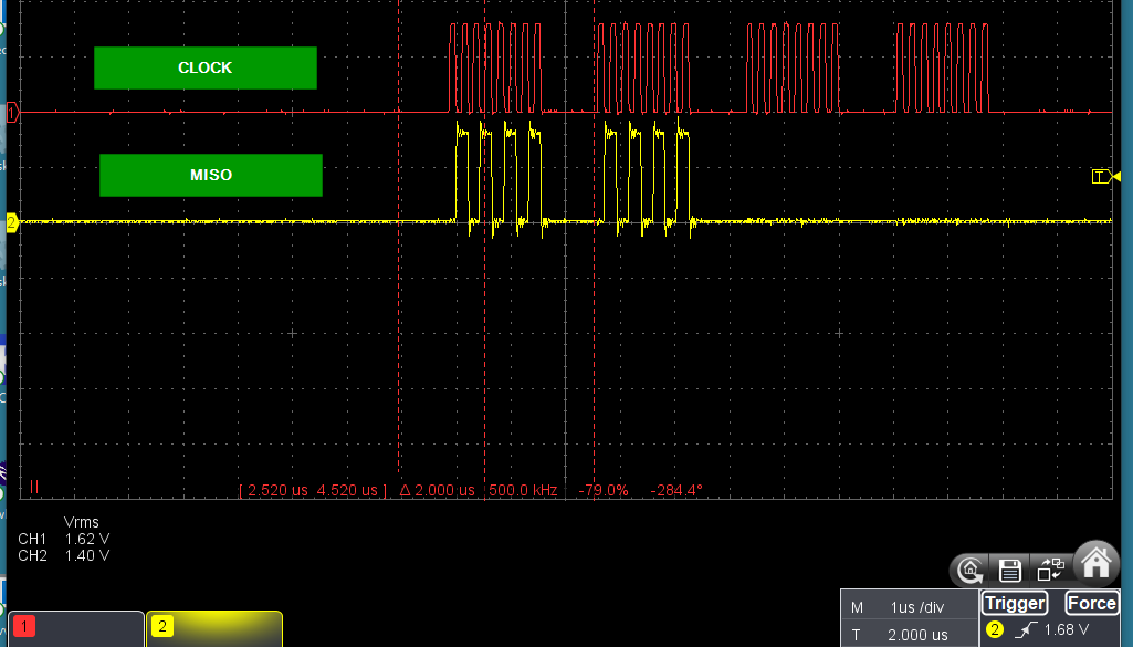

The firmware on the SPI flash should not be your issue. Even if you remove the SPI flash completely (or it is empty), the QCA will respond to the software version request with the response "Bootloader".
I just measured the MISO line on a Foccci. If the QCA does not see a homeplug coordinator for 30s, it does not send anything back on the MISO anymore, it is going to a kind of sleep mode. This is normal. It wakes as soon as a homeplug coordinator (e.g. an EVSE) is visible.
After a power-on, I see some responses on the MISO: But also I see a lot of clock packets without a response on the MISO: So it may be normal that you see not much on the response. You could trigger on the MISO line, this should reveal some data. If not, check the MOSI whether it sends the correct request message.
You could also give a try and connect the QCA as an SPI slave to a Raspberry and load the QCA driver which makes an ethernet interface from the QCA. I never tried this before, but think this should be a quite solid way to check whether the board runs in general.
- uhi22
- Posts: 1117
- Has thanked: 206 times
- Been thanked: 617 times
Re: Develop a QCA7000 board?
Also make sure that you use the intended clock polarity. Here is an example of the C3 message (binary 11000011, means "read, internal, reg 3 RDBUF_BYTE_AVA"). The data is sampled on rising edge of the clock and prepared on falling edge.
Red is clock, yellow is MOSI.

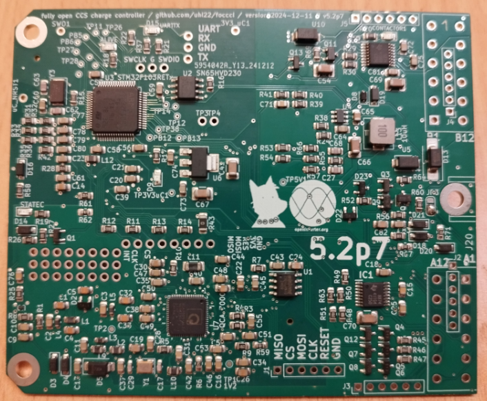

Good news regarding the transformerless Foccci boards: Just populated the QCAs on two of them, and they work like a charm. Even with additional 26dB attenuation of the RF signal, the demo charging with pyPLC as EVSE works perfect.
This means, if you order a Foccci in the shop, you could select now between the transformer variant (V5, V5.1) or the transformerless variant (V5.2p7).Github: http://github.com/uhi22 --- Patreon: https://www.patreon.com/uhi22

Measured the transmit amplitudes using a Foccci 1.0 board, with the aliexpress EVSE_1 and 2, and the Ioniq configuration, which we use on Foccci normally.
The aliexpress configuration has lower transmit power, but still very well visible on oscilloscope.
Summary: each transmit line has 2V (peak-peak, in the preamble) for the Ioniq PEV, and 0.6V for the aliexpress EVSE.
Details here: https://github.com/uhi22/pyPLC/blob/mas ... of-the-qca

So far no progress. I will compare each part of the circuit and components with the REBBEET module. I am suspicious of the quality of the QCAs purchased from Aliexpress. Has anyone had a similar problem?
