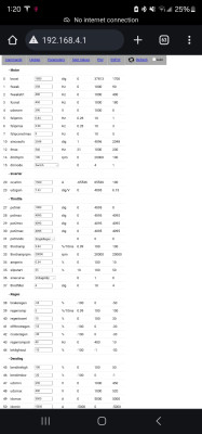

The problem should be easily reproducible if it is cooling related. This time make sure to log tmpm and tmphs. Most likely tmphs will go out of check
johnsongt350
Posts: 24
Joined: Thu Mar 23, 2023 11:29 am
Re: Inverter overheating?
Post by johnsongt350 »
I will log tmpm and tmphs and get back to you all.
