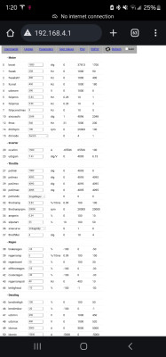

The problem should be easily reproducible if it is cooling related. This time make sure to log tmpm and tmphs. Most likely tmphs will go out of check

I will log tmpm and tmphs and get back to you all.
