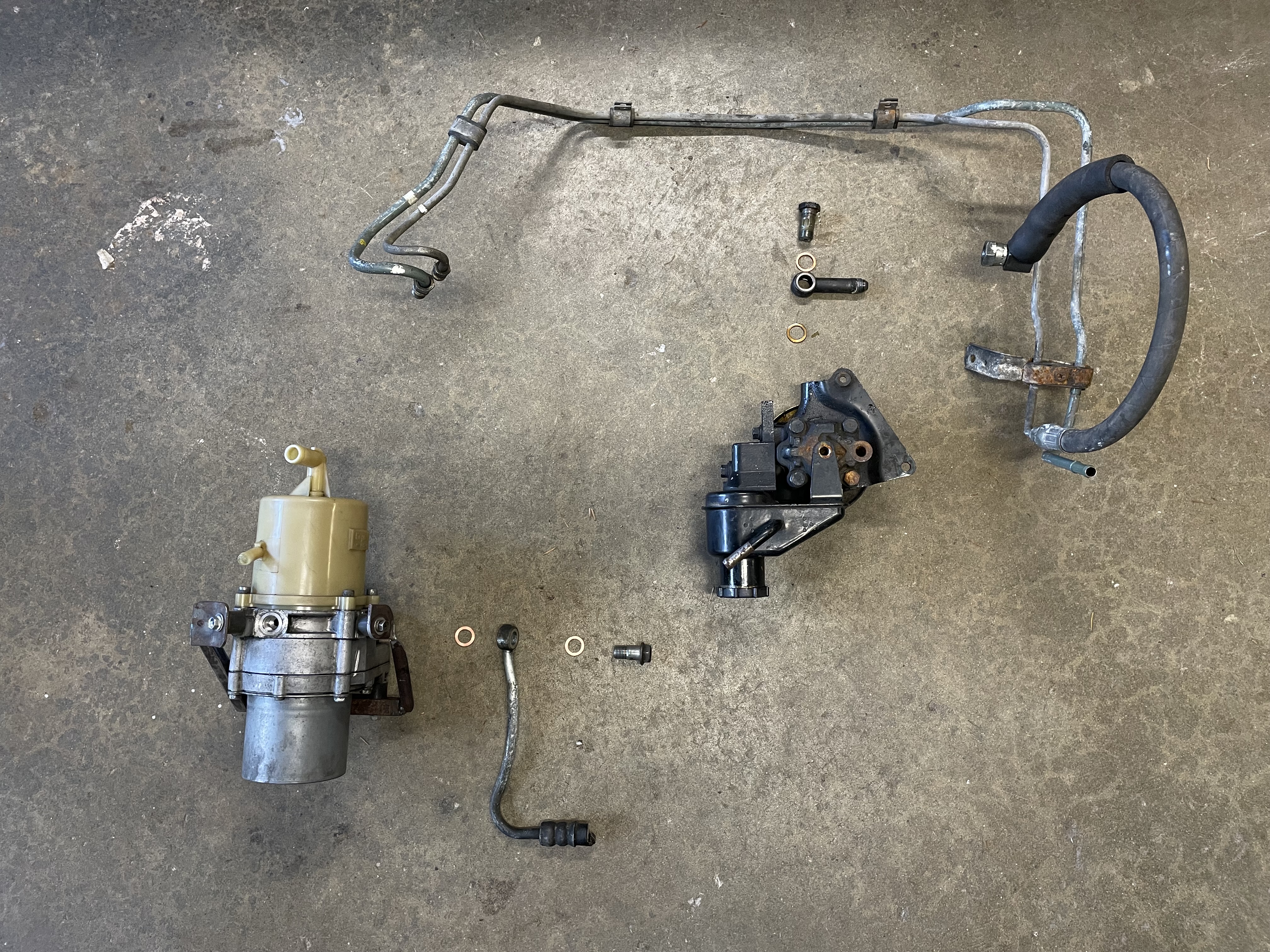

There’s 2 options for power steering:
Electric power steering pump to feed hydraulic pressure to the box.
Or electric power steering column.
A epas pump is the simplest install, just plumb it in and good to go.
Cons are I’m adding weight as the pump is heavy
And there’s hydraulic fluid!
And it’s noisy
Yuck!
Epas column would be quiet, more efficient , and not add anything into the engine bay.
Con’s are lots of custom fab work, which is tricky as I’m am not allowing any of the original trucks column to be cut or welded. this is out of safety and keeping everything bolt on:)
there’s a rag joint just outside the fire wall… so it may be possible to retro fit a Prius rack with some off the shelf couplers.
but picked up an old Mazda epas pump for 80$ cad.

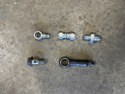

Heres the epas pump and the original line + pump from the truck.
epas pump pressure outlet is a m14 jis banjo fitting
The trucks original power steering lines have a bigger jic banjo. Close but no cigar.
3 fittings later we have connections!
M14 banjo jis -> female x female jis union ->jis x jic union
simple, no expensive custom hoses, and all off the shelf parts!

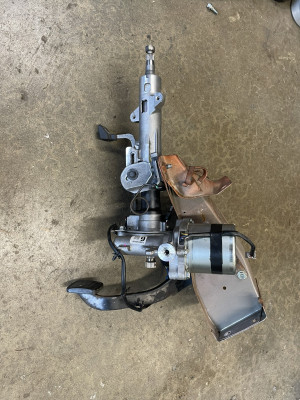

pickd up a 2017 camery epas column for 100$
and.....
its a direct bolt in to the pedal box.
crazy!
the controller box is directly bolted to the motor so i removed it for more space. its 3phase!
motor/gearbox is a bit to big and sadly collides with a bracket on the firewall. but looks like a yaris motor unit is much smaller and should fit with the camery tilt column part.
the output of the toyota epas motors is 11/16- 36 splines, and the input shaft from the steering box has a rag joint that meets at the fire wall.
so!
with the following off the shelf connections:
11/16-36 x 3/4 dd u-joint: https://www.borgeson.com/Steel-3-4-DD-X-11-16-36.html
3/4dd shaft: https://www.borgeson.com/3-4DD-Shaft-18-Long.html
3/4dd rag joint: https://www.borgeson.com/rag-joint-flange-3-4-dd
this should result in a nonwelded steering shaft, and bolt in epas :)

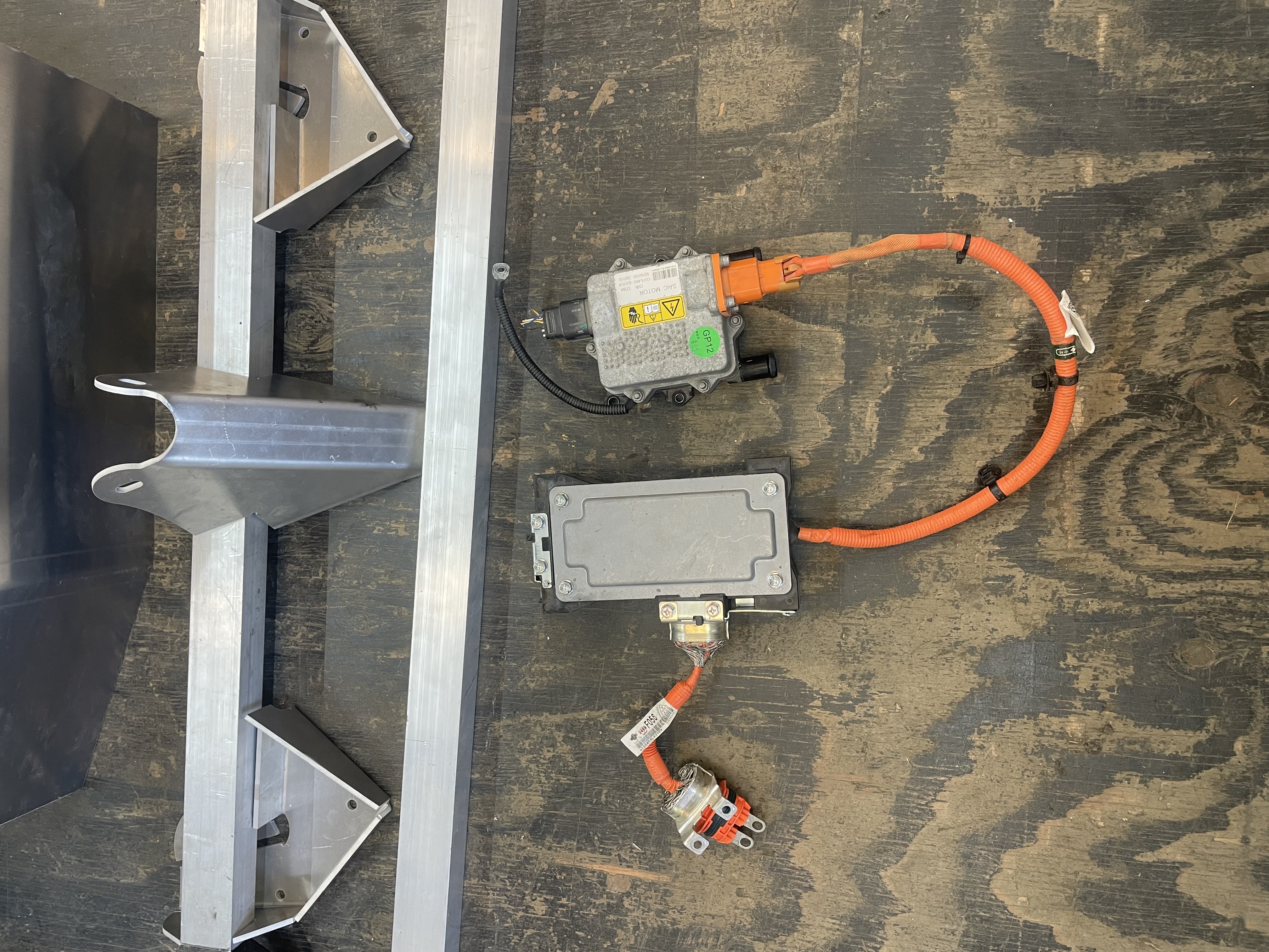

picked up a 110k stack, and installed a rough generic zombie harness.
along with all the other little hardware bits and clean up, truck is temporally back on the road running 2.22A, and ready for the journey over to the new shop in Victoria!
110kw in this truck is a lot....
datsun720-prams.json
(2.13 KiB) Downloaded 35 times
prams will drive the following:
-350v fully charged pack (partial volt pack,84s)
- leaf motor em57 110kw inverter
- outlander OBC (with a leaf charge port, and a 330ohm pull up resistor to 5v for ppval)
- water pump at temp set point
NO IVT SHUNT! :)

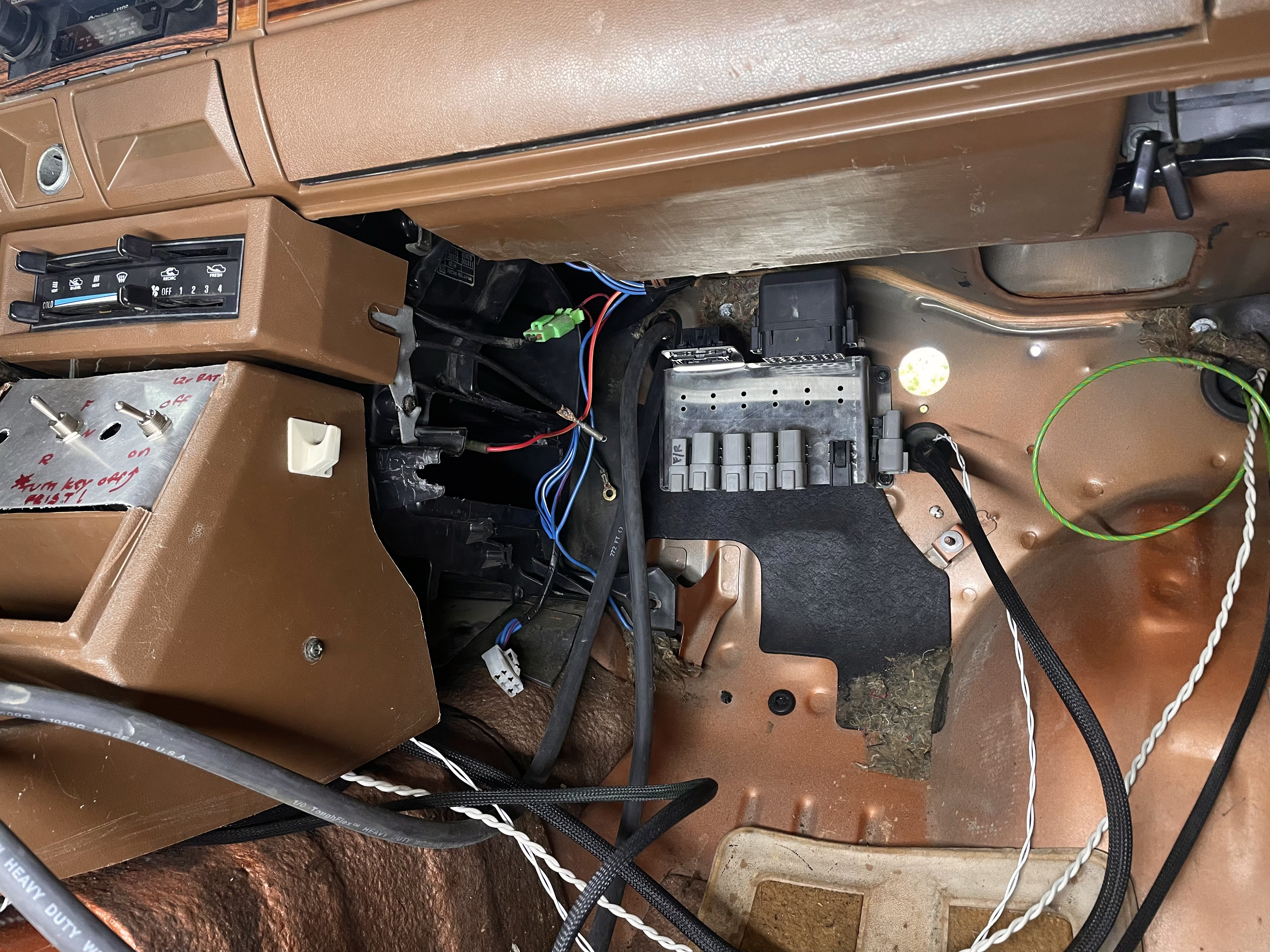

Now that I’m back in the new shop with mostly everything, I got some stainless trays cut for the zombiverter prewired interface.
After poking around to find a nice spot to mount it, I settled on the inside of the passenger fire wall.
fits behind easily removable HVAC ductting, keeps wire runs short, and is very safe from any moisture exposure.
I’ll be also able to access the obd port through the glove box!
Now can start collecting new lv connectors and build a clean harnesses for the trucks ev system

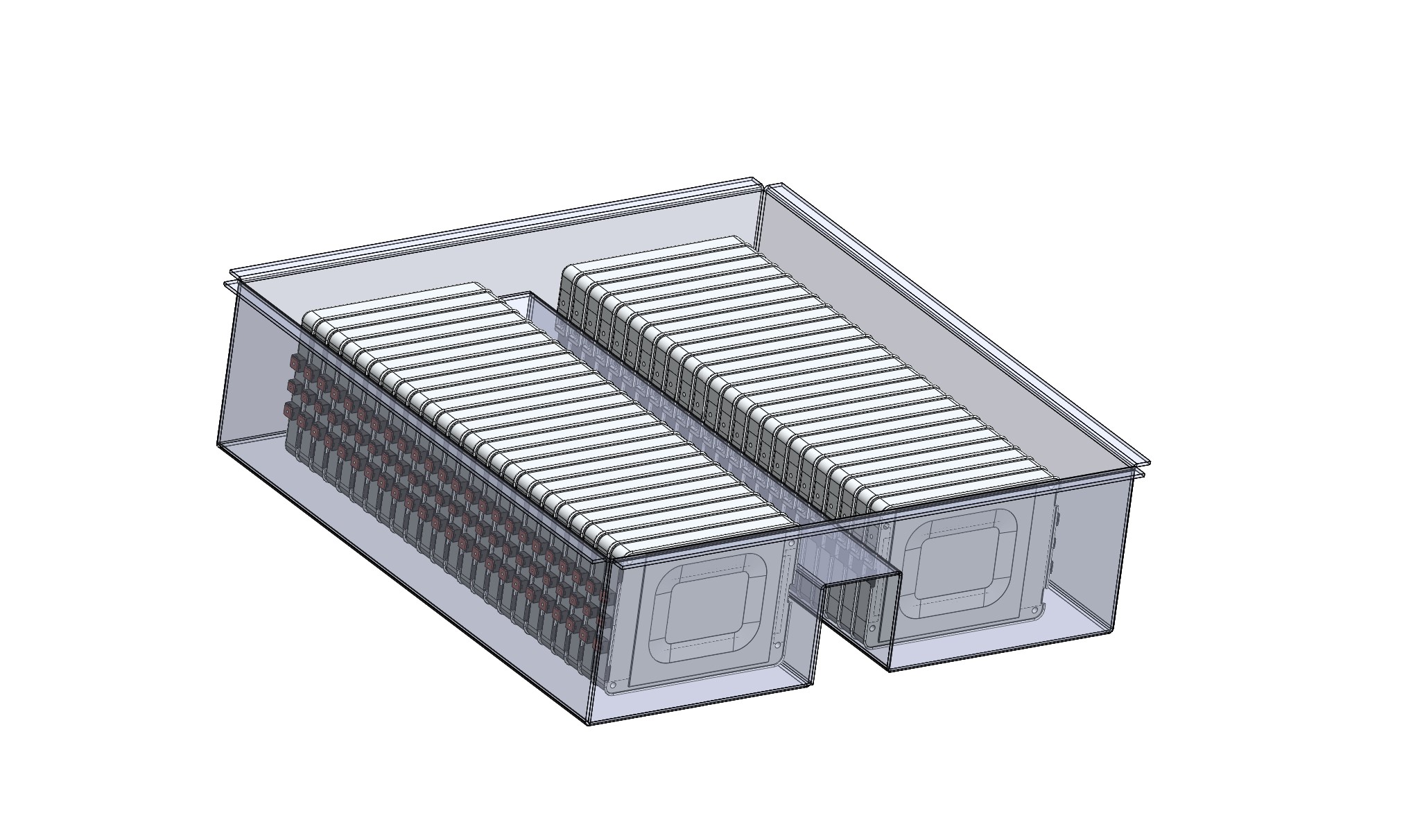

had a moment to spare and dick around with battery modules in the truck. in this case im just going to make the biggest saddle pack i can for the truck, and stuff what i can inside for now. ideally id like to get some vda355 4s3p modules and cram 55kwh in there, but ill have to wait intill a pack shows up with the modules im looking for. there is room for a secoundary rear mounted box, and could fit a full etron pack with 32 3s4p modules, but truck starts getting heavy, right now its very nimble!
the ionic modules are too long unfortunately and will collide with the already tight driveshaft (tunnel).
24 vda355 modules
all 48(96) leaf modules
my current 14kWh gen 2 volt pack

after humming and hawing about how I’m going to approach heating..... I bought a mg water heater from the uk for cheapish.
also picked up a replacement heater ducting box for the truck (as I had cut the original one up to fit a id4 heater matrix) at a pick and pull for 30$
along with other interior trim!
So that settles it, I’m going the simple route and just pluming in a coolant loop through the original heater system. Not as elegant as fitting a ptc, but it’s simple!
mg heater arrived, and wow it really is small!
Okay off to the bin of random connectors I’ve collected as I know I have a te hv plug that will fit…. And !
The outlander hv junction box has one that fits! Look at that! Just need to double check ampacity of the cables before I pull some power.
this will make for a very clean oem install as the outlander obc will also junction in to this with stock cables.
