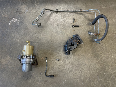

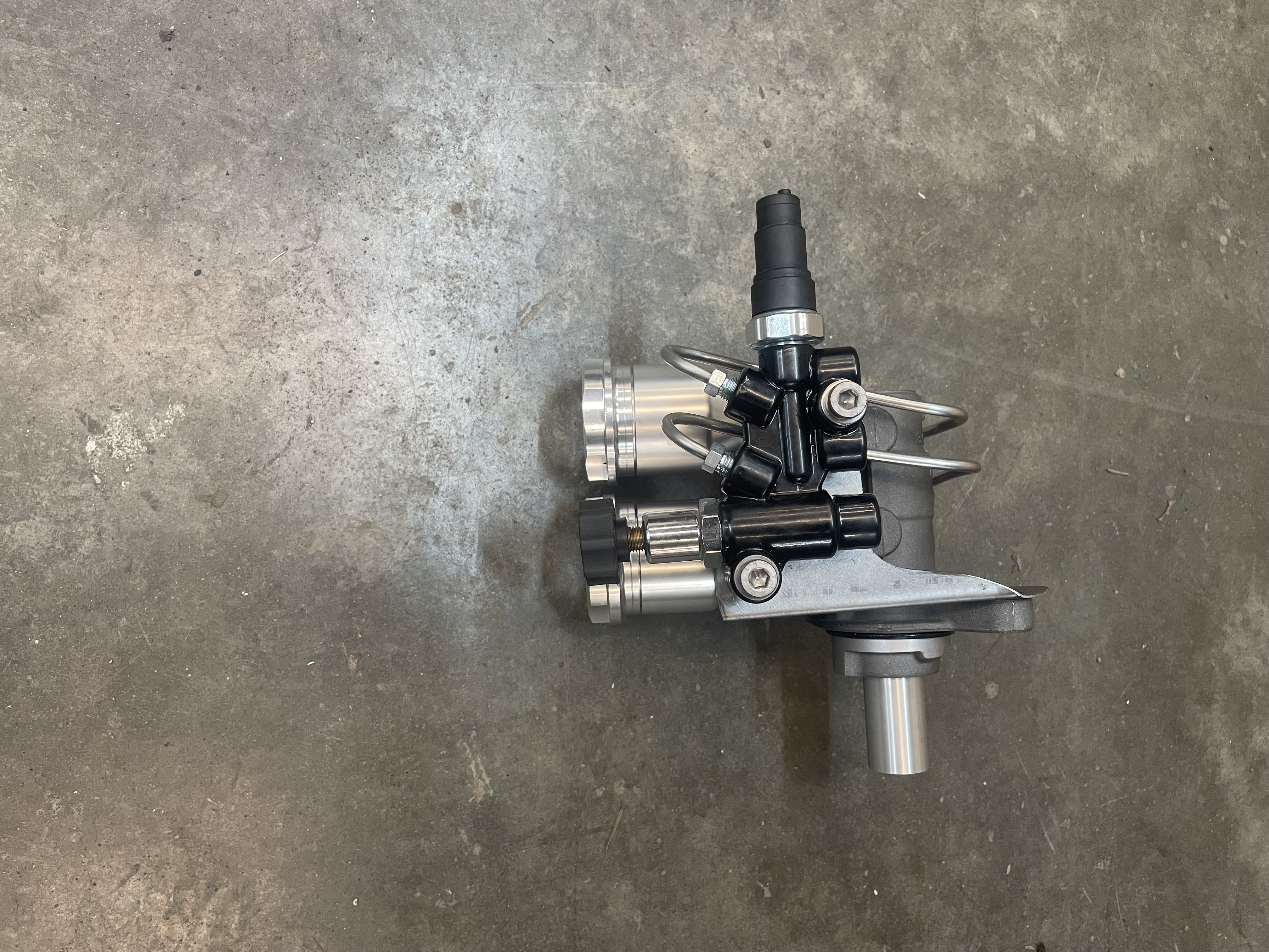

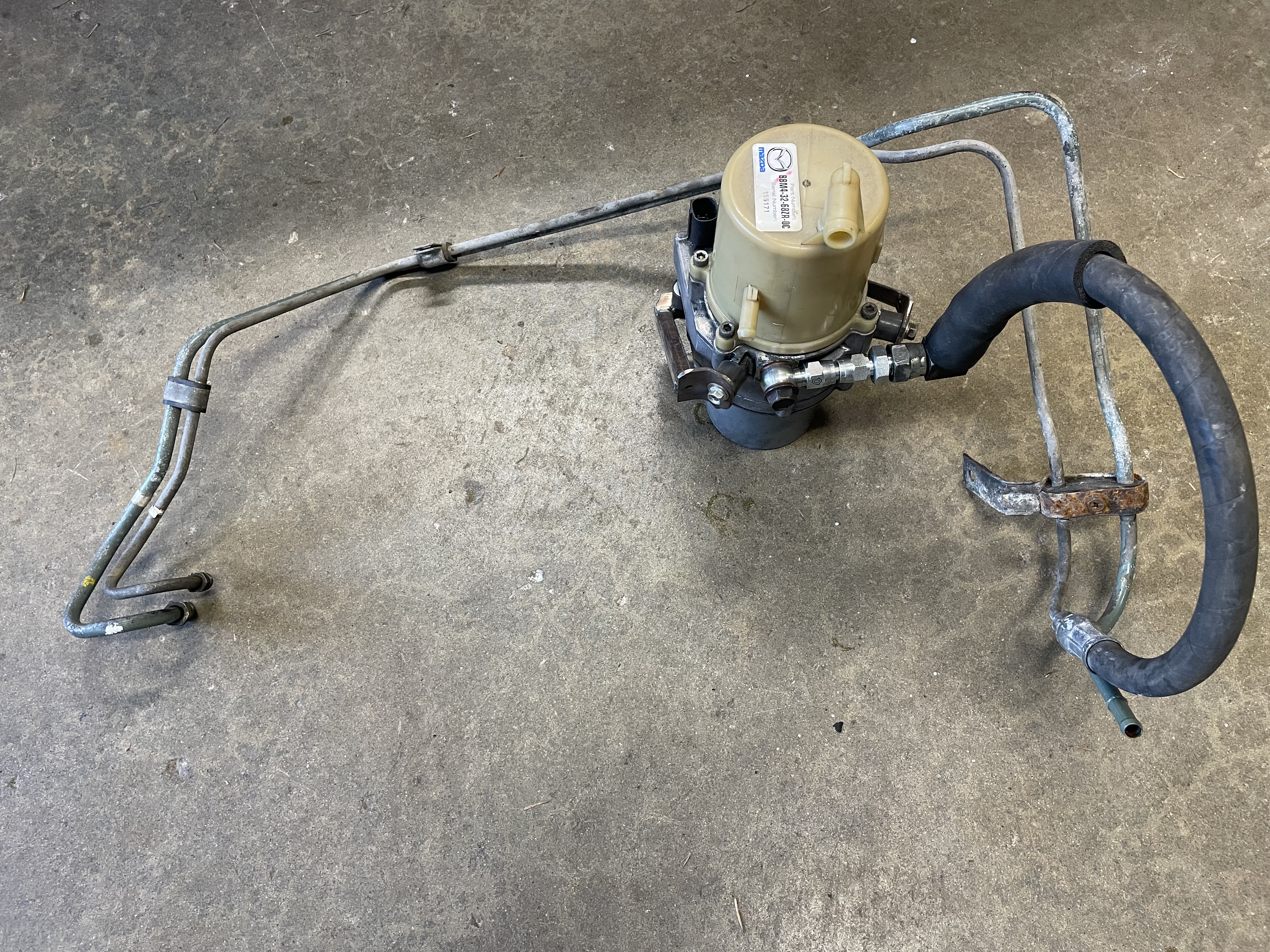

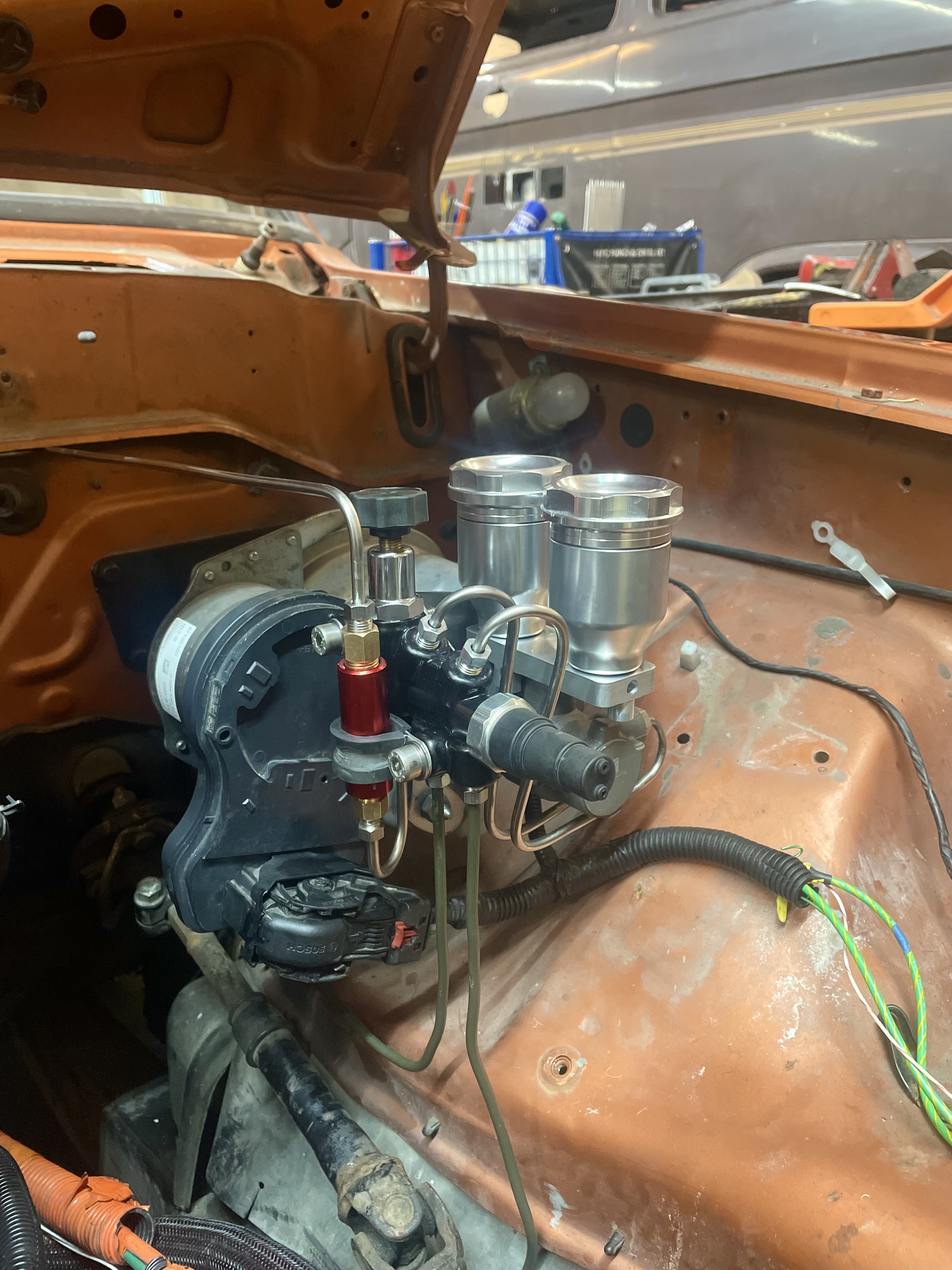

Power steering:
The truck has a hydraulic steering box.
There’s 2 options for power steering:
Electric power steering pump to feed hydraulic pressure to the box.
Or electric power steering column.
A epas pump is the simplest install, just plumb it in and good to go.
Cons are I’m adding weight as the pump is heavy
And there’s hydraulic fluid!
And it’s noisy
Yuck!
Epas column would be quiet, more efficient , and not add anything into the engine bay.
Con’s are lots of custom fab work, which is tricky as I’m am not allowing any of the original trucks column to be cut or welded. this is out of safety and keeping everything bolt on:)
there’s a rag joint just outside the fire wall… so it may be possible to retro fit a Prius rack with some off the shelf couplers.
but picked up an old Mazda epas pump for 80$ cad.

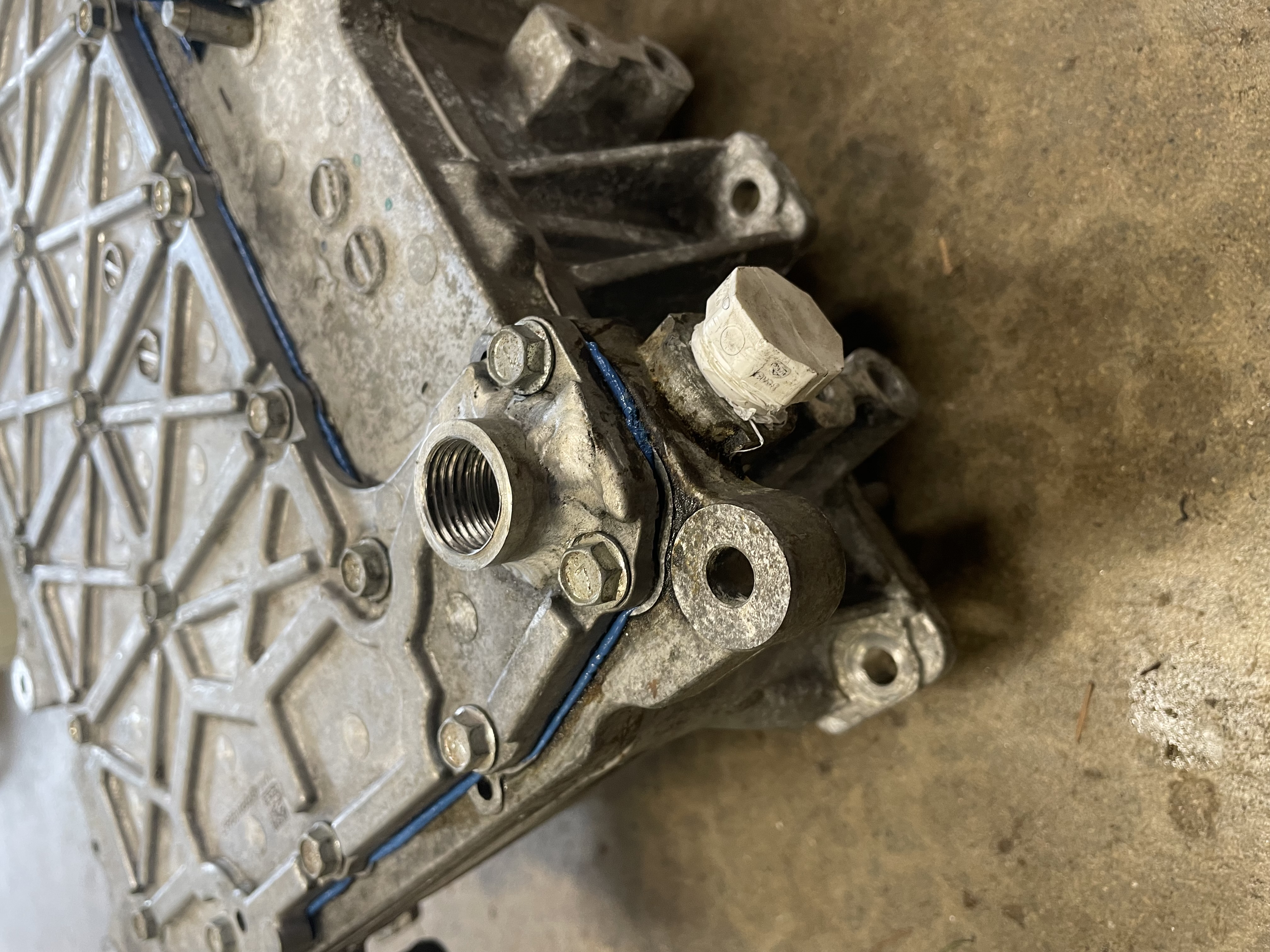

Heres the epas pump and the original line + pump from the truck.

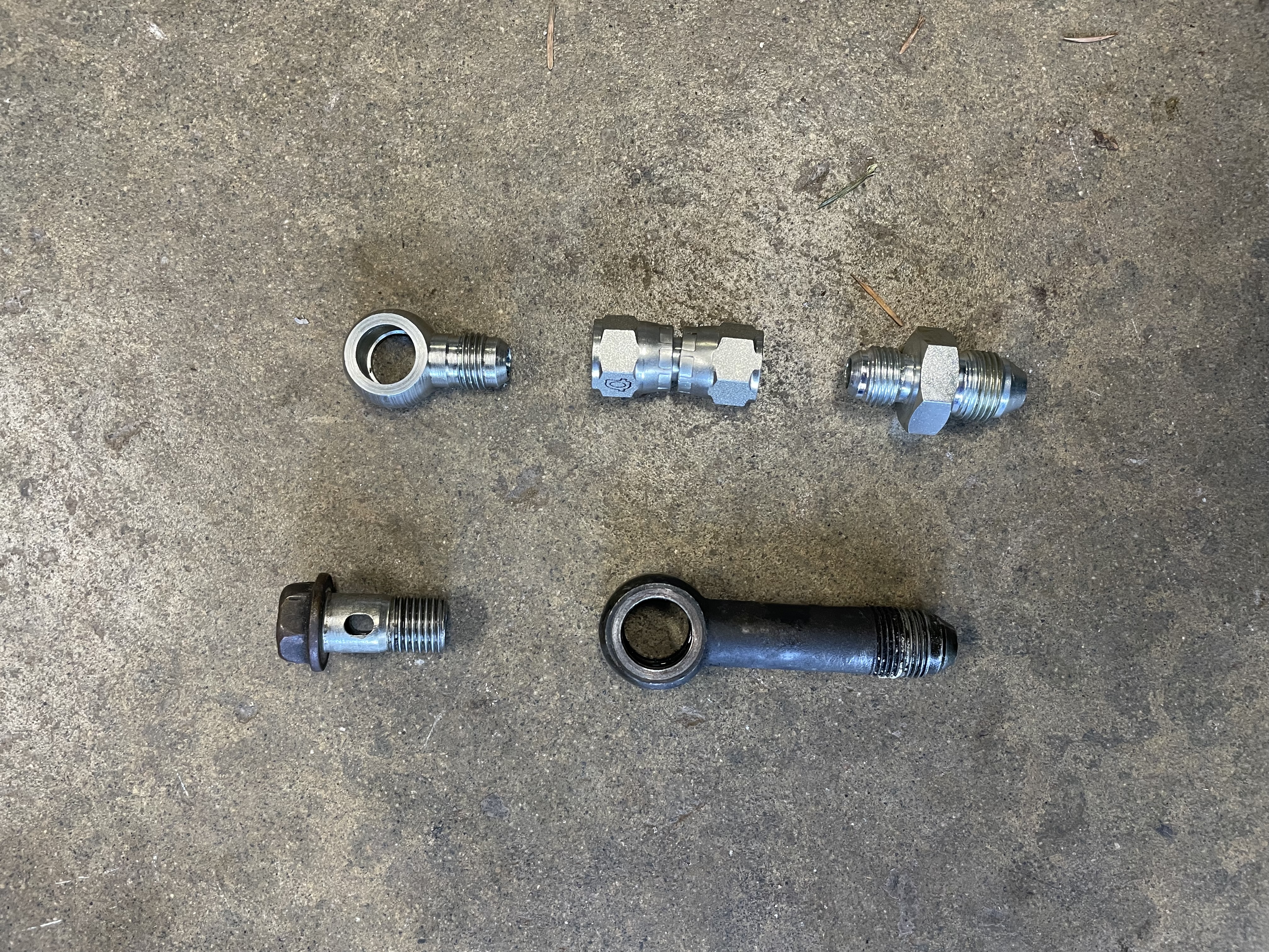

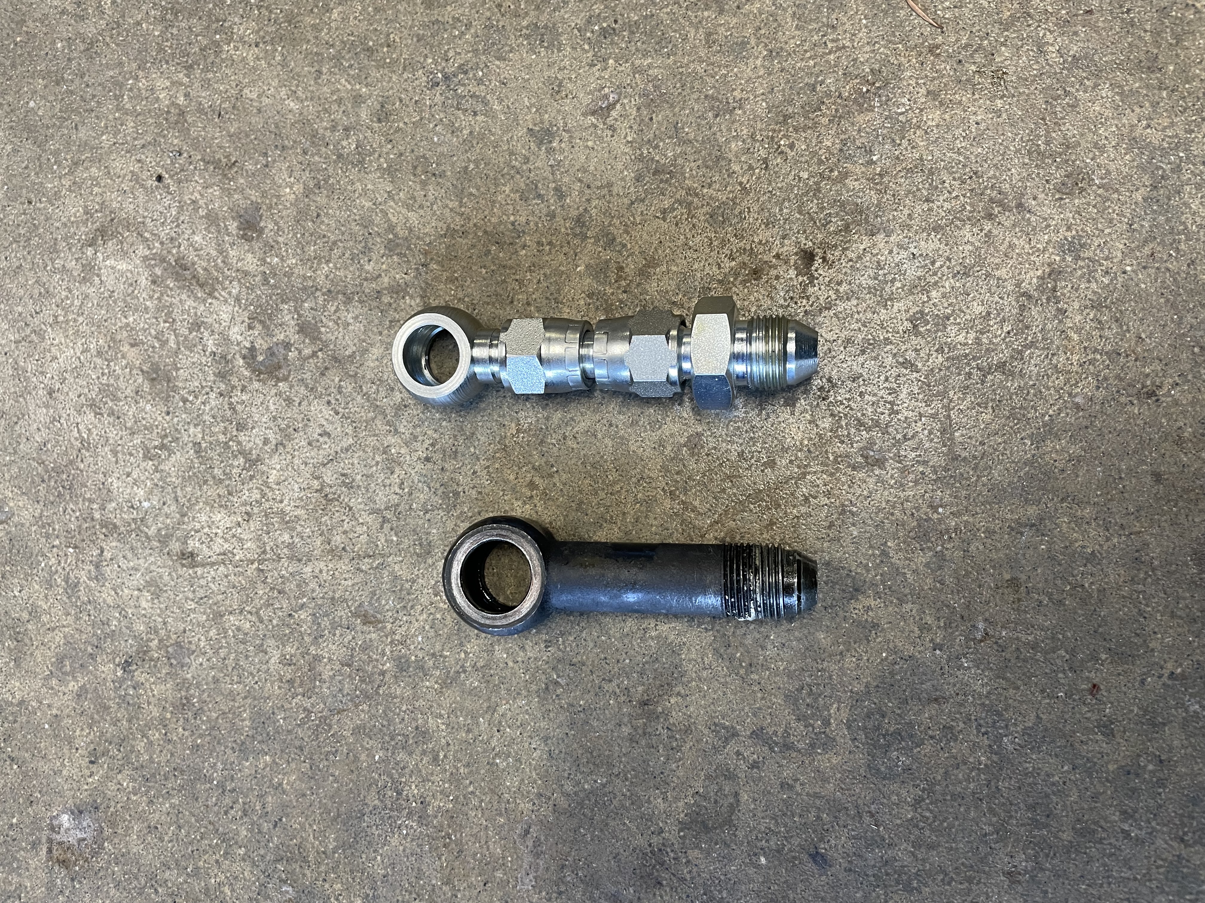

epas pump pressure outlet is a m14 jis banjo fitting
The trucks original power steering lines have a bigger jic banjo. Close but no cigar.
3 fittings later we have connections!
M14 banjo jis -> female x female jis union ->jis x jic union
simple, no expensive custom hoses, and all off the shelf parts!

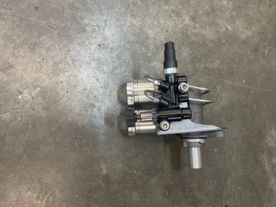

okay now mount it and work on controlling it. its not as straightforward as some of the other pumps like the volvo or ampera. it has 3 connectors, power, can, and analog steering angle.
luckly some one has done the heavy lifting already https://github.com/shifty35/mazda3-ehps-control
code just needs a bit of clean up and good to go.
what i have distilled down so far

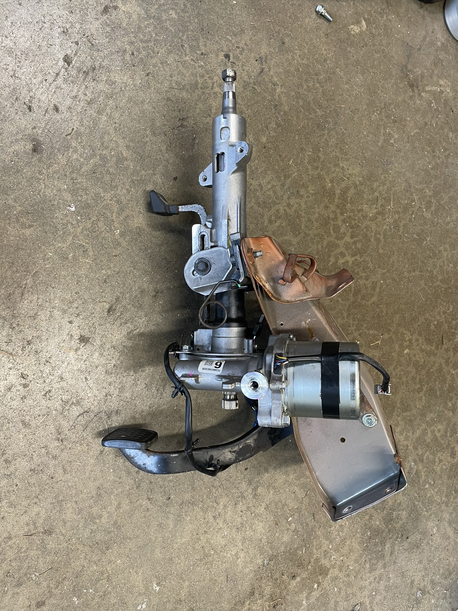

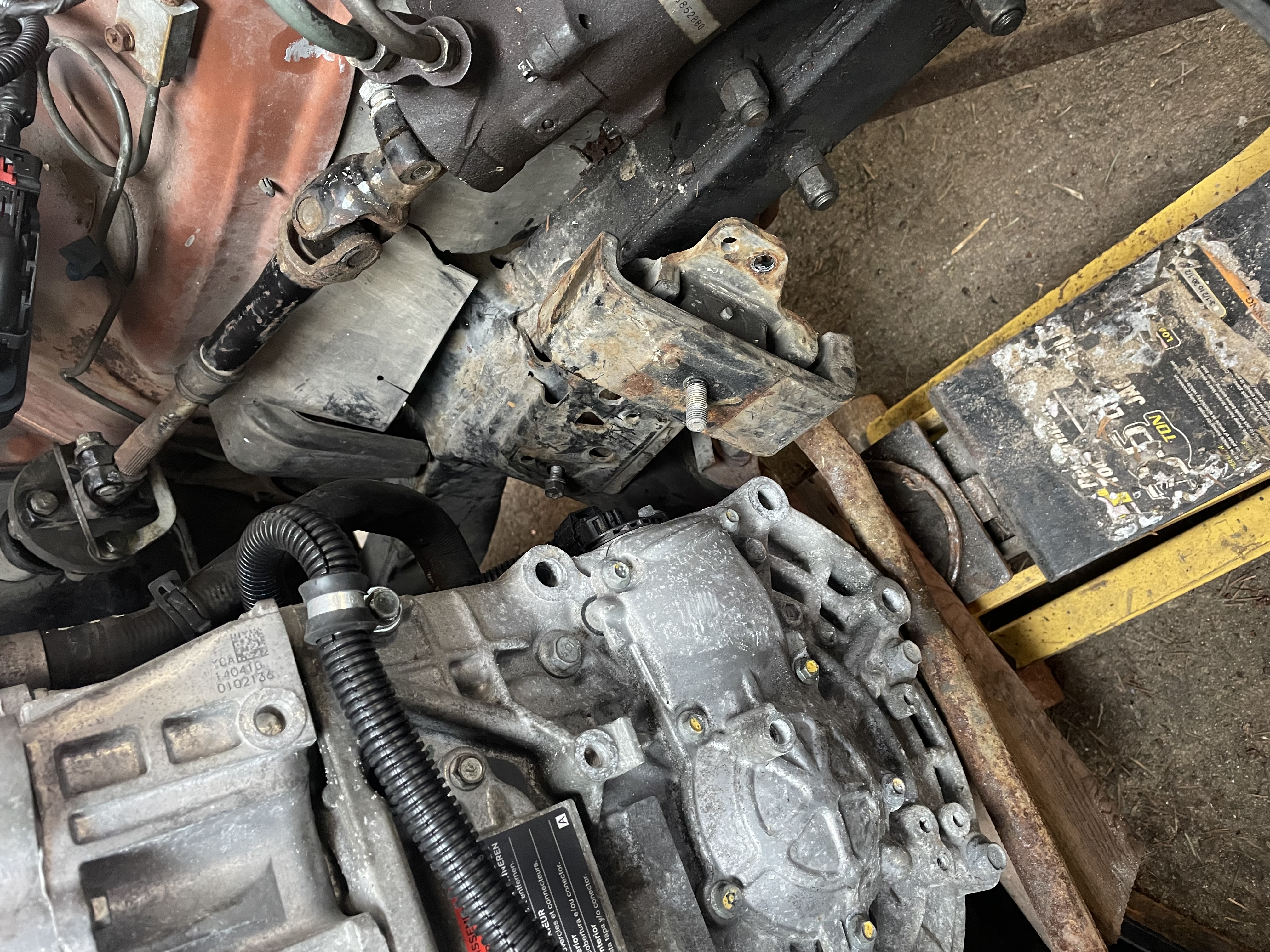

pickd up a 2017 camery epas column for 100$
and.....
its a direct bolt in to the pedal box.
crazy!
the controller box is directly bolted to the motor so i removed it for more space. its 3phase!
motor/gearbox is a bit to big and sadly collides with a bracket on the firewall. but looks like a yaris motor unit is much smaller and should fit with the camery tilt column part.
the output of the toyota epas motors is 11/16- 36 splines, and the input shaft from the steering box has a rag joint that meets at the fire wall.
so!
with the following off the shelf connections:
11/16-36 x 3/4 dd u-joint: https://www.borgeson.com/Steel-3-4-DD-X-11-16-36.html
3/4dd shaft: https://www.borgeson.com/3-4DD-Shaft-18-Long.html
3/4dd rag joint: https://www.borgeson.com/rag-joint-flange-3-4-dd
this should result in a nonwelded steering shaft, and bolt in epas :)

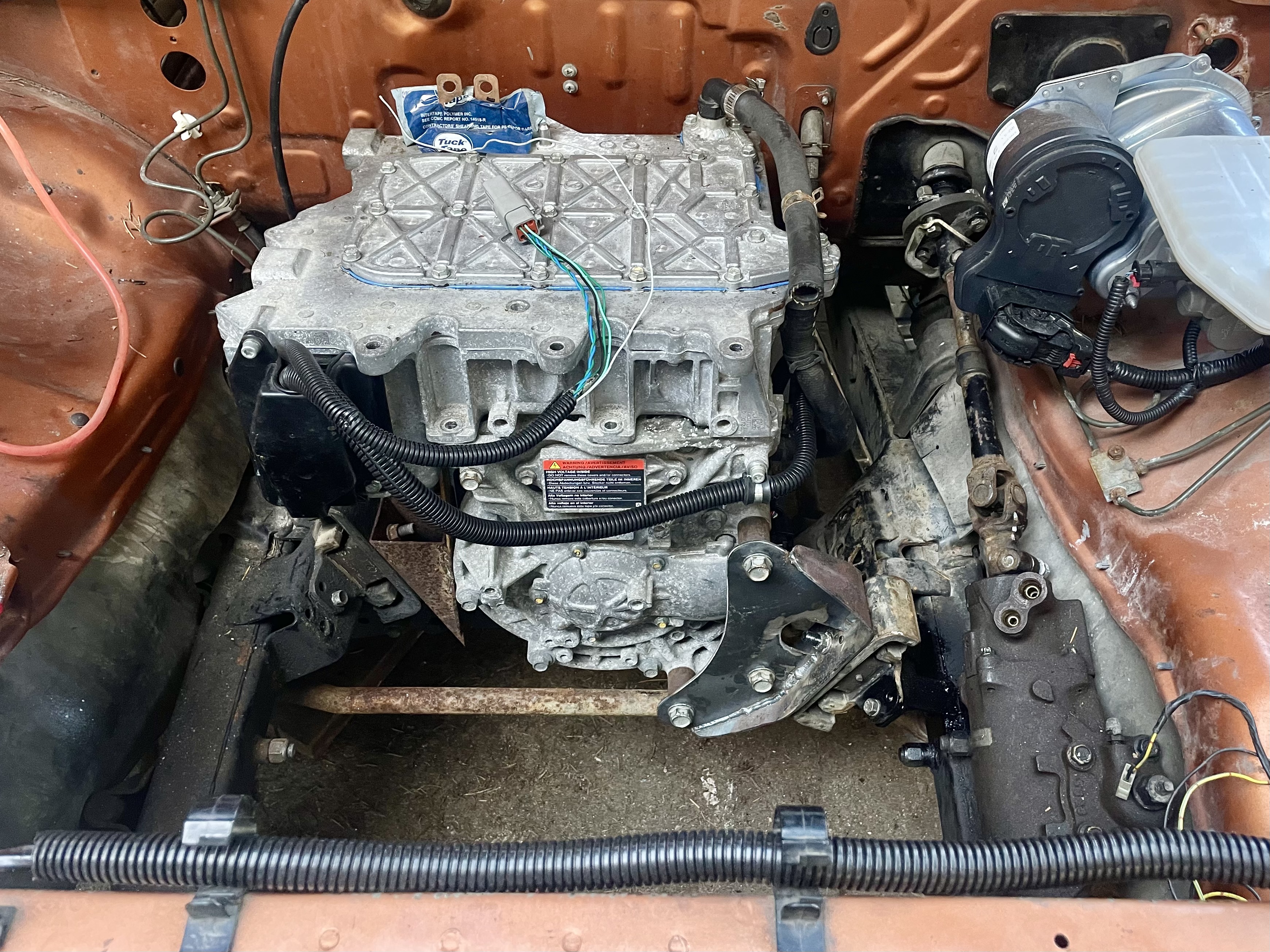

random little bits:
Re sealed the inverter and tapped the inverter coolant inlet to cap it off.

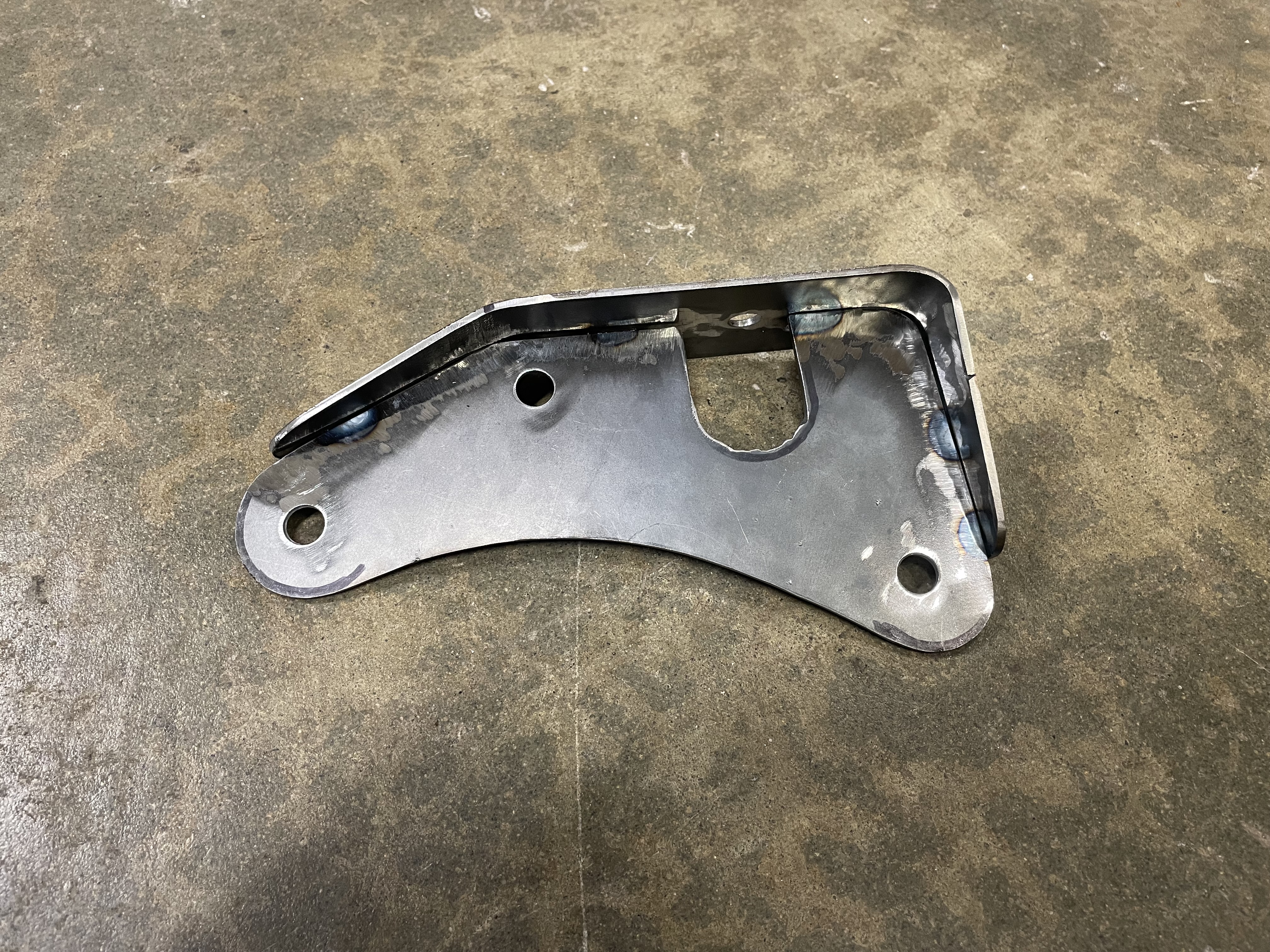

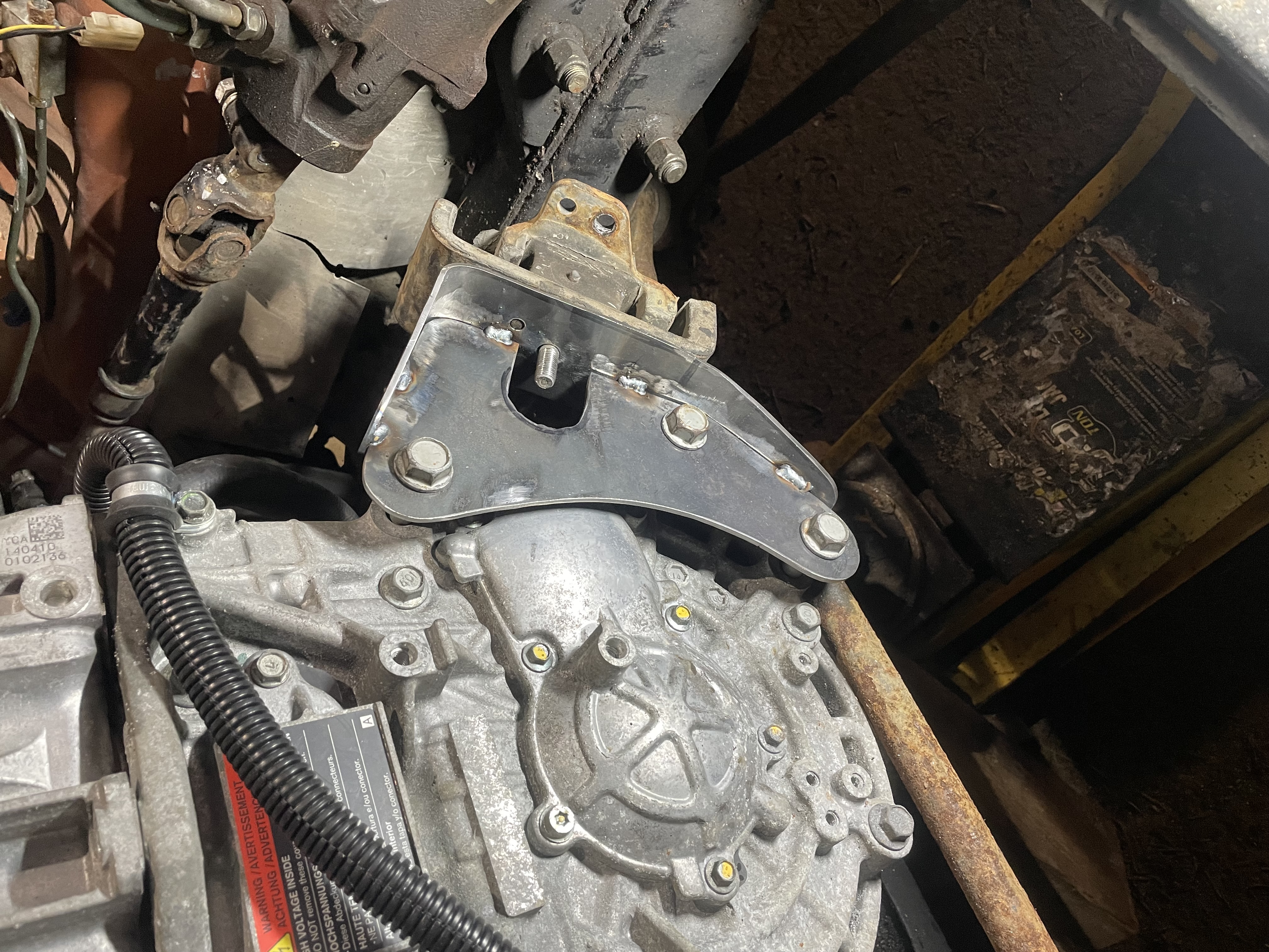

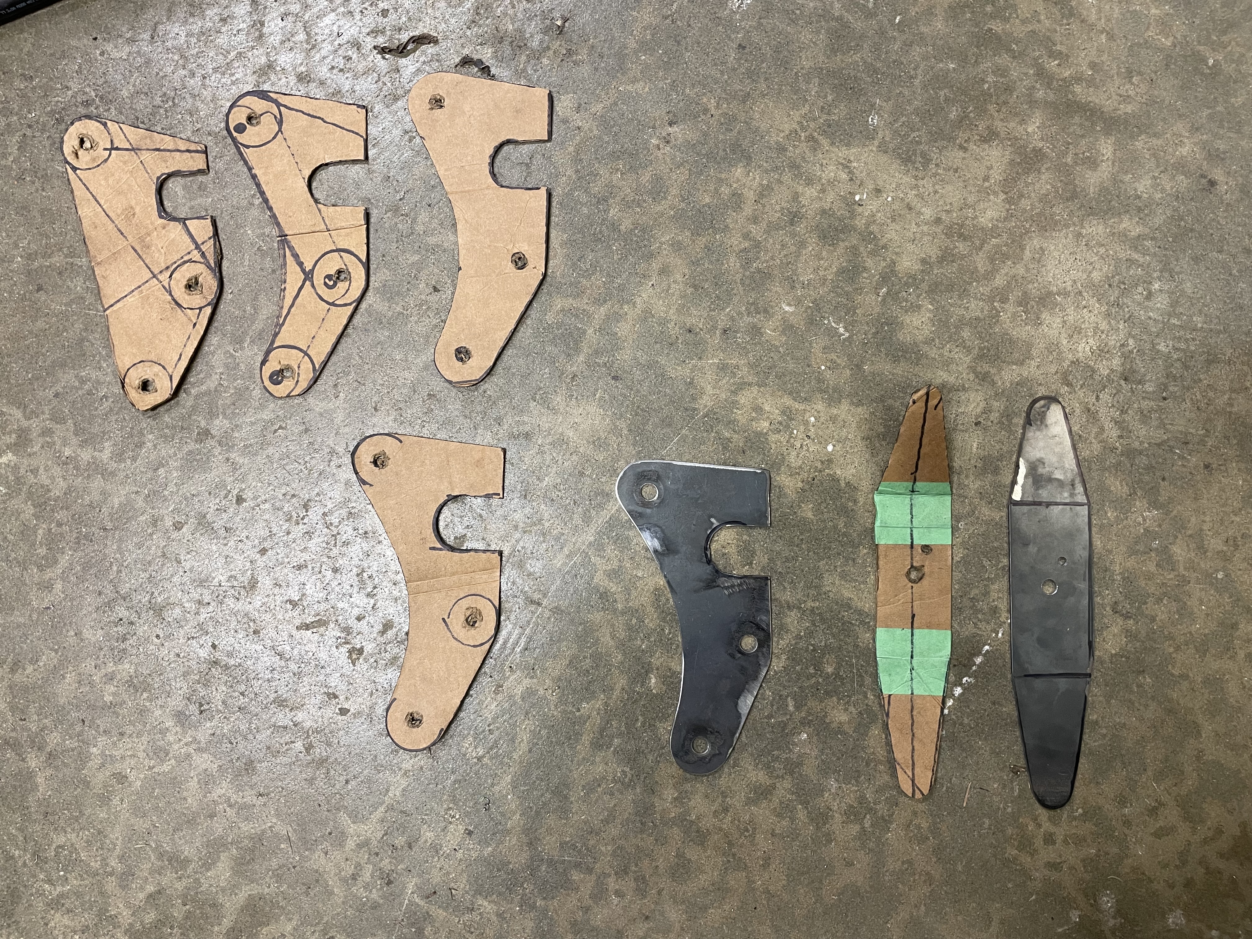

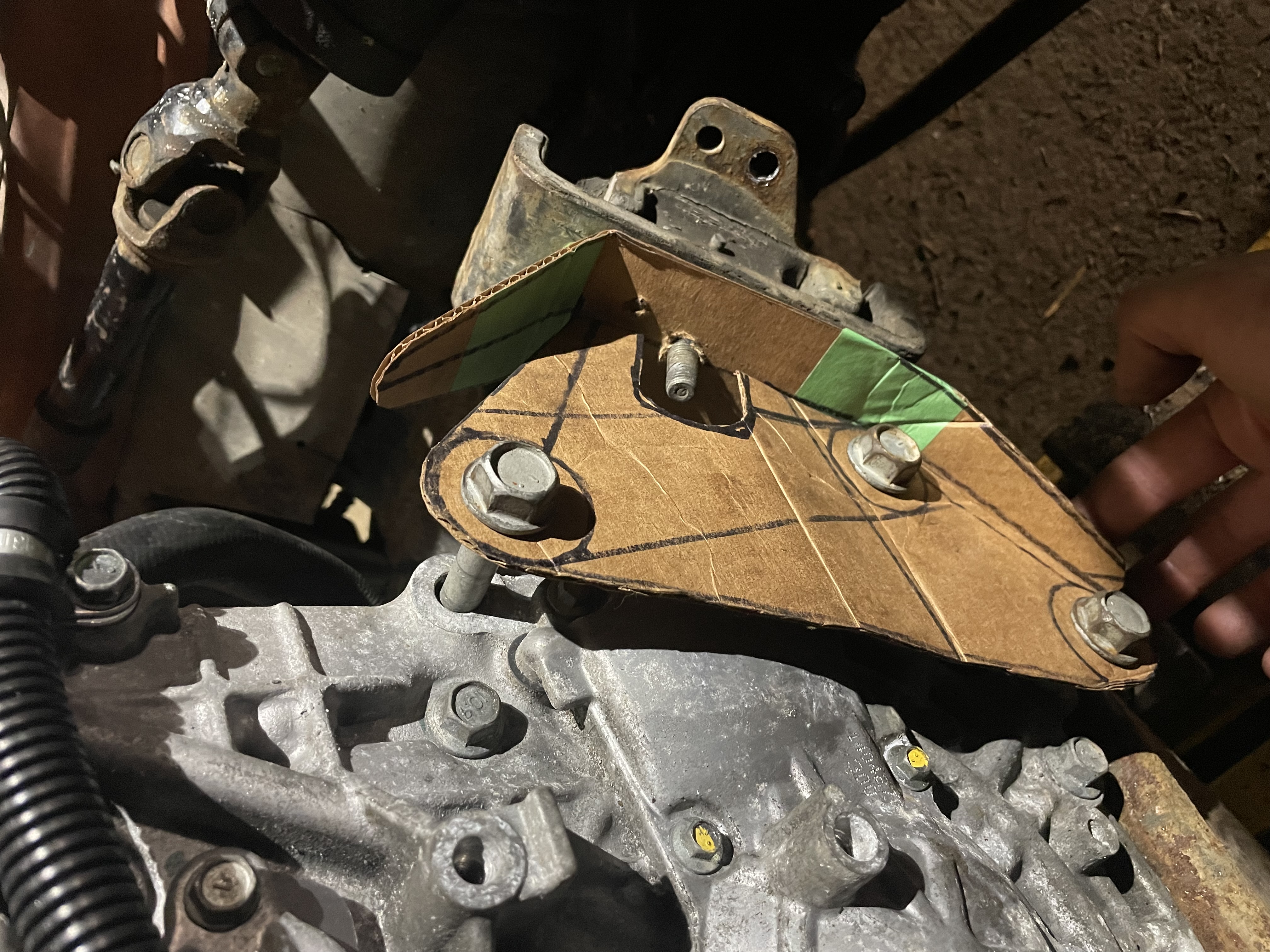

Been scratching my head on how to do the driver side motor mount.
Decided to shift the stock mount over and make a bracket that ties it to the pitman arm bolts on the frame. This puts the mount right inline with the outer edge of the motor.
been busy with lots of brt ind stuff, lots of CAD work, so it’s nice to just fab stuff by hand.. with more CAD work ;)
Which resulted in:
the centre link has always been close to the motor. A common mod on these old Datsun trucks folks do when engine swapping is a “center link flip.” You drill out the tie rod tappers, and press in a new tapered insert on the other side, allowing the link to be mounted upside down, give an extra 3-4in of clearance for a motor.
This extra amount of space might allow the PDM to clear the hood..

Finished off motor mount with some goopy welds (its great that all the clean ones are hiding on the back side)
and started to assemble the prototype “pre- built” zombie unit.

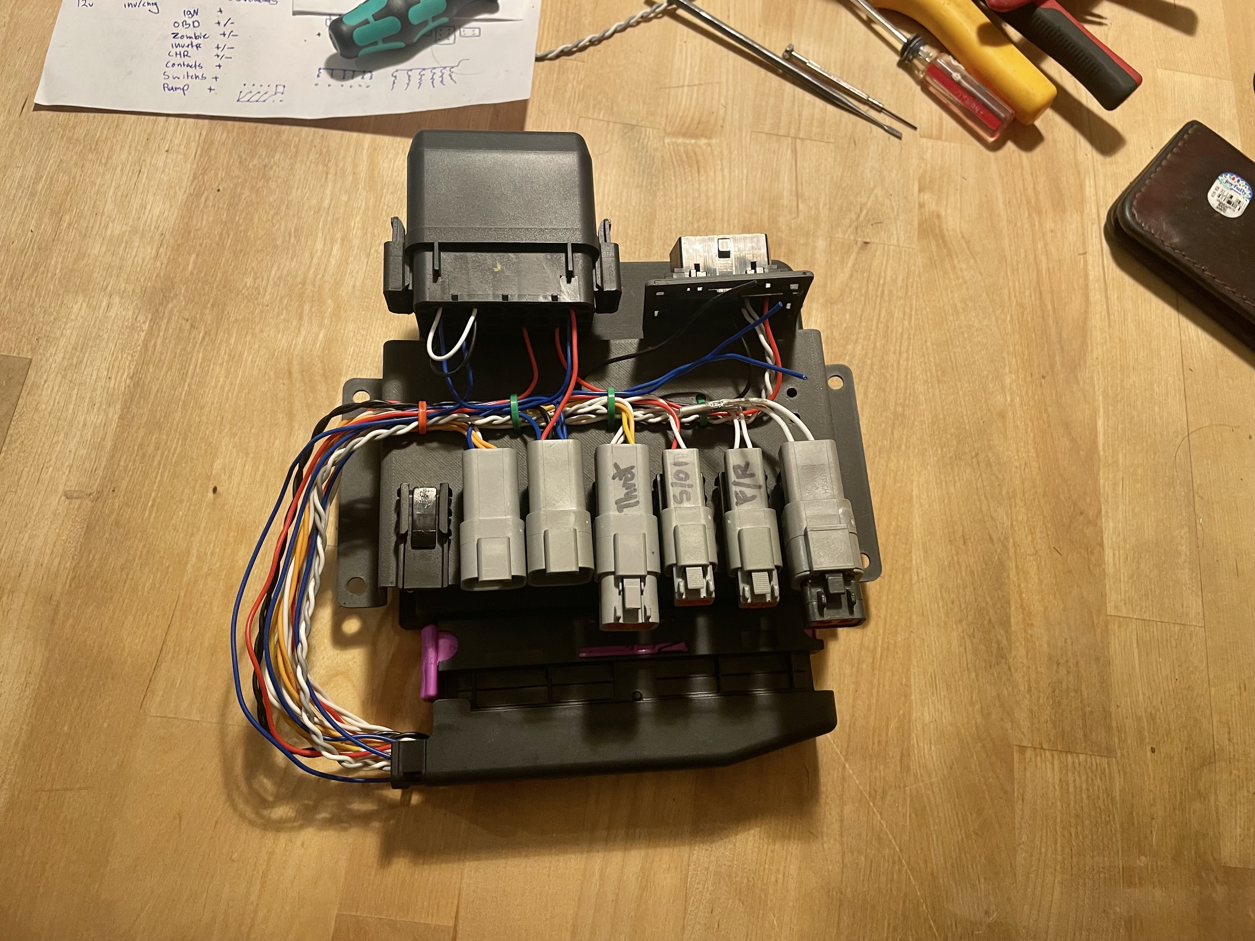

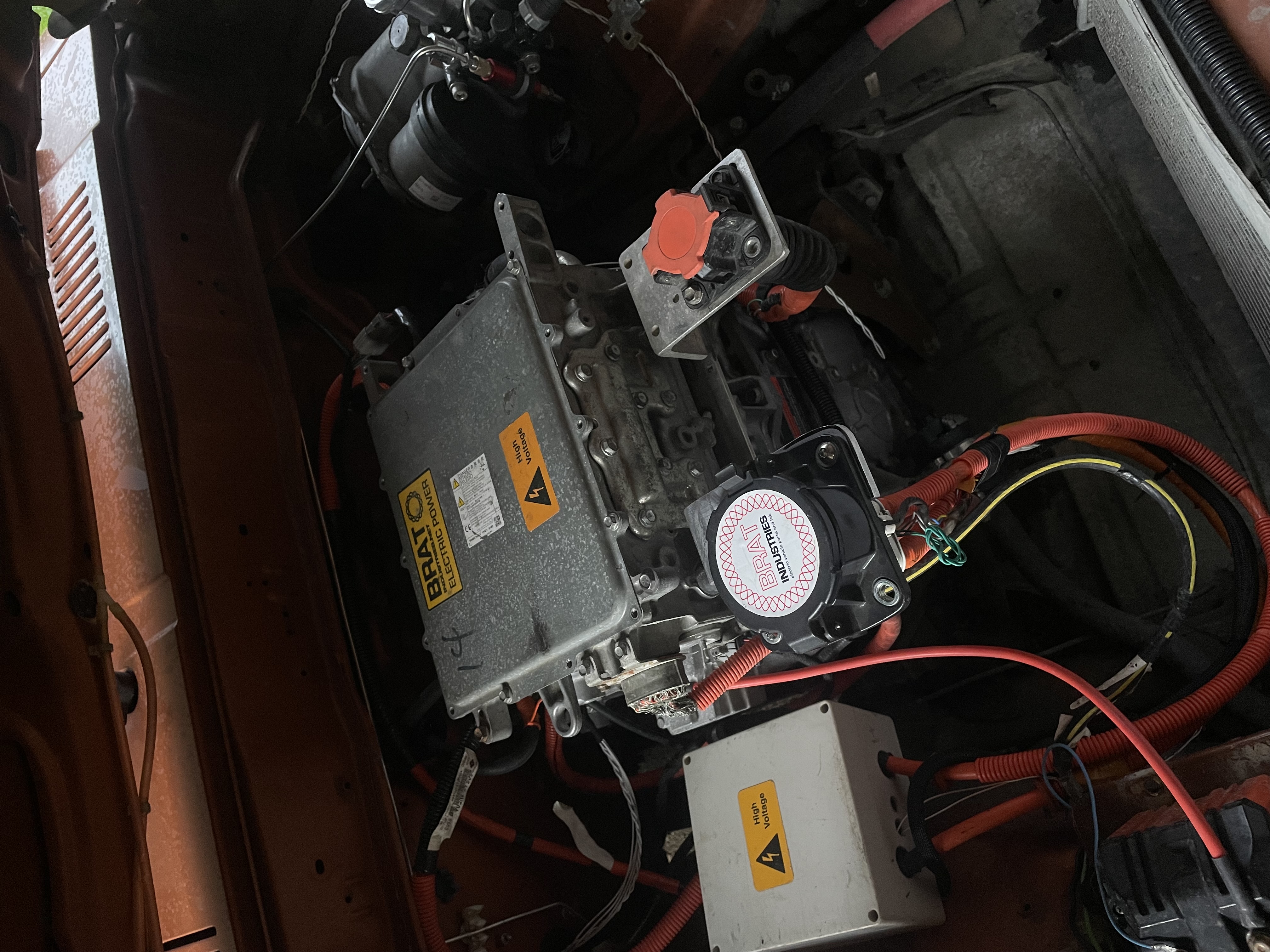

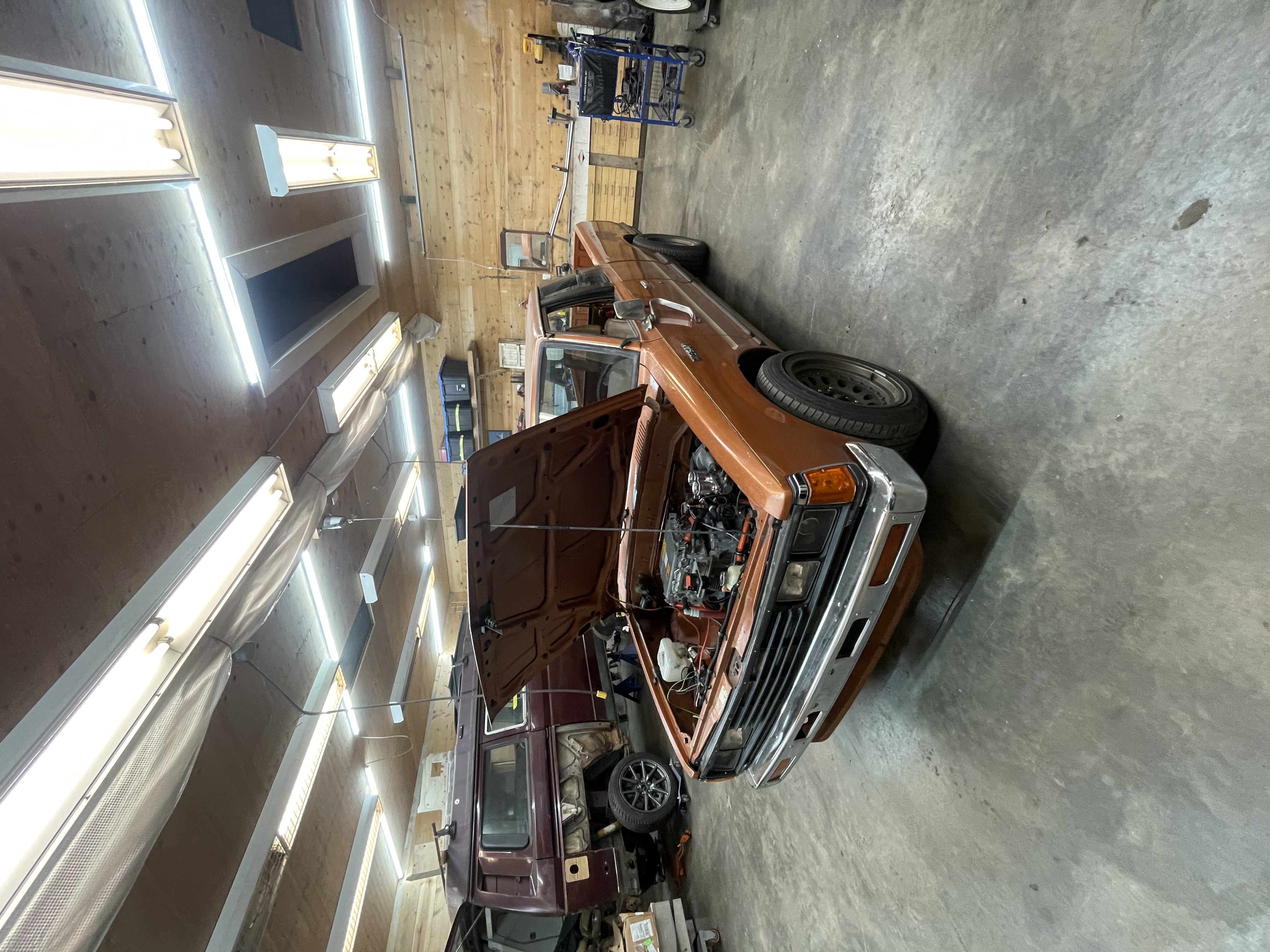

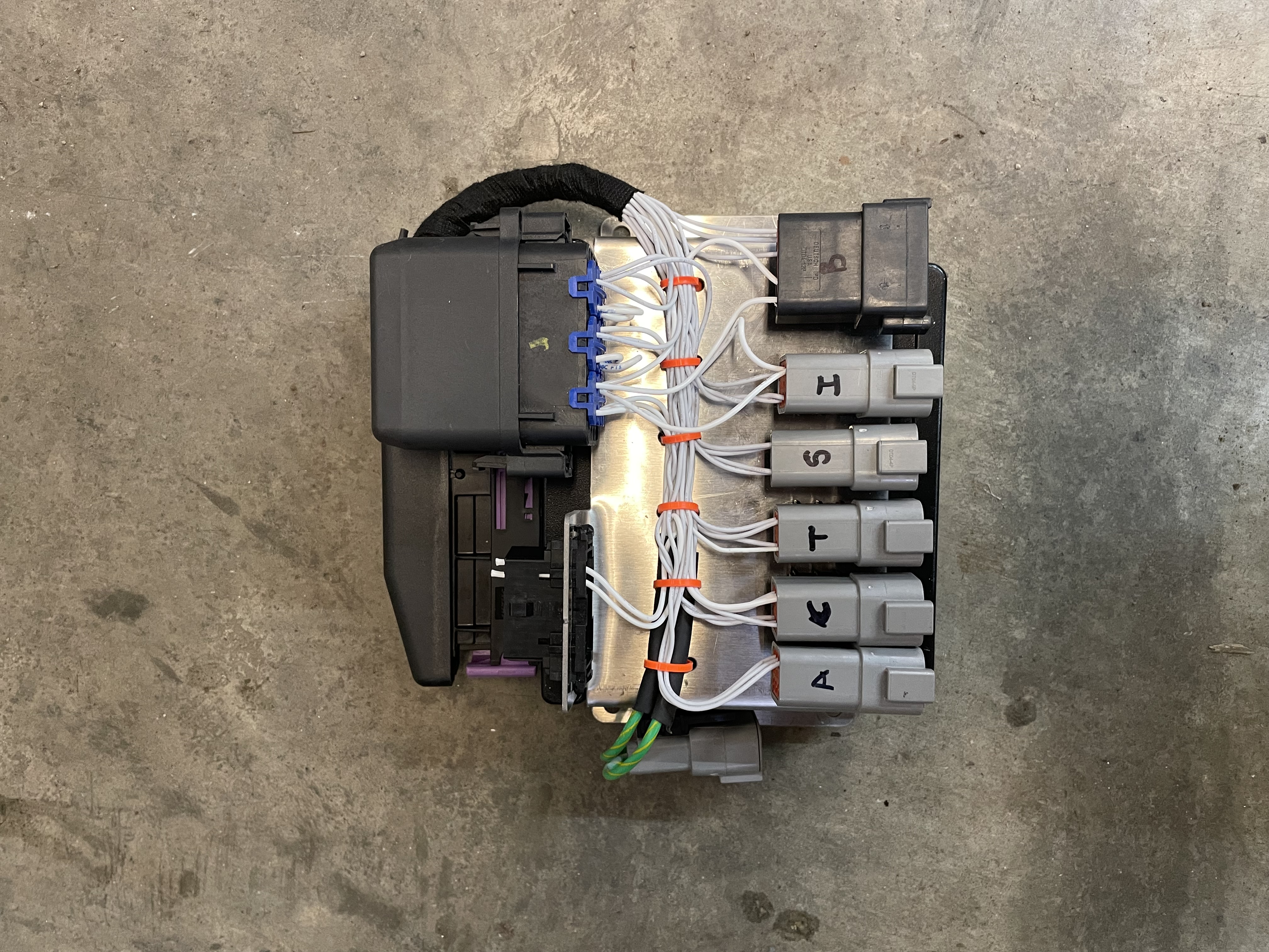

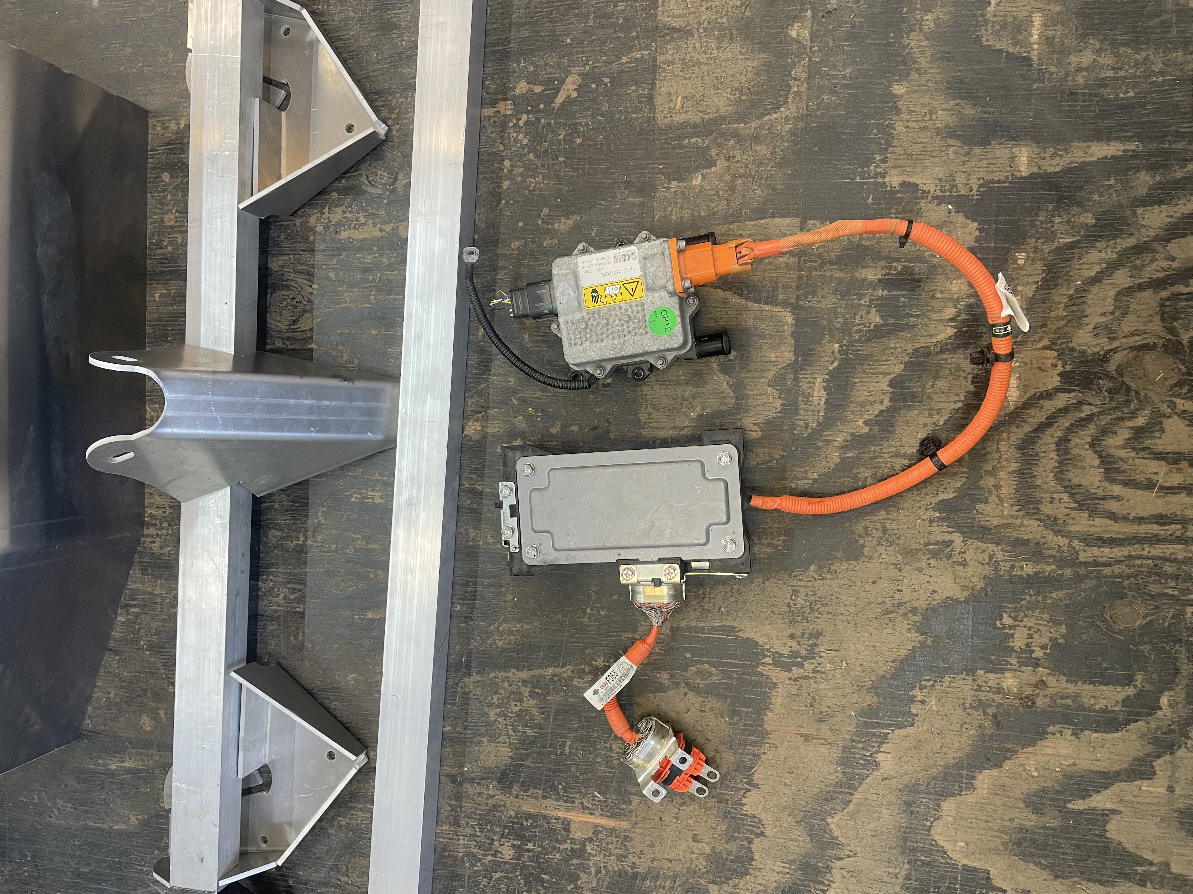

picked up a 110k stack, and installed a rough generic zombie harness.
along with all the other little hardware bits and clean up, truck is temporally back on the road running 2.22A, and ready for the journey over to the new shop in Victoria!
110kw in this truck is a lot....
datsun720-prams.json
(2.13 KiB) Downloaded 60 times
prams will drive the following:
-350v fully charged pack (partial volt pack,84s)
- leaf motor em57 110kw inverter
- outlander OBC (with a leaf charge port, and a 330ohm pull up resistor to 5v for ppval)
- water pump at temp set point
NO IVT SHUNT! :)

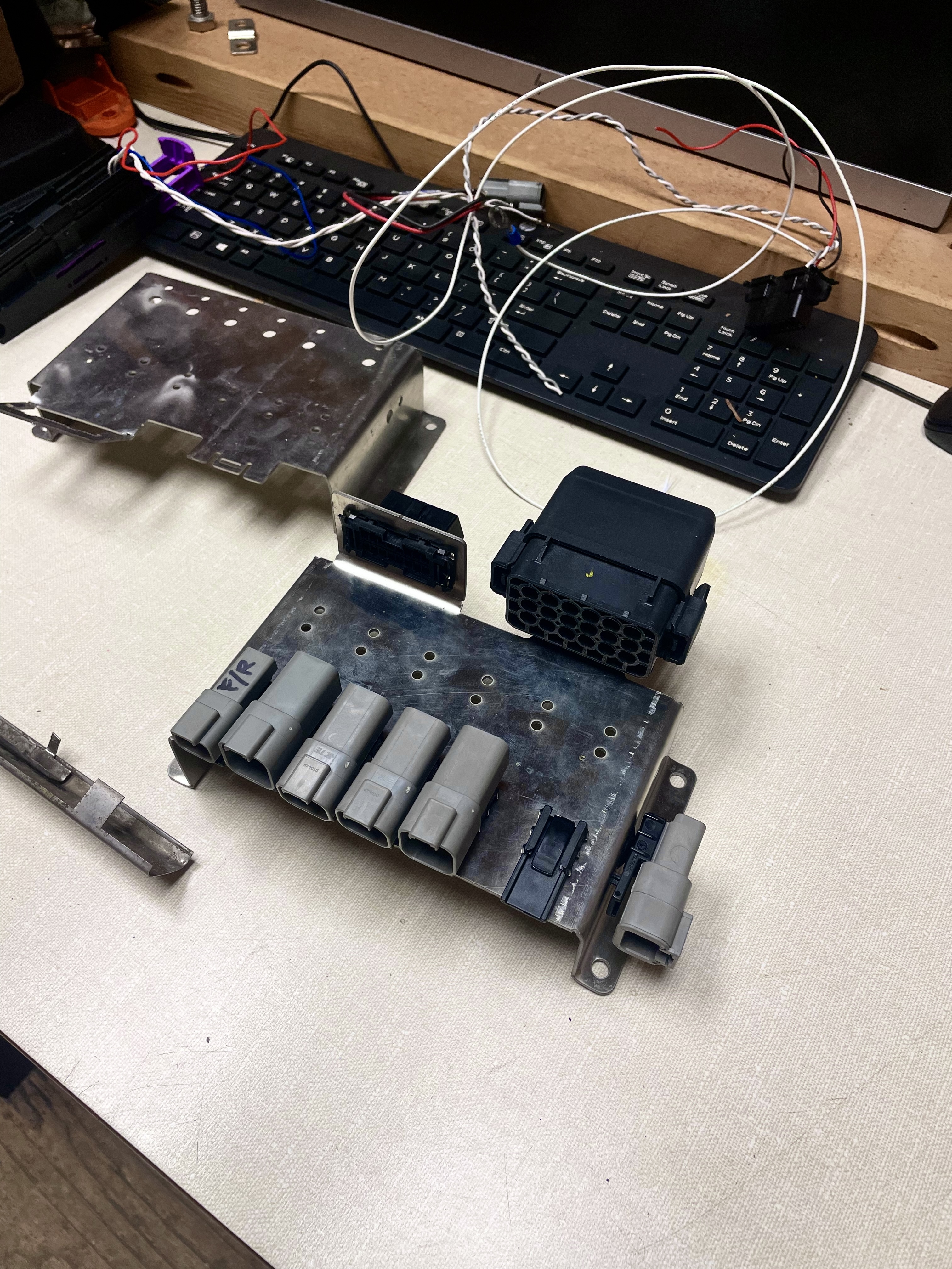

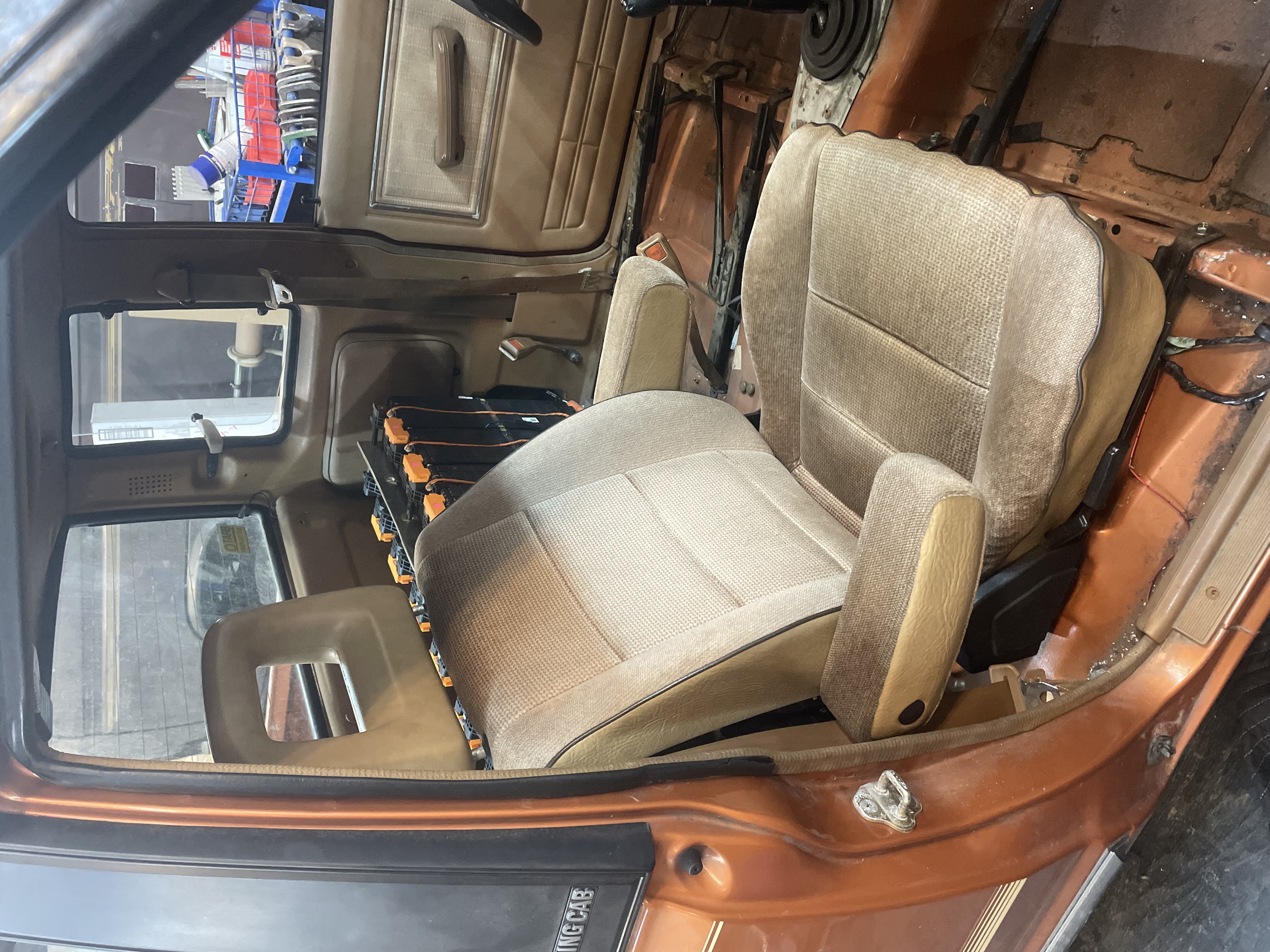

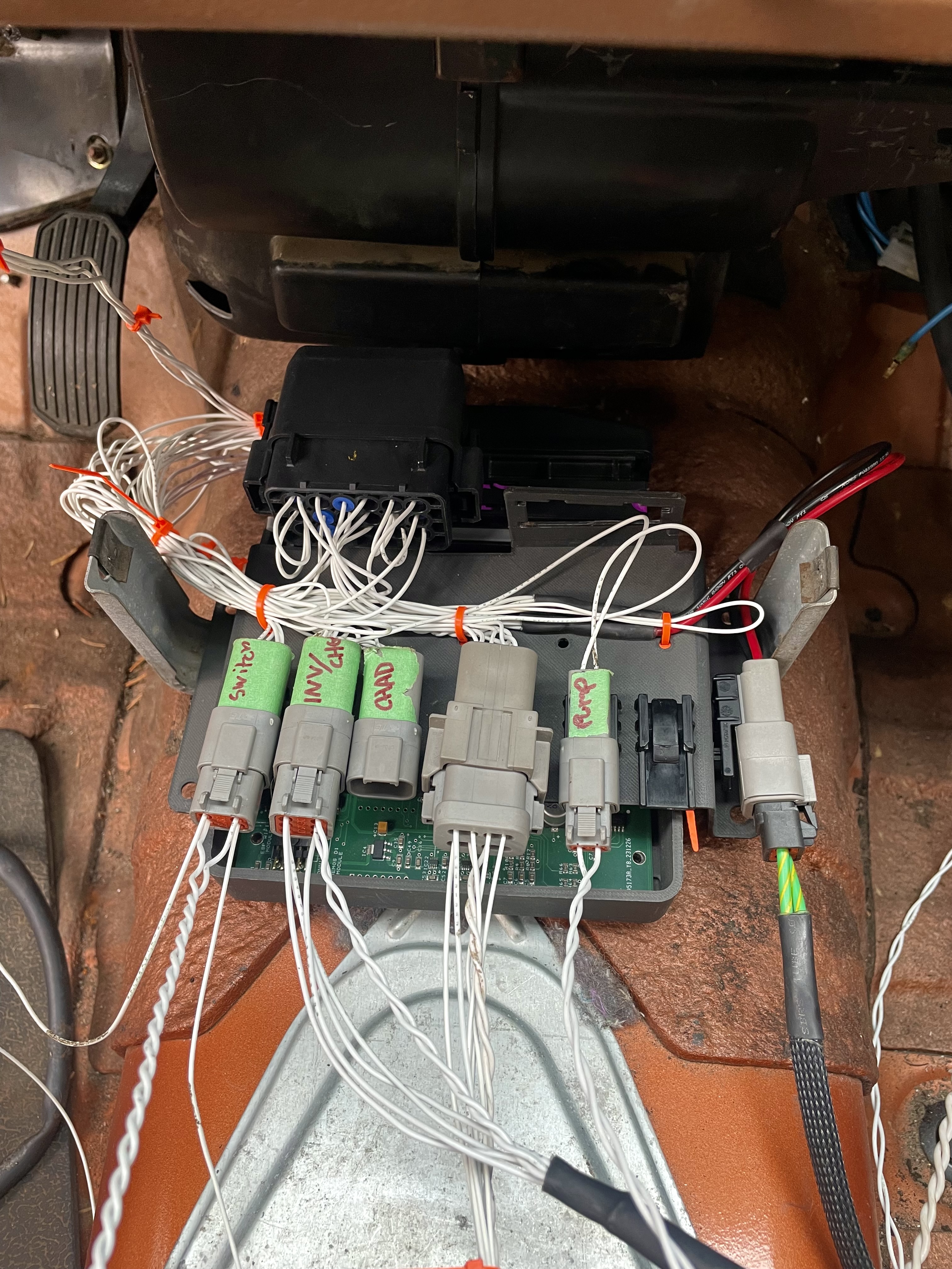

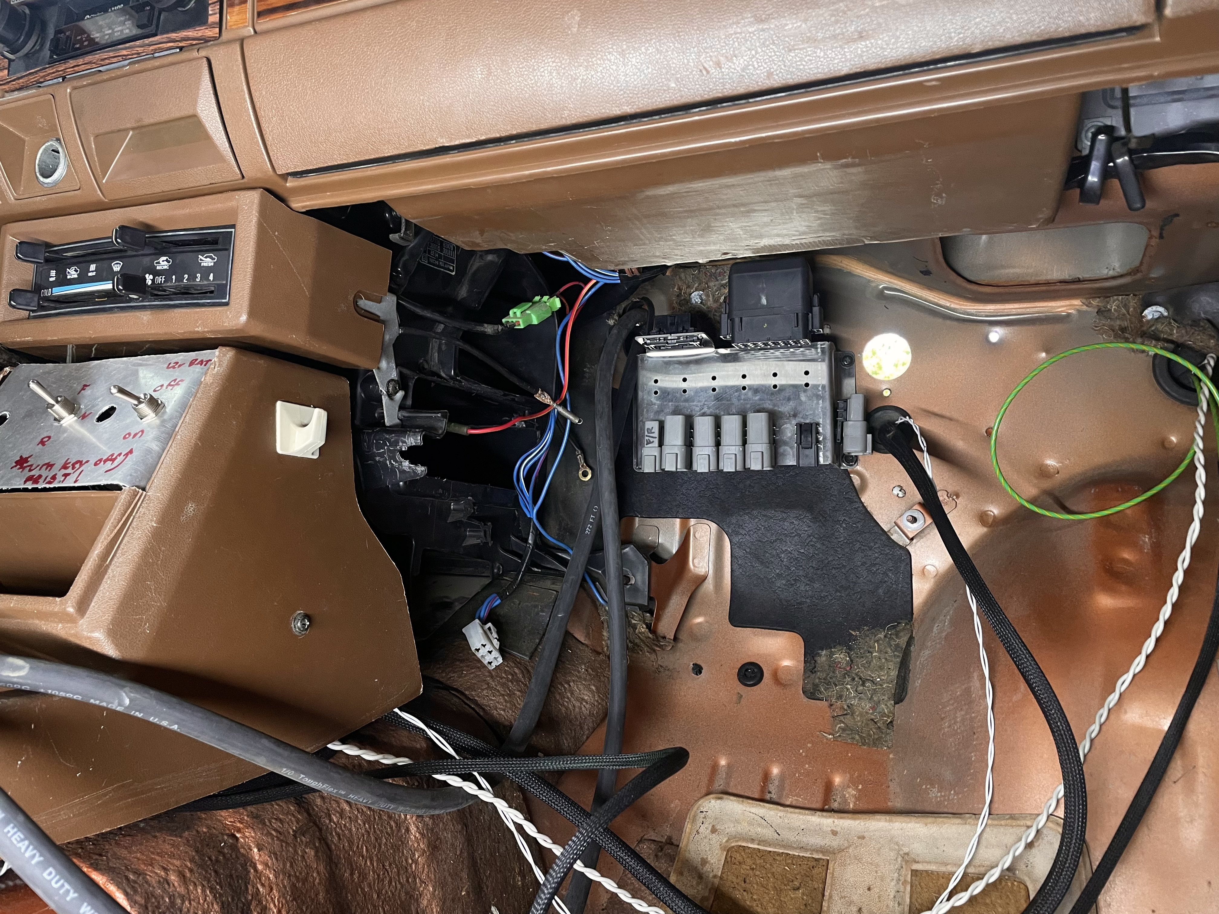

Now that I’m back in the new shop with mostly everything, I got some stainless trays cut for the zombiverter prewired interface.
After poking around to find a nice spot to mount it, I settled on the inside of the passenger fire wall.
fits behind easily removable HVAC ductting, keeps wire runs short, and is very safe from any moisture exposure.
I’ll be also able to access the obd port through the glove box!
Now can start collecting new lv connectors and build a clean harnesses for the trucks ev system

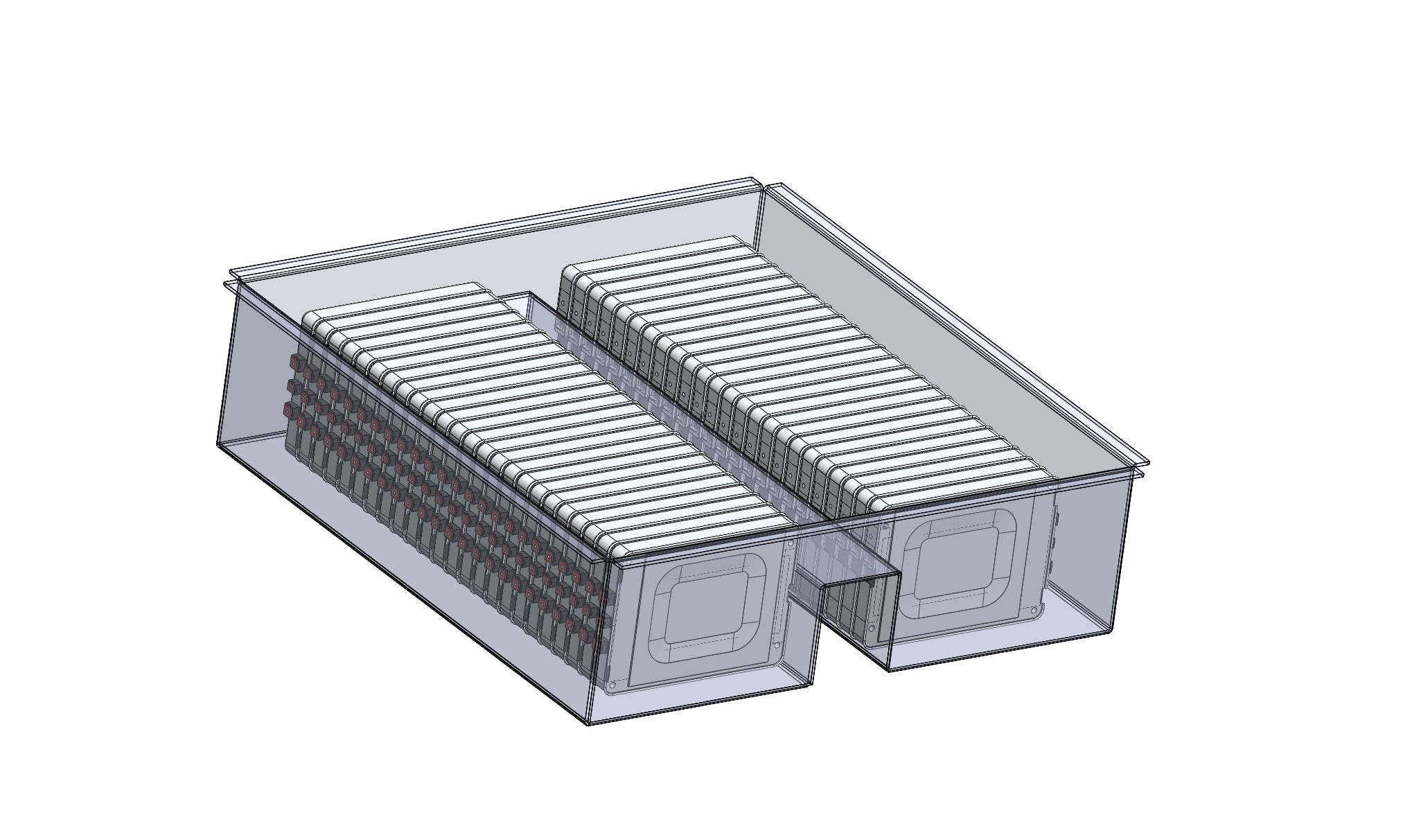

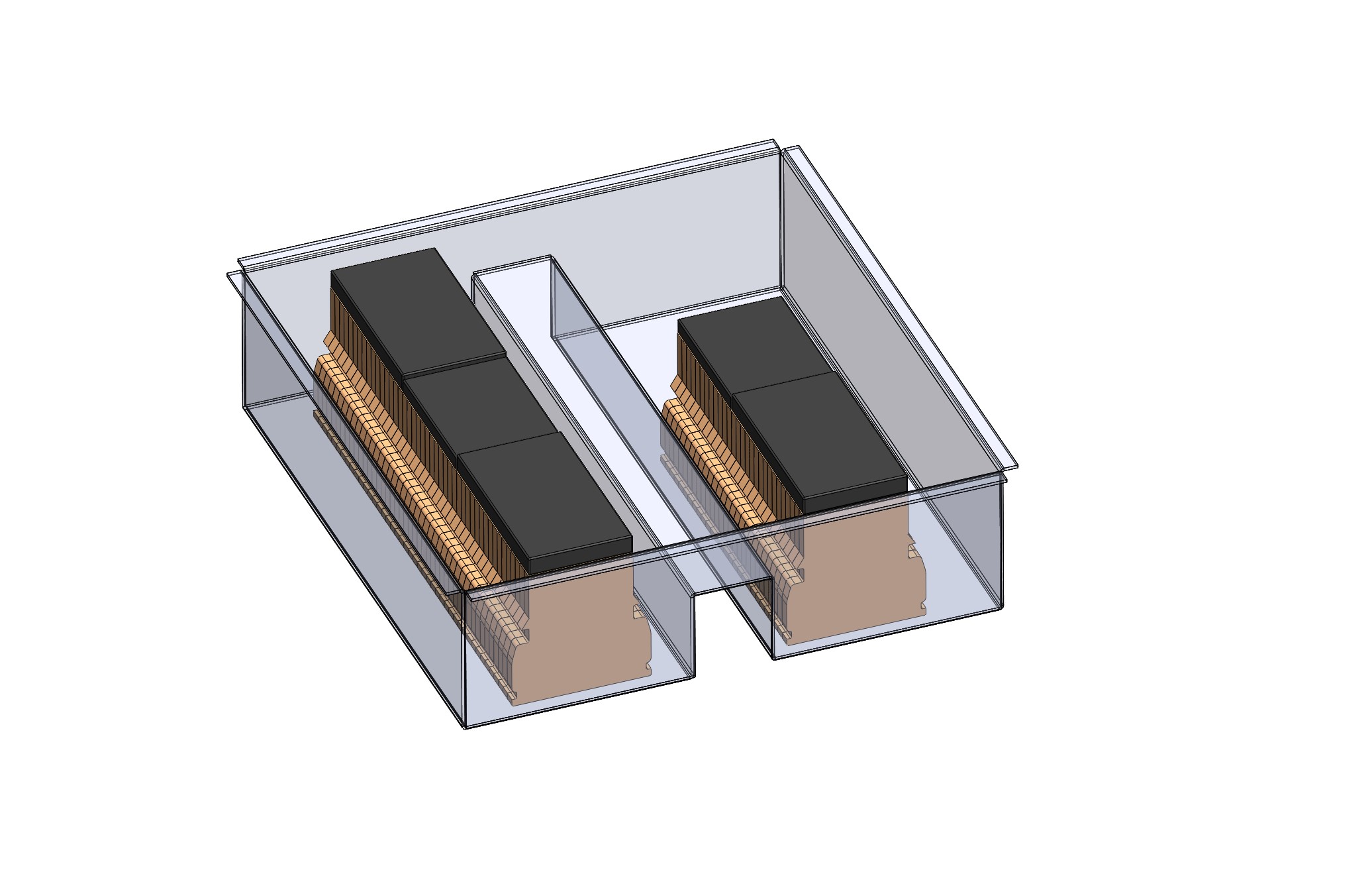

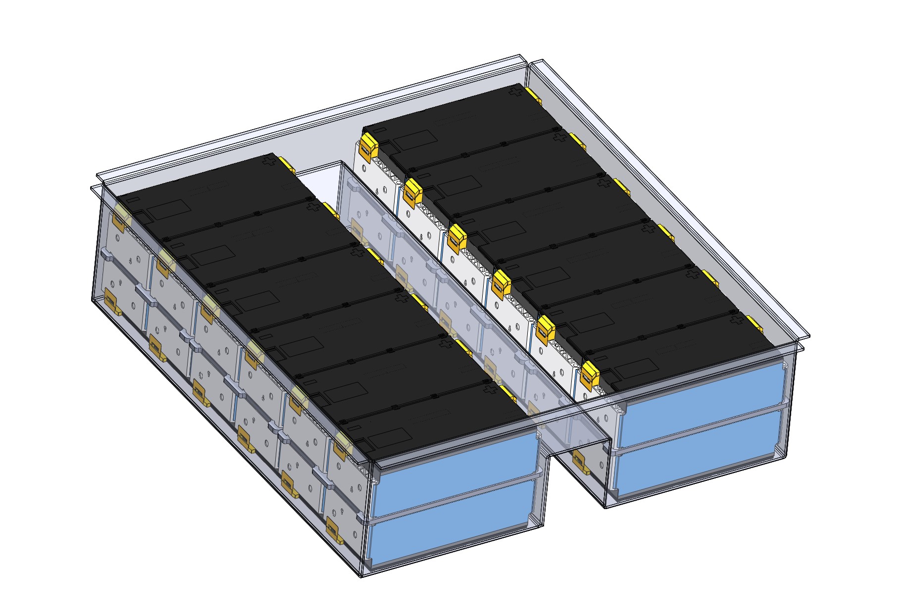

had a moment to spare and dick around with battery modules in the truck. in this case im just going to make the biggest saddle pack i can for the truck, and stuff what i can inside for now. ideally id like to get some vda355 4s3p modules and cram 55kwh in there, but ill have to wait intill a pack shows up with the modules im looking for. there is room for a secoundary rear mounted box, and could fit a full etron pack with 32 3s4p modules, but truck starts getting heavy, right now its very nimble!
the ionic modules are too long unfortunately and will collide with the already tight driveshaft (tunnel).
24 vda355 modules
all 48(96) leaf modules
my current 14kWh gen 2 volt pack

after humming and hawing about how I’m going to approach heating..... I bought a mg water heater from the uk for cheapish.
also picked up a replacement heater ducting box for the truck (as I had cut the original one up to fit a id4 heater matrix) at a pick and pull for 30$
along with other interior trim!
So that settles it, I’m going the simple route and just pluming in a coolant loop through the original heater system. Not as elegant as fitting a ptc, but it’s simple!
mg heater arrived, and wow it really is small!
Okay off to the bin of random connectors I’ve collected as I know I have a te hv plug that will fit…. And !
The outlander hv junction box has one that fits! Look at that! Just need to double check ampacity of the cables before I pull some power.
this will make for a very clean oem install as the outlander obc will also junction in to this with stock cables.

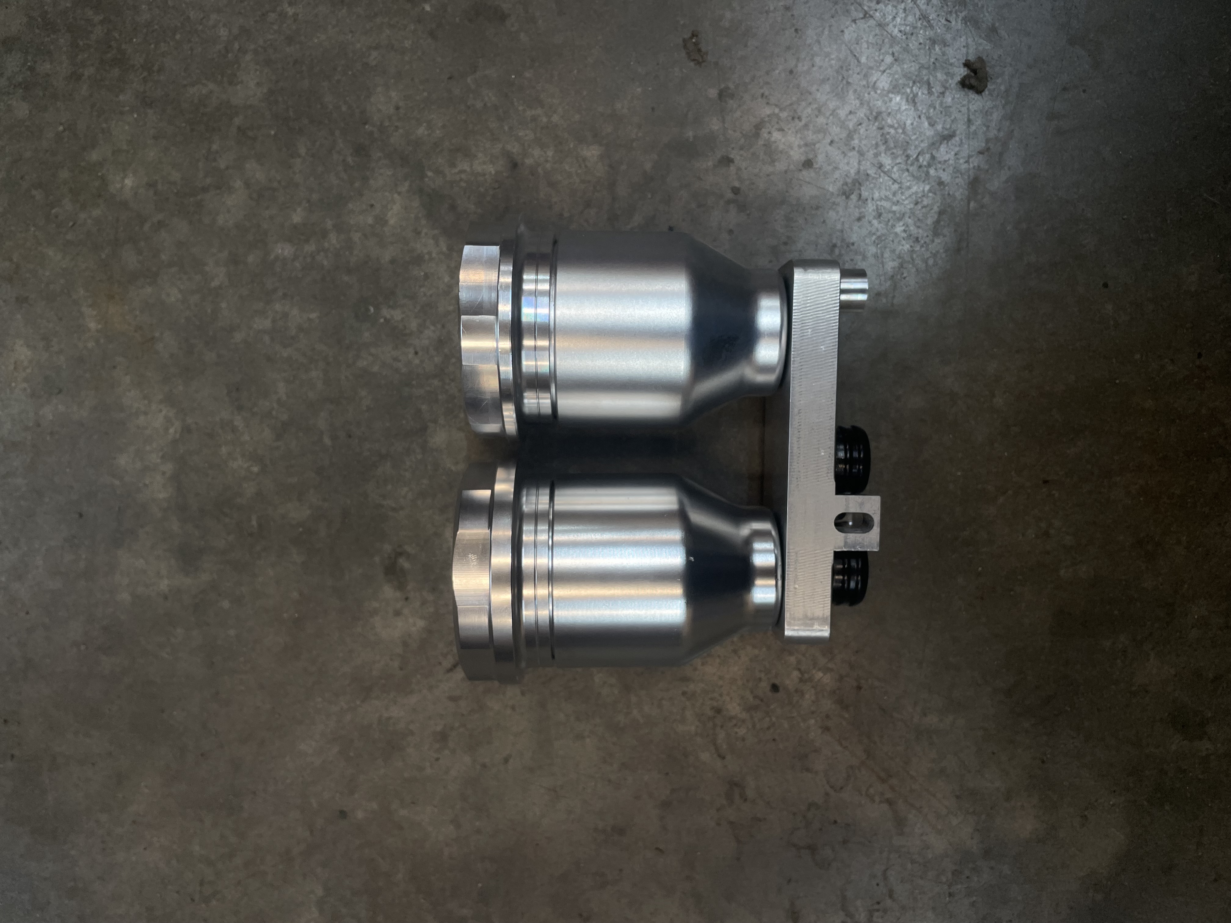

slowly worked away at a few things on the truck past ew months. And the last 2 weeks i spent s bunch of time pulling things together:
-new windshield gasket and under seal paint.
-battery brackets (for 16 ioniq 5 modules)
-custom tesla ibooster resivoir and proportioning valve setup
-cleaned up coolant system
-new ev wiring
- pre wired zombie VCU interface:
This is really proving itself. Makes wiring the ev system very simple and easy to diagnose any issues.
Now having built a few for different setups, I’m starting to nail down key features and get to a very standard layout that should cover 90% of most conversions.
- new proper length harnesses
-new seats:
beige vanagon seats really matched the interior and look stock in the truck, so custom set brackets and a heated seat kit
truck is back on the road softly, still a battery cover to make and get the bms set up and running. Just waiting on the MAX chipset version of Damien’s and Tom’s M3 bms board. Then off for testing with the ioniq bms boards

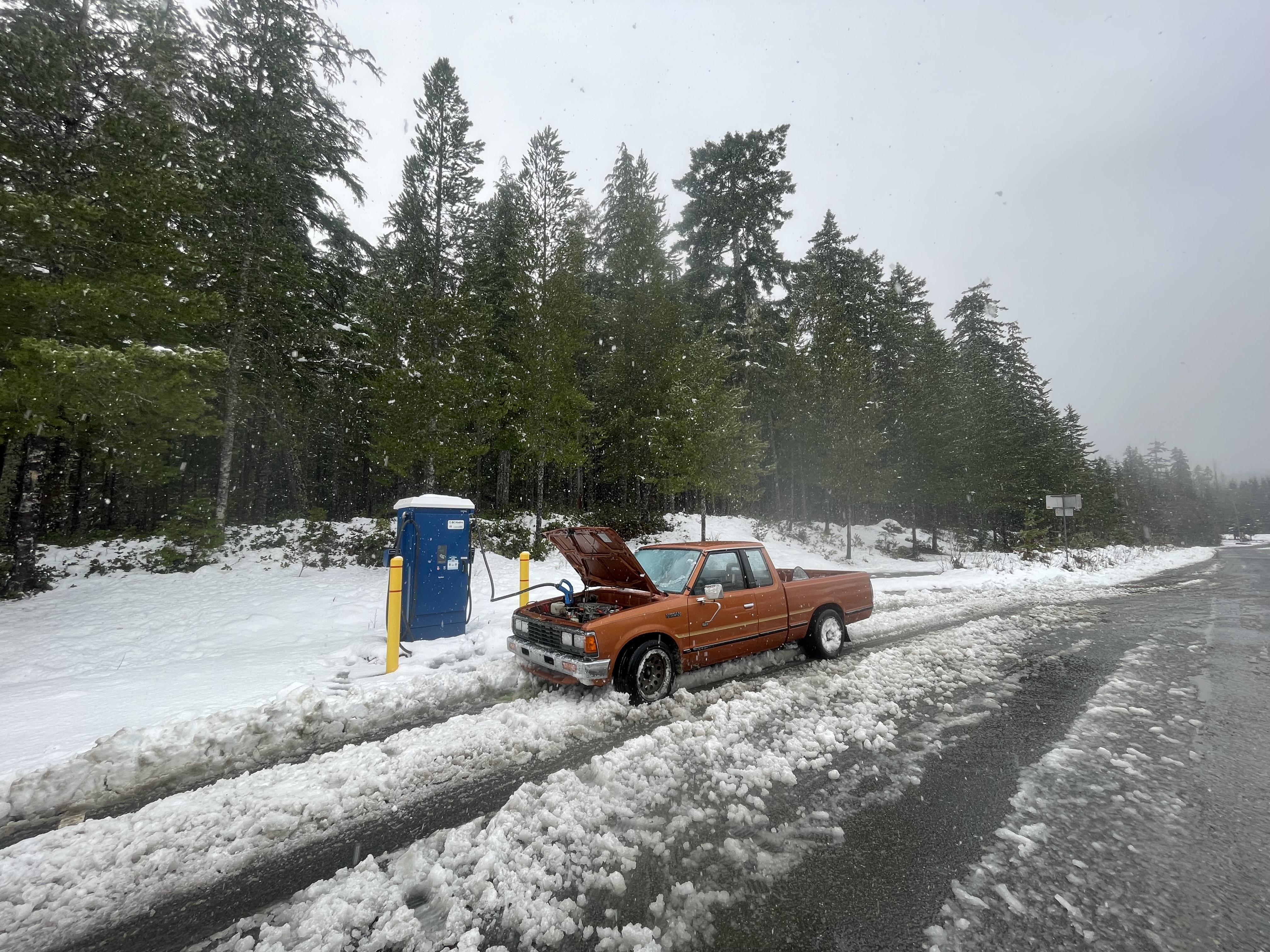

Installed a shunt, which means I installed CHAdeMO, which means ROAD TRIP!
mind the very temporary (slightly sketchy) CHAdeMO and general wiring...
Drove all over Vancouver island, over 800km throughout the week.
BC hydro has really stepped up its fast charging game, with quite a few 400kw capable stations, and now many 180kw. North of Campbell river was only 50kw. Everywhere had at least 1 CHAdeMO plug lucky me.
unfortunately was not able to do any data collection, but the low ir of the ionic modules handled multiple 50kw charge sessions in a day with minimal heat production.
From first glance, with some active cooling these guys should handle much higher power levels!
Which gets me excited about implementing foccci with a nacs port!
Now for issues possible bugs:
2 of the more northern chademo stations had lockout issues during the initial hand shake. after the station did its precharge test, it would drop the 12v supply, which is used to trigger the contactors and gp12 input. this would cause the station to flicker the 12v supply on and off a few times then lock out.
my on the road fix was to monitor the 12v supply during the handshake, and jumper the connection to 12v once initiated. this would stabilize the connection and the station would begin charging. not sure if the station is not following the spec, or if it wants an additional message.
second issue was that the out lander dcdc was not working during dc fast charging. i have the 12v supply for the outlander obc on a relay trigger by HV active on one of the output pins on the zombie. also now dose not work during AC charge mode. works fine in drive.
going to investigate if there's a wiring issue that has cropped up. i have tried with removing the chademo lv harness and removing the chademo settings, but still no dcdc during ac charge.

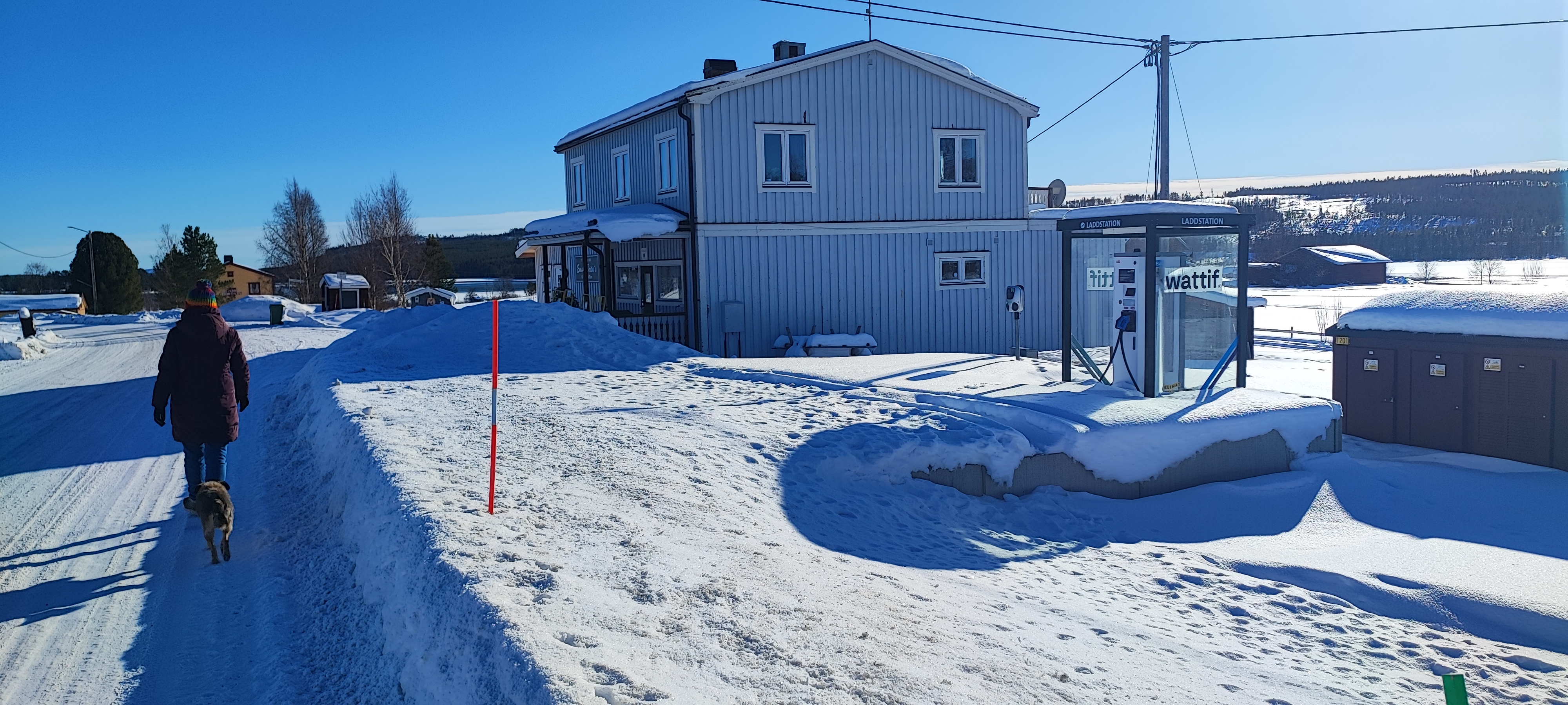

That charger is still better plowed than this one:
The name gives it away: wattif I could charge here?

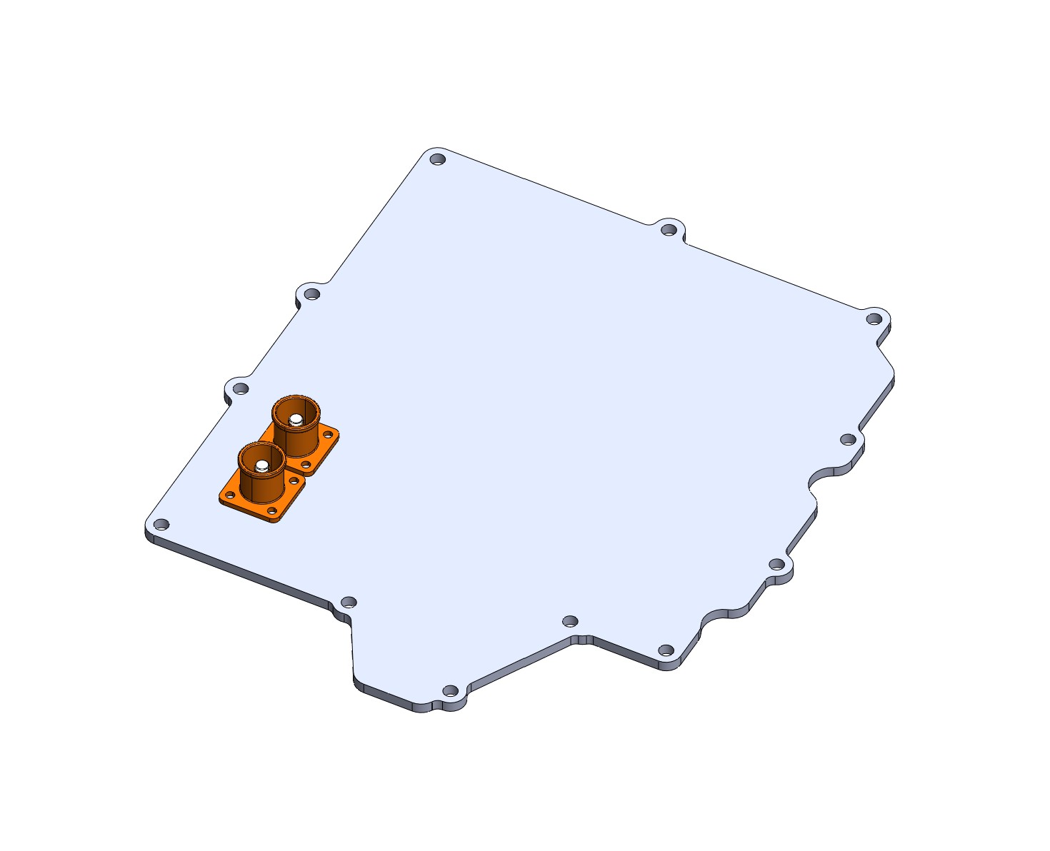

as i just have the truck band aided and work on everything else, i got more work done on a better HV interface for the leaf inverter.
being i have a gen3 inverter, the "cover" isnt a cooling plate, rather just a lid with holes. so first draft modeling up a new one with holes for radlok connectors...or cable glands if your a cheap man :)
dxf attached, use at your own risk i have not done a proper fit test yet, have to wait till next week to confirm :)
leaf-gen3-inverterlid-R00-2026-03-26.DXF
(36.37 KiB) Downloaded 9 times
