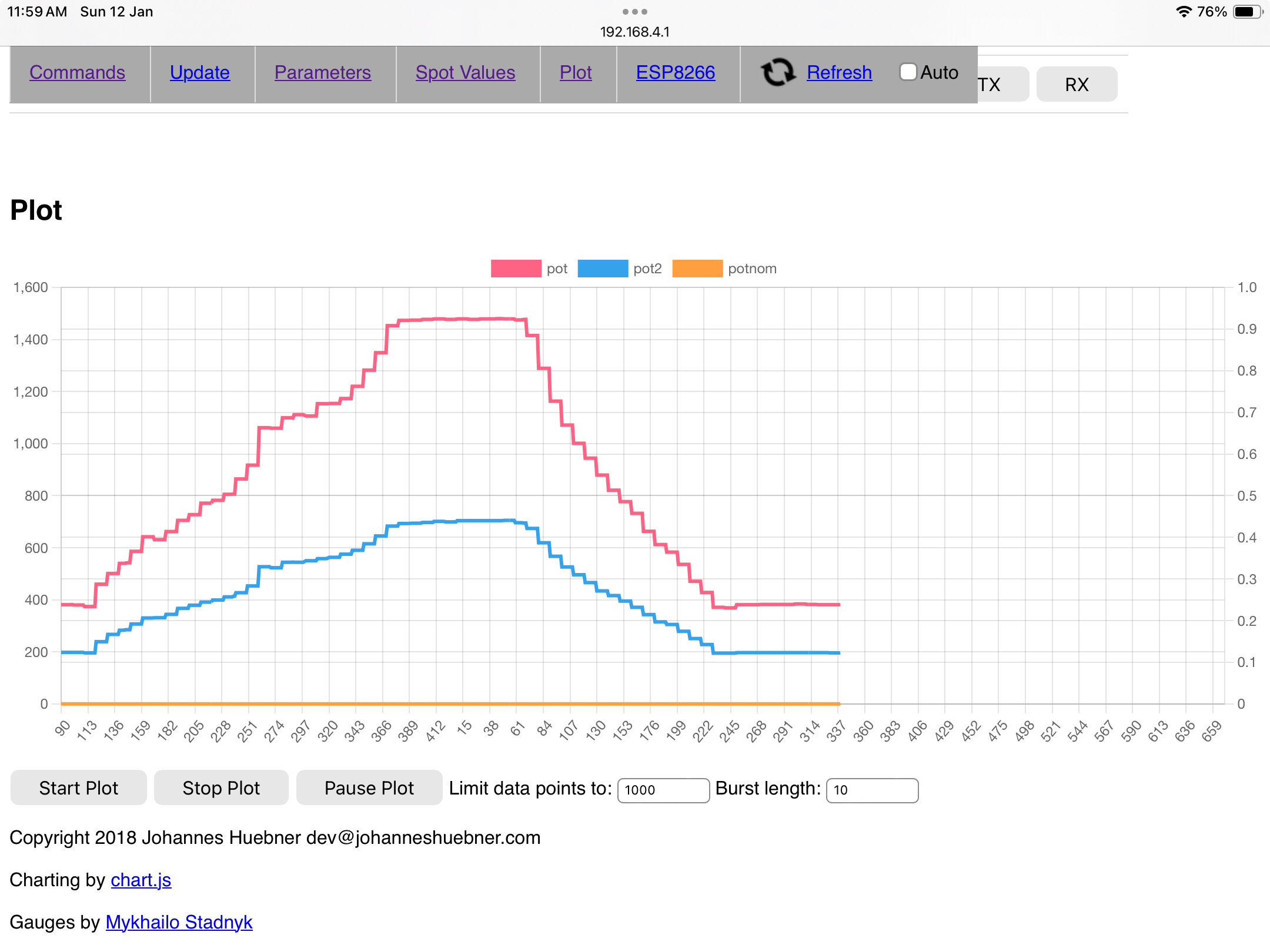

Hi Tom - wasn’t sure how to export the plots you requested, so I just took screenshots. I hope that is sufficient. One of the plots is just me gradually applying the throttle from 0 to 100% with the car turned off. Feedback as expected from both pots, but no feedback at all from potnom. The next plot is with the zombie in Run mode and Forward direction selected, I only applied partial throttle as the car was in neutral. Again, expected feedback from both pots, but almost nothing back on potnom. And the last one is in reverse, with similar results. I hope this is what you are after, and please let me know if there is anything else you need

Hi Tom - I just realised you asked for potnom and speed. I will go and get those plots for you
Iceman96
Posts: 49
Joined: Sun Jan 14, 2024 1:36 am
Has thanked: 65 times
Been thanked: 19 times
Re: Zombieverter & Gen2 Leafstack - RPM surging in Forward direction but stable in Reverse
Post by Iceman96 »
Hi Tom, - this time I got the plots for speed and potnom as requested. First plot in Foward and 2nd in reverse. As you can see, no readings for potnom in either direction. Also, I gradually applied the throttle pretty much the same in both directions, but you can see from the plot,that in the forward direction that the motor gets up to the revlimeter ( 3000 rpm at present) far more aggresively. While in reverse it is a far smoother and gradual build up to speed. I backed off the throttle straight to zero the same in both forward and reverse, and in both instances the rundown to zero rpm is pretty much the same. I have regen set to zero at the moment.

Iceman96 wrote: Thu Jan 23, 2025 1:50 am Potnom still does not show meaningfull values
this is a problem, can you plot potnom, speed and torque

tom91 wrote: Thu Jan 23, 2025 9:12 am this is a problem, can you plot potnom, speed and torque
Will do

For Tom - I did the plots you requested, and I thought I was still getting nothing on the Potnom channel. But I realised that due to the scale required for the RPM plot, that the changes in the Potnom channel probably would not show up. So to check my theory I did a plot of just the Potnom value. And sure enough, it now goes from 0 to 100 and back as I applied and removed the throttle. So maybe I need to start another thread to find out how to make the best use of the Plot feature? I have searched the Forum and the Wiki, but have not found anything helpful yet.
Also Tom - I noted your point that the Leaf inverter firmware has some inherent limits, but this leaf motor had plenty of torque in reverse when it was in the Leaf, so I dont understand why it doesn’t now. From my plots it appears that the Zombie is sending the negative torgue request ok, yet for some reasong the inverter is not applying it to the motor.
For JOhannes - I tried doing the same Plot as you had done, but due to the problems I am having with the Plot scaling I mentioned above, it does not show the change in direction like your plot did. But you can clearly see the negative torque request when the car was in reverse and would not move regardless of the amount of throttle applied.
This plot is taking off from a standing start on flat ground, accelerating to 60kph, slowing for a corner then accelerating to 60 again before backing off.
This plot is of just the Potnom value showing that it does go from zero to 100
This plot is an attempt at recreating JOhannes’s plot. Starting off, accelerating to 60kph, then coming to a stop and selexting Reverse, apply the throttle again but car would not move due to a very slight gradient.
