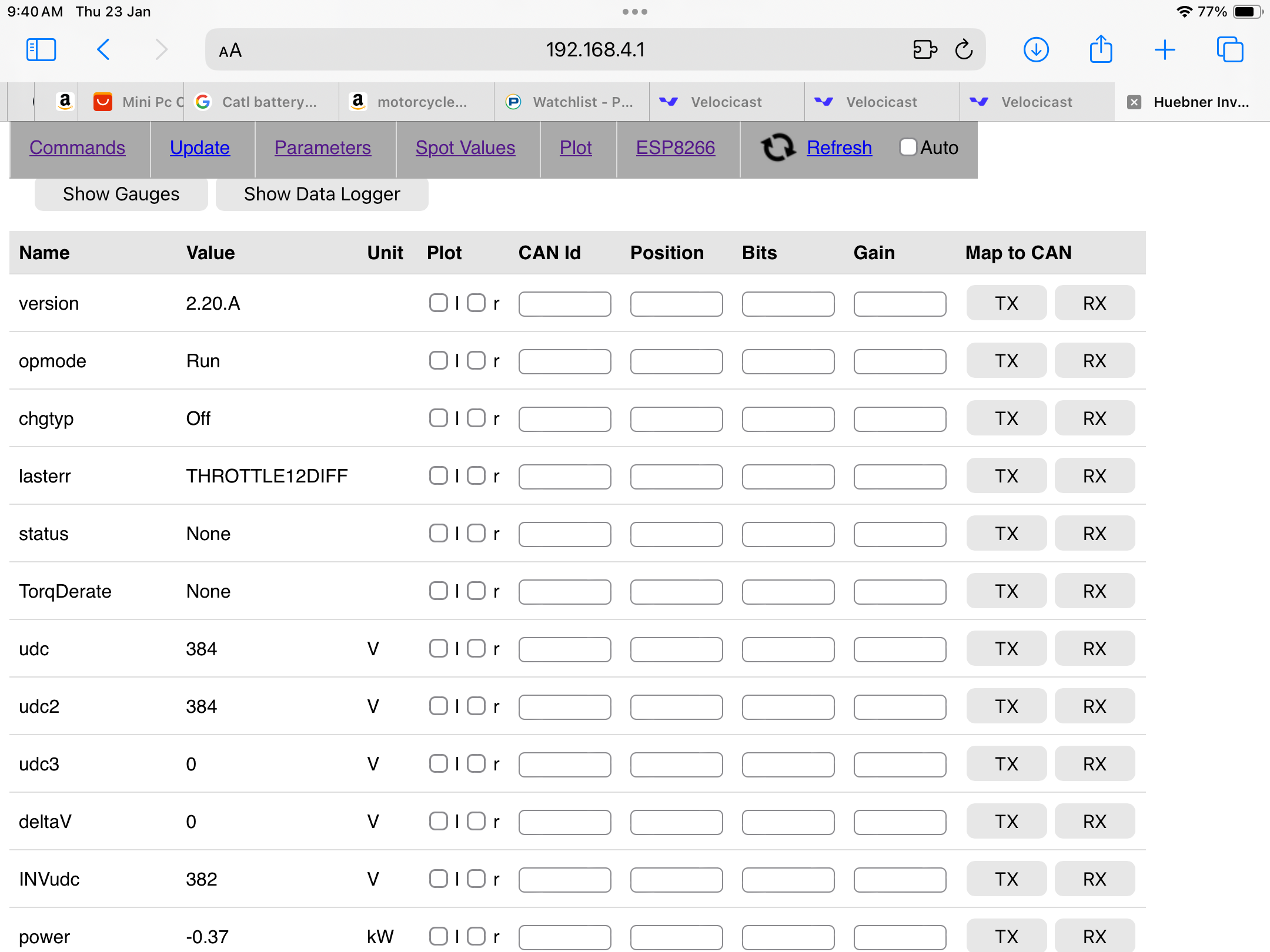

Re: Zombieverter & Gen2 Leafstack - RPM surging in Forward direction but stable in Reverse
Hi Angus - Thanks for your input. Yes the Digital inputs for both Forward and Reverse both turn on as expected when I select either direction. And the “dir” spot value shows Neutral when neither input is selected, Drive when The Foward input is turned on, and Reverse when the Reverse input is selected. So everything seems to be ok there.
However The “ Invstat” spot value behaves oddly I believe. It shows up as “on” as soon as I log into the zombie ( IE when 12 volts is connected to the Zombie, and to pins 46 & 48 on the inverter, and pin 18 on the PDM). It remains as on when I turn on the ignition and the zombie digital input T15 turns on, then it goes to “off” as soon as I give the Zomie its “start” input.
Is that normal behaviour? as from my reading of the wiki it does not seem right?

OK - if I changed my throttle to single channel would that eliminate it as a cause of the judder at takeoff?
i will give it a try and report back
Will do
I had increased it to 50 from the default value of 30 that Damien uses, but it made no difference. But I will increase it to 100 and see if that does
Set it to single channel and it will eliminate the error being called, which can be source of your juddder.
Note the Nissan leaf motor is limited in the the stock inverter firmware.

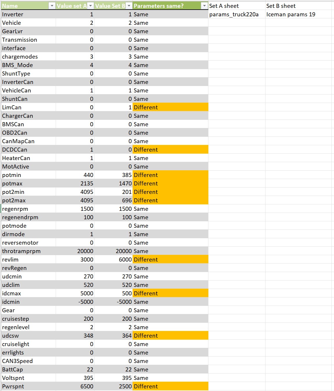

Looked at parameters for the L200 Damien has shared on Github
He's using a single channel pot throttle setup. I'll try this also to see if it makes a difference on my setup.
Hi Johannes - I like what you have done with your excel comparison workbook. I have also made a comparison workbook, but i set mine up so it shows me what the parameter value is, rather than highlighting any differences. But after seeing yours I am going to copy your idea and add it to my workbook.J0hannes wrote: ↑Sun Jan 26, 2025 11:18 am Looked at parameters for the L200 Damien has shared on Github
And yes, I have had a good look at Damiens parameters for all of his cars, but with particular interest in the L200. I had noticed that he was using single channel for the throttle. I changed mine, and while it stopped me getting the “throttle12diff” errors, it made no difference at all to my lack of torque in reverse. I even rewatched his video on the first drive of the L200 last night to see if he drove his in reverse. He definitely does, but I cant tell for certain if he is actually reversing the motor direction, or if he is using reverse gear in the gearbox. I suspect that he is a actually using the gearbox, so it is possible that he has not tried running his motor under load in reverse yet.
I also finaly managed to get the gvret sketch loaded on to my Arduno Due yesterday, but as you no doubt read in my earlier post, I also managed to weld the contacts closed on my Positive & Negative contactors ( I suspect I may have done this when unplugging the charging cable while it was under load). So while I can now get some CAN logs from the zombie, there is probably not much point until I can get some when it is trying to move the car in reverse.
I will be interested to hear how you get on with yours- Good Luck!

Yeah, I didn't look at Damien's params too closely earlier. I've been working on mechanical stuff on my build recently, so haven't put much focus in this yet.Iceman96 wrote: ↑Sun Jan 26, 2025 10:33 pm I also managed to weld the contacts closed on my Positive & Negative contactors ( I suspect I may have done this when unplugging the charging cable while it was under load). So while I can now get some CAN logs from the zombie, there is probably not much point until I can get some when it is trying to move the car in reverse.
Since you are cracking open the battery anyways to replace the contactors, you could in the meantime see if you can get them moving by tapping them to continue testing and diagnosing your setup. If you get them moving, I'd still replace them once you get new contactors.
I'm sure we'll get these running properly eventually

I then connected up my arduino Due and started savvycan logging on my CAN1 bus, which has the zombie, pdm, inverter, and bms all on it. I continued logging for a bit as it was, and then turned the ignition on. I saw no appreciable difference on savvycan ( IE no new channels appered in the list of what was being logged). I then gave the zombie a “Start” signal. I-heard the contactors close, the zombie went into run mode, and udc1, udc2, and Invudc were all indicating approx 384volts, the DC-DC converter powered up as my aux volts wentup to 14.8v and everything seemed okother than my “InvStat” was now showing as off. I checked Savvycan and there was now extra channels being monitored.
I left it like that for a few more seconds, before turning off the ignition. It sounded like the contactors dropped out, but i was not sure. The zombie went into “Off” mode ok, “InvStat” went back to on mode, i think the dc-dc turned off as i am fairly sure the aux volts dropped back to approx 13volts. After a short wait i stopped the savvycan logging and the file is below:
Something strange that I noticed was that it appears that the value I had saved for udcsw of 360volts had been ovverwritten by the actions of starting up the inverter, as it was now showing a value of 364volts. (Not sure if it is a coincidence or not, but that was a value I had been using previouslyfor udcswI ). I tried doing a refresh, but the value remainned at 364 volts. So I did another parameter download which is attached below where you can see the value has changed:
I then cycled power to the zombie and checked the parameters again, and udcsw was back to 360volts again???
I then tried powering up the inverter again to see if it did the same thing (it did), but on powerdown the contactors sounded funny again, so after isolating eveything again and checking, i found the contactors stuck closed again. So even though I did not run the main traction motor at all, the power draw of the dc-dc converter was enough to reweld the contacts, so I wont take any more risks with these contactors, and will have to wait until my kilovacs arrive and are installed before I can get any savvycan logs of the “no torque in reverse” issue. But hopefully the one log that I did manage to get may give some insight into why my “InvStat” is behaving the way that it does???
So now with 12VDC going to the zombieverter, and to the correct inputs on the PDM, Inverter, and the Battery pack, but no “Ignition on” signal, or “Start” signal going to the Zombie, I logged in to the zombie to see what state it was showing. Everything looked ok to me except for the fact that the “InvStat” feedback was showing as on. But no volts were showing on udc, and the DC-DC converter was still off. I then did a download of the parameters which is below:
Does nothing with the Leaf inverter. As indicated by the spot value description on wiki. https://openinverter.org/wiki/Zombiever ... pot_Values
