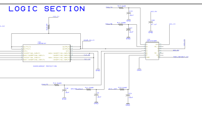

Here is some more info. I am using an open inverter board to control the SDU. Attached is a .json file with the parameters I am using.The wifi connection shows battery voltage and 12V supply. All the inputs are getting into the board as determined by the "spot check" function as is the throttle position input. The drive never goes into run mode. It pre-charges OK. I have tried forward and reverse inputs. Further investigation reveals that the "fault A" signal which comes from the main Tesla board is off. ( And off means there is a fault from what I can see ), This in turn means that the inhibit output on the OC board is on so not surprising that the motor will not run.
Getting into the Tesla board looks a little daunting so would need some one with experience at that level.
I am in Melbourne Australia. If anybody has experience , let me know
Been thanked: 1918 times
Re: Assistance with Tesla SDU
Can you check which pin of IC5 stays low?
The parameters look pretty much alright for an SDU.
philipj
Posts: 18
Joined: Mon Sep 28, 2020 9:01 am
Post by philipj »
Pin 1 ie Fault A stays low

I have done the tests as outlined in the link you sent and looks like there are no IGBT faults. On the OC board I found that the fault A signal is not actually zero but is just no connection. I can drive it up to 12V or down to zero. Same with fault B. Fault C is definitely being driven to zero ( 0.6V actually ). I tried bypassing all the fault inputs so that the inhibit PWM signal is off, and tried to run again. But nothing happening.
Now I have removed the OC board and removed the plastic cover on the main circuit board ( and the gel ). There are 36 IGBT's ( 6 for each phase ). I found the connections and all of them test OK. Now I am trying to work out the circuit as a step to fault find. If you have access to the circuit diagram or know of anyone who does please let me know. Seems like there is some logic between the signals from the OC board and the IGBT's
Re: Tesla SDU board
This sounds not so good. The power electronics seem ok but the gate drive board seems toast. Also note that fault signals are 5V. Not sure where you applied 12V? If to the SDU logic board you may have blown the and-gate IC5

johu wrote: Wed Mar 05, 2025 7:52 pm This sounds not so good. The power electronics seem ok but the gate drive board seems toast. Also note that fault signals are 5V. Not sure where you applied 12V? If to the SDU logic board you may have blown the and-gate IC5
My mistake , it was 5V not 12V. IC5 is working OK. Will check more on the drive board
