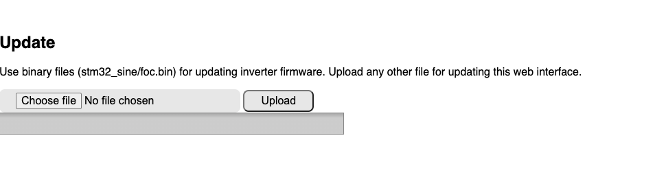

Sometimes it does work and I can access the interface. Then I can usuallly download parameters OK but nothing else. Trying to get spot values gives a blank screen, and I usually find this action has caused the wifi to disconnect. The wifi also disconnects randomly. I have tried to down load both the STM32_sine.bin and STM32_foc.bin files but nothing happens. The web interface suggests it should be an STM32_sine/foc.bin file which I cannot find. Maybe the next step should be a new olimex module, what do you think?

Do not download the stm32_foc.bin ! Only stm32_sine.bin is intended for Tesla boards

OK ... but I am puzzled as to why the wifi interface says to downloadd stm32_sine/foc.bin

You do realize that this is just meant to express the two alternatives?
You can either flash stm32_sine.bin OR stm32_foc.bin . NOT stm32_sine/foc.bin
As said, you need to flash stm32_sine.bin.
Re: Tesla SDU board
Now I realize that. The / was confusing to me. Dementia catching up. Now have downloaded stm32_sine.bin and board working

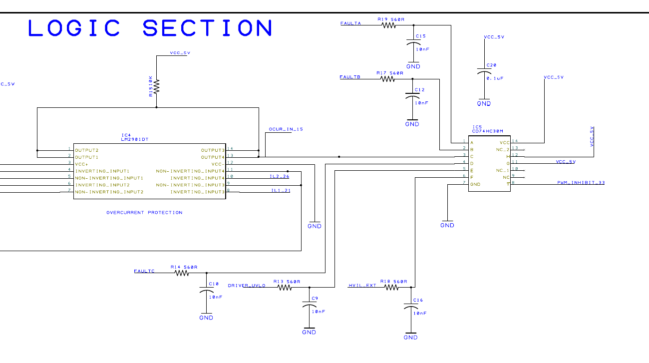

Here is some more info. I am using an open inverter board to control the SDU. Attached is a .json file with the parameters I am using.The wifi connection shows battery voltage and 12V supply. All the inputs are getting into the board as determined by the "spot check" function as is the throttle position input. The drive never goes into run mode. It pre-charges OK. I have tried forward and reverse inputs. Further investigation reveals that the "fault A" signal which comes from the main Tesla board is off. ( And off means there is a fault from what I can see ), This in turn means that the inhibit output on the OC board is on so not surprising that the motor will not run.

Can you check which pin of IC5 stays low?

I am in Australia. Have narrowed the problem down to “fault A” on the Tesla main board. Do you know what that means ?

Alright, it is no easiest to check if there's an actual problem with the power stage or just a bad logic connection. Look at the second section here and report back: https://openinverter.org/wiki/Electronics_Basics

I have done the tests as outlined in the link you sent and looks like there are no IGBT faults. On the OC board I found that the fault A signal is not actually zero but is just no connection. I can drive it up to 12V or down to zero. Same with fault B. Fault C is definitely being driven to zero ( 0.6V actually ). I tried bypassing all the fault inputs so that the inhibit PWM signal is off, and tried to run again. But nothing happening.
Now I have removed the OC board and removed the plastic cover on the main circuit board ( and the gel ). There are 36 IGBT's ( 6 for each phase ). I found the connections and all of them test OK. Now I am trying to work out the circuit as a step to fault find. If you have access to the circuit diagram or know of anyone who does please let me know. Seems like there is some logic between the signals from the OC board and the IGBT's

This sounds not so good. The power electronics seem ok but the gate drive board seems toast. Also note that fault signals are 5V. Not sure where you applied 12V? If to the SDU logic board you may have blown the and-gate IC5
Re: Tesla SDU board
My mistake , it was 5V not 12V. IC5 is working OK. Will check more on the drive board
