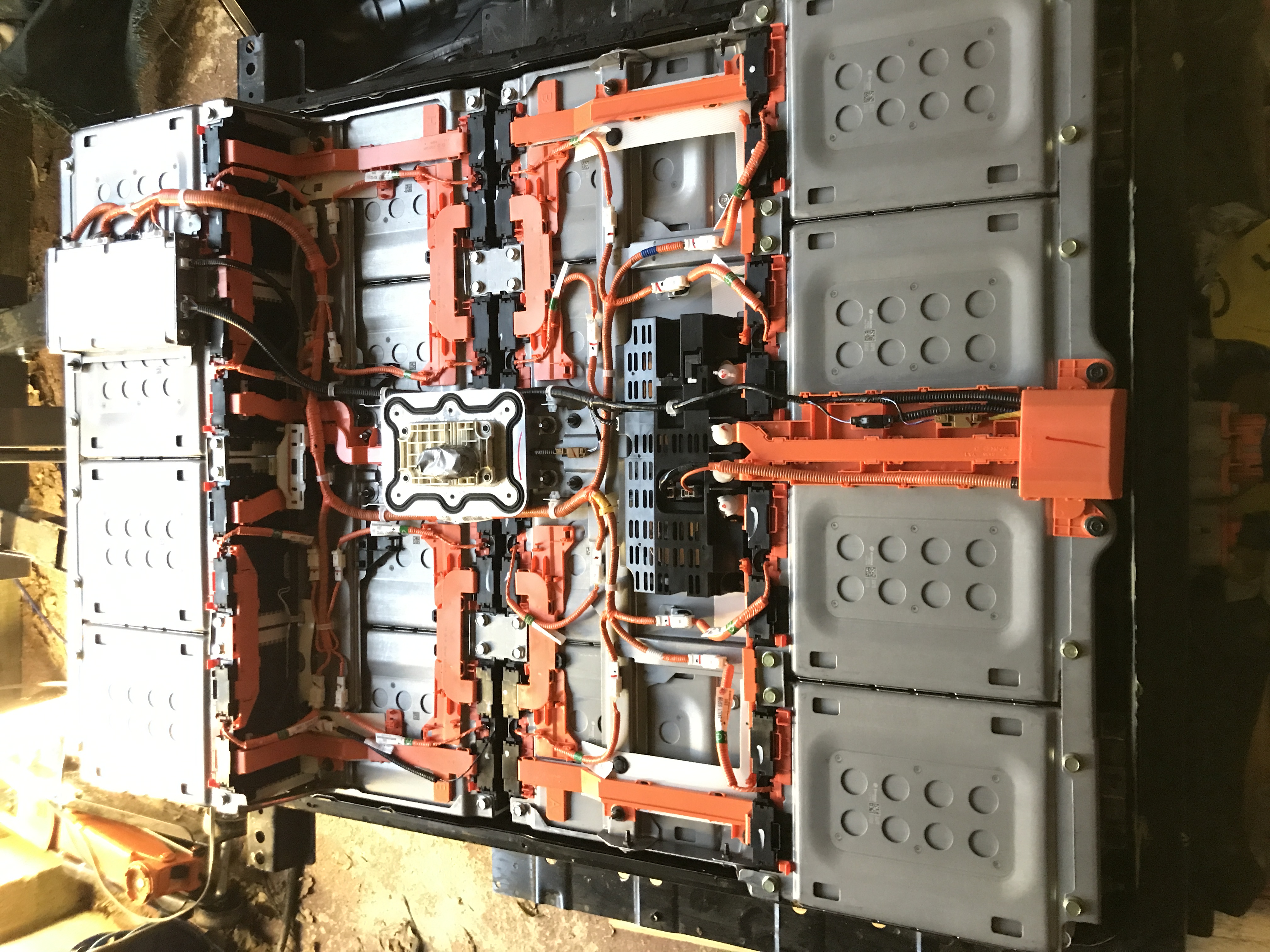

I have a UK 60kWh Leaf battery I’m taking apart for my project. Some details have been hard to be sure of so I will collate my own details here as I take it apart, plus add the other useful links I’ve come across. If there’s any questions I can answer while I work on it let me know.

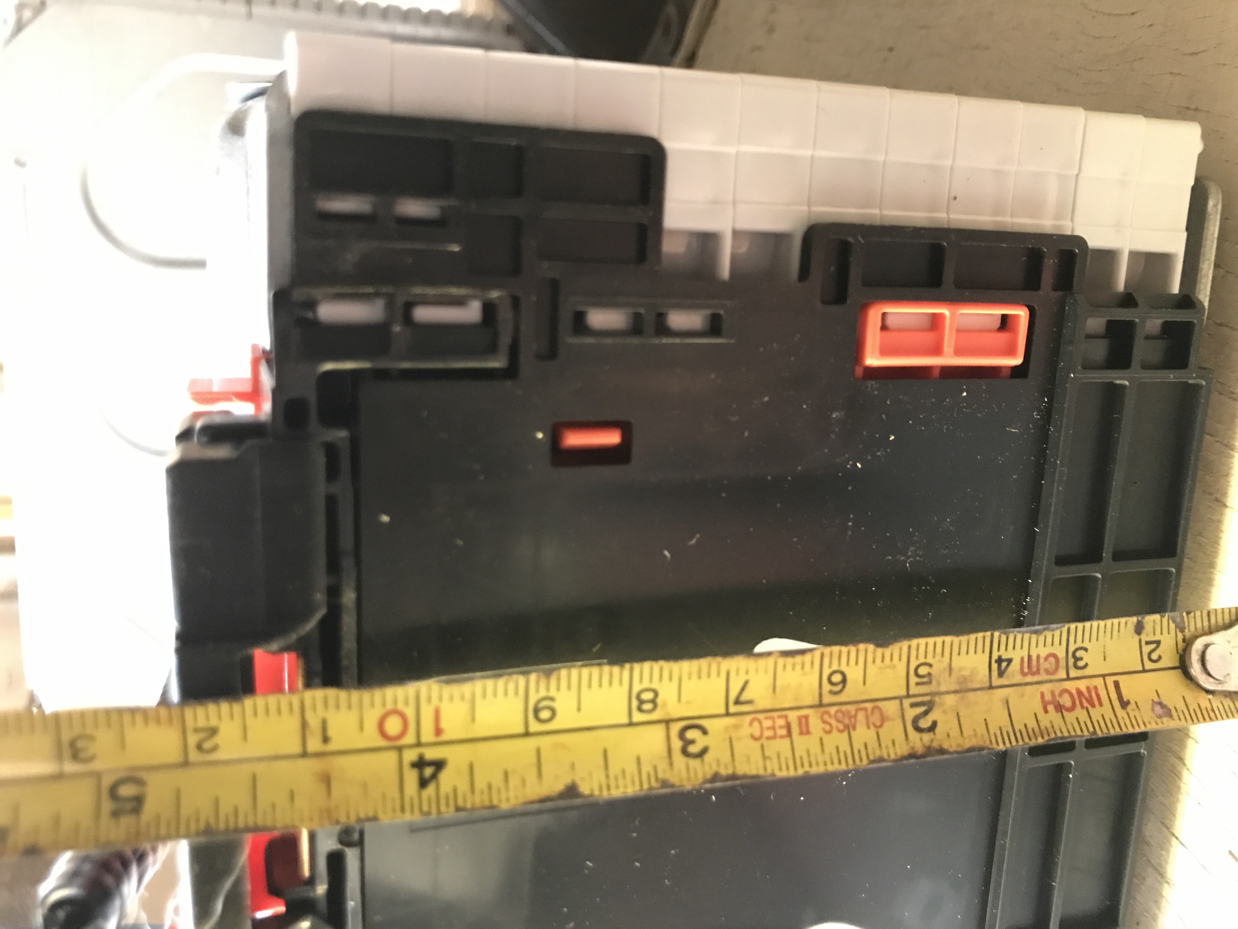

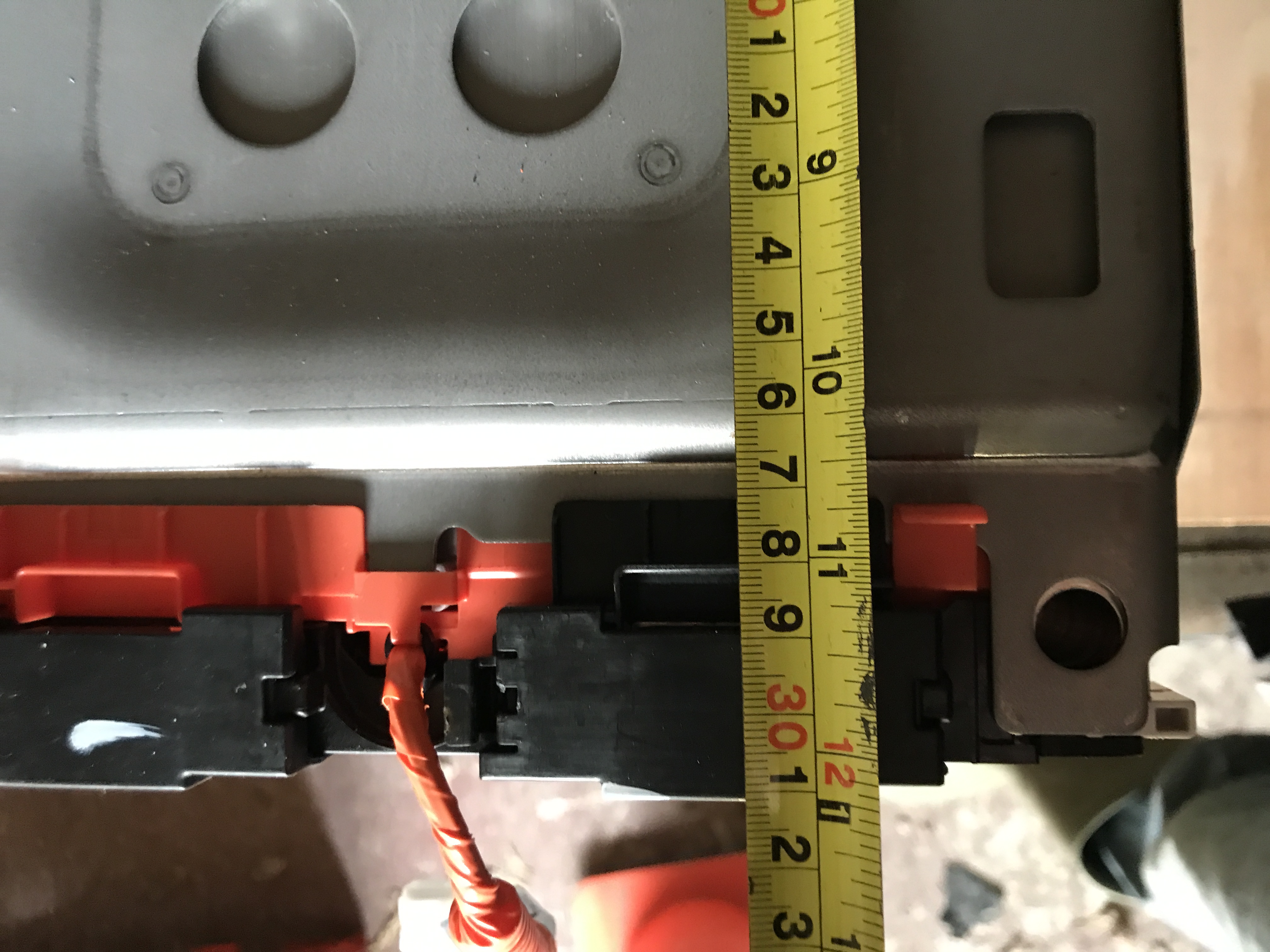

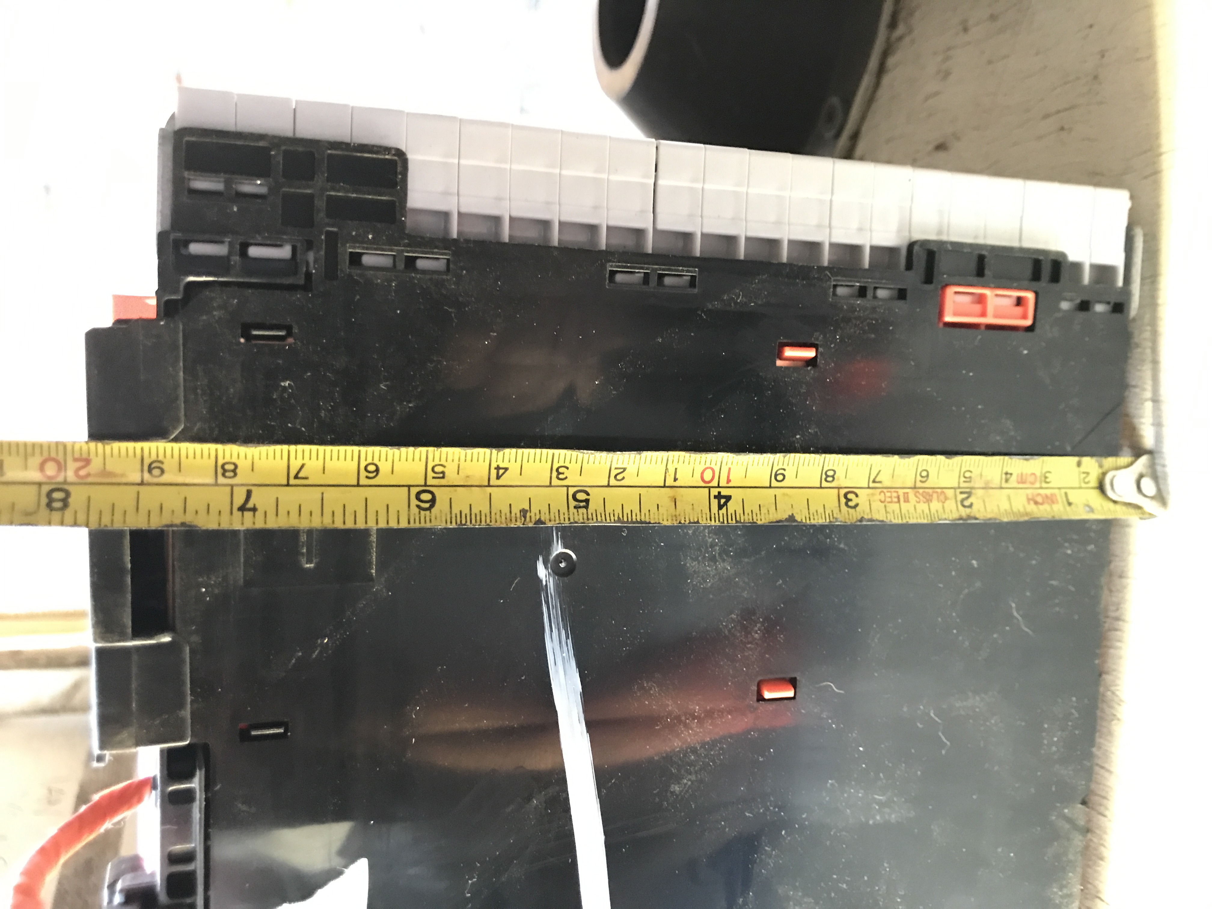

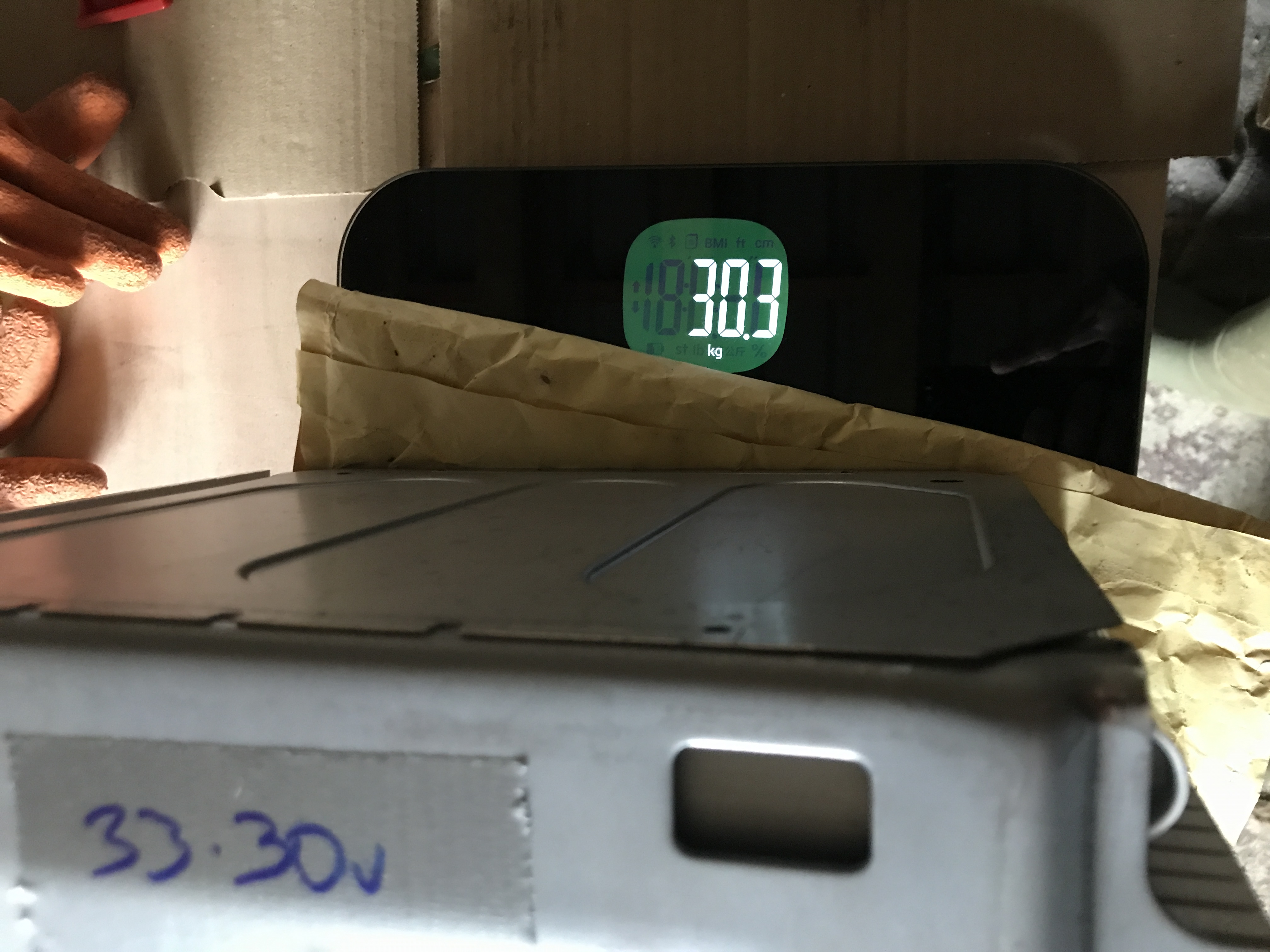

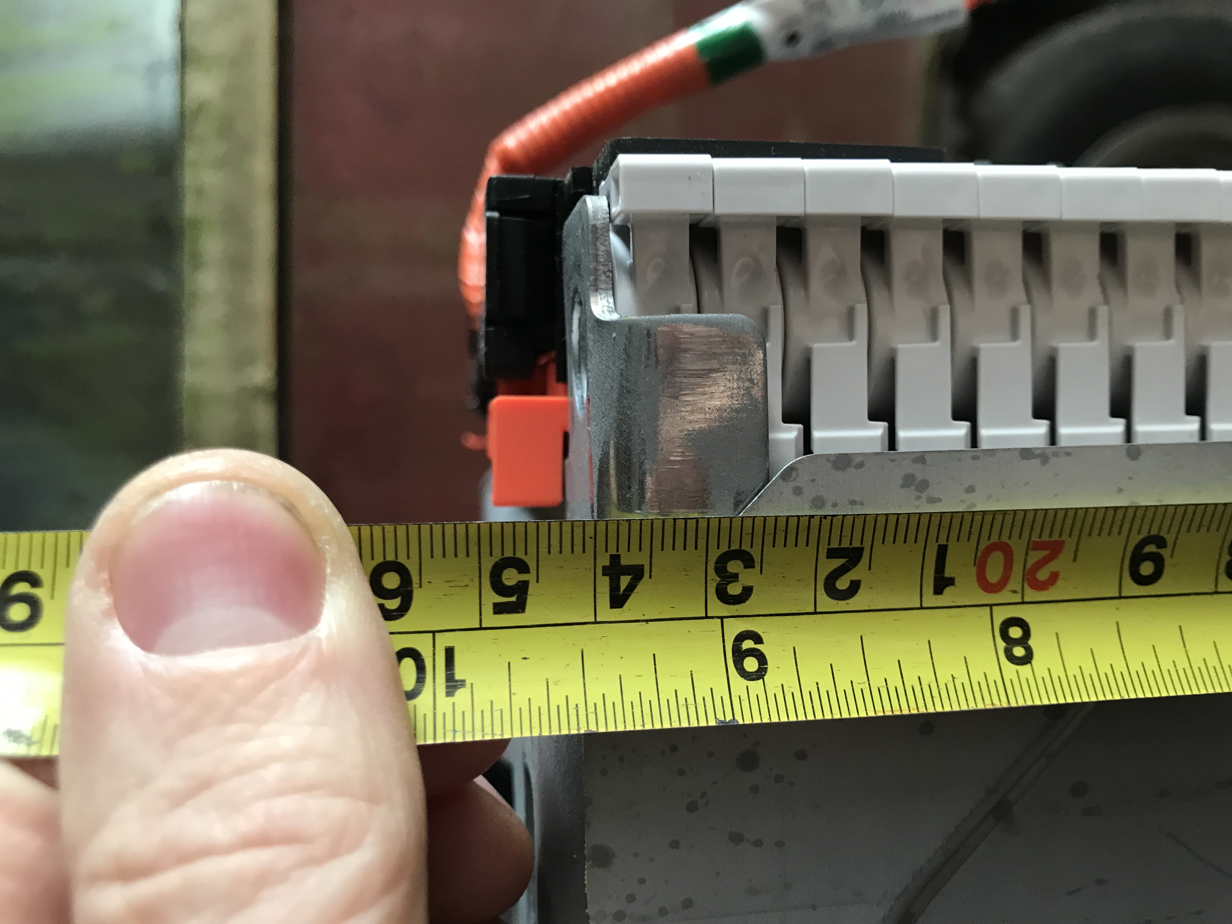

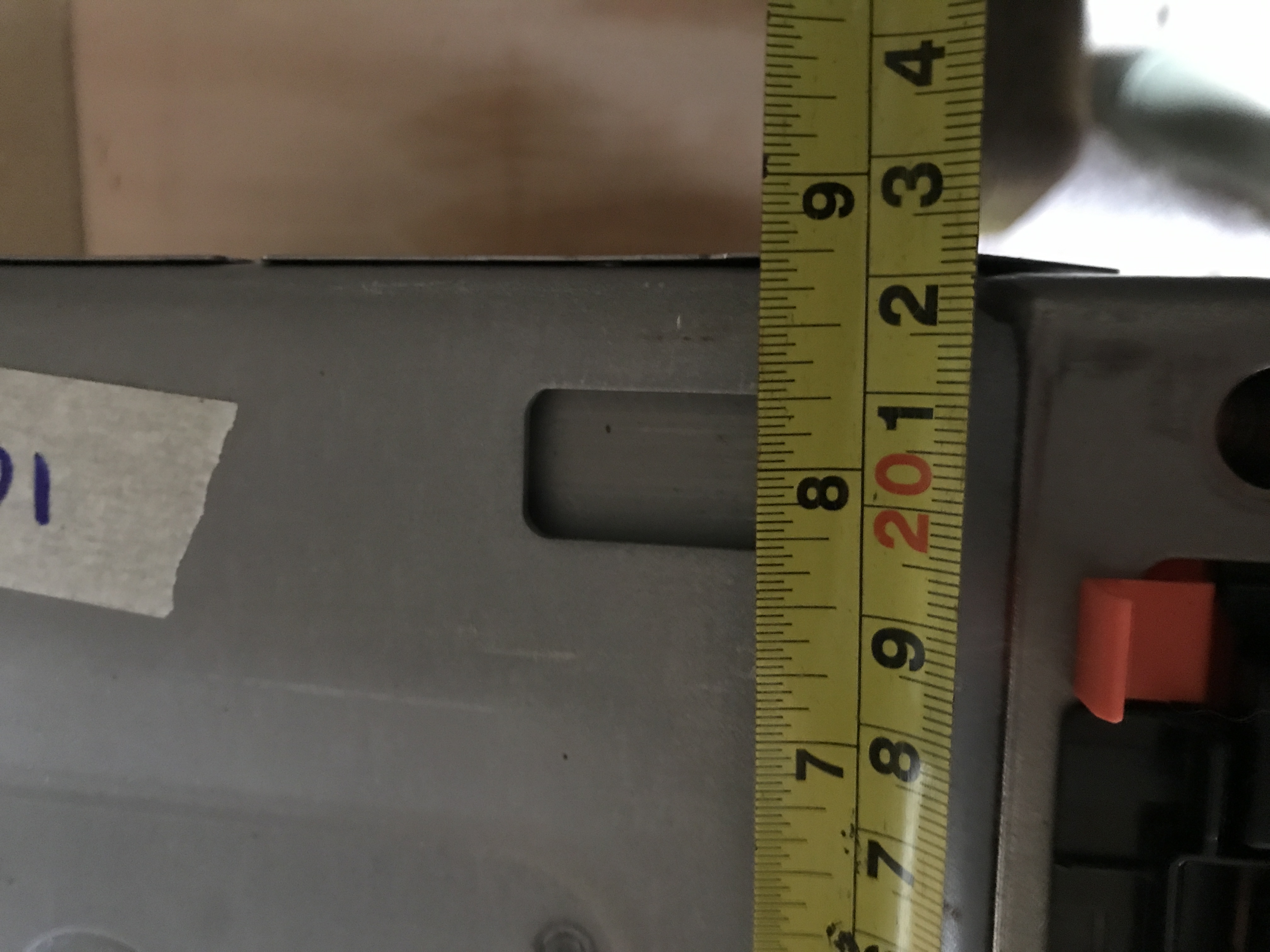

Photos showing real world dimensions and weight of one of the tall modules, 7, 8, 9, 10.
Height
Length
Width
And weight
I’ll do the other module sizes soon.

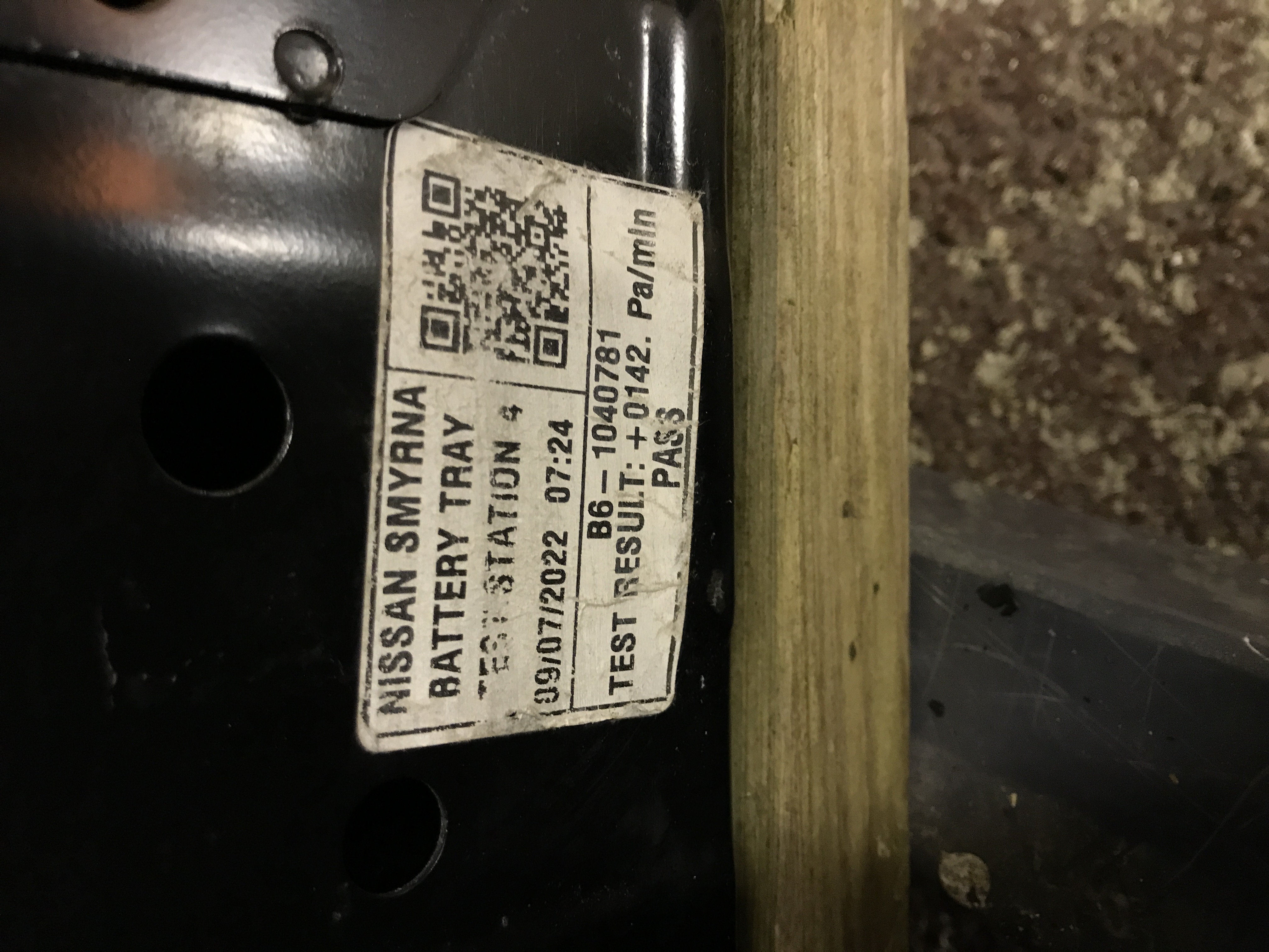

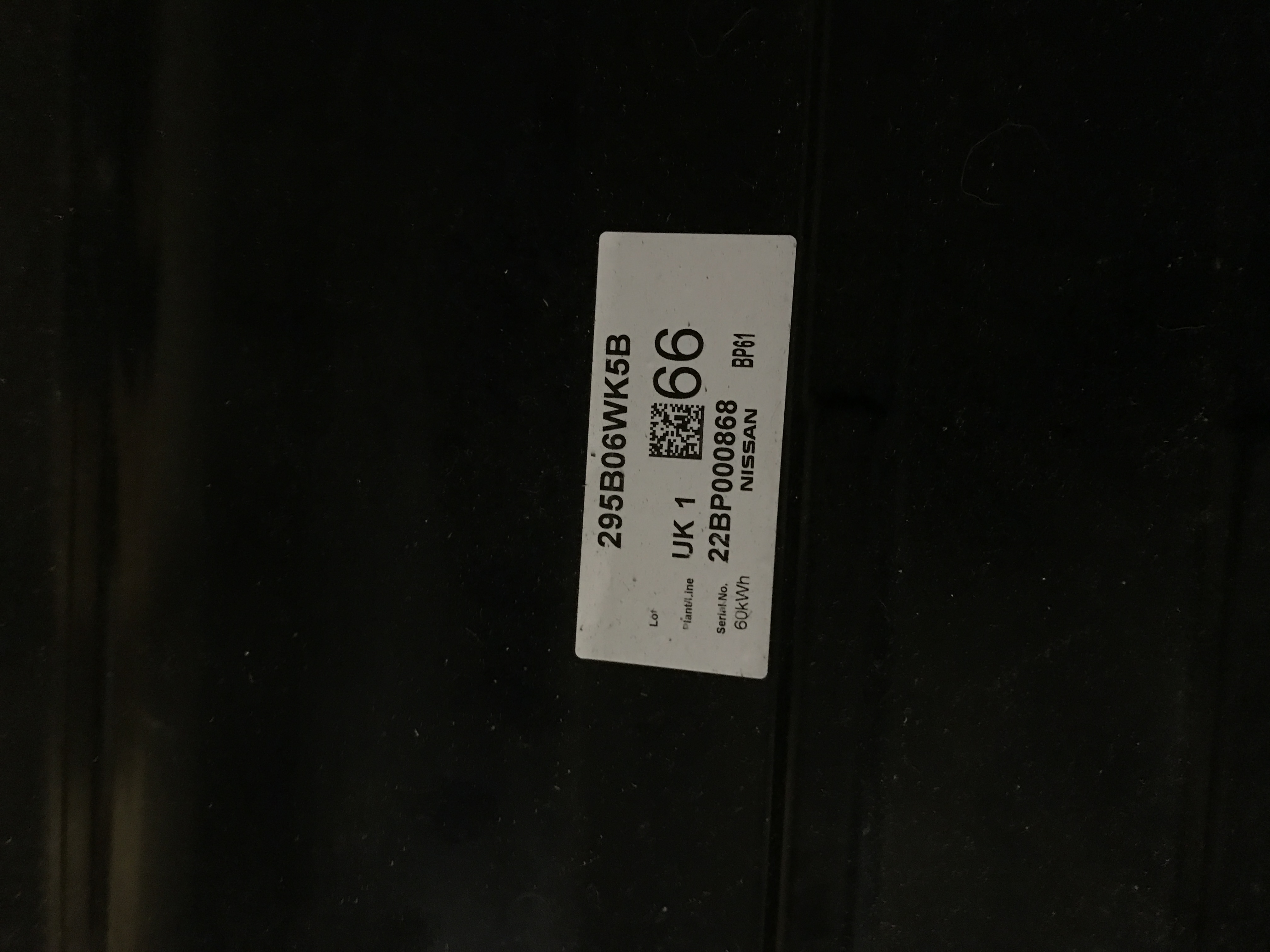

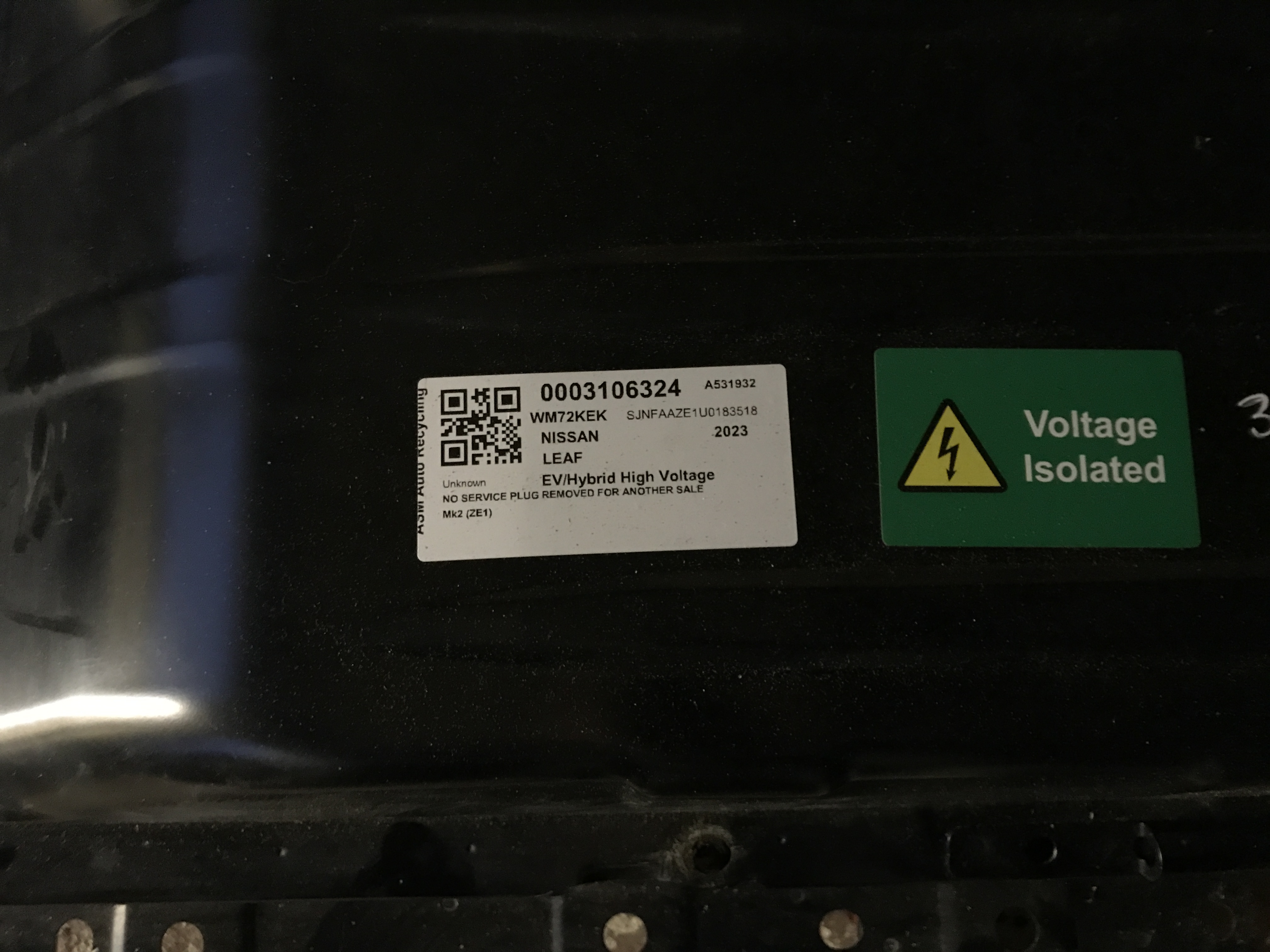

For reference, this is how Nissan labelled the pack on the outside

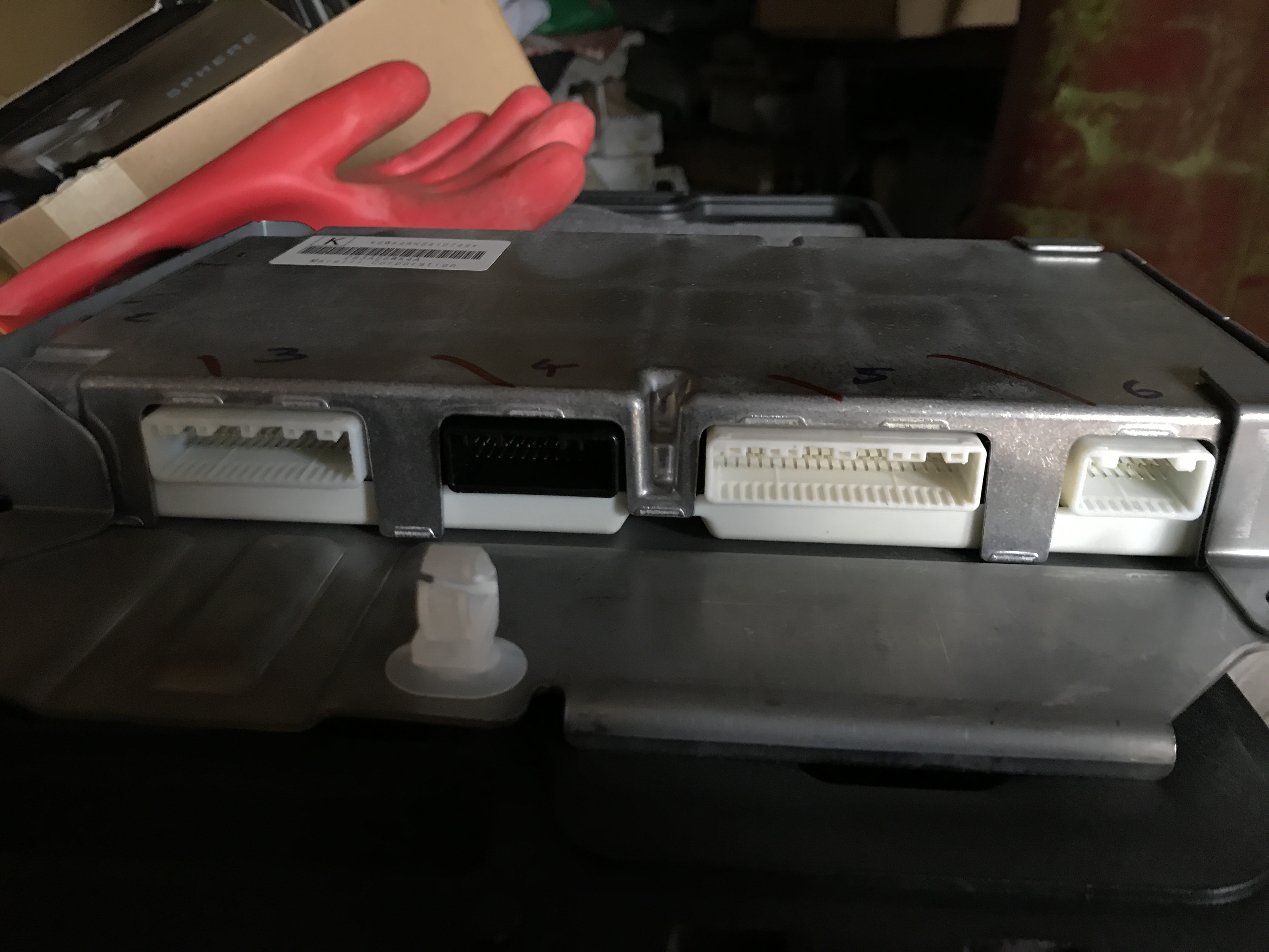

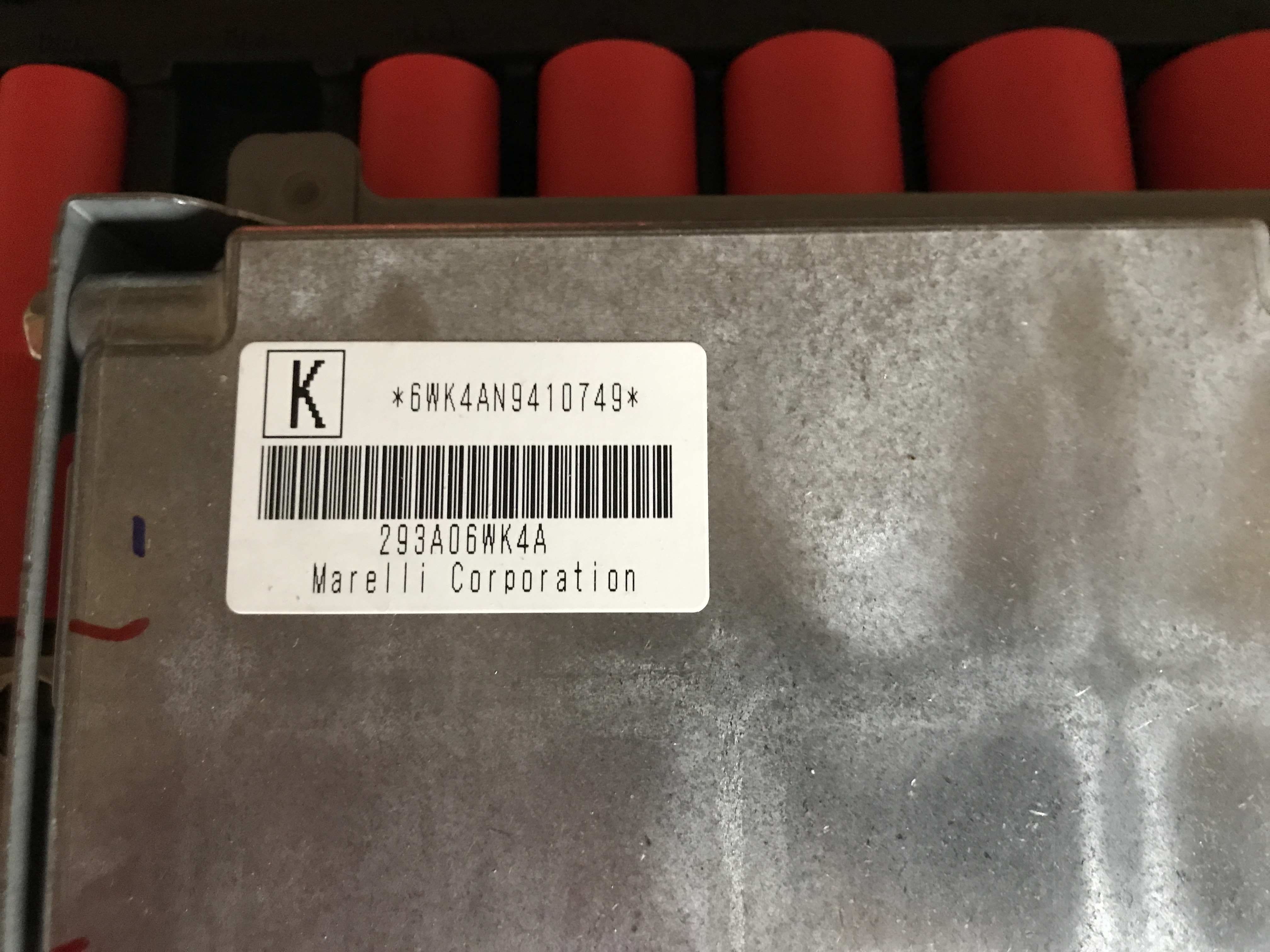

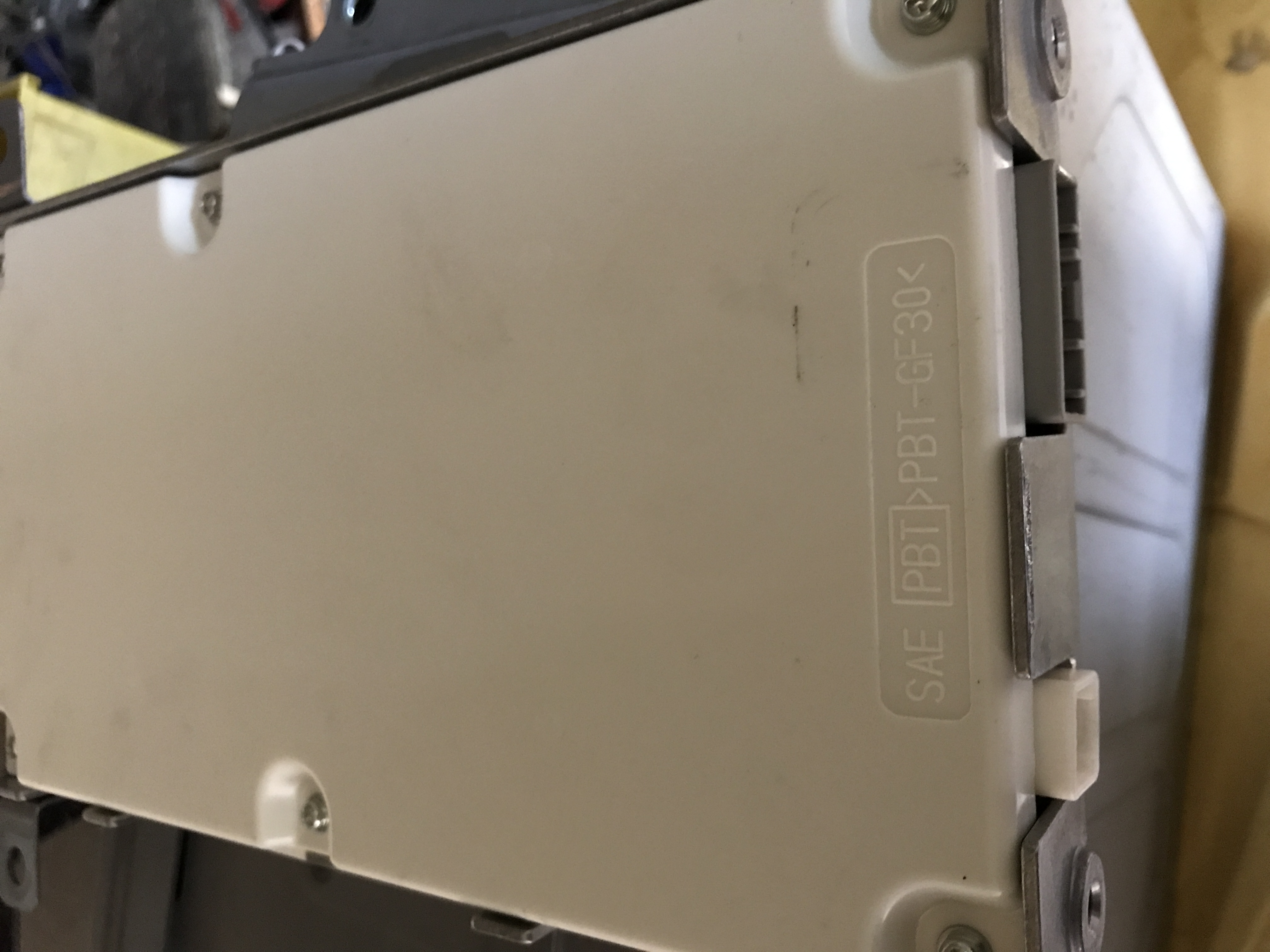

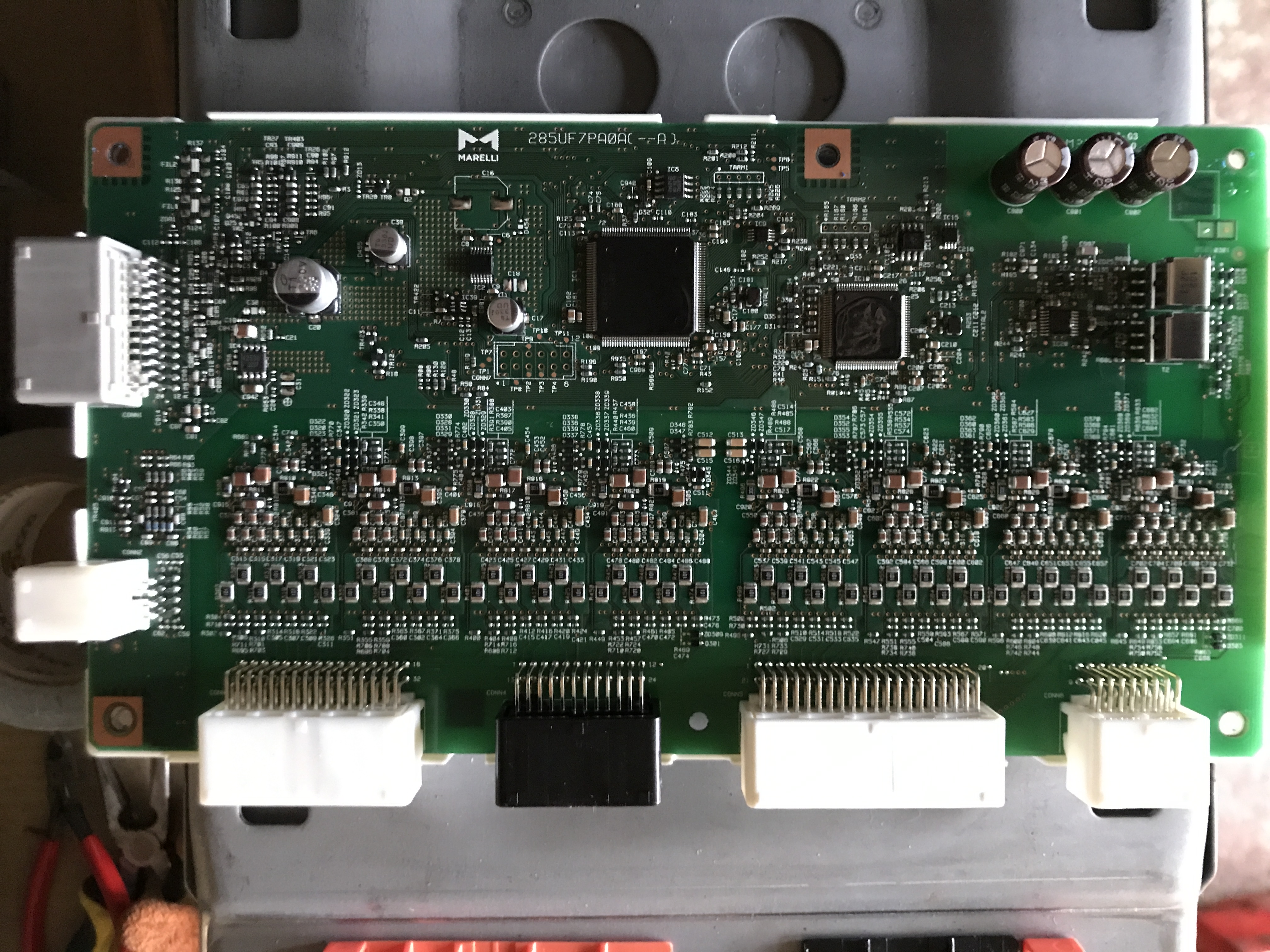

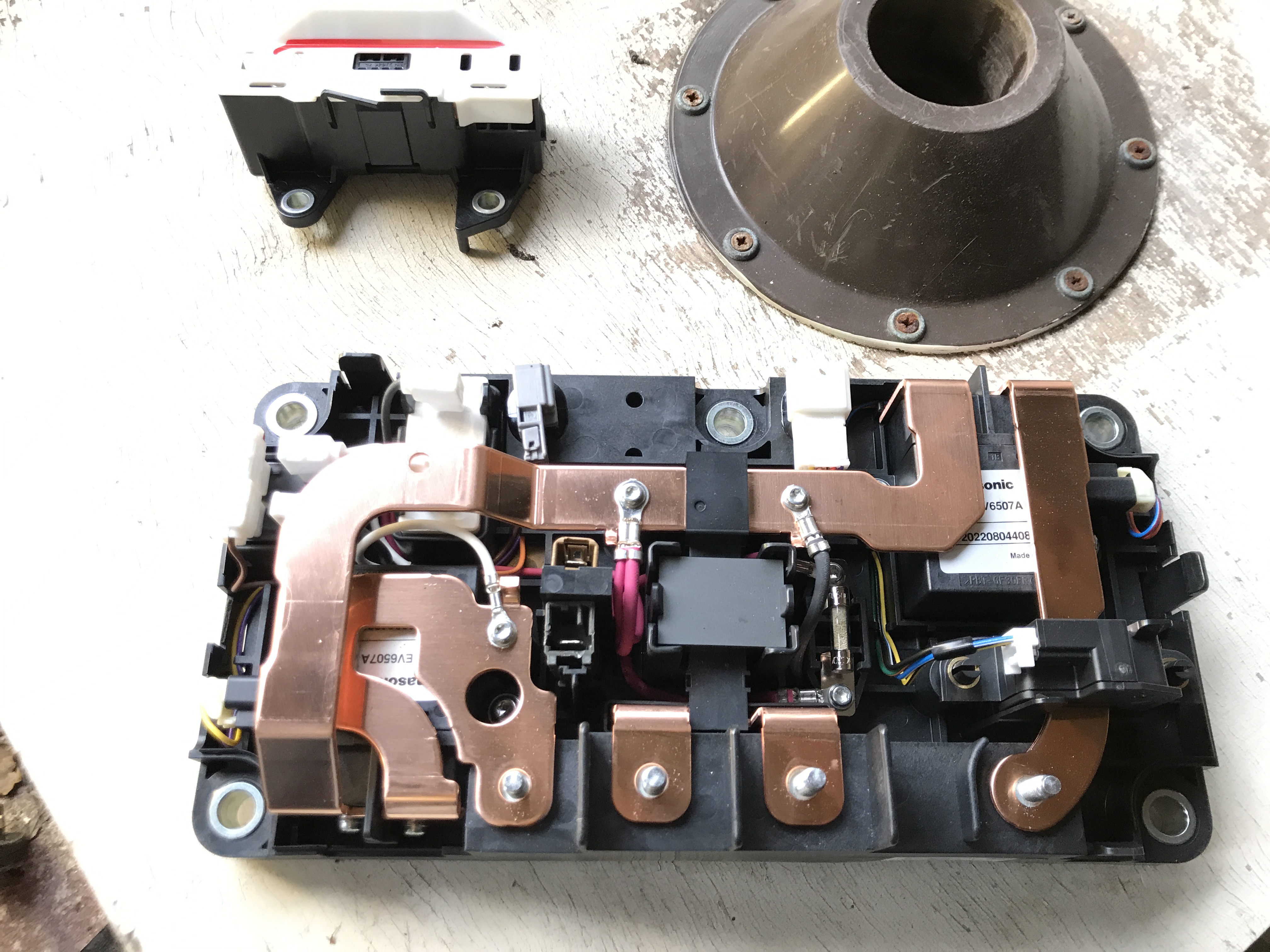

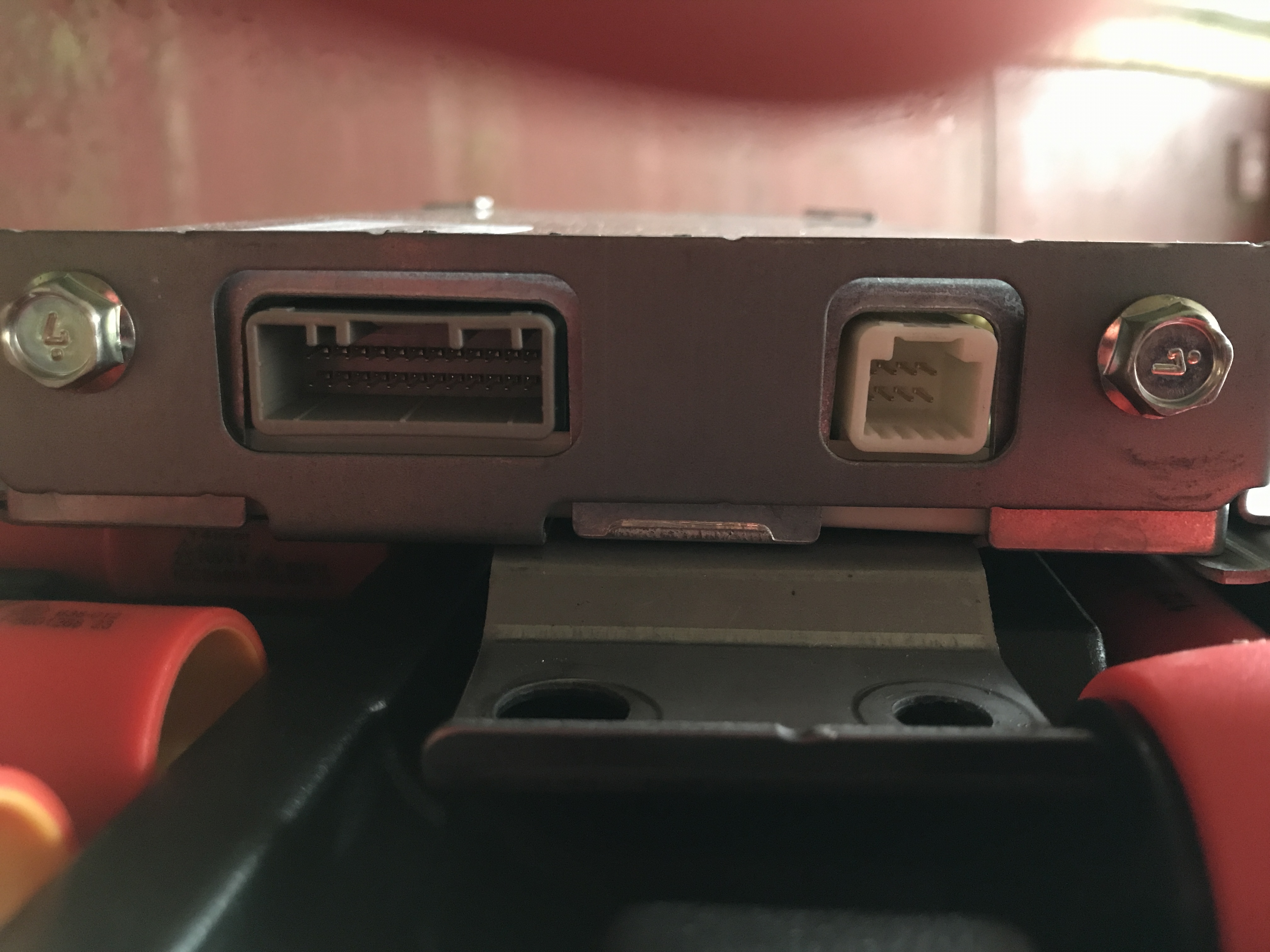

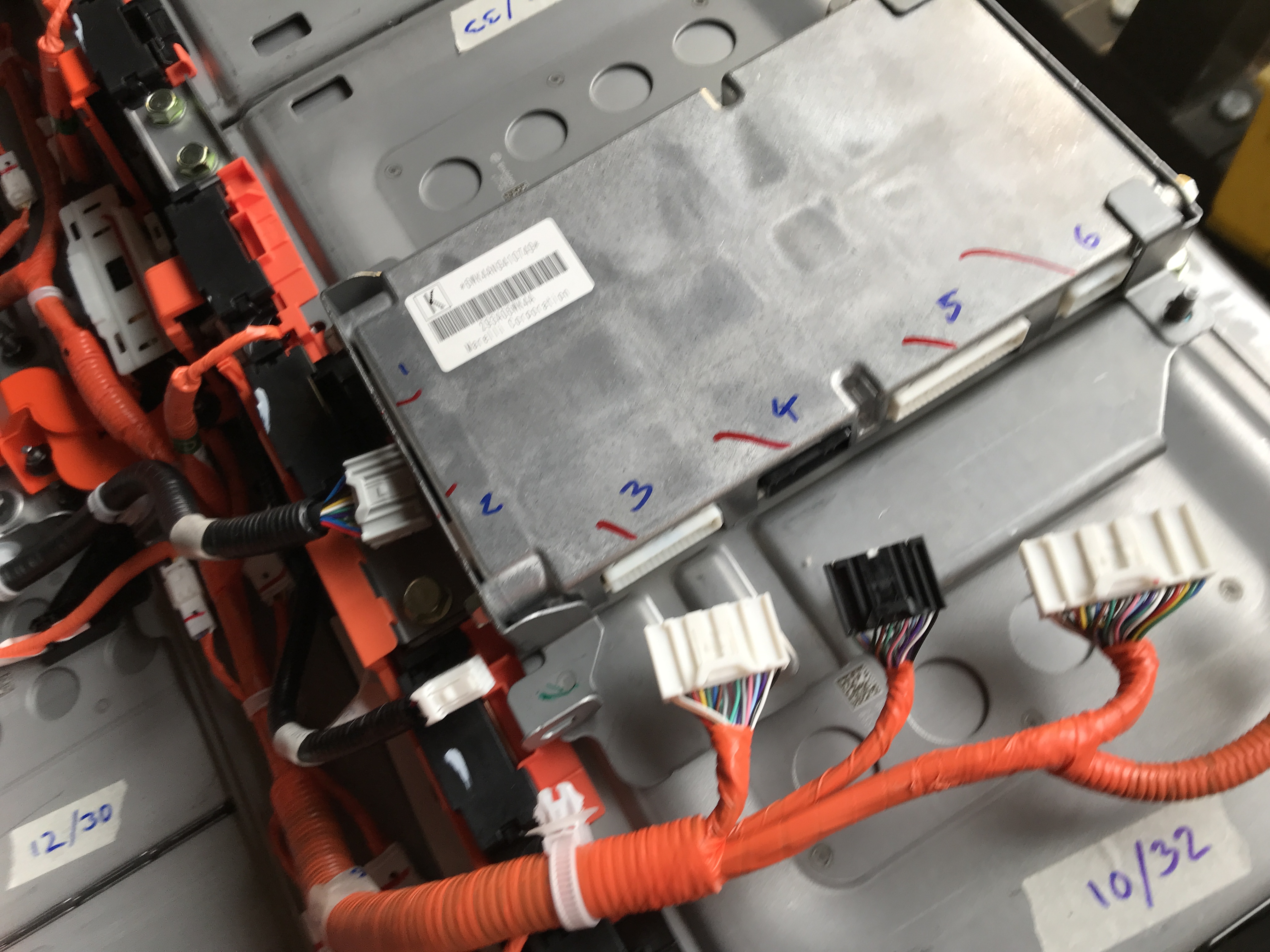

And now the BMS.

Height of tall module was shown above. 250mm. Weight 30.3kg
Height of medium module - 198mm. Weight 24kg
Height of short module - 121mm. Weight 14.8kg
So total module weight (not incl busbars, contactors, case, etc) is
4 x 30.3 =121.2
4 x 24 =96
8 x 14.8 =118.4
= 335.6 kg.

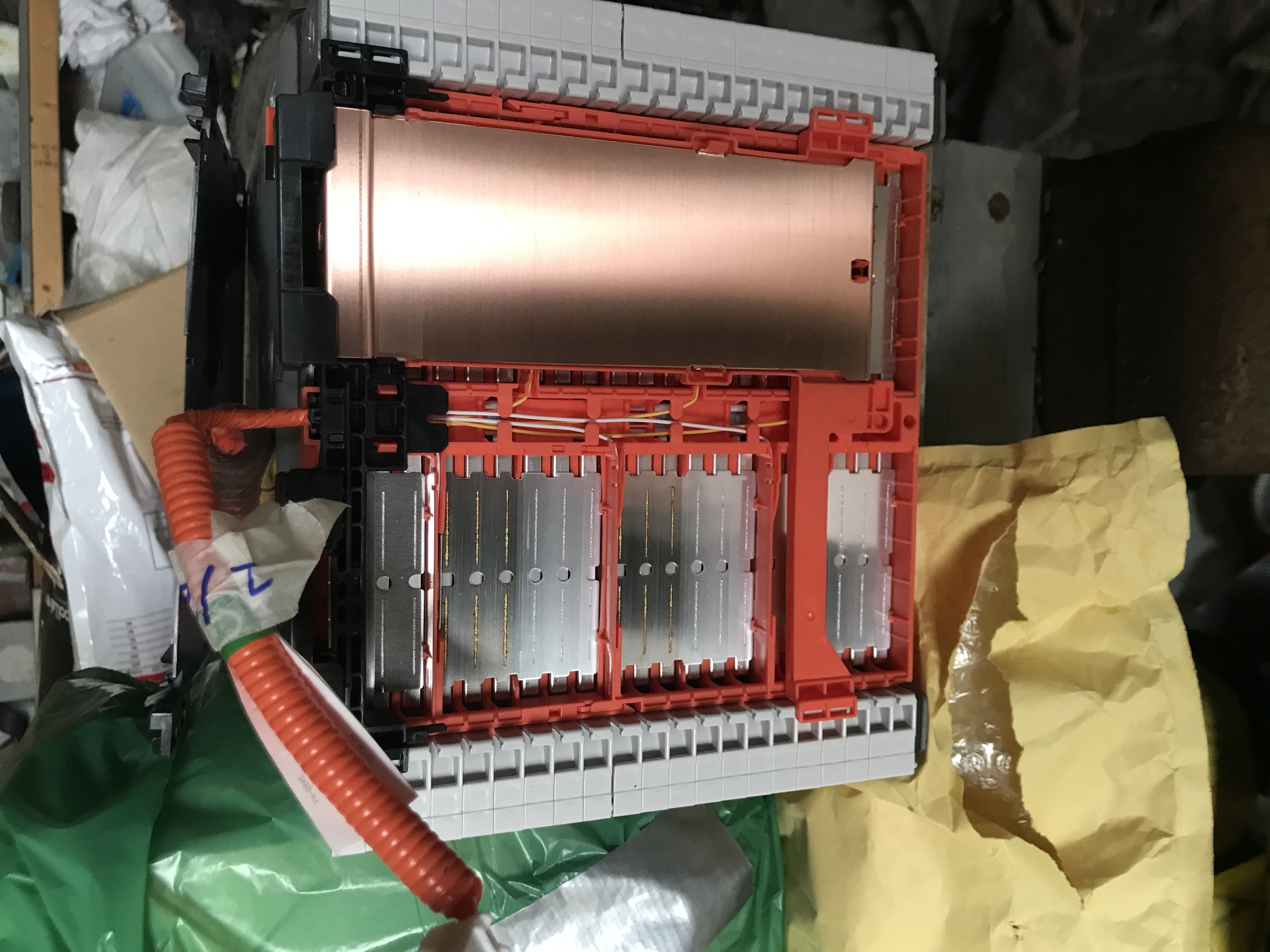

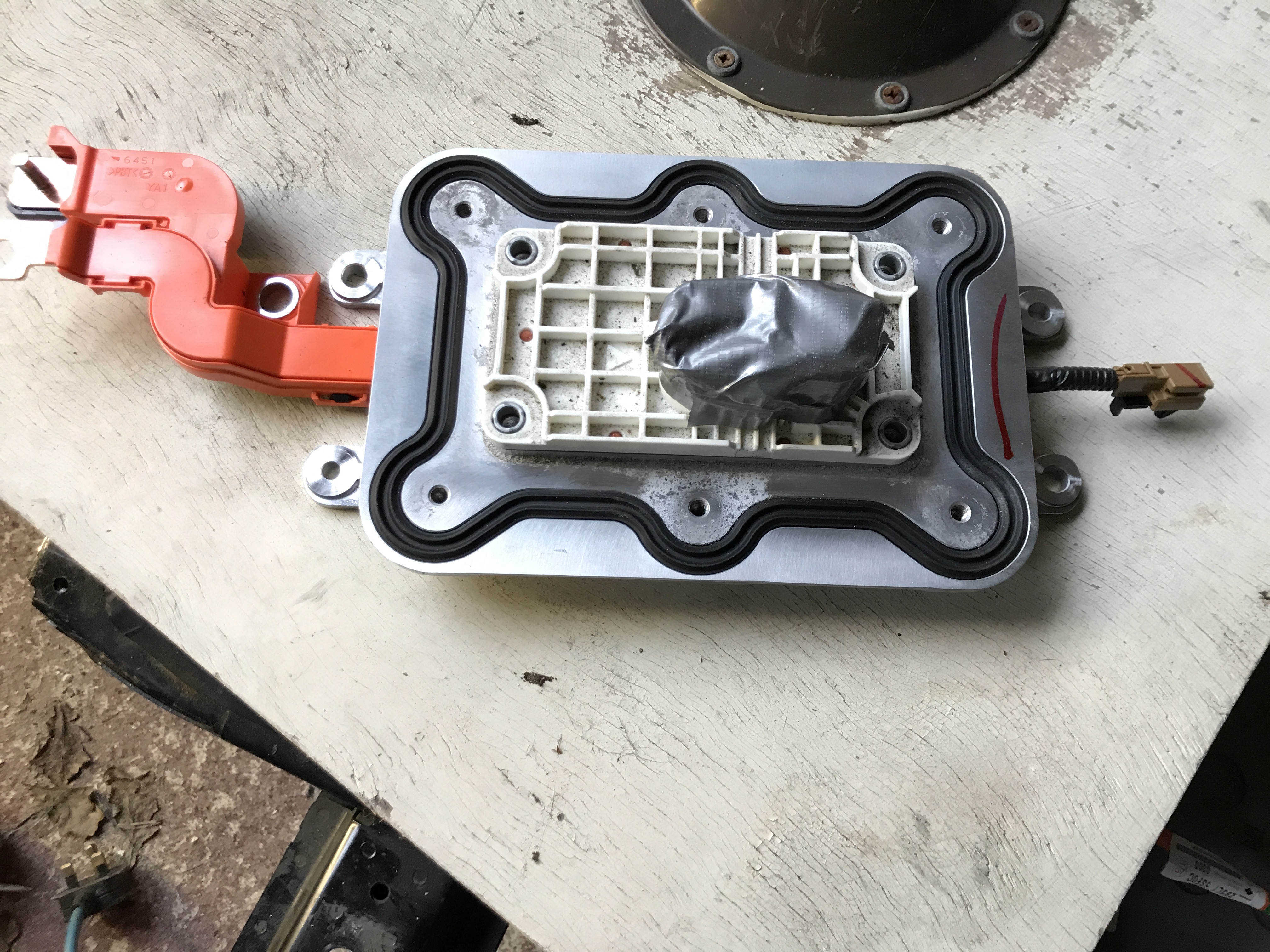

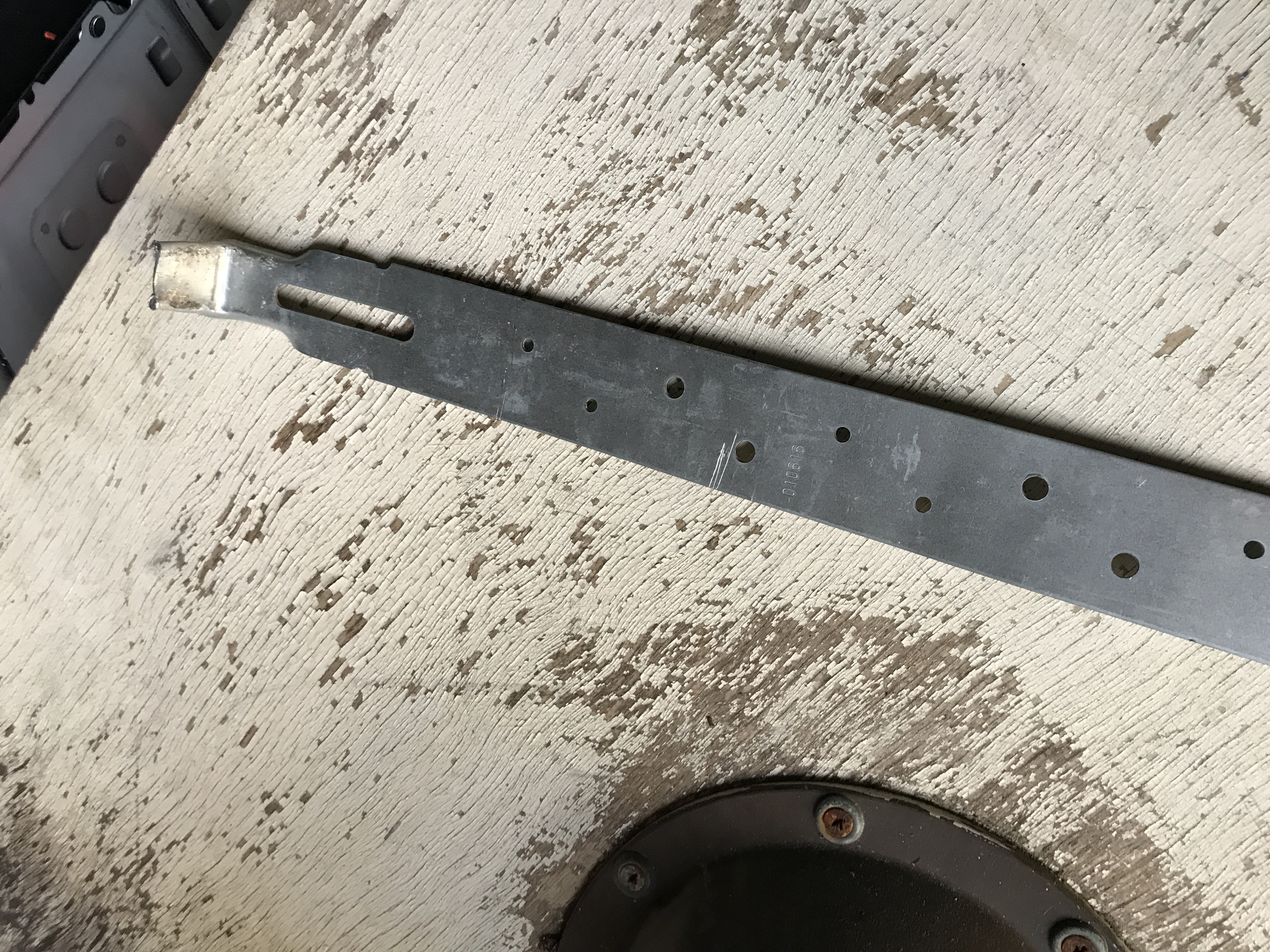

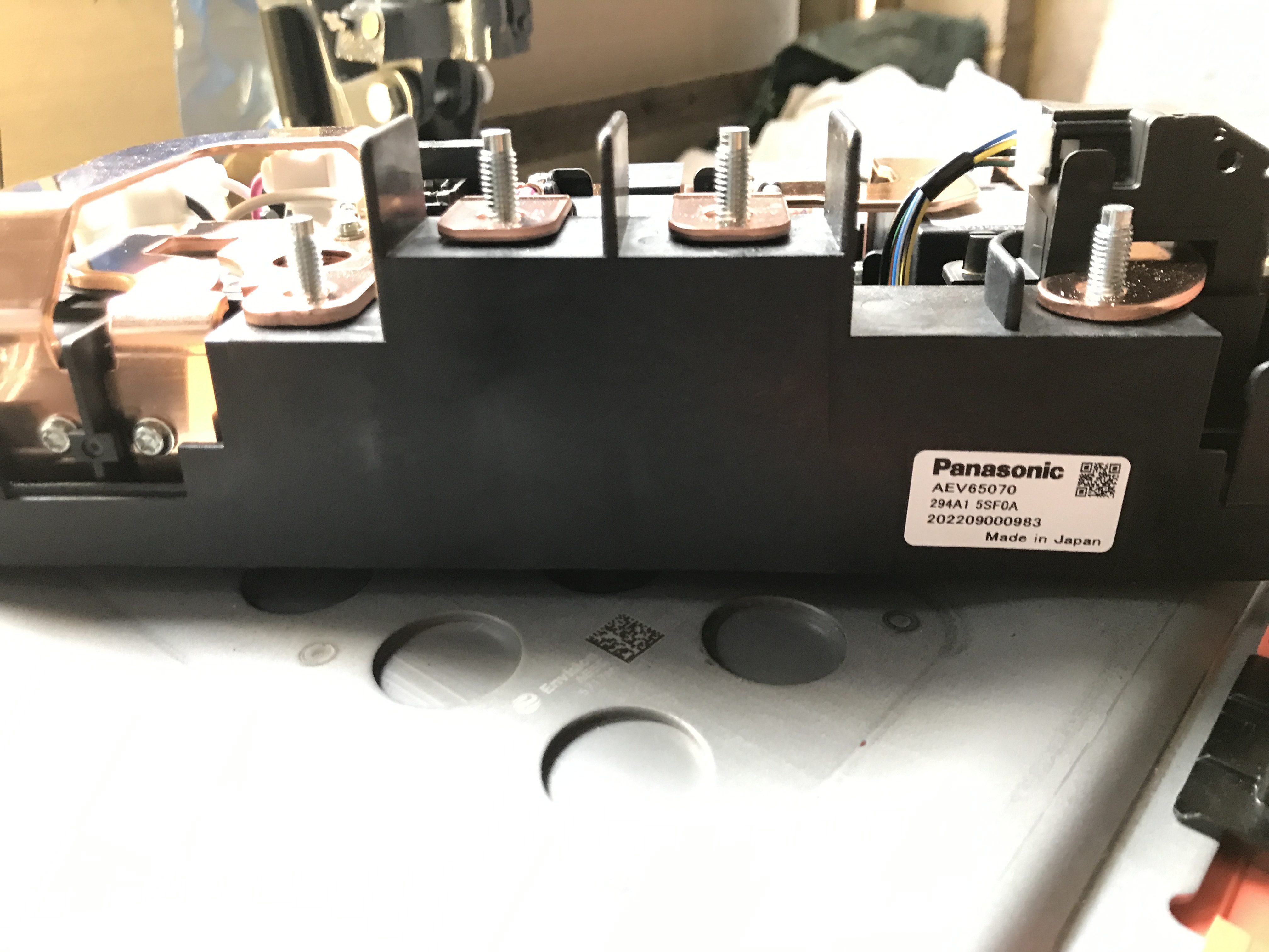

Getting the modules out of the case is a slight struggle. I found this building tie (for wall to roof) was a useful way to get a purchase underneath to pull them up.
A few of the other bits and bobs for the record…
