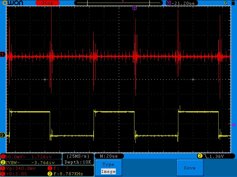

Re: Overcurrent trips at low speed
So took the inverter apart. Luckily I did not need to drain the cooling system.
There seems to be quite a lot of switch ringing on the current waveform. 150mV equates to 45A
Red: current sensor signal Yellow: is ch3 PWM (for timing)
Have tried adding a capacitor before the voltage divider/input filter (as on the first picture). That didn't do much.
Thinking about adding a chip bead ferrite inline. Need to find one with that works on the 26MHz most are 100MHz or higher
Don't think that I can do something about the origin of the noise.

After finding that the overcurrent error could be one of the 3 inputs to the NAND gate if the pulse is short enough.
I soldered the scope probe to the track between the NAND gate output and the TIM1_BKIN input on the STM32.
red=current sensor yellow=NAND Zoomed So the interrupt pin is triggered by the NAND gate. Next I soldered the scope to capacitor on the desat track.
Zoomed The datasheet for the NC7SZ10 gives a LOW Level Input Voltage of 0.3 VCC. That is 0.99V at VCC 3.3V
the scope got to 1.4V so in the inverter it whas even lower.
Added one of the chip bead ferrite to the track.
This seems to have fixed it
