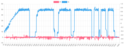

But when pulling away from a standstill sometime the inverter trips with a overcurrent error. If I get some speed than I can floor the pedal without a problem.
Have played with the iqkp and idkp values did not make a notable difference. With the handbrake on the Iq and Id are nice and stable. With this being a OI board I made myself it could be loads of different problems.
Would like some comments on things to check/try before I remove the inverter to scope the current sensors to check the signal for noise or something. And check the reference voltages for the overcurrent protection circuit.

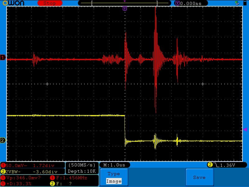

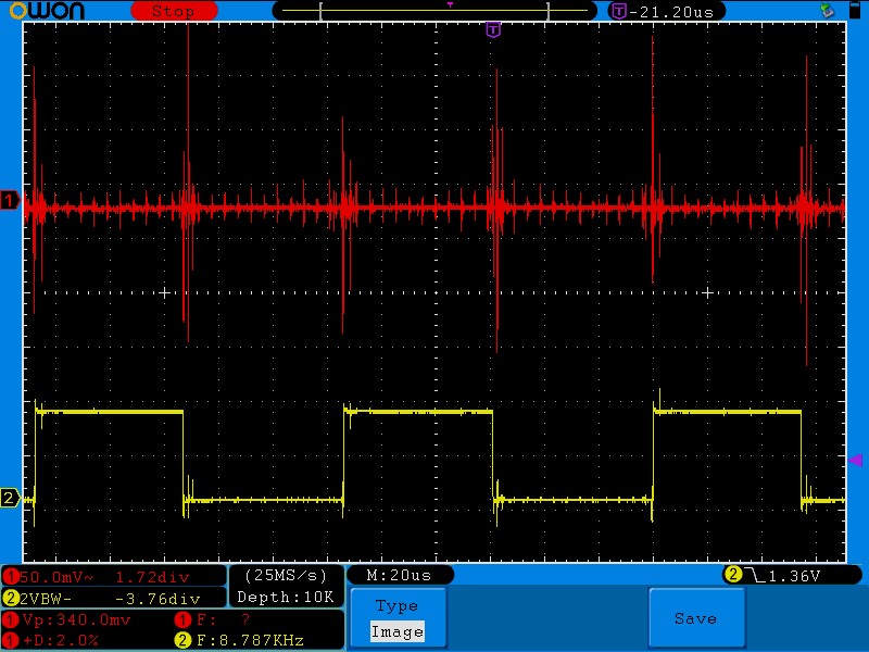

Re: Overcurrent trips at low speed

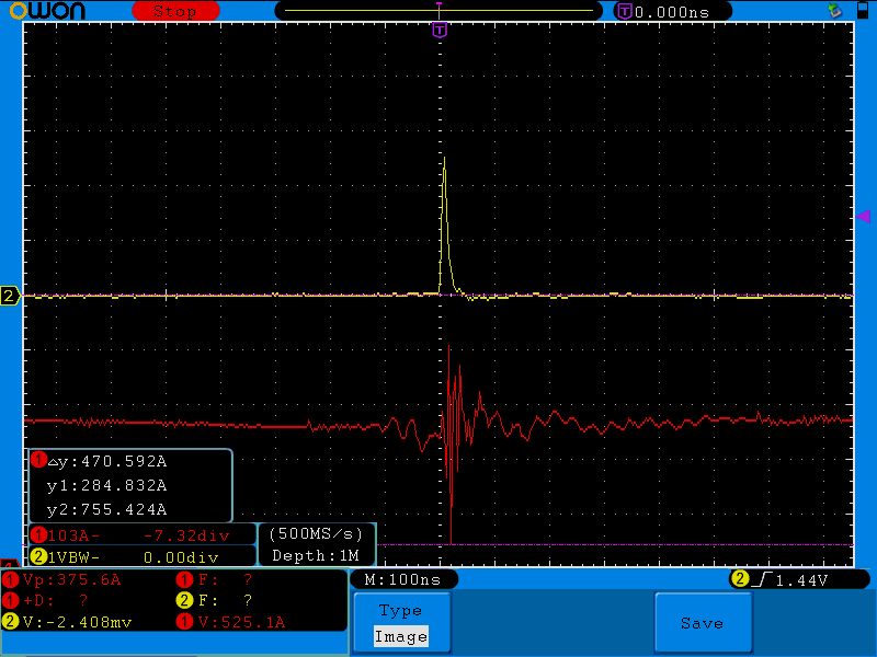

So took the inverter apart. Luckily I did not need to drain the cooling system.

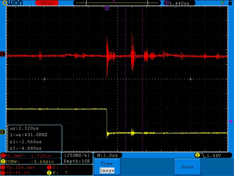

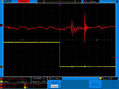

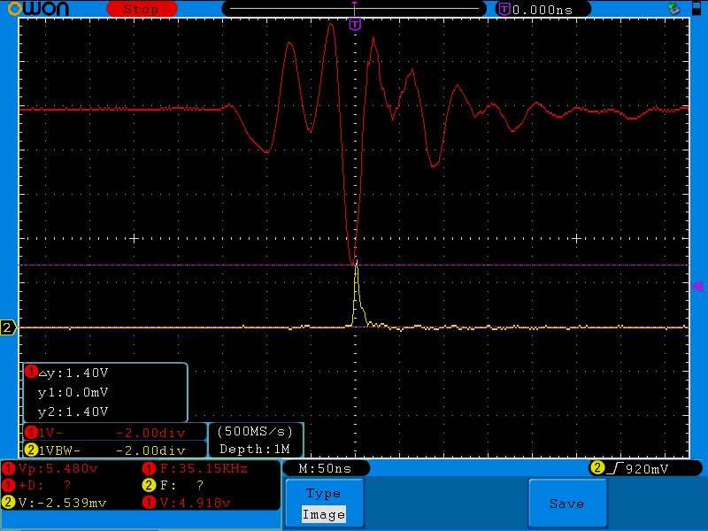

There seems to be quite a lot of switch ringing on the current waveform. 150mV equates to 45A
Red: current sensor signal Yellow: is ch3 PWM (for timing)

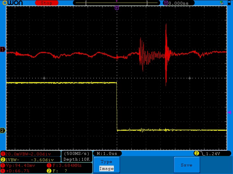

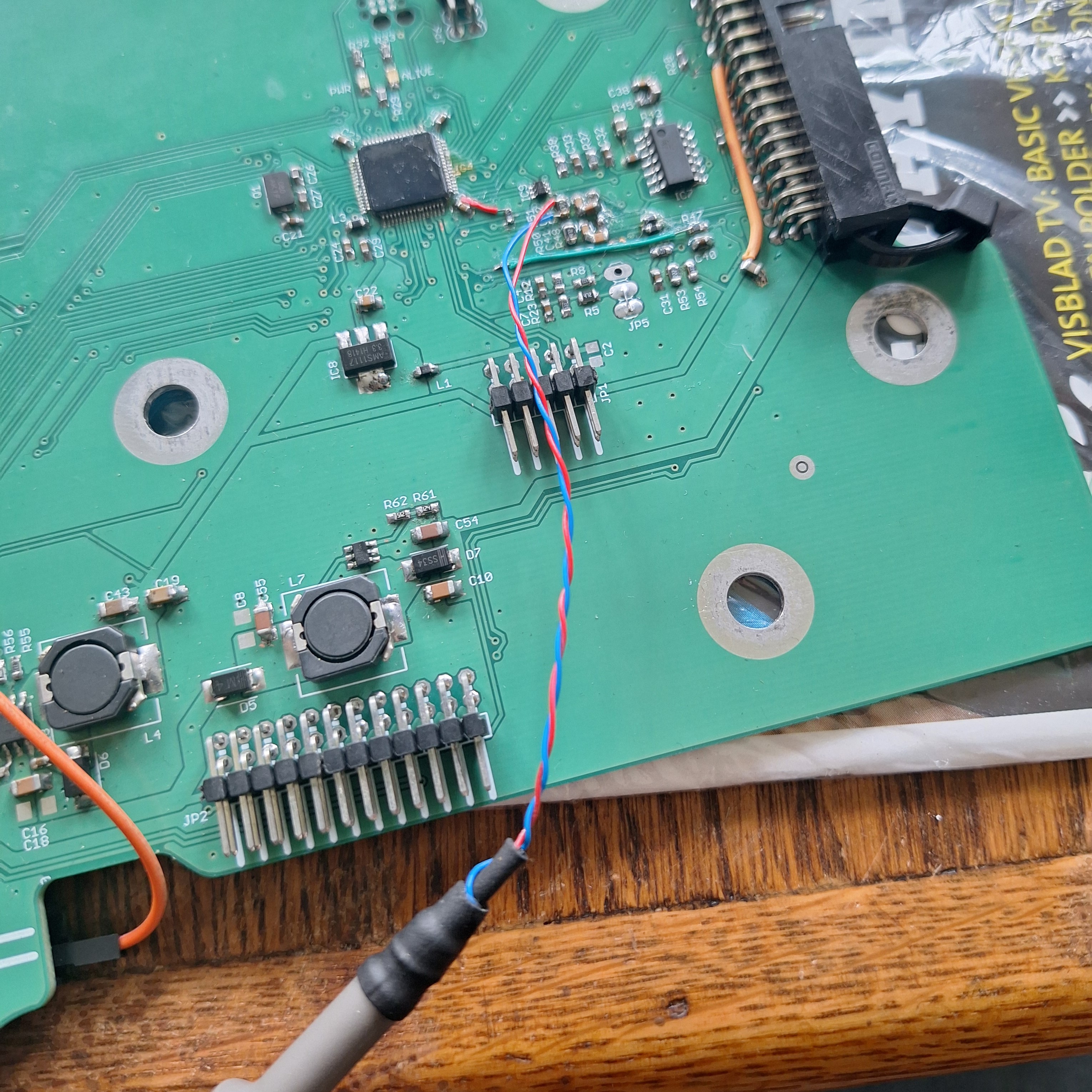

Have tried adding a capacitor before the voltage divider/input filter (as on the first picture). That didn't do much.
Thinking about adding a chip bead ferrite inline. Need to find one with that works on the 26MHz most are 100MHz or higher
Don't think that I can do something about the origin of the noise.

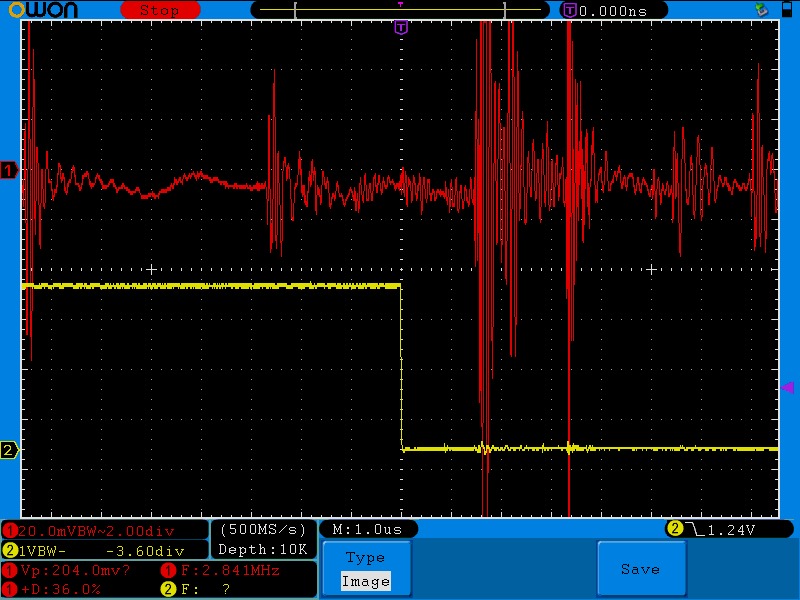

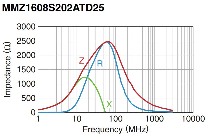

Finally got the car back together. After fixing the stuck contractors and a BMS issue.
Before that i got the chip bead ferrite installed on the inverter board. Went for the MMZ1608S202ATD25 from TDK. After some initial testing it looked to good to be true so I soldered a small wire across the bead, So I can measure in one setup, without and with the bead ferrite active. By simple cutting the wire.
So it suppressed the noise a lot. So I was hopeful that this solved the issue but sadly it did not. Still happy I "fixed" this.

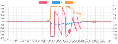

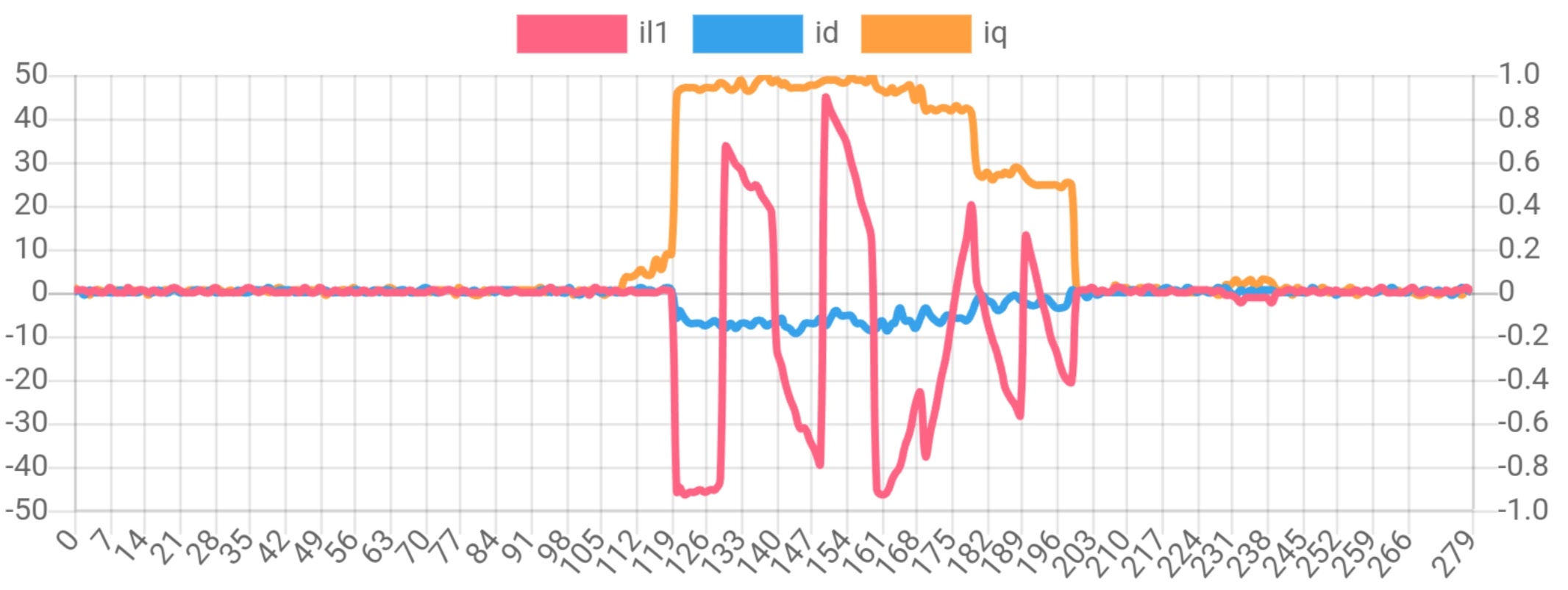

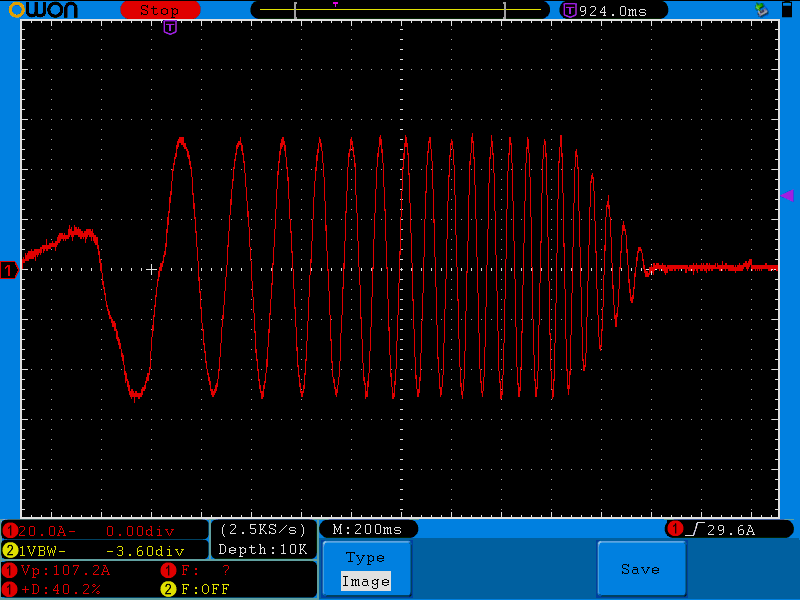

Did some testing in the garage because the weather is not compatible with driving with the hood up and a scope in there.
Set the throtcur to 0.5 and the I can go full throttle and slowly accelerate and then break before smashing in to the work bench.
So throtcur at 0.5 at 100% throttle 50A produces 107 peak to peak(probably, the current clamp is a cheap one. Hantek CC-650)
After looking at this I remembered that I have the MTPA parameters set so this may change things.

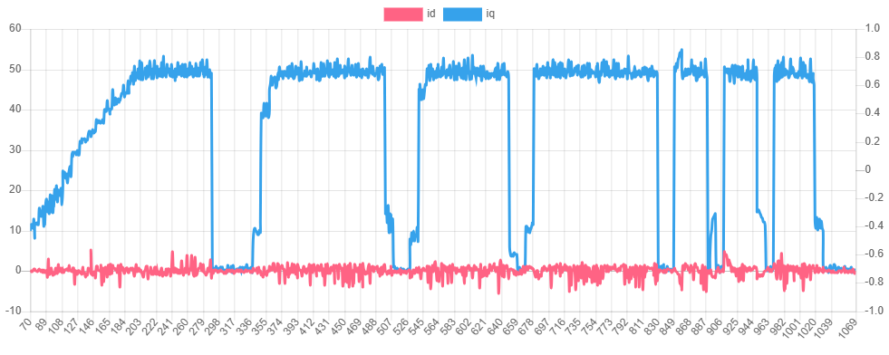

Took a plot on the web interface. So at 50A throttle Iq is 50A and there is some Id current resulting in the 107Ap/p on the scope.
To answer my own question:
This all seems fine. Hopefully the weather will cooperate this weekend to do some testing on the driveway and get a scope shot when the overcurrent occurs. To see if there is something strange going on or if it's just noise/trigger happy overcurrent comparator.
~Peak, but with some Id current. peak = sqrt(Iq²+Id²)

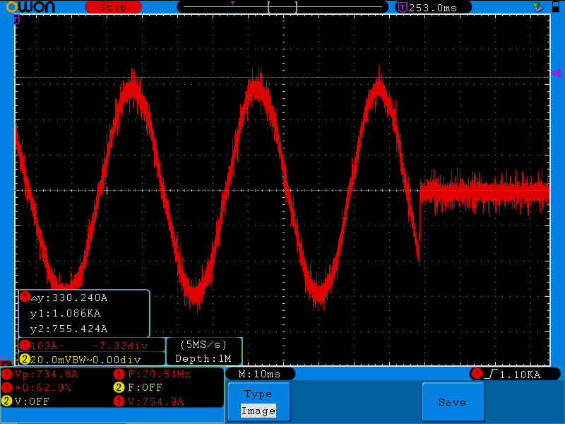

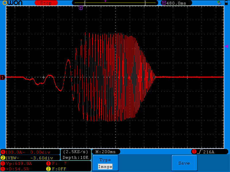

♫The sun is shining and scope is out♫

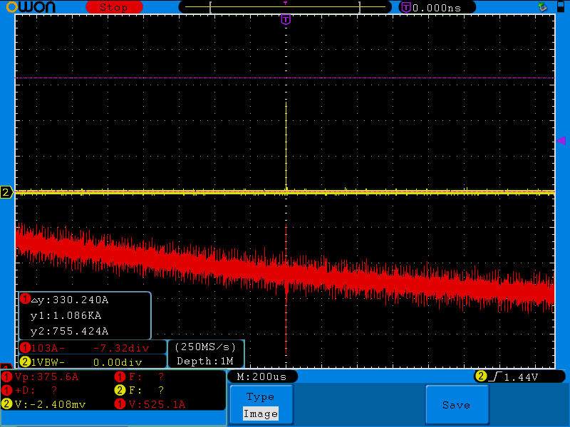

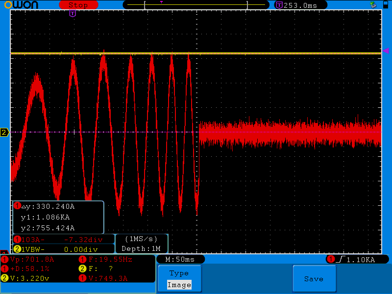

Went out for testing today. Tested every phase with the current clamp.
no trip trip
So this is definitely not a problem with the OI software it seems to have perfect control over the phase currents. This also means that the current sensor signal is also good.
Also bump up the ocurlim to 600A(sensor max). The response stayed the same. So it must be something else. Maybe signal coupling in on the track between the comparator and the nand gate(will check the pullup on this track). Maybe I will disconnect the current sensor signal from the comparator and replace it with a 1.65V from a voltage divider. To test this.
It is difficult to measure the current sensor signal on the controller. Because the PCB is on the backside of the inverter near the firewall
no trip trip

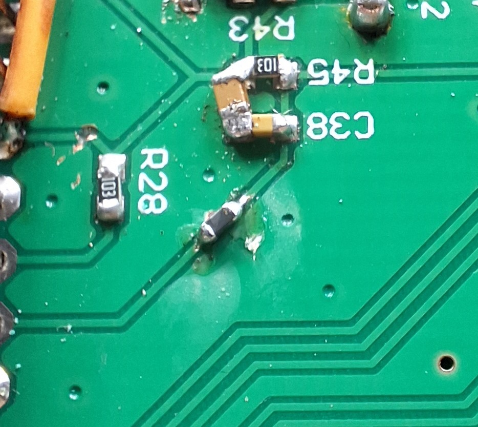

replaced the 10k pullup with 1.2k to get ~max 4mA as the datasheet from the comparator suggests(4mA only when overcurrent is active).
and added a 100nf capacitor near the VCC pin for the comparator.
so which one ¯\_(ツ)_/¯
IT IS FIXED
I have been a bad scientist and changed 2 variables between tests

Could not leave it like that.
Took the PCB out again and put the 10k resistor back. Got 1 trip in 5 launches.
put the 1.2k back in and got 1 trip in 10 launches.
So it not completely fixed but this is the problem area.

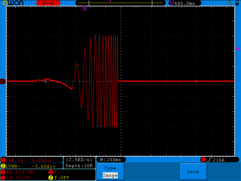

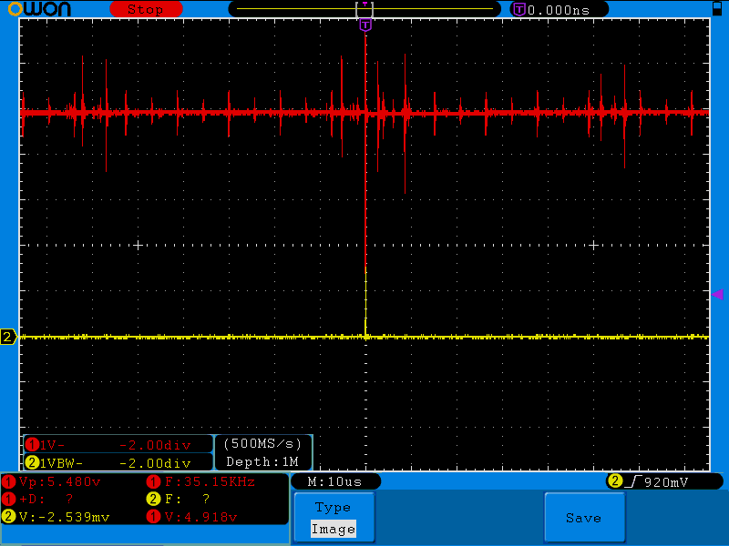

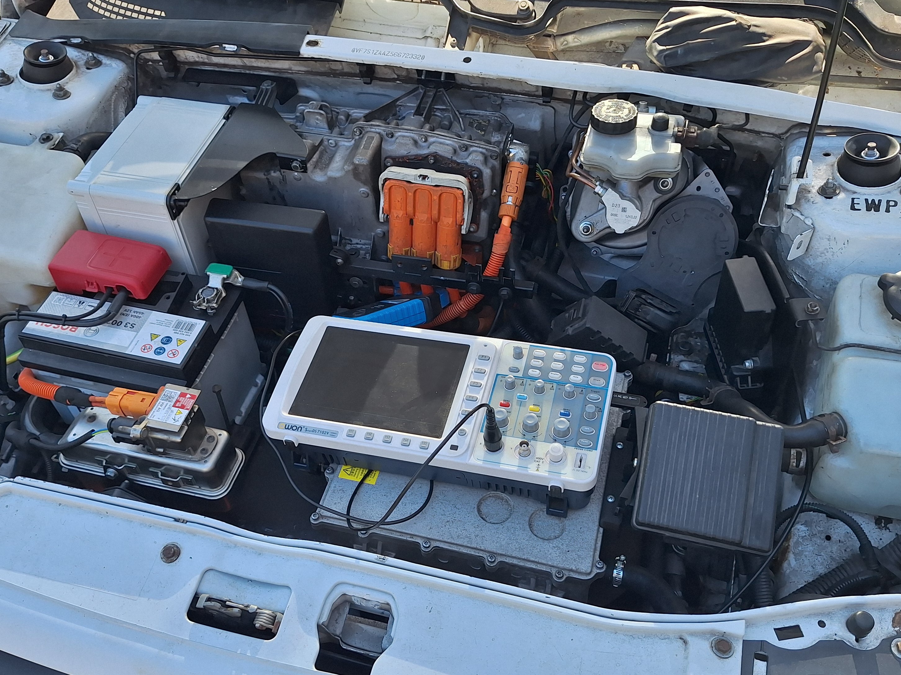

Did some more testing today.

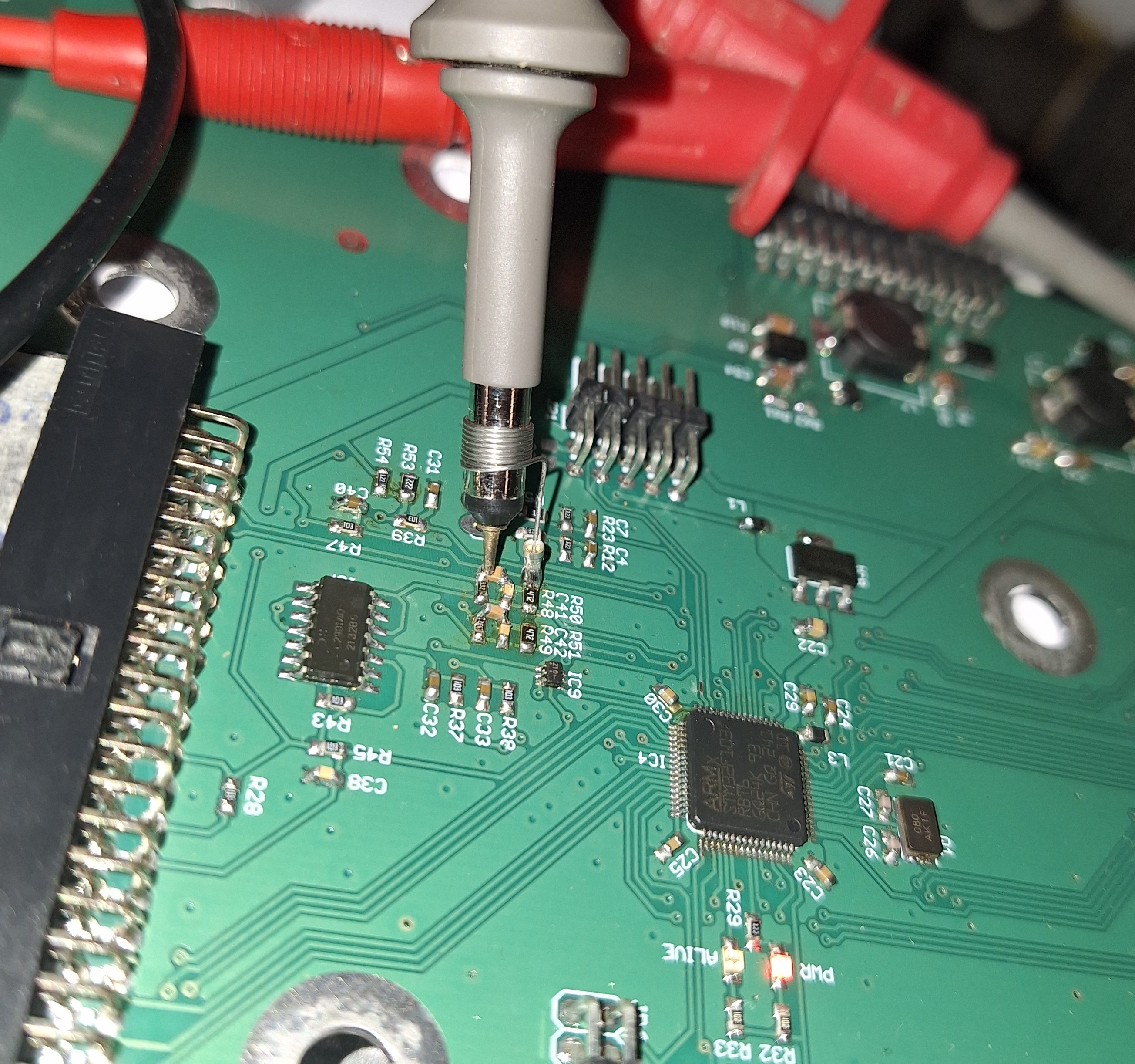

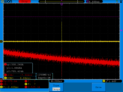

Measured the current sensor signals in the car. Did not do this before because, its difficult to measure the signals because the PCB is in a awkward place. Attached two small wires to the scope probe so that I can solder the in place.
This signal confirms the current clamp measurements. There is no overcurrent.
To check the output of the comparator added a second probe.
So there is no change on the comparator output. To verify this I used the comparator output as the trigger for the scope. floored the car, it tripped and the scope did not.
So what else can cause a overcurrent fault? Have been locking at the code on github.
So if the interrupt is triggered and no input is active than the overcurrent is set.
PS:
Found a small error in the OI mainboard. The pull up on the comparator output is to 5V but this pin on the STM32(pa1) is not 5V tolerant. the Desat pin is also pulled up to 5V but it is 5V tolerant. Changed the pull up on the comparator output to 3v3 did not change my problem.

Re: Overcurrent trips at low speed [SOLVED]
After finding that the overcurrent error could be one of the 3 inputs to the NAND gate if the pulse is short enough.
I soldered the scope probe to the track between the NAND gate output and the TIM1_BKIN input on the STM32.
red=current sensor yellow=NAND Zoomed So the interrupt pin is triggered by the NAND gate. Next I soldered the scope to capacitor on the desat track.
Zoomed The datasheet for the NC7SZ10 gives a LOW Level Input Voltage of 0.3 VCC. That is 0.99V at VCC 3.3V
the scope got to 1.4V so in the inverter it whas even lower.
Added one of the chip bead ferrite to the track.
This seems to have fixed it
