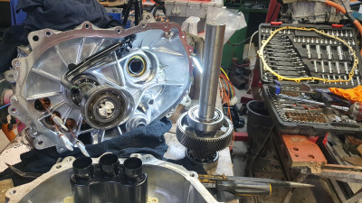

Re: Tesla Model 3 Drive Unit Mechanical Hacking
The big gear is a press fit on the intermediate but we need that one. Center bore is 22.90mm by my measurements so will be making a press fit into that and weld with some 29/9 rods. Will have a video soon so the internet can tell me I'm doing it wrong.

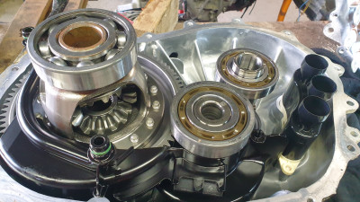

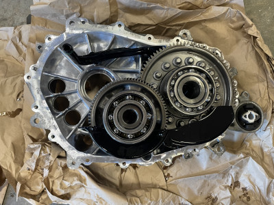

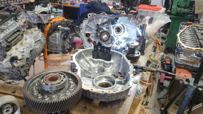

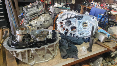

split my rear du apart.
very simple and minimal amount of parts.
all the case halves only have plainer machine features on them, this should lend itself to easily re-housing the motor alone.
Damien has the new 4d3 drive unit with hairpin windings, at first glance, this is the more ideal motor as it’s easier to bend the phase leads 90degrees..

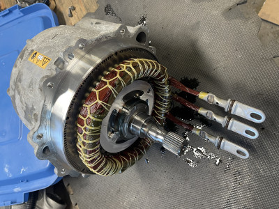

Davidk wrote: Sat Jan 25, 2025 8:38 pm There is only coolant pass through, shaft from rotor, 3 phase cables and coolant return. I plan to have phase cables bend 90 degrees so inverter will be mounted on the side on stator housing. There needs to be roughly 2 litres of coolant (it is somewhere in Tesla docs maybe i am wrong).
You’re a bit mistaken, there’s no coolant in the m3 drive units. Only atf. The oil pump runs Through a heat exchanger, then into a manifold. this manifold diverts part of the oil through a port that pushes the oil through channels in the stator. the other part of the manifold pumps oil through the input shaft bearing.
As it stands non-hairpin wound motors like the one I have, it’s probably not a good idea to bend the phase leads, as they are covered in an epoxy coating.
A 3d4 (or is is 4d3?) drive unit is the new hairpin design, which uses solid copper. This would be find for bending out of the way.

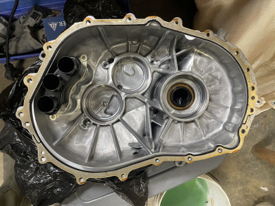

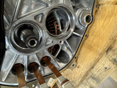

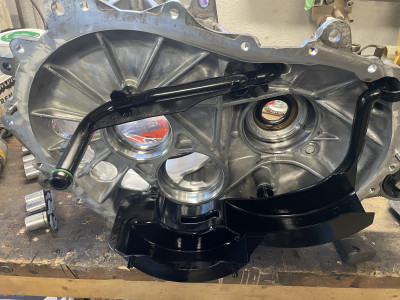

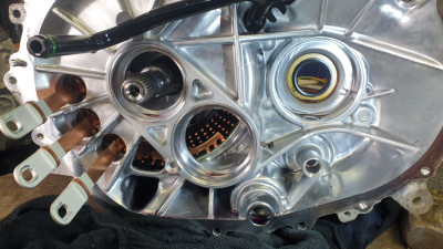

Here’s the motor side case half.
you can see the larger hole at the bottom edge of the case, this is in inlet for the oil pump.
Adjacent to that is outlet hole from the oil filter.
This hole connects to the top right hole via a plastic tube (seen in the other photo). Oil then passes through the heat exchanger (across the top of the case), then exits back into the case via another hole. Another tube splits the oil from there to the hole right next to it(which feeds the motor) and y’s off to the other case half. On the other car half the oil is pumped through the input shaft and intermediates shaft bearings.
Here’s the other case half where you can see where the oil tube inserts and routs the oil into the bearing bores
Using the intermediate shaft for out put would require cutting a hole in this case half, and making a plate with a shaft seal on the other side of the case. Not sure of oil pressure, but I image the pump runs at different speeds based off temperature? the viscosity and how small some of these Chanel’s are, I’d imagine it’s pretty decent.
Hard to say if you could have a shaft seal there without the oil blowing by. Just need to keep those bearings lubricated

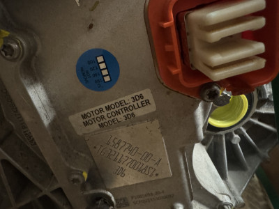

After bit searching on internet it looks like Damien has 3D6 or 3D7 version.
Newer 4D1 and 4D3 are with new “squared” inverter, relocated filter and pump.
Tesla has description here: https://www.tesla.com/ownersmanual/mode ... CAA58.html
Wiki with a lot of details: https://tff-forum.de/t/wiki-model-3-mod ... its/190111

Just to confirm, my 3d6 motor has hairpin design.

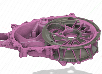

3D scan of casting (stator side) created today. Feel free to use them, precision should be 0.05mm.
