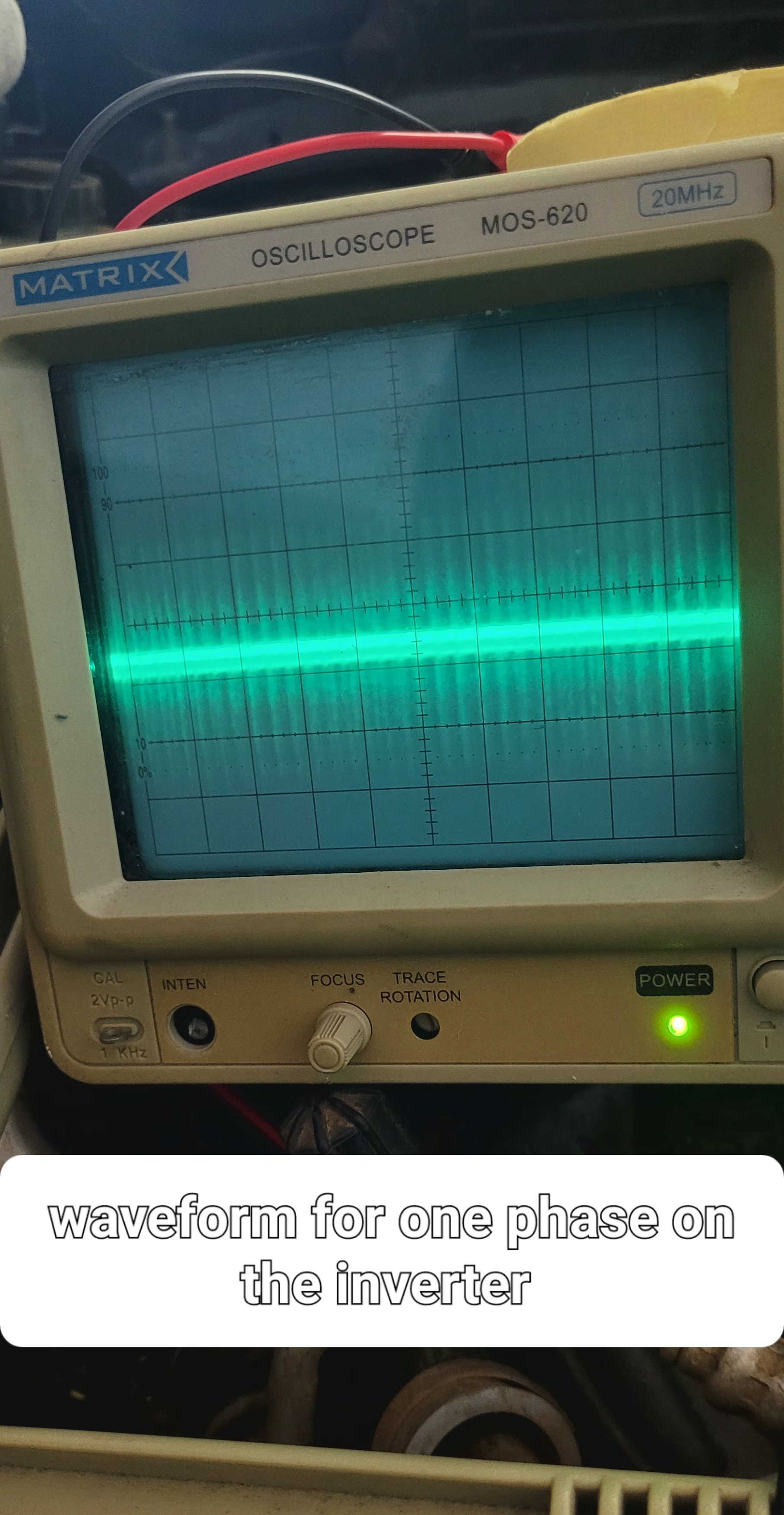

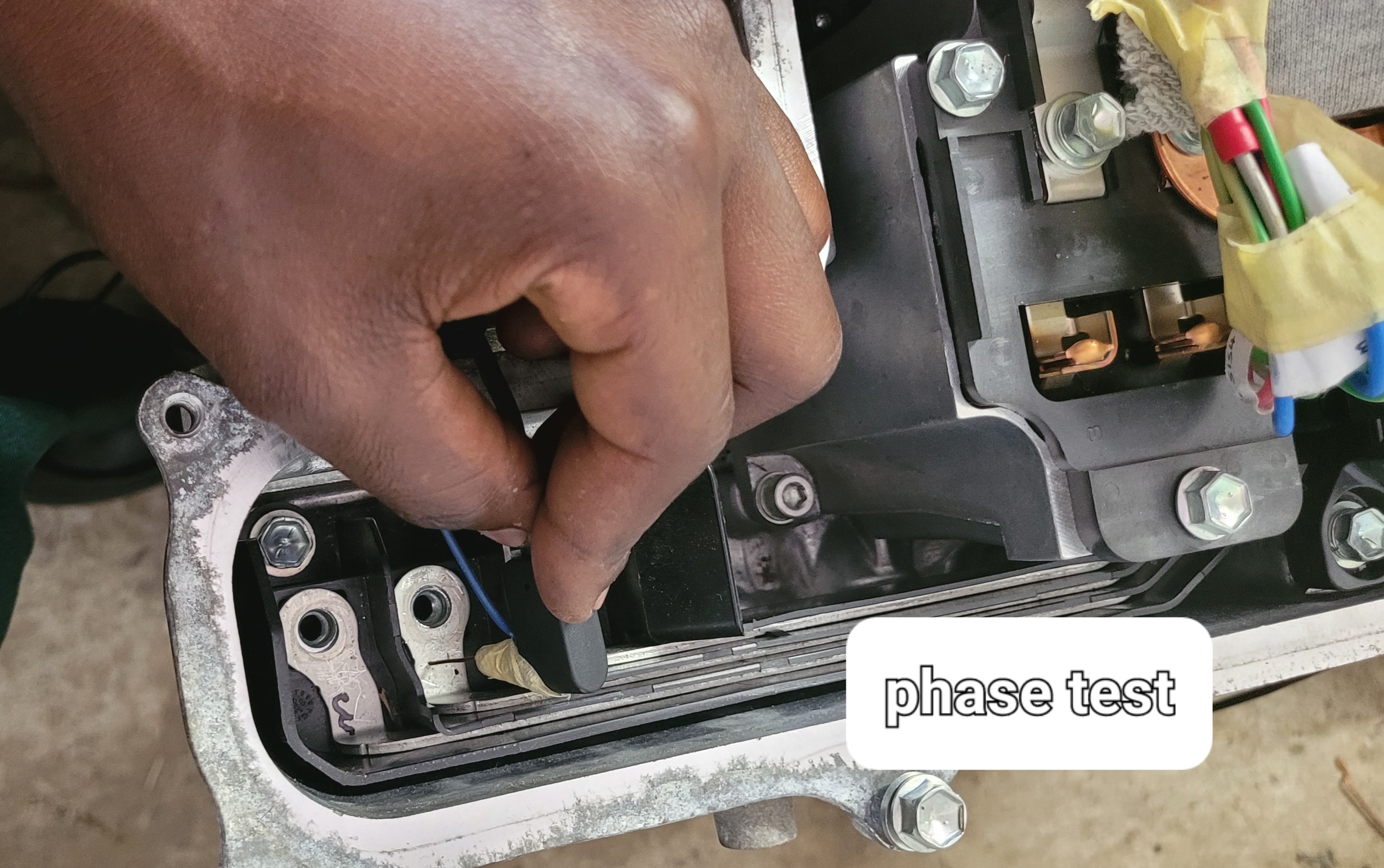

Re: EV Conversion using prius gen 2 inverter/transaxle
First of all I'd like to apologize for all the trouble I've caused you all. I wouldn't be here if I knew whay I had to do. I appreciate all the effort and time you've invested in helping me out. I really appreciate that
From now on I'll give a detailed explanation of everything I do.
First I made a probing wire since I didn't have one. I used an old laptop cable. I've attached pictures below. The white wire showing from the black cable is my positive and the other longer wire is my negative. For the test points I have a green and yellow cable which is my negative and the shorter head is my positive.
After connecting it to the scope I first tested with my hand to see if it works. I also have pictures of that below.
Next I turn on the inverter and the vcu I tested pins 28 29 and 30 before logging in the web Interface, a noise pattern showed up on the scope.
Then I went to the web Interface, I set ocurlim -1 and hit send custom command. I went to test section and set manual mode on fslipspnt 1 and ampnom 1. I started inverter in manual mode, went to sport values check opmode, I hit refreshed and it changed from off to ManualRun.
I went back to three phase output on the inverter to test and the waveform was still the same.
I wasn't sure if I was supposed to test on the inverter or the control board for the waveform so I also tested the pins on the board and ive attached that pictures aswell.
Ok, so from your scoping it looks like no PWM is coming out of the ULN2003 driver. Can you measure the ULN2003 inputs, so pins 4,5,6 of IC6?
Are you sure you scope works?

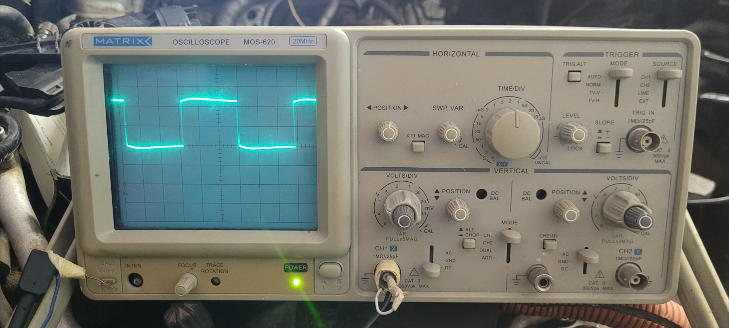

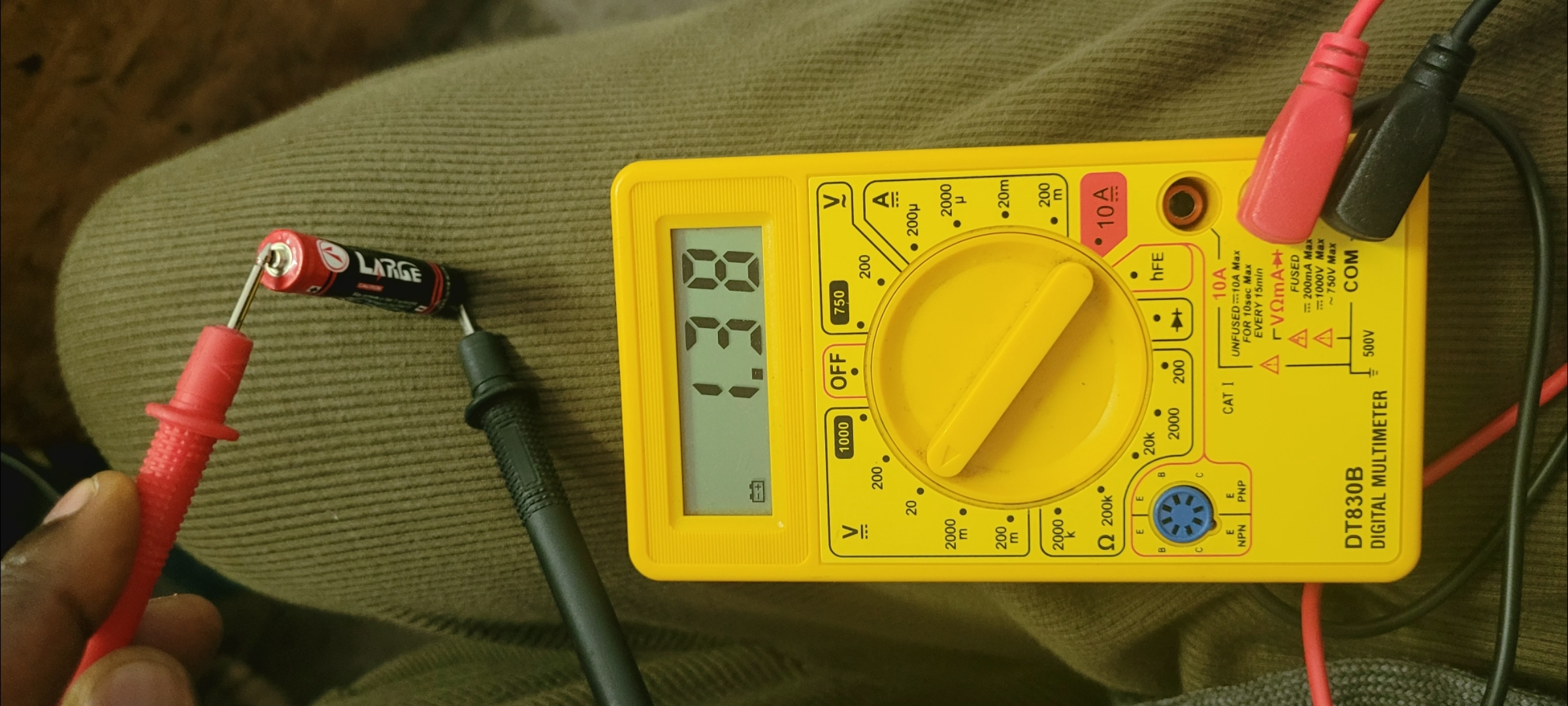

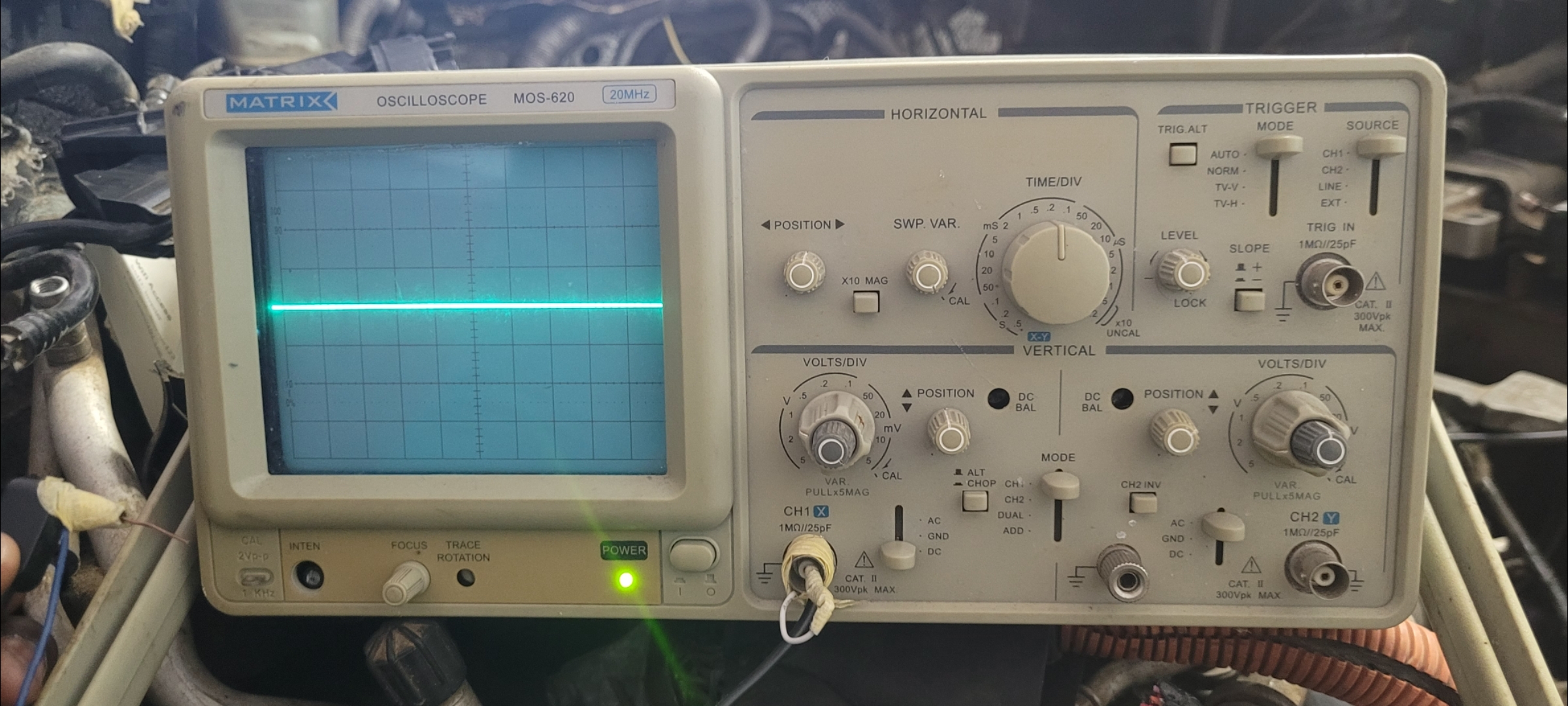

I had to watch more than 2 tutorials on how to use a scope to make sure I get it right since I ouldnt find anyone to help me. My country is not thst advanced in technology. In my home town there isn't a single shop selling electronic parts, not to mention an oscilloscope. Finding someone who knows how to use one is even harder.
So I was able to make sure that the scope works fine, "I'd like to think do, you'll be my judge". I've attached screenshots below of the readings I got.
On the tutorials they helped me test the probe using the 2vp-p 1kHz test on the left bottom corner of my scope. And I was able to get a proper square wave from dc. Then I went on to test a 1.5v AAA battery.
First I rested it with my multimeter to see if it has some juice in it. Then I used my scope to see what will happen when I connect it to the battery. The green horizontal bar moved a round about 90% labeled on the vertical side of the scopes display screen.
Then from there I logged in the web Interface, set ocurlim -1 ampnom 1 fslipspnt 1 selected manual mode and hit start inverter in manual mode. Went to spot values, refreshed and confirmed manualmode.
Then I first used my multimeter to test for voltage on the ic6 chip. First I tested pin 8 GND and pin 9 VCC and I found 14.57v which my power supply is supplying (15v) the I tested pins 5,6,7 against pin 8GND, the pins 5,6,7 and thr ones on the left side of the ic6 which are input that Johu said I should test, right?.
With the scope I couldn't barely find any readings as I got 0.01v on all this three pins. When I tested using the scope the horizontal green bar on the scope barely moved and it just shifted I think by 0. Something on the horizontal axes I had it on. I hope you understand what I mean. But in shot in barely moved because when I tested pins 8 and pin 9 of ic6, the green horizontal bar shot way up, so high that it couldn't read on the screen, way above 100%.
Pictures attached, sequence from bottom to top
Seeing a square wave is good news. It tells me your scope is functioning, your probe lines aren't broken, you have some correct understanding of how to operate the scope. All good things.
Getting 15v on the ULN2003's pins is good, I think. I don't know if that's the right voltage for the bus, but, it confirms you've got power going to the chip.
Getting 0v on pins 5, 6, and 7 is sad. Yes, the left side.
That means the controller is not telling the chip to make a square wave.
I'll stay aside and let Johannes advise further on where the fault is located and what to try next.
