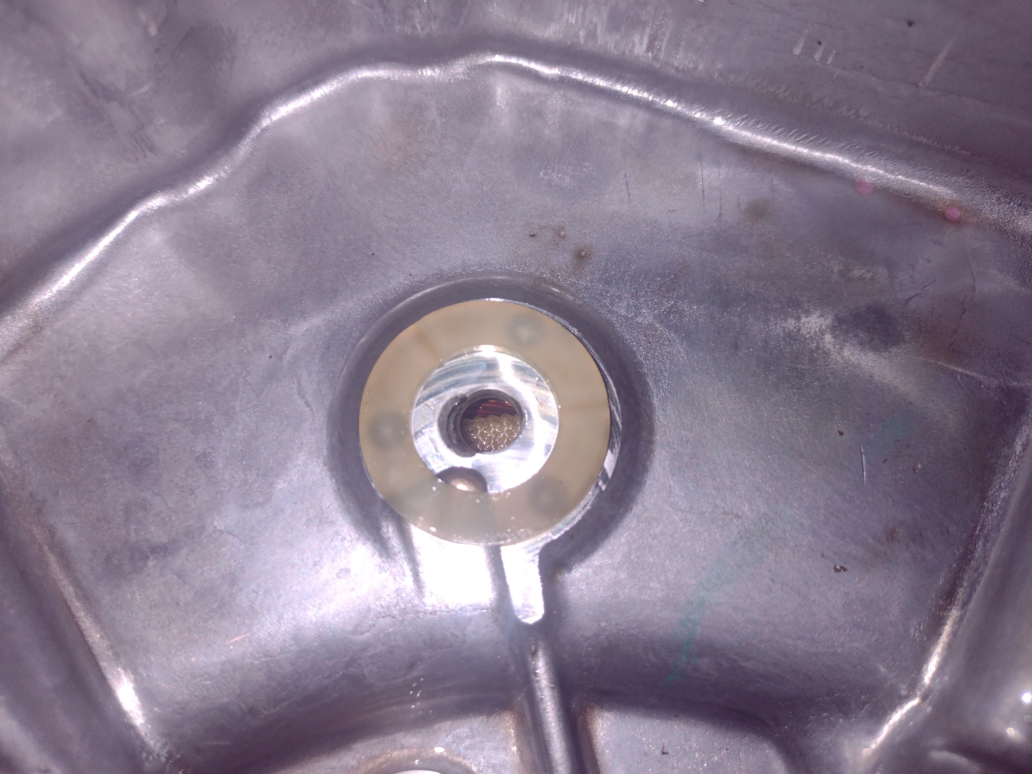

I have been running my setup with no problem until yesterday when the motor developed a very high piched noise, any ideas on what could have occurred?..the motor has 4 litters of AWS fluid

Got a video of the noise? My first transmission developed a nasty noise after 1k miles. I didn't find out what caused it.

I replaced the transmission. Only thing I found was the hole for the internal oil pump was damaged. I didn't fancy all the effort to put it back in without it just incase it wasn't it.

What's your plan? You going to tear it down?

I will tear it down I'm curious to learn the source of failure but I plan to replace it.ill keep you posted on findings
