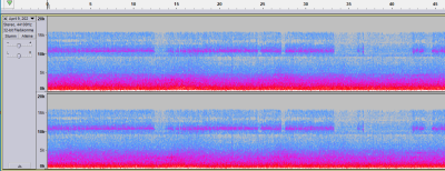

Hi all,
I'm posting this here hoping you all may be able to shed some light on what this noise is. At the moment, our best guess is the front drive unit/a bad or faulty bearing design.
There is a large number of Tesla Model Y and 3 owners that have been vocalizing their concerns and frustrations with this noise. There is a very long thread over on Tesla Motors Club forums where you can read all about it. I don't know what the policy is for posting links to other forum boards, so I'll refrain from posting the link to it for now. The noise we are hearing, which can not be heard by everyone (frequency), is the noise heard (if you can hear it) in this video:
This noise is seemingly only present in cold weather (50 degrees fahrenheit or colder), above a certain speed (50mph). Although, some have heard it at lower speeds. It is even being heard on the new Model 3 Highland models.
Does anyone know what this noise is and/or how one might eliminate it? Tesla service centers have replaced front drive units over this noise, with some replacements solving the problem, but most failing to solve it. Tesla has taken a different stance on these drive unit swaps recently, and is now stating that although the noise is known to Tesla engineering, it is not something they are being authorized to perform a repair for.

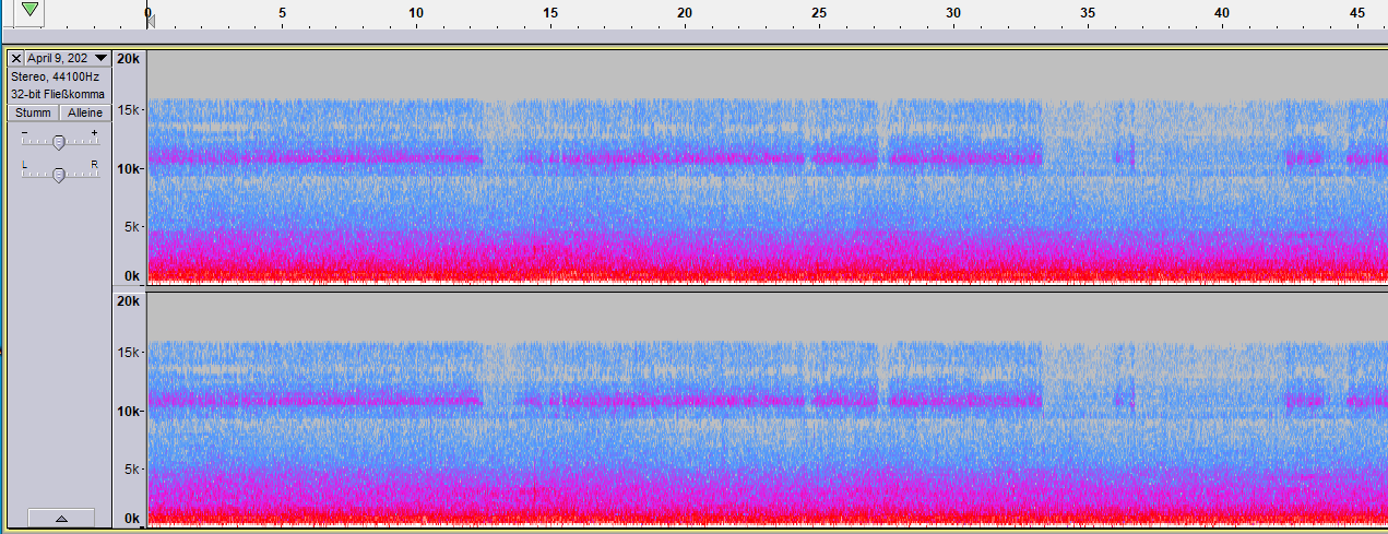

From the video linked above, took the audio, loaded it into Audacity (a really nice free audio processing tool), and see a quite stable tone at around 11kHz. Personally I cannot hear it, but it is clearly there. The frequency is stable, and the tone has some gaps. Would have been nice to see the speedometer at the video instead of the jeans :-)
I'd propose to place some microphones into the interesting places to find out the loudest spot.

Sorry about the video; it isn't mine; I snagged it from the 40-page thread about this issue on the other forum board. I added a few more sound clips below for reference.
Does the sound change pitch relative to speed?
It does not.

Given that it doesn't change frequency with speed, I am very skeptical that it is caused by any rotating components such as a bearing. In my opinion, that points to the inverter itself and likely its switching frequency. That could also explain Tesla's refusal to replace the units. Likely, they initially assumed it was a bearing issue like the LDUs had, but upon examination determined its an inverter noise issue.

I’m still of the mindset that this noise is harmonic in nature. While I’m not at all familiar with inverters and the noises they produce, but I’m very familiar with mechanical issues. The best way I can explain this sound is as if it’s something not properly tightened that is excited by mechanical resonance. In this case, I suppose it’s even possible the noise could be trigged by a specific speed of the motor due to the magnetic impulses causing something immediately near the FDU to resonate? I’m thinking of how old transformer hum after the insulation materials start to degrade - the process that creates the sound being similar I mean..?
Furthermore, if it were a failing bearing, the noise would be increasing in volume over use. This doesn’t appear to the case. I haven’t seen one case of an FDU failure in which the noise was apparent prior to the failure.
Forgive me if I’m stretching definitions here or using the wrong words - I have no formal training in electrical or mechanical engineering.
For those interested, the user ev_go123, over on Teslamotorclub, took a recording with a microphone attached to the FDU. While this does not necessarily mean the noise is coming from inside the FDU, it may be helpful to differentiate it from noises that could be coming from the inverters.
