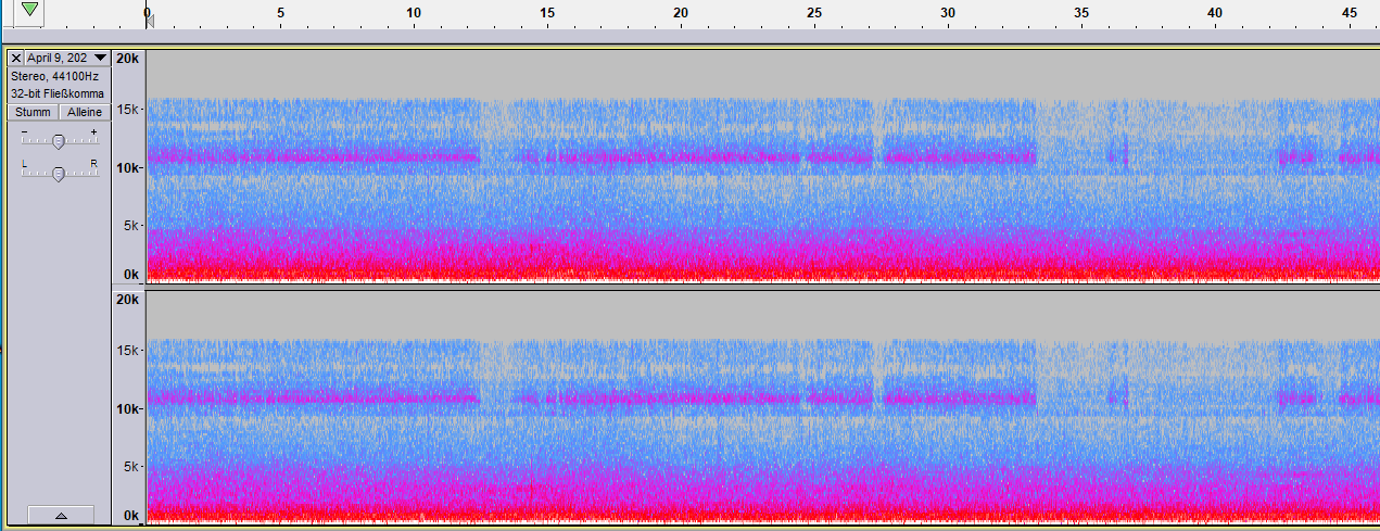

From the video linked above, took the audio, loaded it into Audacity (a really nice free audio processing tool), and see a quite stable tone at around 11kHz. Personally I cannot hear it, but it is clearly there. The frequency is stable, and the tone has some gaps. Would have been nice to see the speedometer at the video instead of the jeans
I'd propose to place some microphones into the interesting places to find out the loudest spot.

That frequency seems to be almost the same as my tinnitus, had to really play with the volume to make sure I was hearing it.
If my car was doing that I would probably try to isolate it with an automotive stethoscope if possible. I'd be checking different parts of the drive unit as well as the wheel bearings, and anything metallic near the motor just in case it's being induced by the AC.
Sometimes manufacturers add mass to problematic parts, which will shift any harmonic frequencies up and hopefully out of the range of the human ear. The 2010 Chevrolet Camaro had terrible noise from its front brakes. For those models, the fix was to stick a bunch of lead wheel weights to the outside of the calipers. 2011+ models had a more professional-looking set of weights permanently affixed to the caliper. I wonder if something like that would help here? I feel like if I was being driven sufficiently insane by the noise and couldn't isolate it, I'd be sticking weights to various parts just to see if it helped.

Given that it doesn't change frequency with speed, I am very skeptical that it is caused by any rotating components such as a bearing. In my opinion, that points to the inverter itself and likely its switching frequency. That could also explain Tesla's refusal to replace the units. Likely, they initially assumed it was a bearing issue like the LDUs had, but upon examination determined its an inverter noise issue.

I came over from the Teslamotorclub forum to see what the thoughts were about the issue here. I have read and kept up with the 799-post-thread over there, as I am also experiencing the issue.
I also have a hard time believing it’s a bearing based on the fact the frequency is consistent. While there are quite a few people who have had the problem remedied by replacing the front drive unit, yes… most of those fixes required multiple FDU replacements to solve the issue. This means either, there are that many effected units OR the act of a dropping and replacing an FDU has an affect on whatever is causing this issue. I’m leaning towards the latter.
I’m still of the mindset that this noise is harmonic in nature. While I’m not at all familiar with inverters and the noises they produce, but I’m very familiar with mechanical issues. The best way I can explain this sound is as if it’s something not properly tightened that is excited by mechanical resonance. In this case, I suppose it’s even possible the noise could be trigged by a specific speed of the motor due to the magnetic impulses causing something immediately near the FDU to resonate? I’m thinking of how old transformer hum after the insulation materials start to degrade - the process that creates the sound being similar I mean..?
Furthermore, if it were a failing bearing, the noise would be increasing in volume over use. This doesn’t appear to the case. I haven’t seen one case of an FDU failure in which the noise was apparent prior to the failure.
