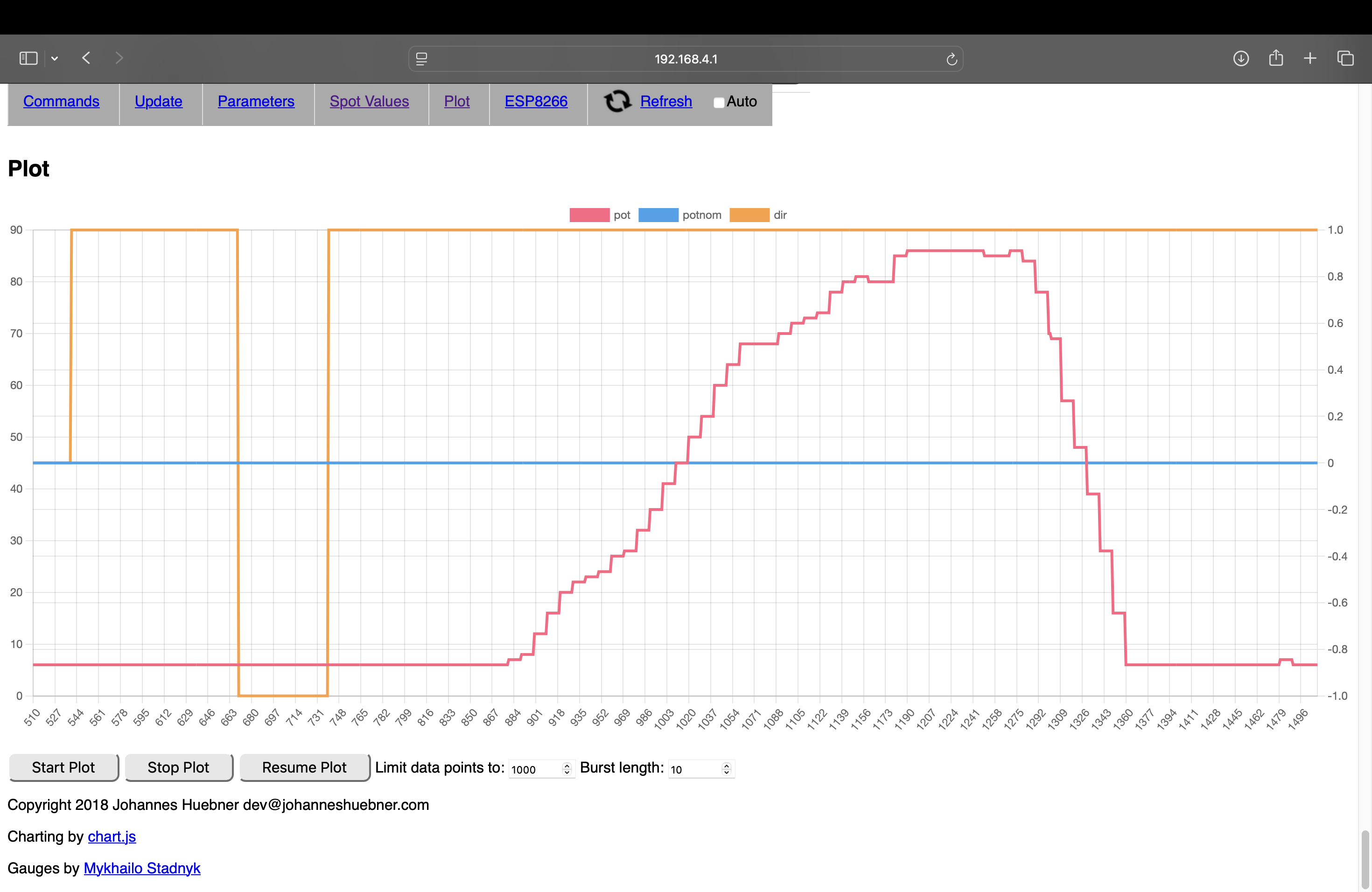

Re: Leaf First Spin Parameter Help
plot.
L- pot 1
R- potnom and dir
start plot
select dir to forward
increase throttle
Screenshot and share please.
L- pot 1
R- potnom and dir
start plot
increase throttle
Here's the files. Interestingly the potnom didn't move. I don't know enough to know why it didn't move with the pot values. I'm assuming potnom means pot nominal... the value to use if both the pots pass redundancy checks? IDK. I'm going to go look it up.
Maybe my pot max is too high, and with the little bit that I'm turning the throttle I'm not making it out of throtdead, which is set to %10. That means pot values need to be over 310 (potmax is 3100). Does that sound right?
I turned the pot about a third of the way (pretty scared of cranking it up).
I calibrated the throttle/pot months ago, and can't remember how accurate / close it is. I'll double check the real max value when I get a chance.
Calibrate your throttle first then come back.
You are getting very very low changes in throttle compared to your declared range.
OK, I found the problem this morning. I used parts I had around to build my little control box, and turns out the pot was logarithmic, from an old audio project. So, max it was 3100, but turned half way was still only about 50. So, it was in the thotdead (potnom < %10) zone for most of the pot range.
I calibrated the pot settings to only use the first half of the pot range, and got the motor to spin as expected. So, proof of concept done. Now we're on to cleanup the test setup and think about the real configuration.
