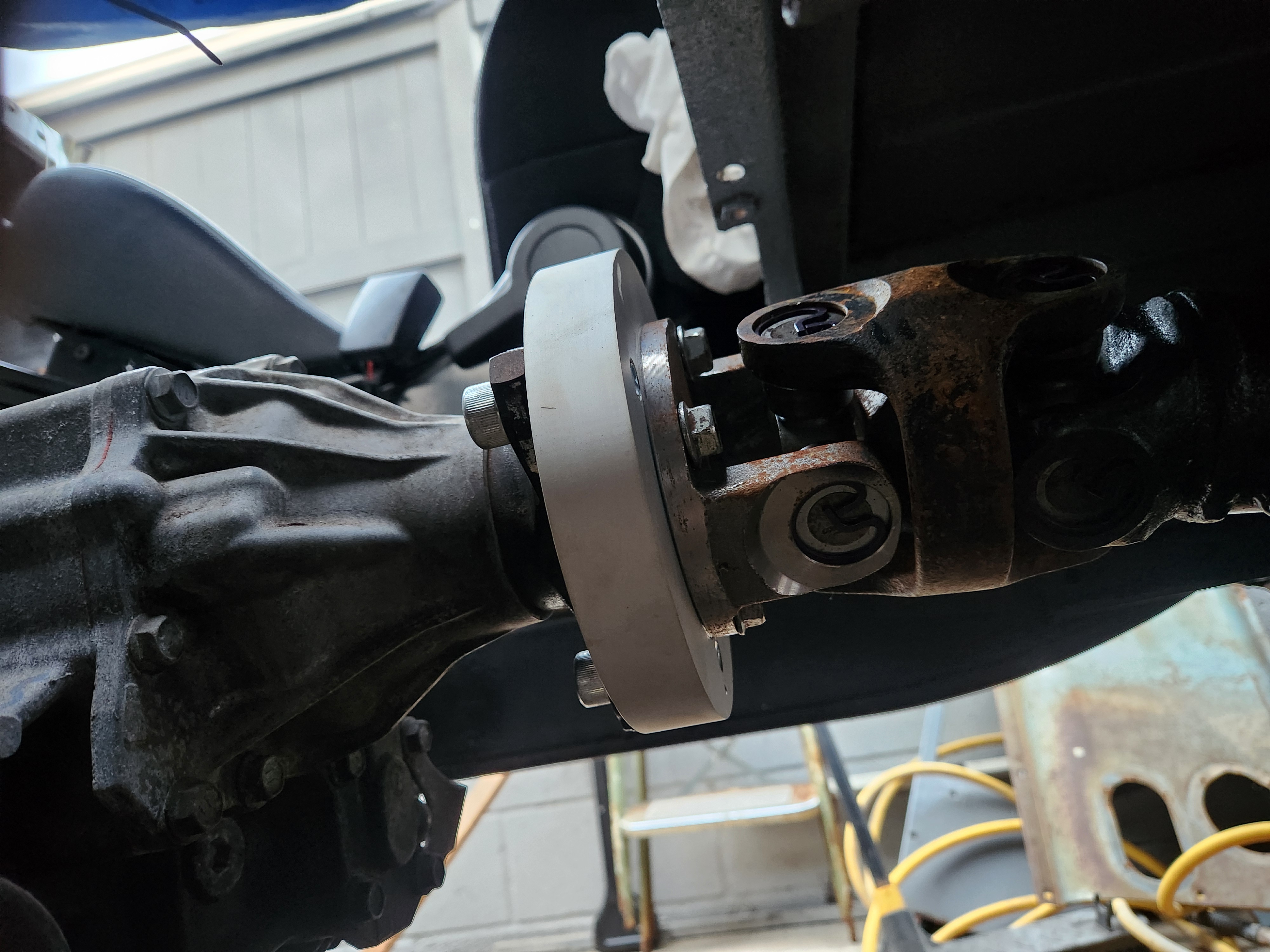

Came back from a few days out of town to find my nice new adapter all machined up from jlc:
robertwa
Posts: 152
Location: San Diego, CA
Has thanked: 108 times
Been thanked: 117 times
Re: [WIP] 1964 Scout LS600H conversion
Post by robertwa »
Slow progress, but got the adapter mounted at least
Posts: 965
Has thanked: 154 times
Been thanked: 334 times
robertwa wrote: Wed Jan 08, 2025 3:21 am Slow progress, but got the adapter mounted at least
Nice, is it anodized? Or planing on panting it?
Just concerned over the dissimilar metals reaction.

Bratitude wrote: Wed Jan 08, 2025 6:23 am Nice, is it anodized? Or planing on panting it?
Anodized.... this is what I chose:
Material: Aluminum 6061
Surface Finish: Bead blasting + Anodizing-Natural-Matte
Tightest Tolerance: ISO 2768 medium
Surface Roughness: Ra3.2
Threads: Yes
Posts: 965
robertwa wrote: Wed Jan 08, 2025 4:48 pm Anodized.... this is what I chose:
Threads: Yes
should be okay, i would throw a lay of paint on the steel ends to be on the safe side being is exposed to the elements harshly

With the front and rear driveshafts installed, I put the Scout up on jack stands and got everything spinning. Filled up the transmission with Toyota WS fluid. Still need to change the fluid in both differentials and the transfer case. So far the LS600H inverter seems to behave when Zombie is set to GS450H settings. I'm really excited to be so close to actually moving this under its own power and parking it backwards so I can work on the other side more easily.

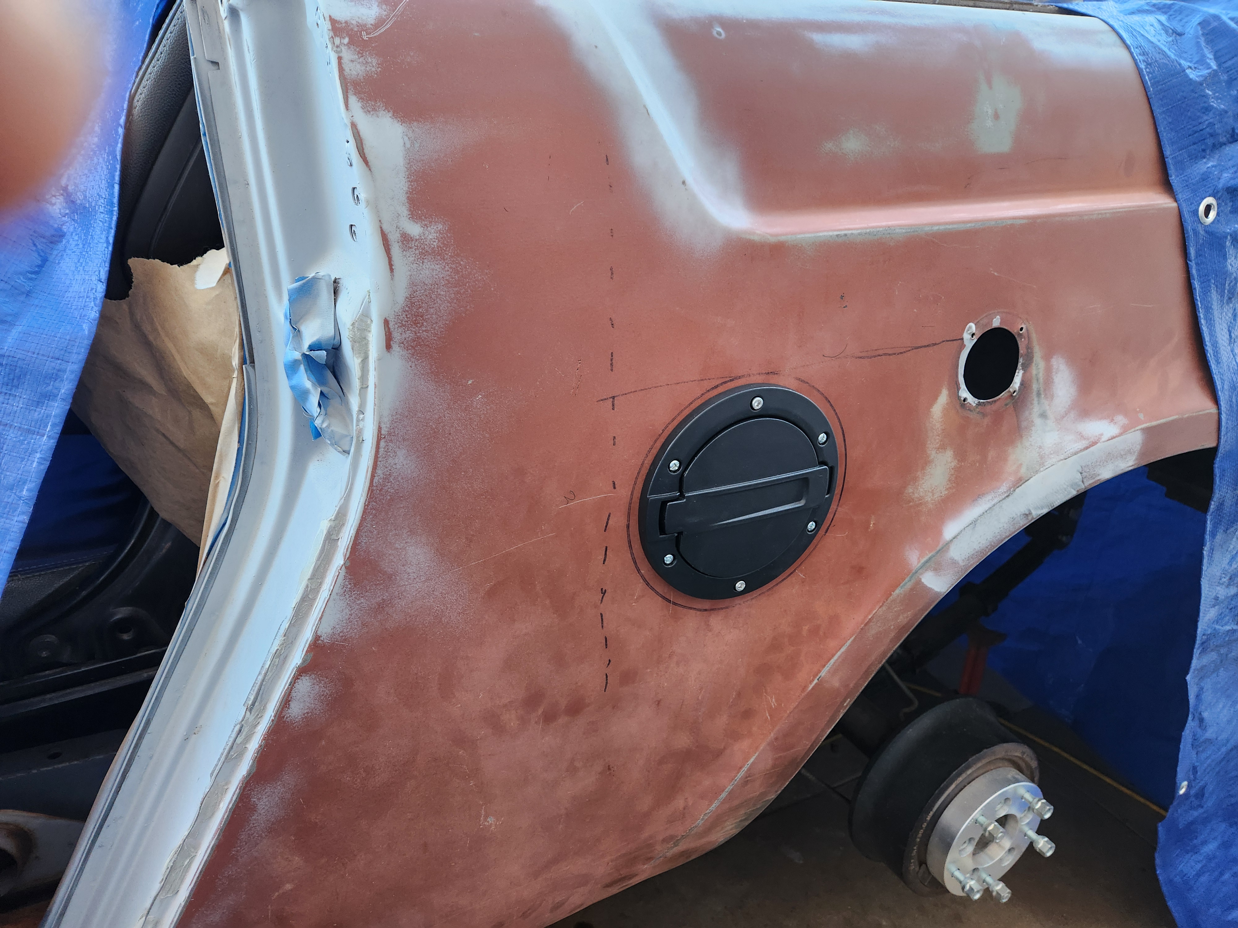

It's been hard to find time this last month, but I got to work on the charge port this weekend. There are lots of gas cap door assys for Jeep Wranglers on Amazon for around $25 and found one that should work.
