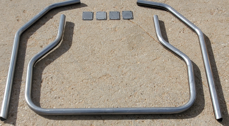

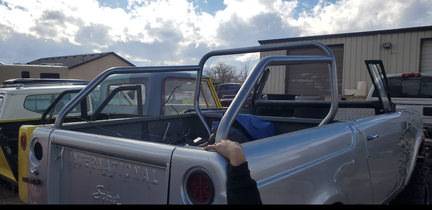

I bought a roll-cage to Mad Max this rig up a little. It's custom cut for the Scout, and comes pre-notched for welding.
This is how it should look installed (obv not my Scout)

They sell sfi roll bar padding for cages. It's pricey but worth considering if the cage is anywhere near your head. Or where your head stretched to in a crash. The padding is almost as hard as balsa wood. Hitting your head on a roll cage hurts bumping into it. If your head impacts it in a mild crash it can be lethal. It's not just the hardness but the small diameter.
The pool noodle padding is worthless in a head to cage crash.

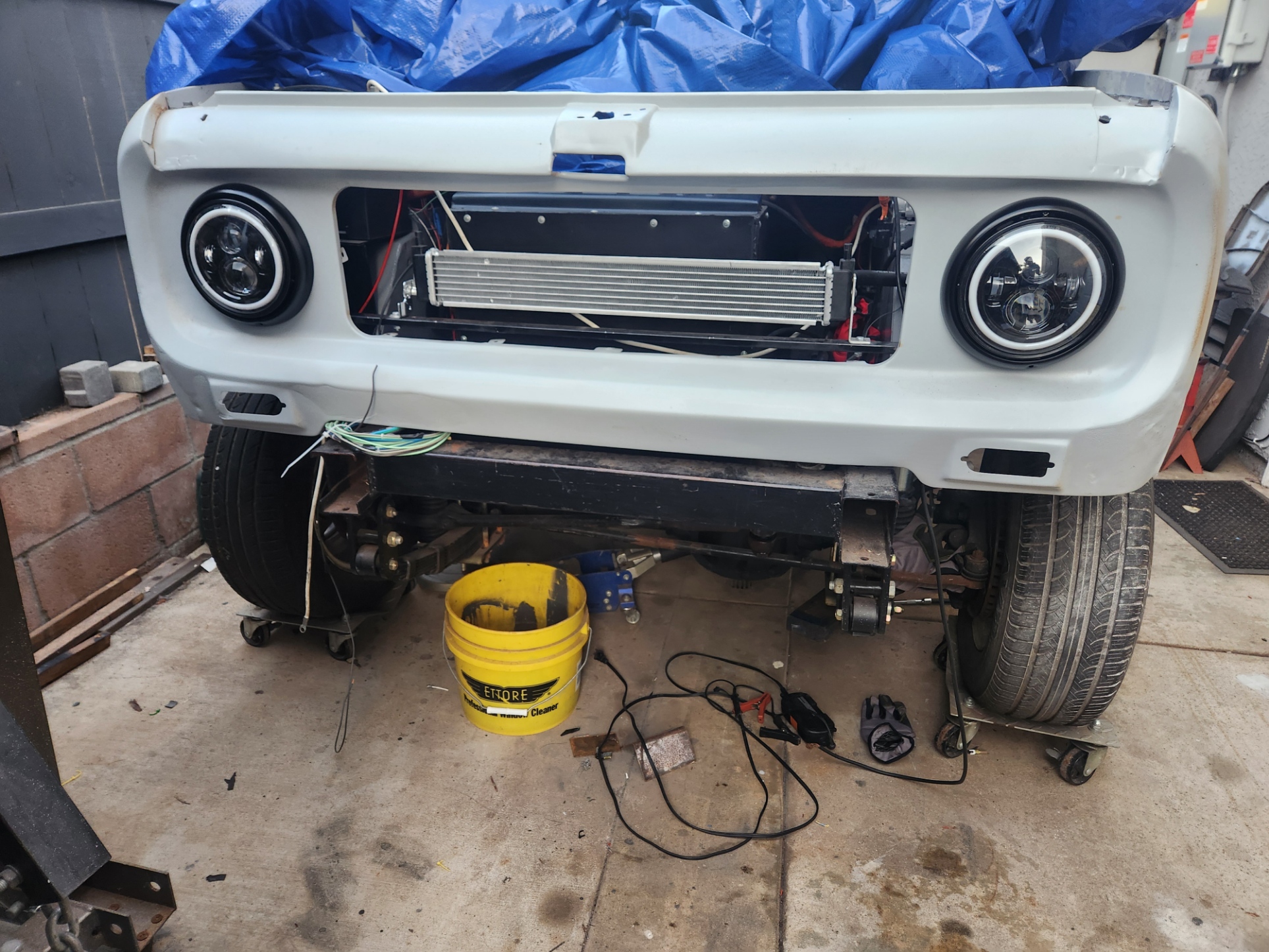

The original Scout headlight buckets were rusted out and parts are really expensive to come by. Luckily there are a ton of aftermarket parts for Jeeps, so picked up a set of DRL LED leadlamps. For now I just painted my rusty chrome bezels black, but may get new chrome ones later. The headlamp has amber turn signal capability on the LED ring

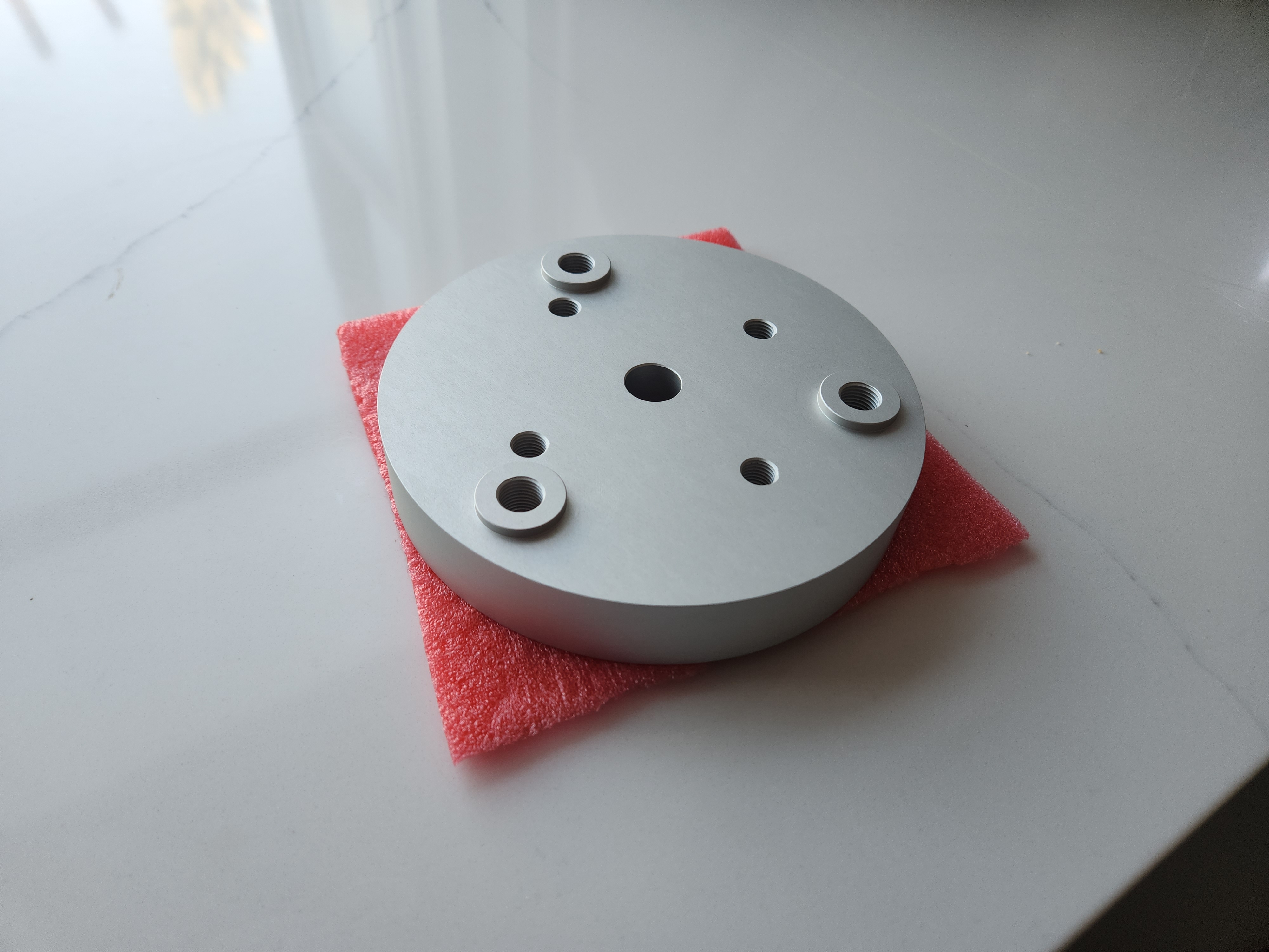

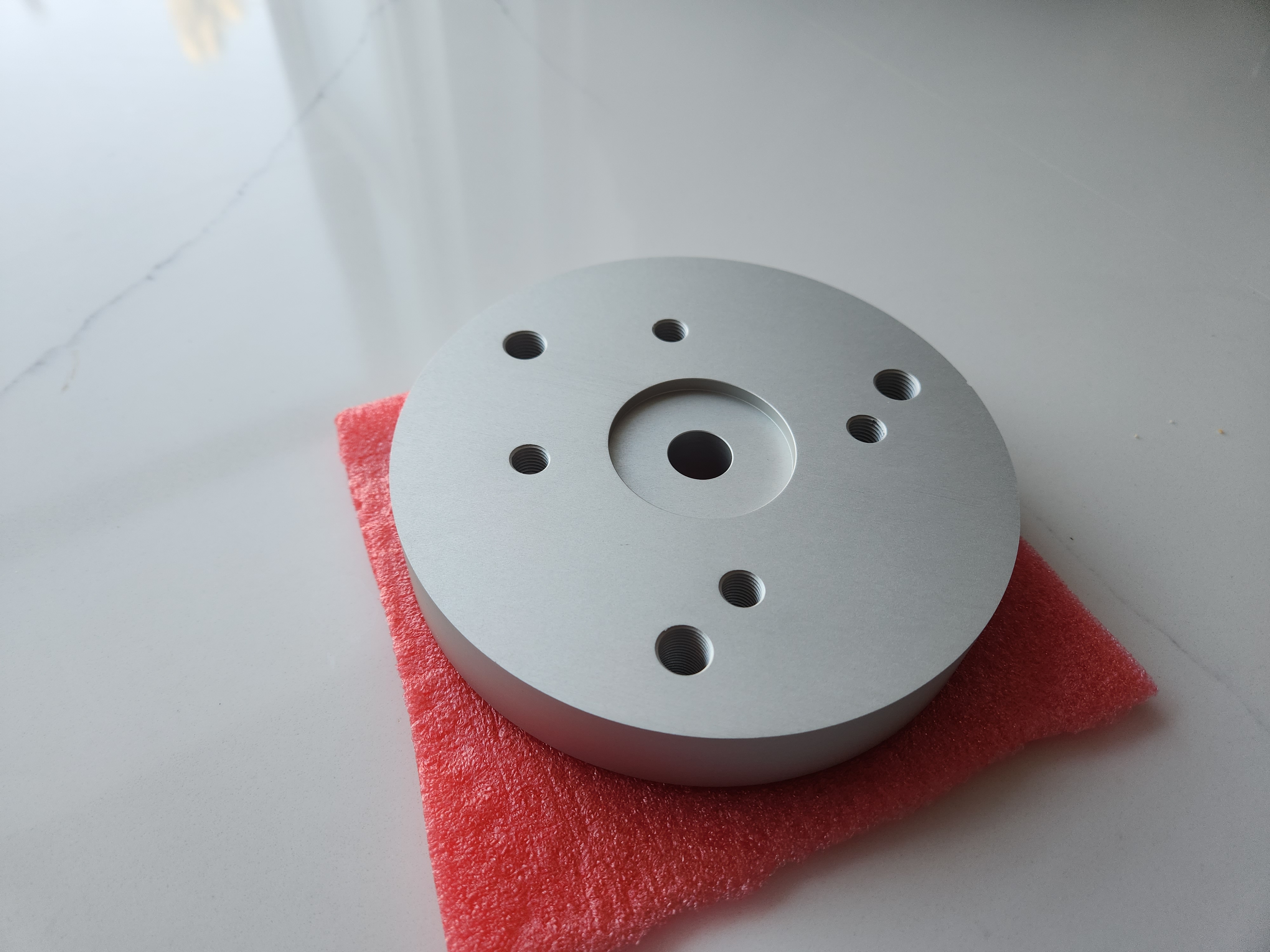

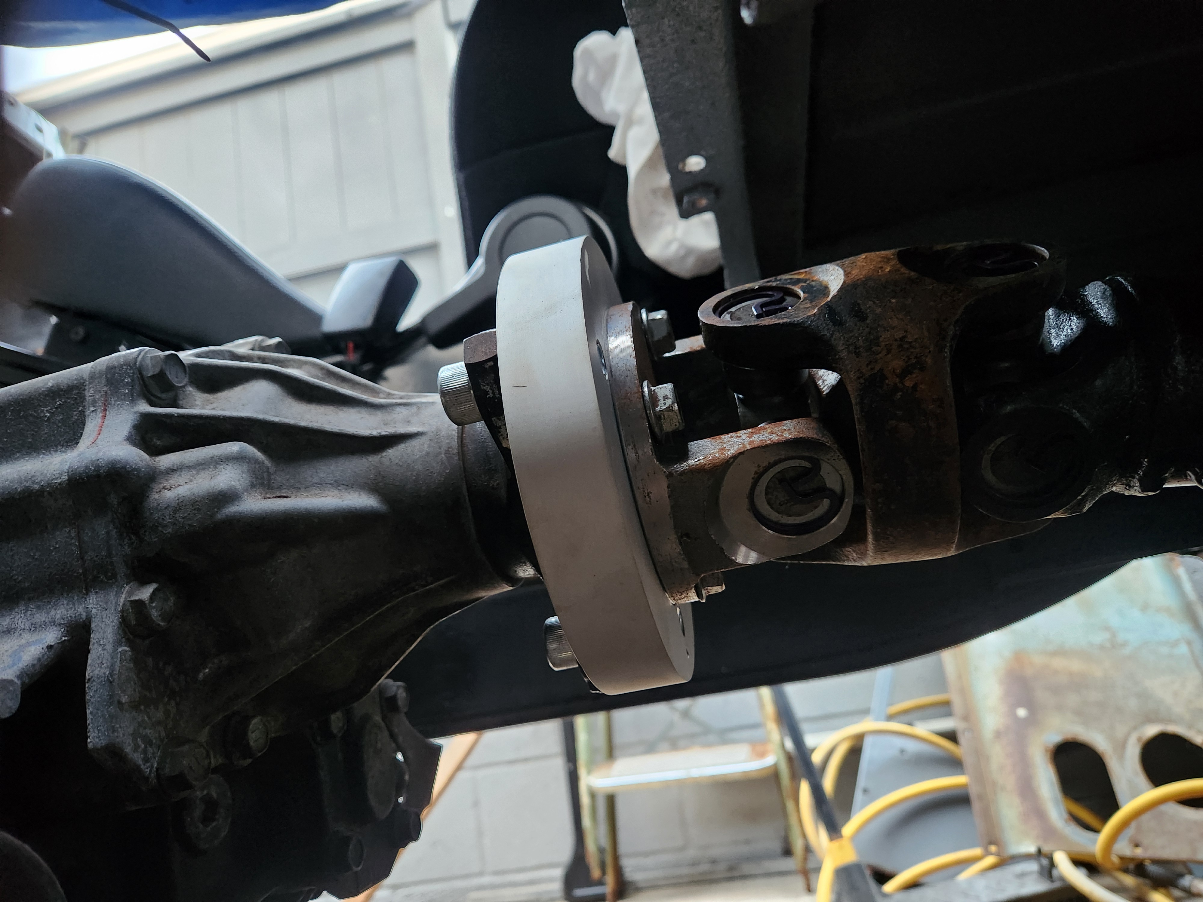

Came back from a few days out of town to find my nice new adapter all machined up from jlc:

Slow progress, but got the adapter mounted at least

robertwa wrote: Wed Jan 08, 2025 3:21 am Slow progress, but got the adapter mounted at least
Nice, is it anodized? Or planing on panting it?
Just concerned over the dissimilar metals reaction.

Bratitude wrote: Wed Jan 08, 2025 6:23 am Nice, is it anodized? Or planing on panting it?
Anodized.... this is what I chose:
Material: Aluminum 6061
Surface Finish: Bead blasting + Anodizing-Natural-Matte
Tightest Tolerance: ISO 2768 medium
Surface Roughness: Ra3.2
Threads: Yes

robertwa wrote: Wed Jan 08, 2025 4:48 pm Anodized.... this is what I chose:
Threads: Yes
should be okay, i would throw a lay of paint on the steel ends to be on the safe side being is exposed to the elements harshly

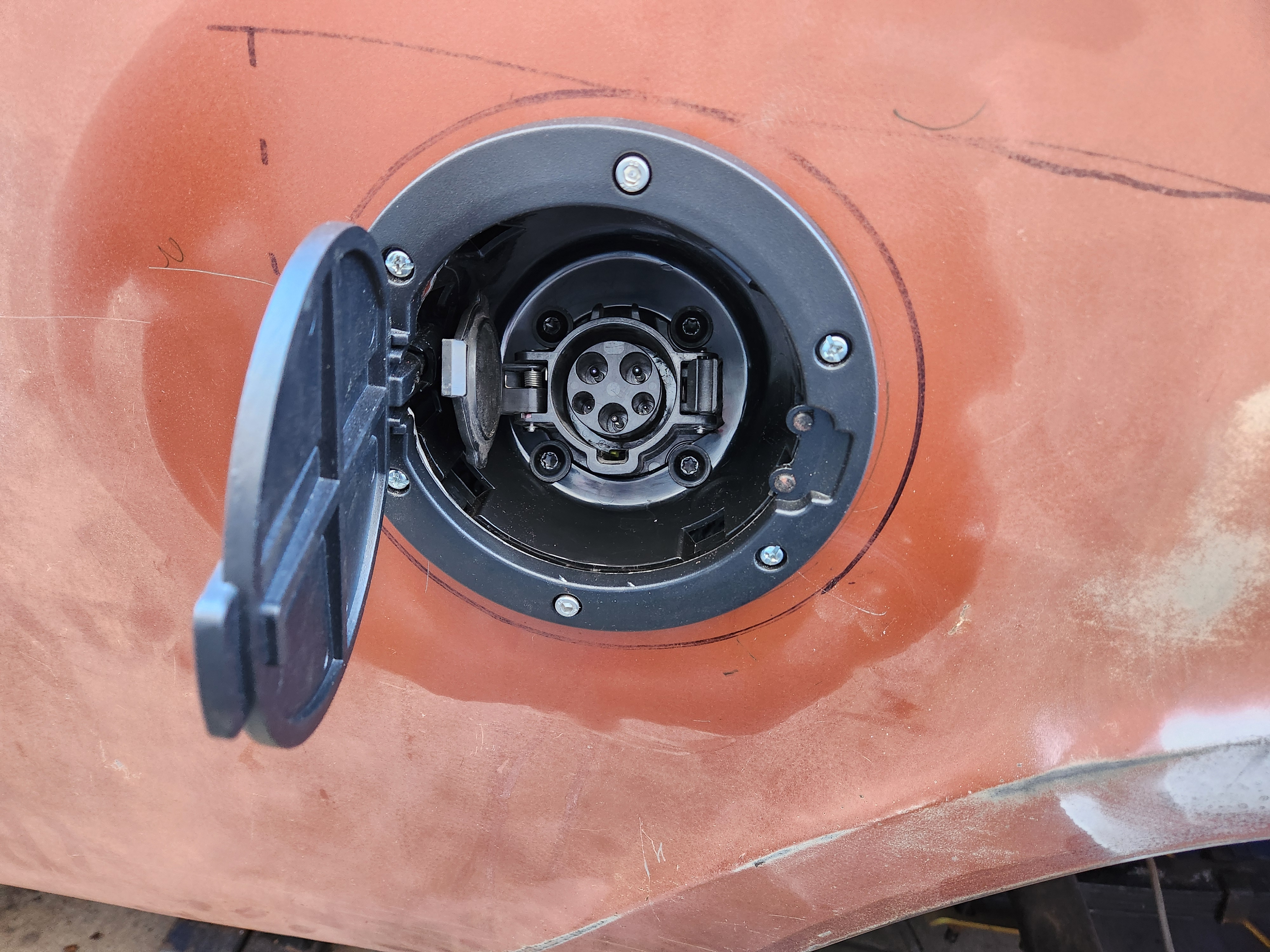

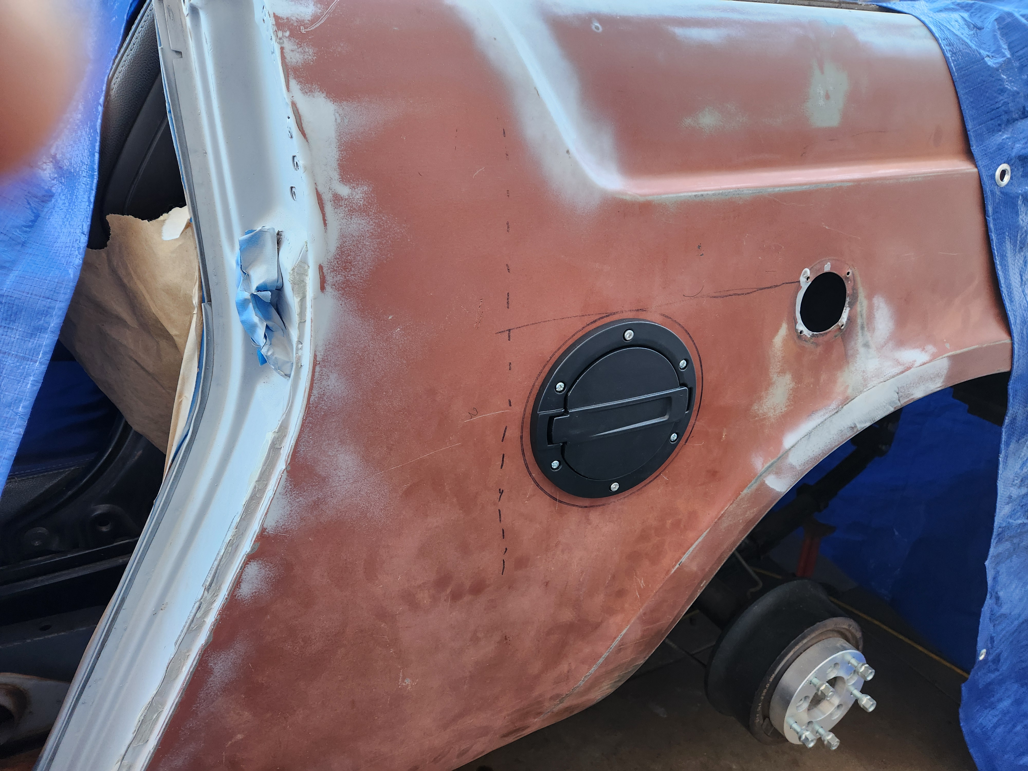

It's been hard to find time this last month, but I got to work on the charge port this weekend. There are lots of gas cap door assys for Jeep Wranglers on Amazon for around $25 and found one that should work.

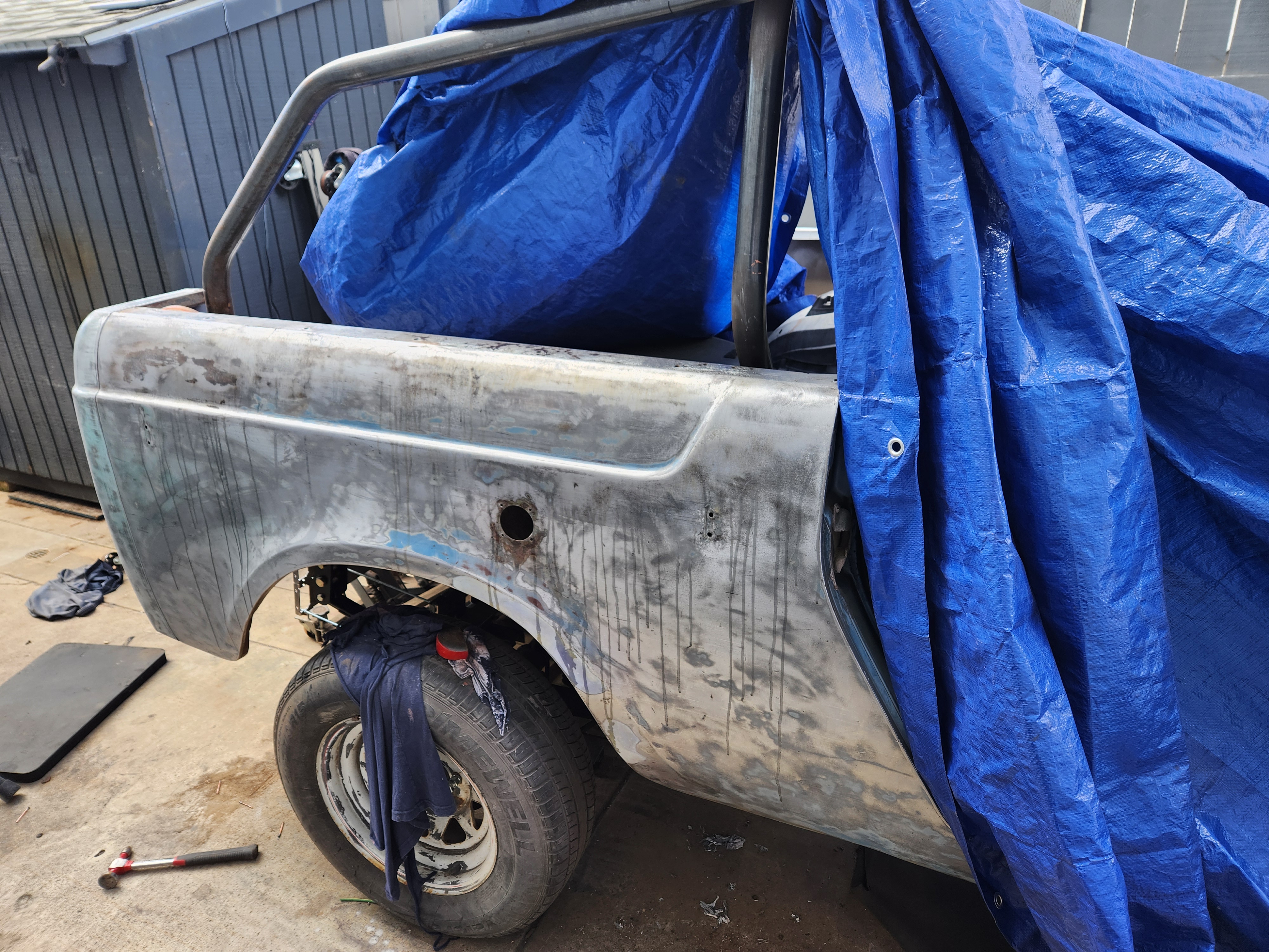

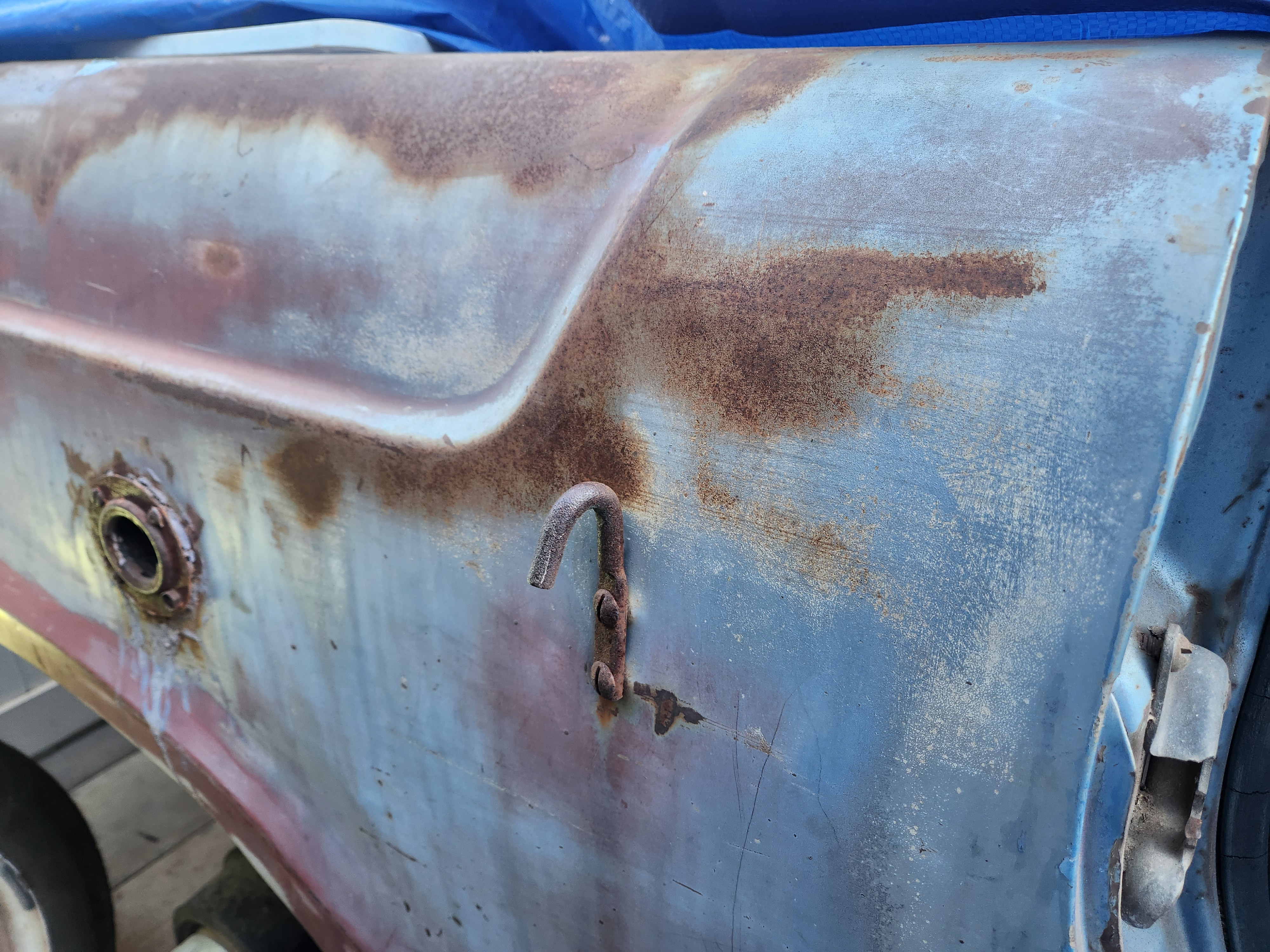

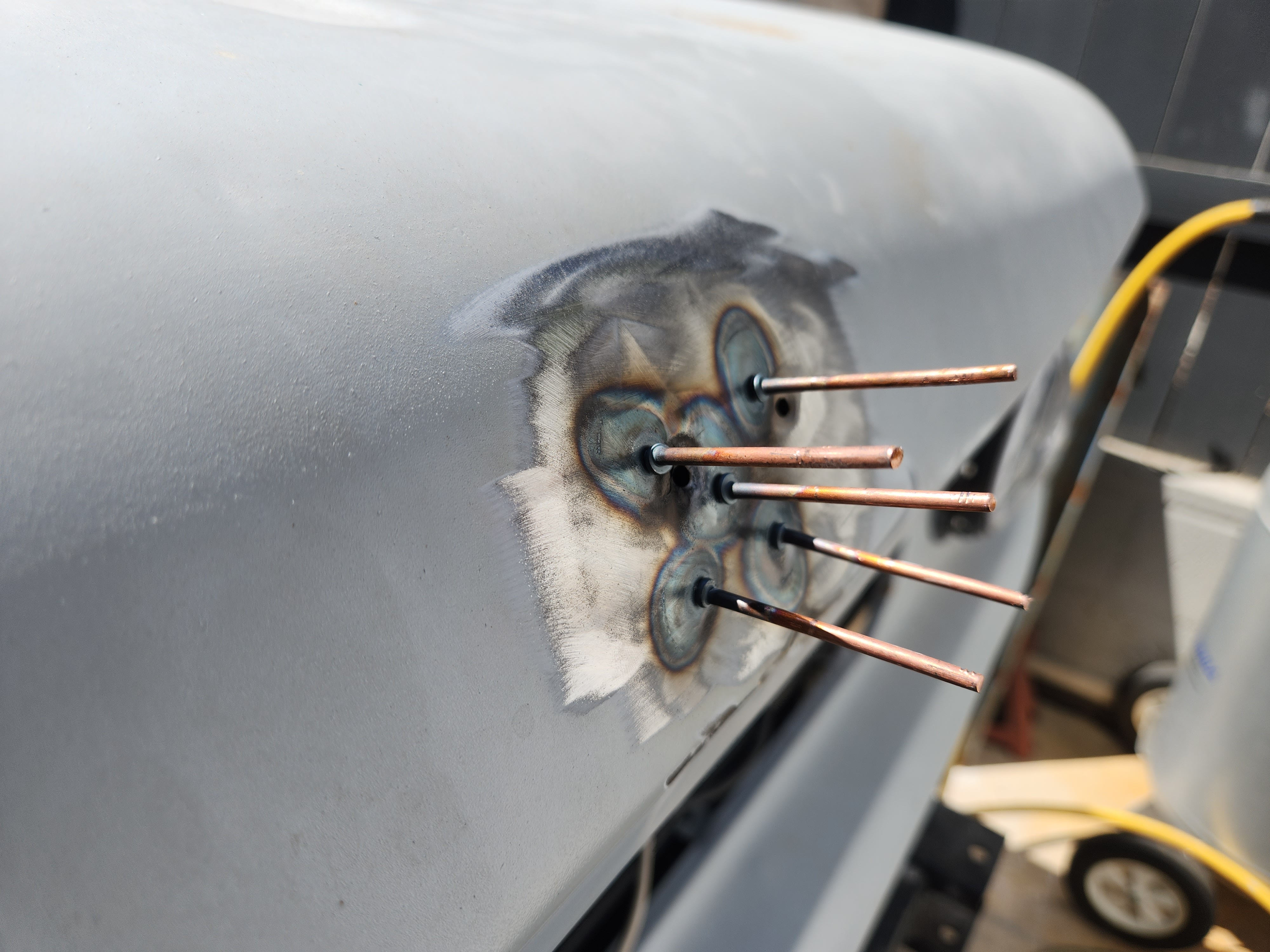

Bodywork, bodywork, bodywork. Don't buy a rust bucket. My goal is to get this thing halfway respectable, so I don't get the side eye from the neighbors.
This Scout came with (no joke), options from the dealer back in 1964. One of these options was farmer hooks. I've torn clothing and skin from these damn things over the last couple years, finally they have to go.
Stripped and ready to weld closed some holes
Pulling dents
Finally all in primer. Problem now is it brings out every single little ding, so lots more filling and block sanding to do

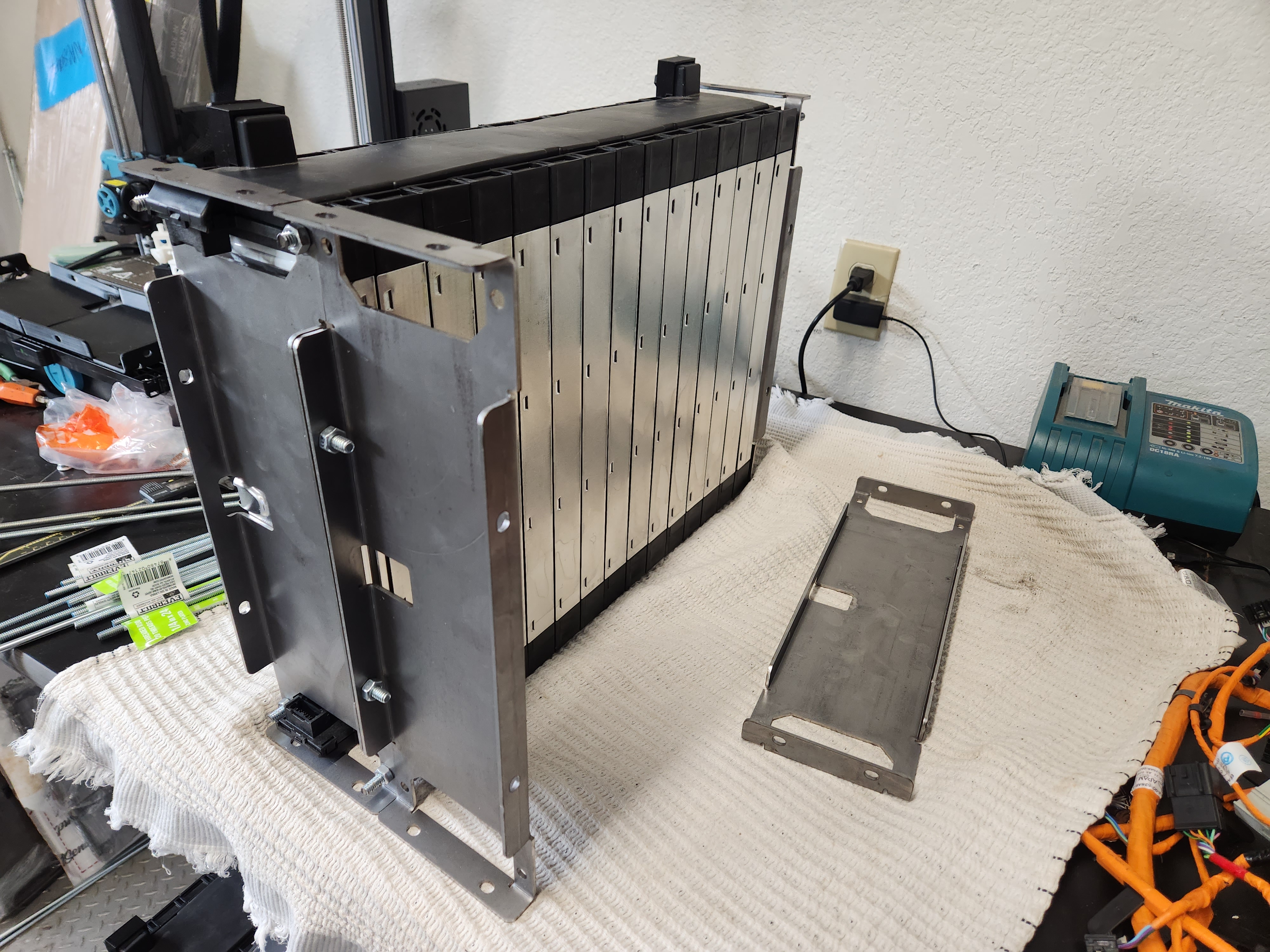

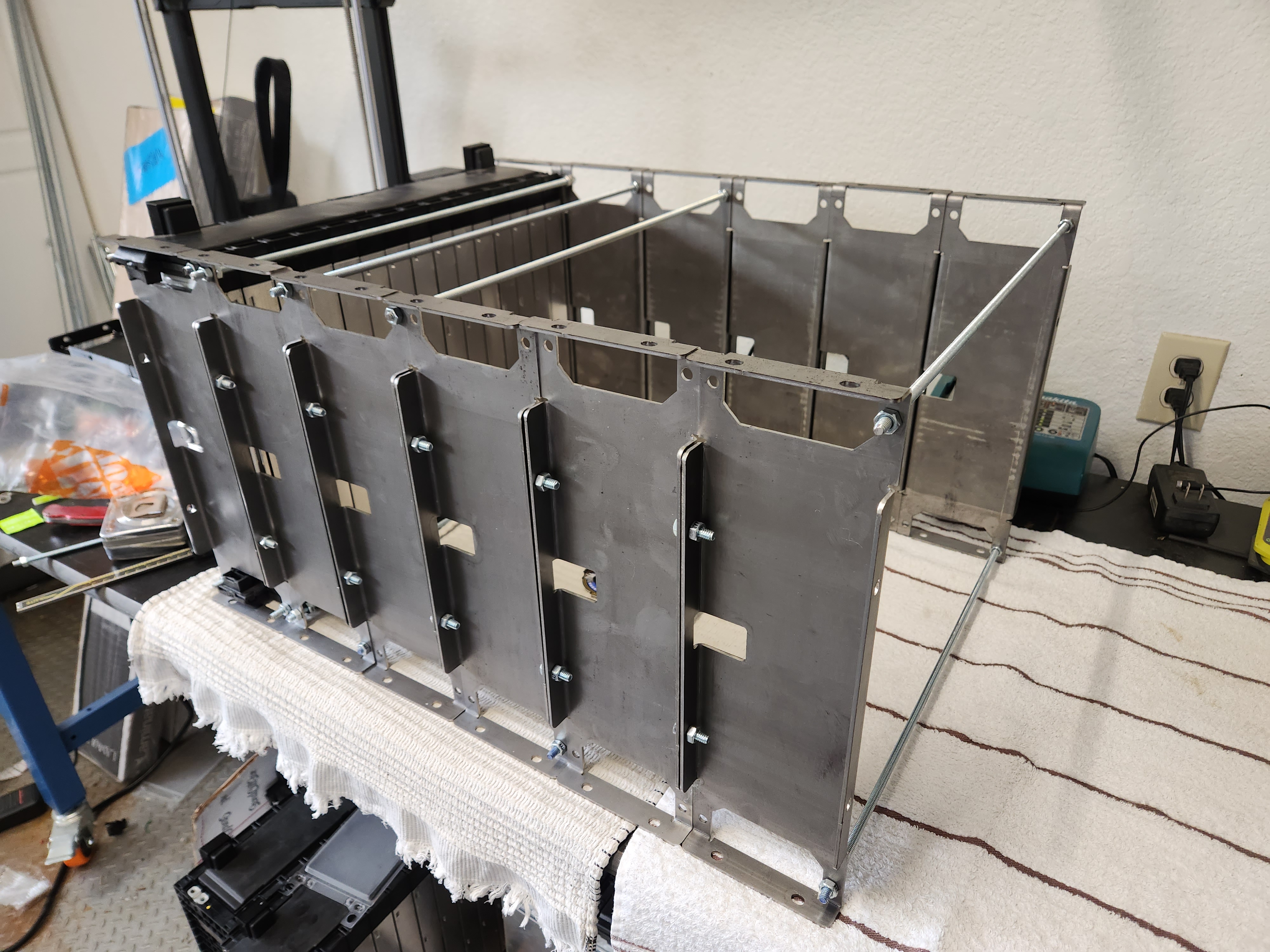

I bought the 2023 Bolt pack a while ago as it was local and seemed too good to pass up. It has 8 10S modules and 2 8S modules.I got a leg up from a forum member here with CAD of custom module endcaps to make mounting easier. Plan is for 6×10S modules up front, and 2×10s+2×8s under rear seat. This time, I want to keep everything more accessible.

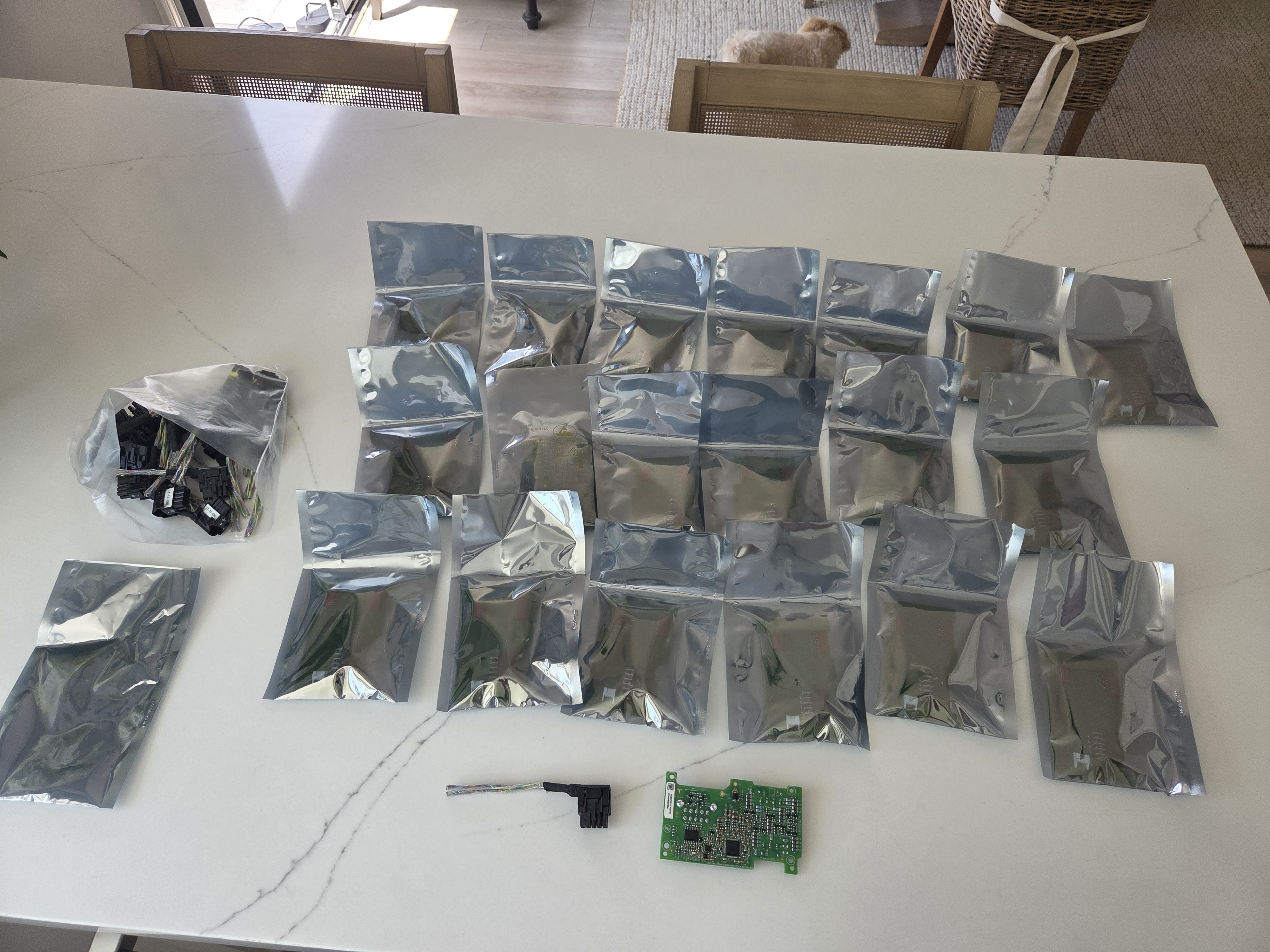

For BMS, the plan is to use salvaged tesla slave bmb's. Picked up 20 cheap on ebay @$9ea
[attachment=0]20250821_133930.jpg[/attachment
Posts: 2754
Location: Bristol
Has thanked: 264 times
Been thanked: 717 times
Re: [WIP] 1964 Scout LS600H conversion
Please note the Bolt modules will need to be housed in a water tight enclosure (like all batteries should). I have seen them go bad just from being stored improperly, they develop an isolation fault and worst case can start to have excessive self drain.

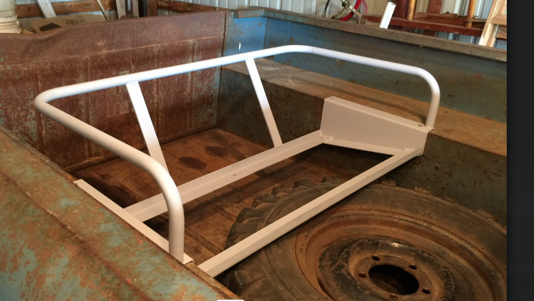

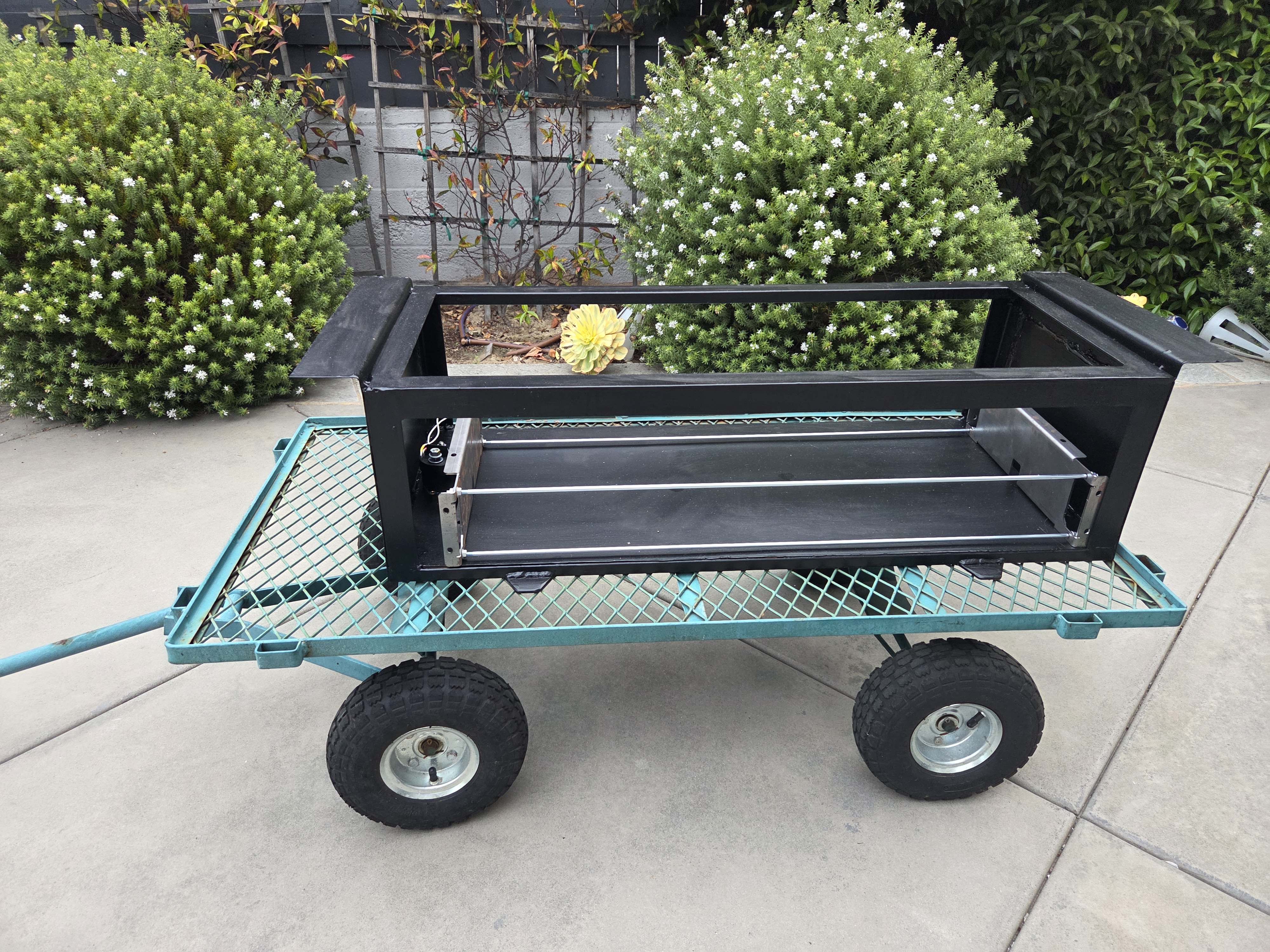

Yes, batteries will be fully enclosed in boxes. For the rear bench seat battery box, I'm going to try and mimic the basic design of the original bench seat (that I don't have), except it will sit higher. I'm undecided whether to have it front facing (as per original) or mounted further forward and rear facing. Amazon has a number of rear seat cushion options for golf carts that look like they may work to top off the box.
robertwa
Posts: 187
Location: San Diego, CA
Has thanked: 129 times
Been thanked: 157 times
Post by robertwa »
This is a stock image of the original seat

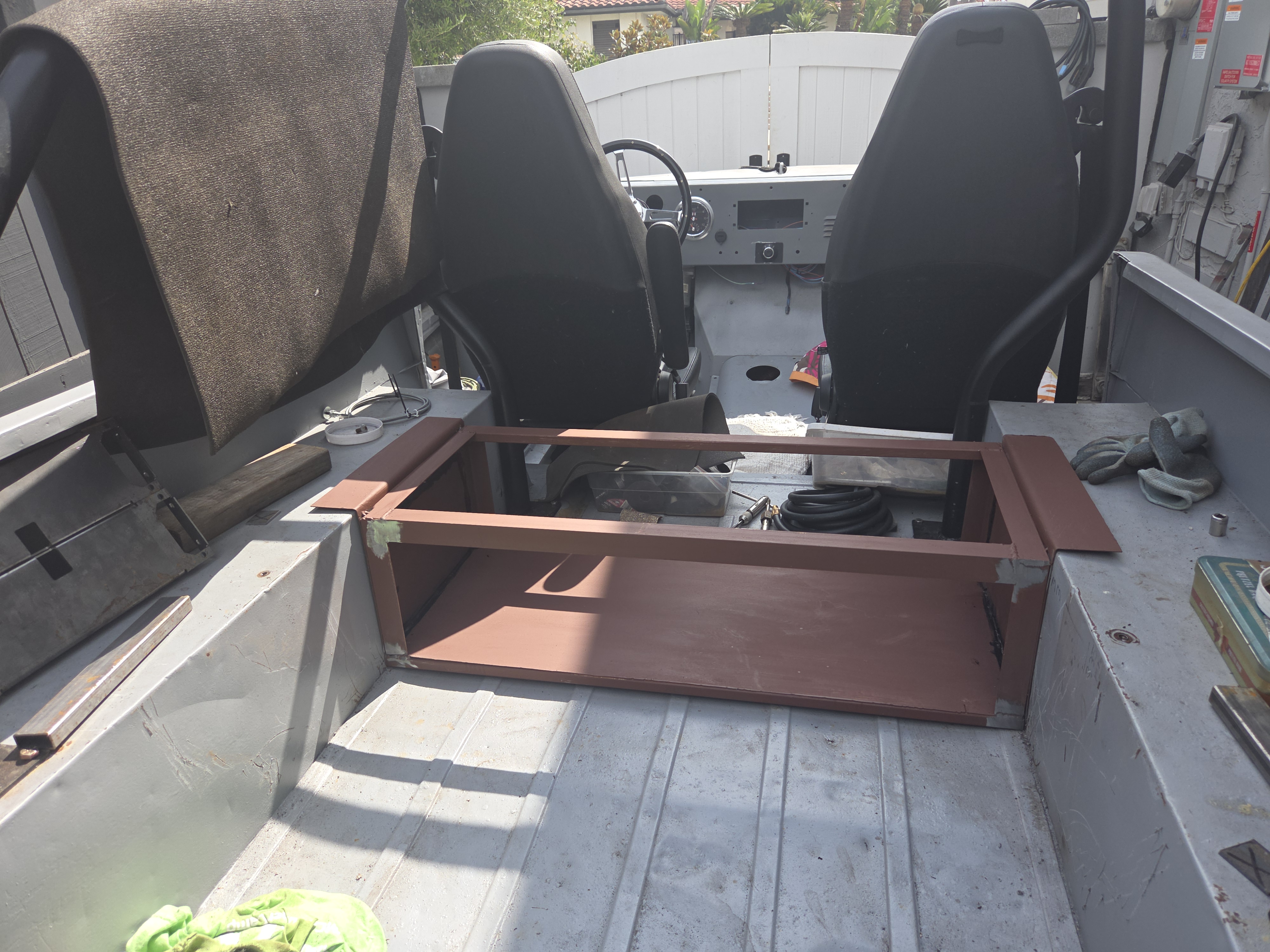

Here is where I'm at:

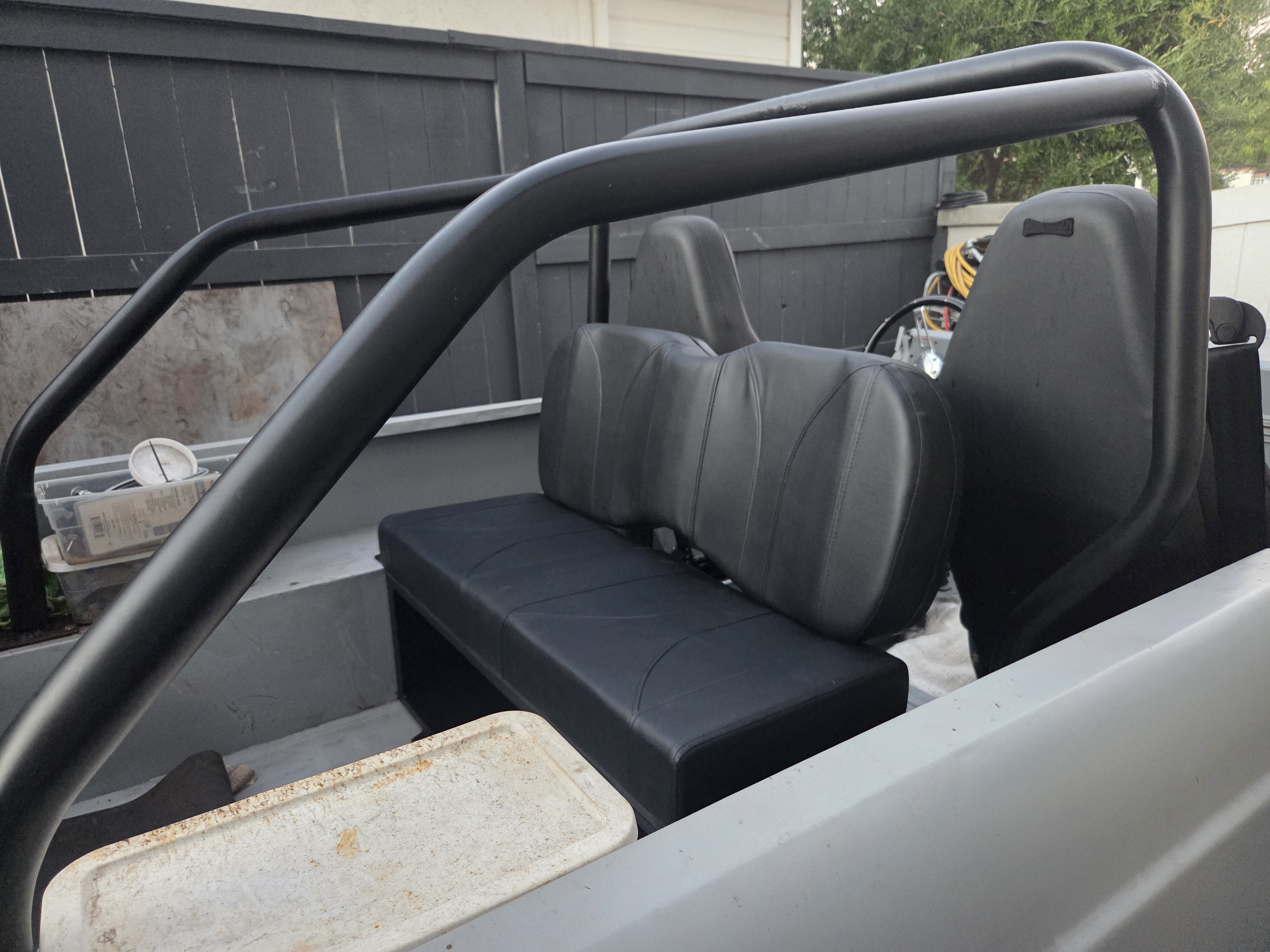

Received my golf cart bench seat, so had to do a rough test fit
I could lower by 2-3 inches by cutting out the floor and dropping it to the frame rails, but that's not in the plan for now.
